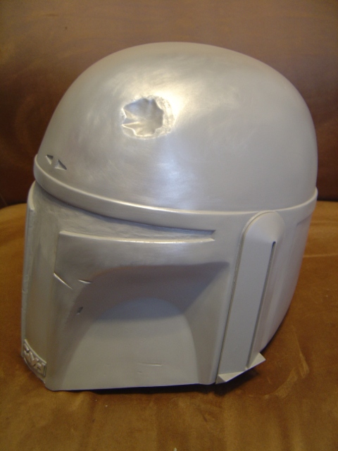

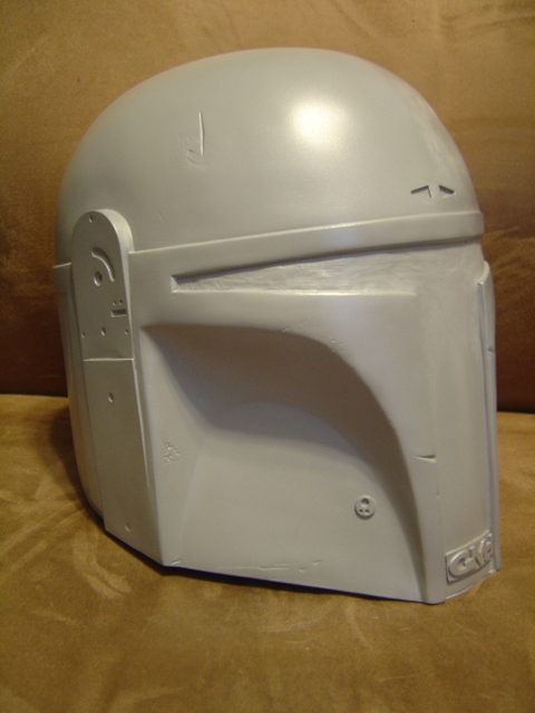

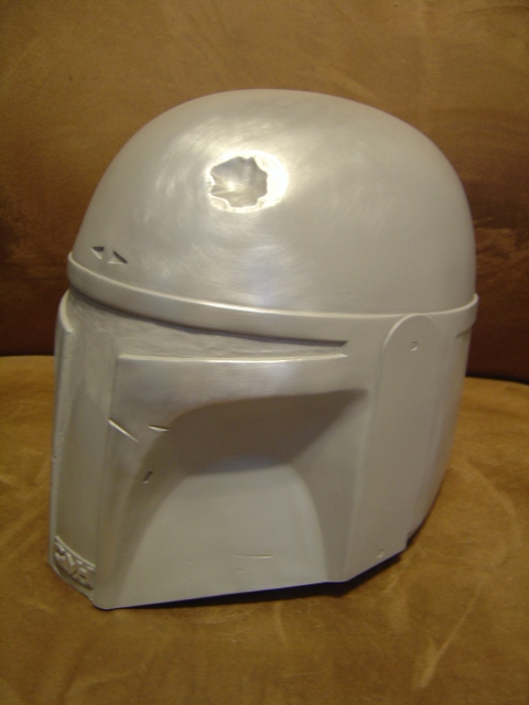

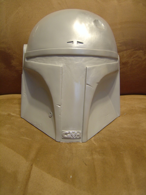

So, here are my progress photos. I stand it just a little on the right and none on the left. If it's to smooth and shinny the paint will not stick. What do you think?

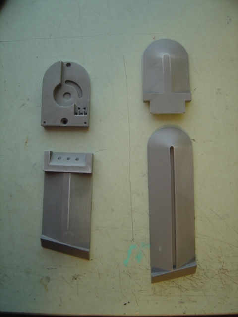

The ears are just tape in place and yes, they are cold cast.

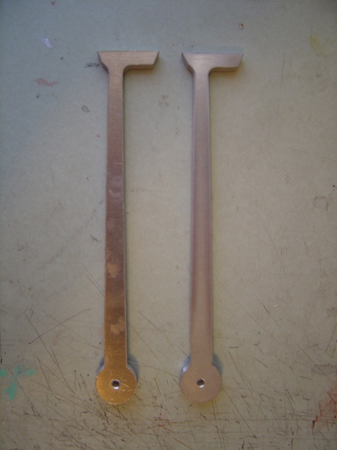

This is the RF I give in my Budget Boba kit. The ear for the GHM is a little different. To make it fit the best, I trimmed the one on the right to make it fit. Just a little trimming with a drimel was all it took.
