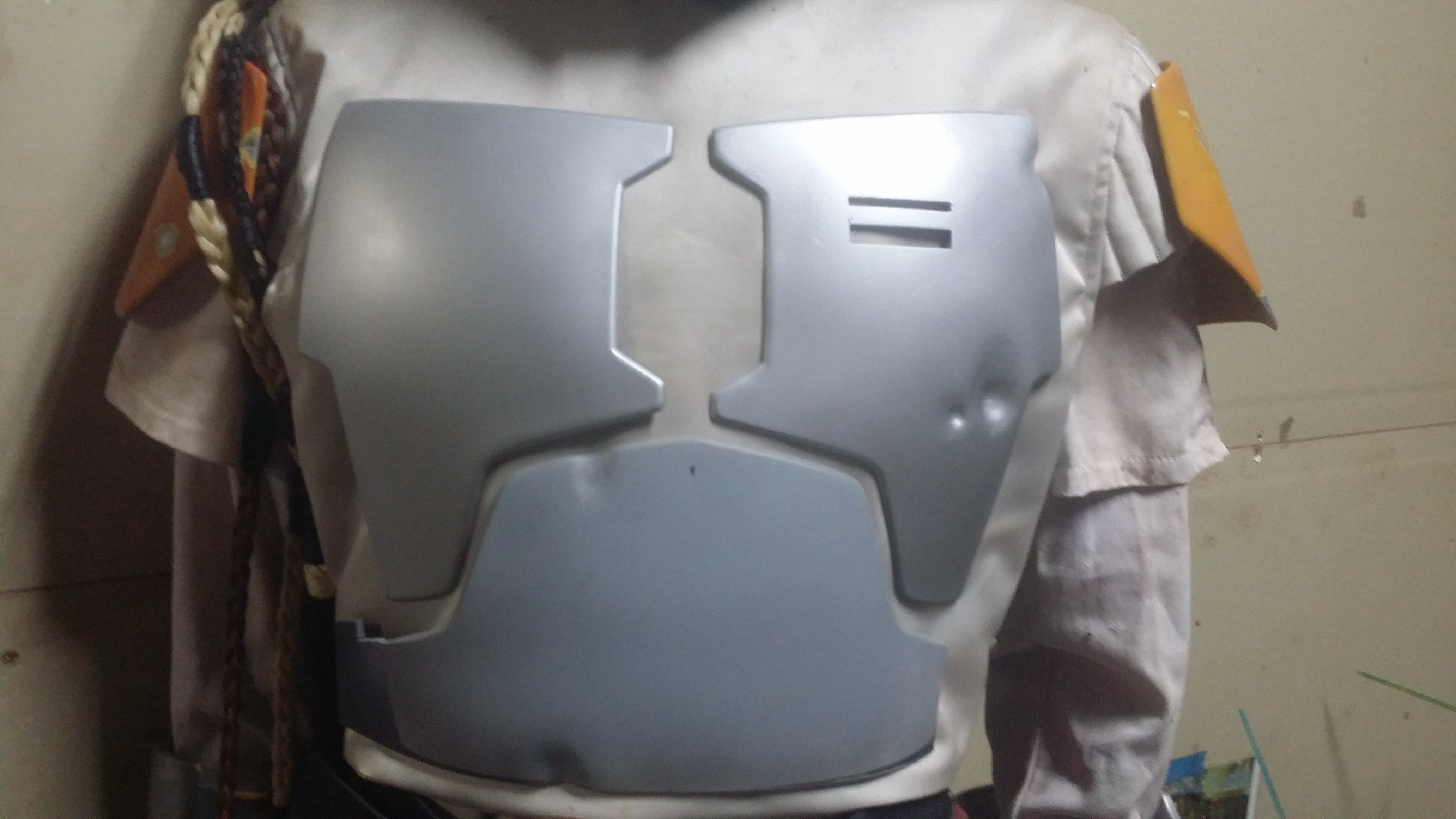

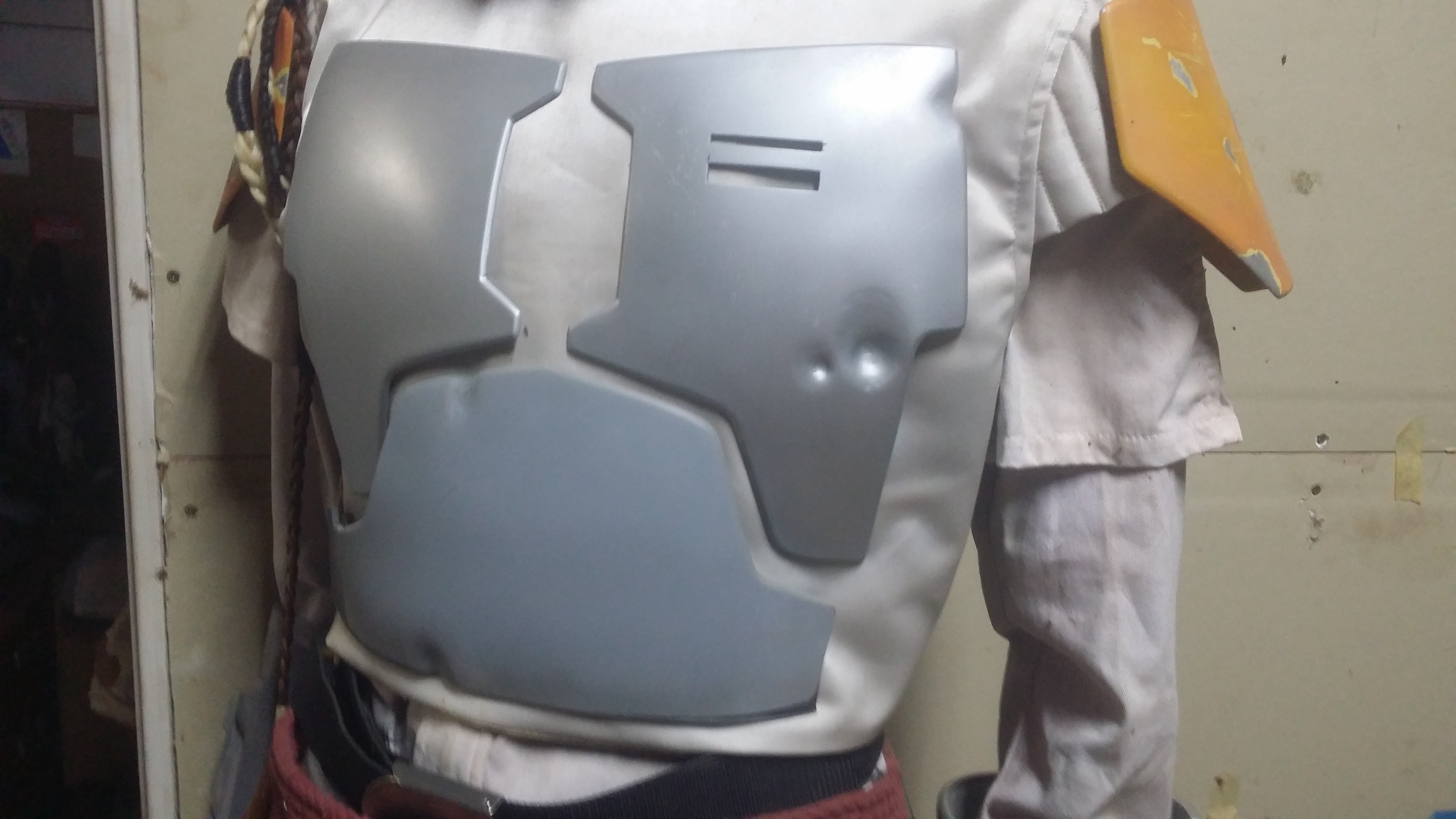

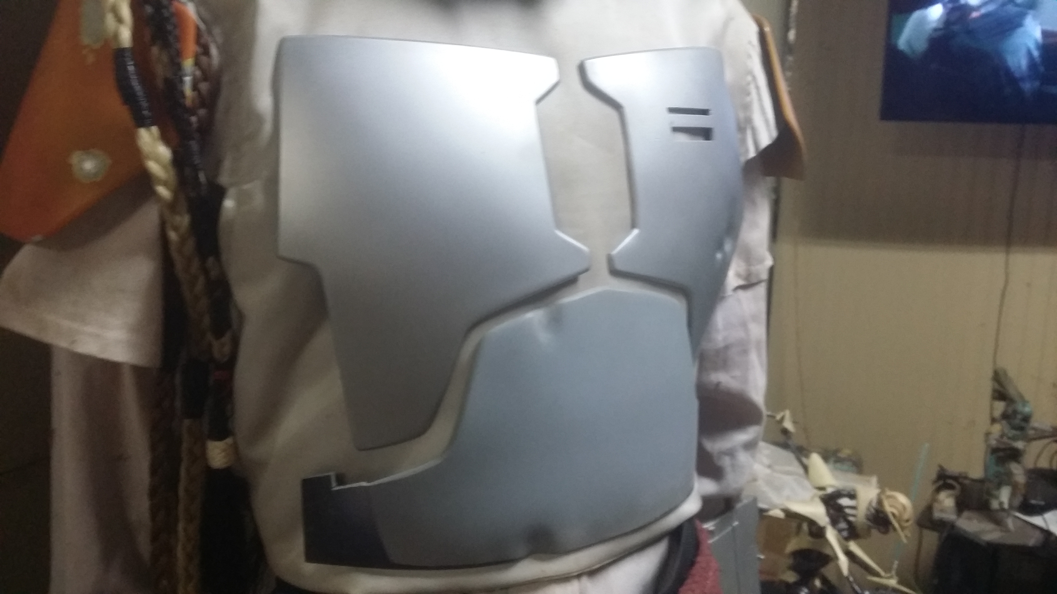

Here is my 3 mm pvc ( sintra ) 6 mm would to much! The real stuff is only 3 to 4 mm from the gallery, sorry to say but don't go the 6 mm its to boontha ( crazy ) may be 4 mm at max still easy to heat and bend hope this might helps? And for the dents find objects that may useful like a volcano lamp top cone.
I guess I'll just be better protected when trying to get the hard bounties! Lol
Thanks for the pic! Great job on that, looks very much like RKDs! I have 3mm, so maybe I'll give it a shot! You used WOFs templates?
Sent from my SAMSUNG-SM-N910A
thanks fella's, sorry for the late response, the chest plates are based on FP v3 but modified and ab plate is from screen shots, the chest still some more refining and the ab still needs more work,,may be this weekend? I am trying to copy the vac form look in the screen shots. With the dry season coming in might get some painting in too.
