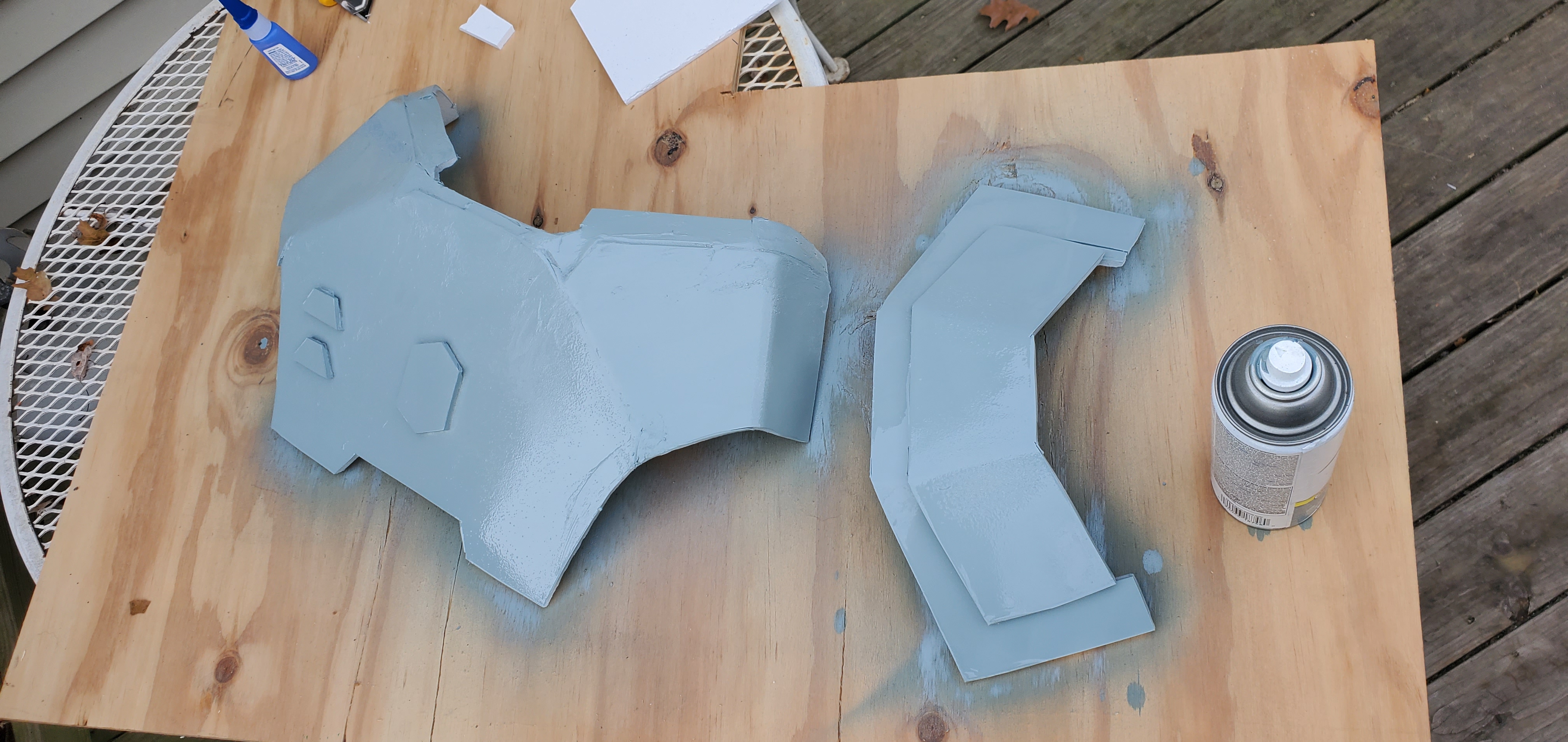

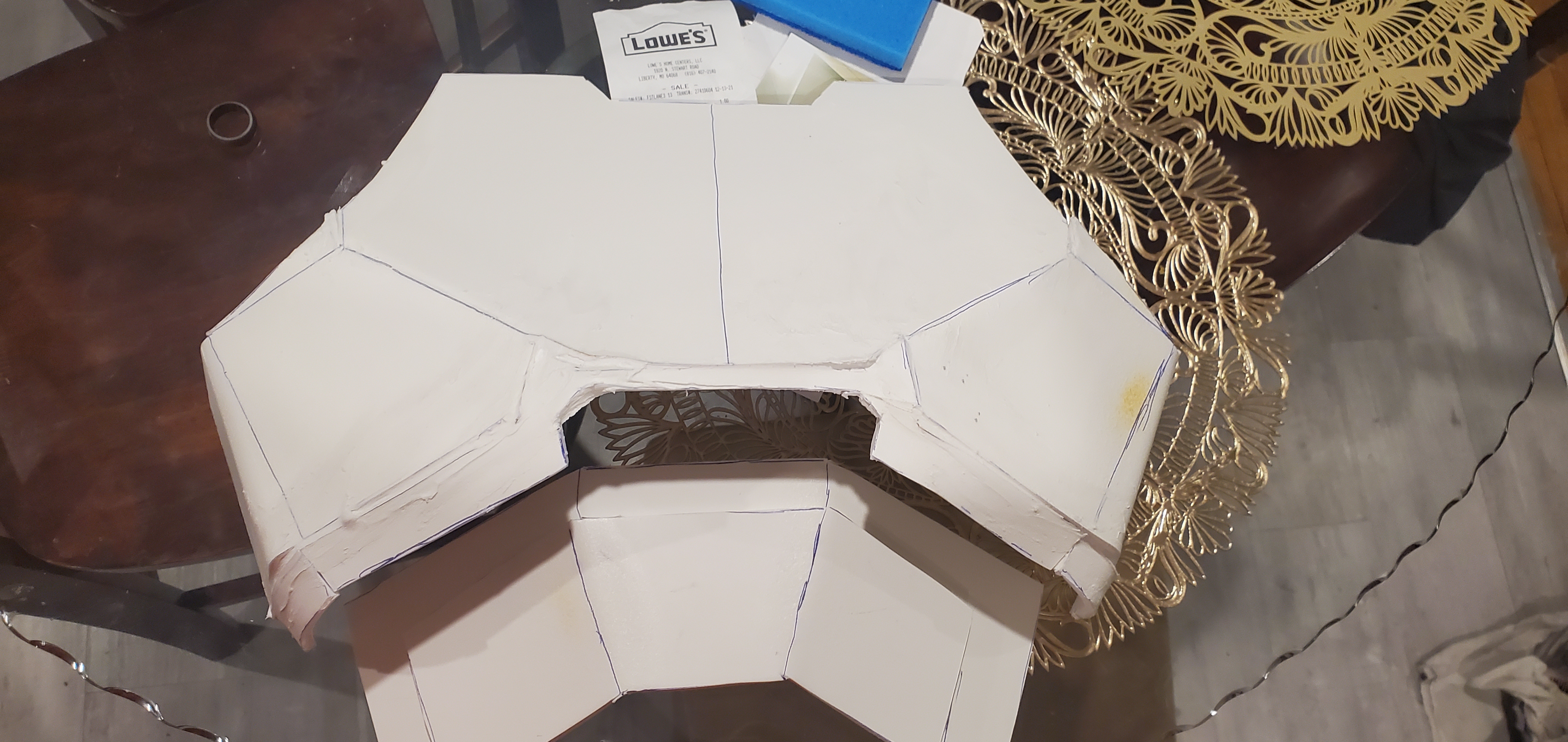

Here's what I've managed so far. I'm actually extremely happy with it. What do you think?
