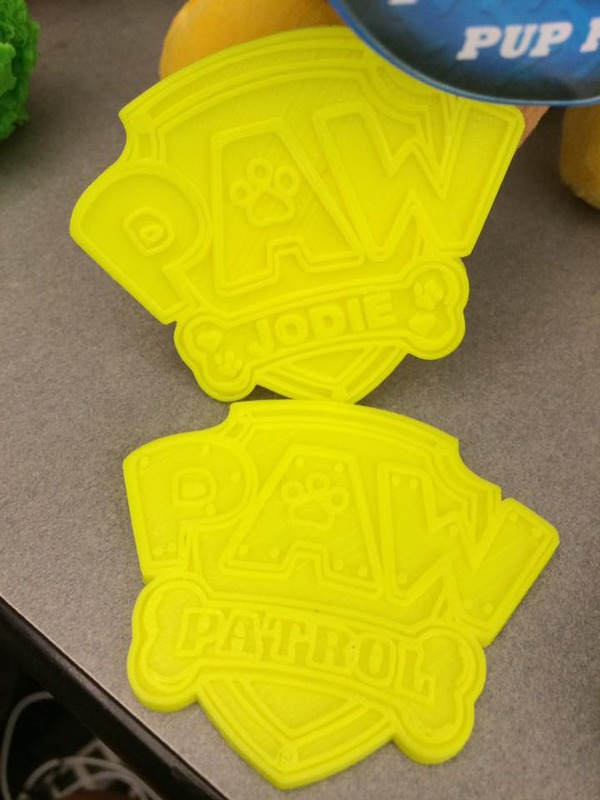

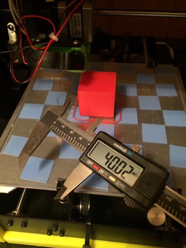

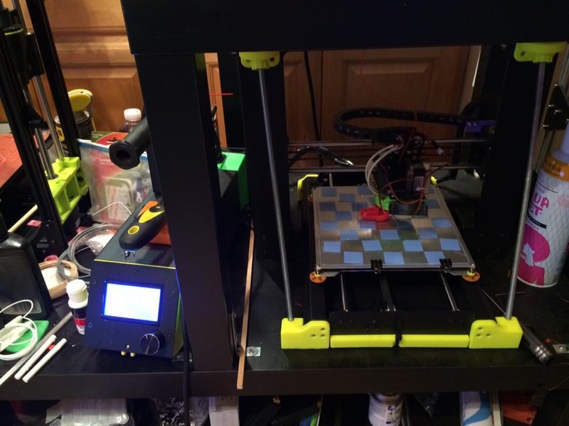

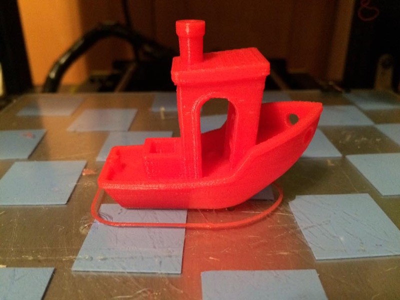

The Wanhao i3 is more difficult to use vs some others, but thats true of the i3 design in general. I think its a good printer to learn on and understand the basics of 3d printing At its current price point as well, its hard to beat. Lulzbots are nice, thats why I own them but the $2500 vs $350 pricepoint is pretty stark and to be frank, I just purchased it due to the build size. Also, the Lulzbot printers use 2.85/3mm filament not something specifically bad but 1.75mm is looking to be the standard in the industry and will make life easier in 2 ways: often cheaper options and more options with 1.75mm filament. Sure 4-point leveling is a pia, but once nailed down and as long as you don't wrench at the print off the bed, you're generally pretty set as well. It really comes down to how much you want to learn and how in depth you want to get with the mechanics of it. Once that's decided, then you have the price point you need to figure out. After that, THEN you need to decide which slicer/program you want to use to print, Cura vs. Simplify3d vs. anything else seems to be the basic setup. Some are free, Simplify3d is paid and so on. Here are some shots of my Wanhao and some badges I printed with them recently as well as a 40mm cube and "benchy" the tugboat, everyone uses to print/test their settings and printer. You can see the cube is pretty much 40mm, its a digital caliper so its probably the caliper's fault that its off and everything else looks clean. Not saying the other options aren't great either, if you have the funds to sink into the hobby, go big though I've found a good mix has been worthwhile. Lulzbot for larger items and my flashforge and wanhao for small detailed items work well together as a combo.
