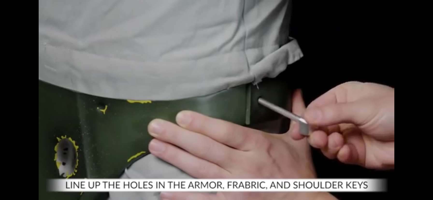

On the cod/kidney armor attachment the cod piece should overlap the kidney piece, not vise versa.
ShortFuse - Good Catch! (y) Are we gonna chalk that up to being a "Rookie Mistake"?

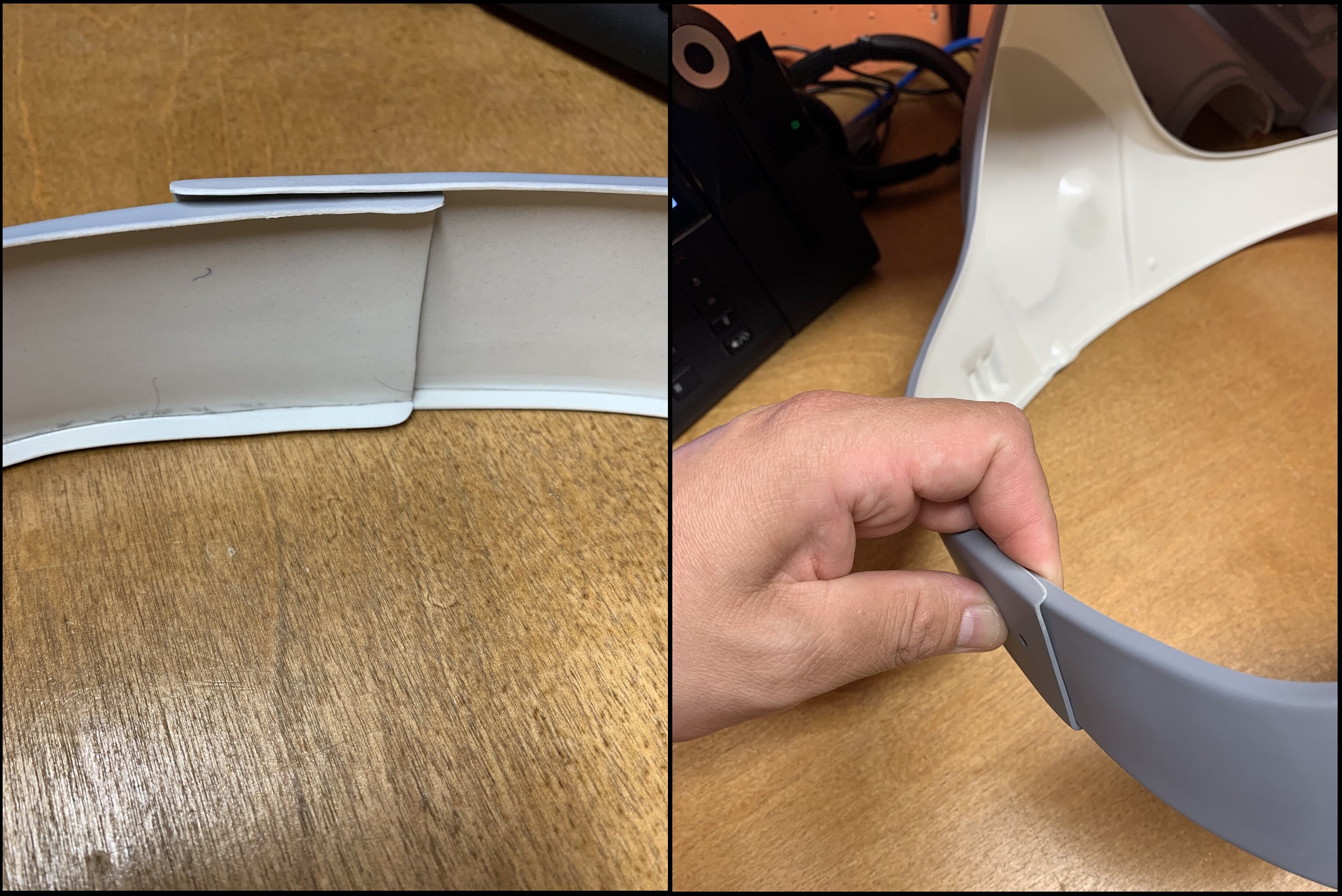

Boba Maker makes those armor pieces in such a way that its kinda dummy-proof. You can see that there are tabs on the upper and lower part of the Cod/Kidney Armor. The Kidney cannot overlap the Cod armor, with Boba Makers Armor it just wouldn't work the other way.
