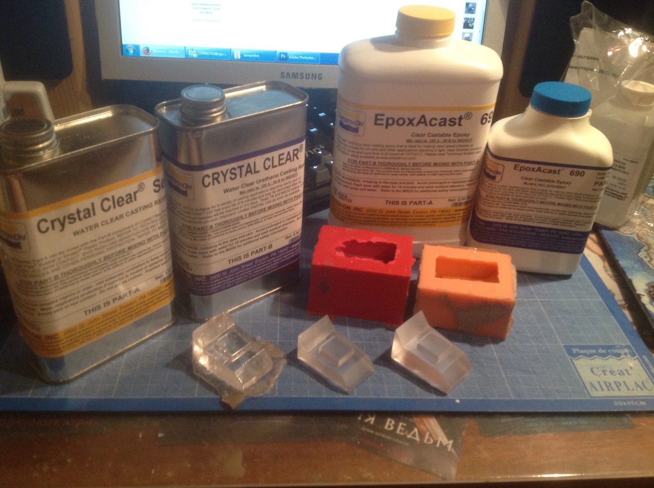

I used plastic at first, then began to use epoxy.
The plastic is very brittle and difficult to shape.
Epoxy is very durable and the quality is better.
