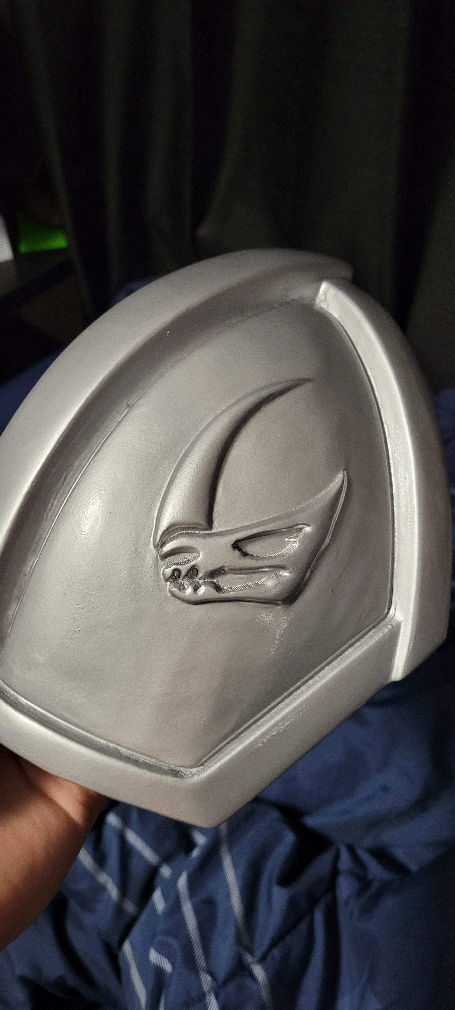

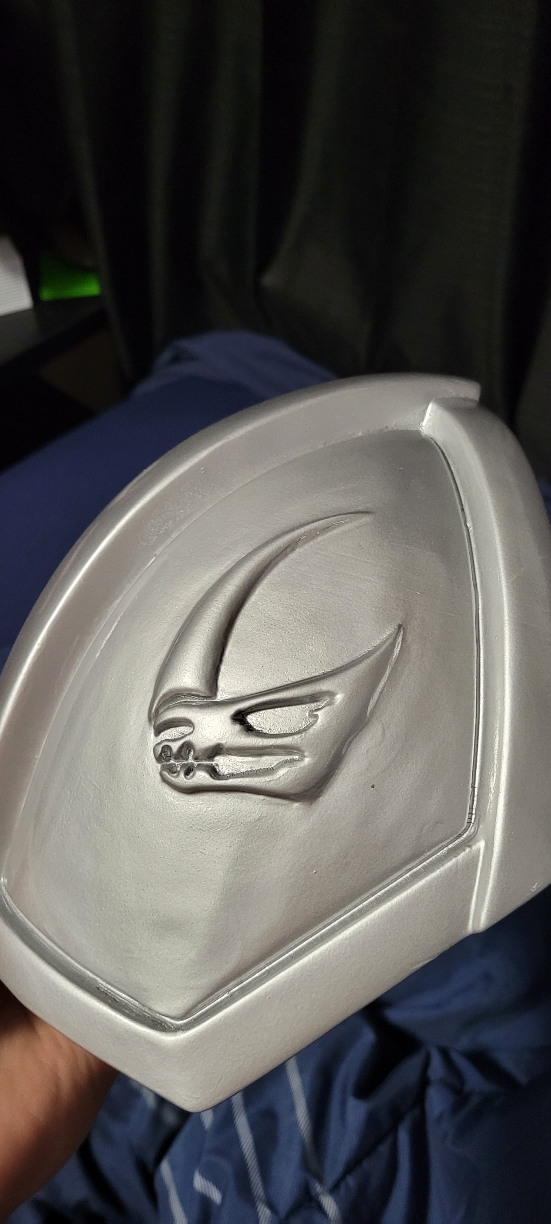

Hello again dented helmet folks, I come looking for help once again with the finishing touches on my armor. I wanna bring out the recessed details and kinda darken it down a but. I was told acrylic wash but the Clearcoat I used to seal and protect the silver is to smoothed that the wash isnt really sticking to it. Do I just need to use less water with the black acrylic? Or is there something else I can use?

Hit the surface of the armor with 0000 steel wool and this should cause enough abrasion on the surface to take the washes you are trying to apply.
