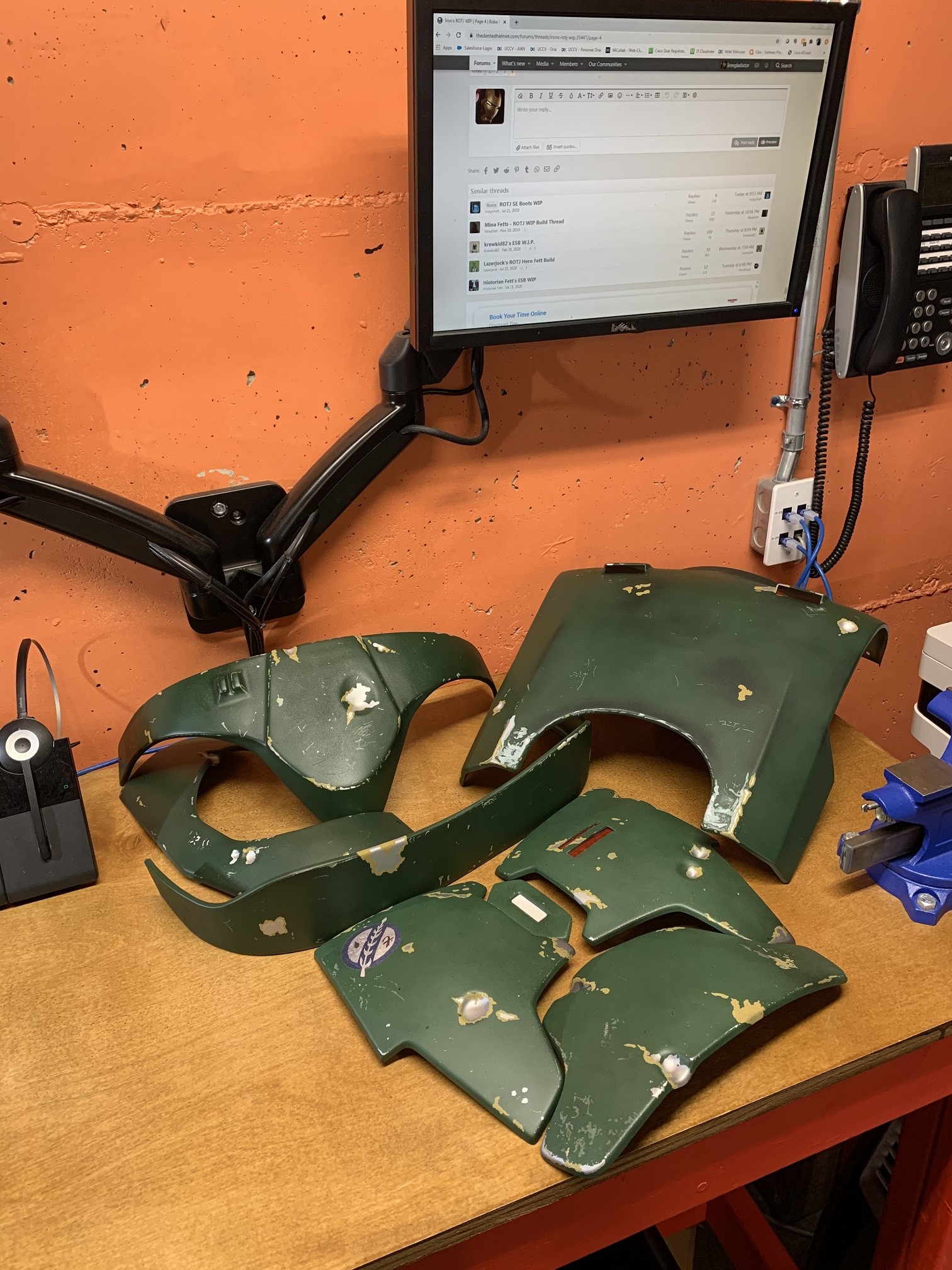

When building my ROTJ Fett I went with an all Boba Maker solution (Armor/Jetpack). Many of you may know, but Boba Maker finishes his pieces to 501st standards. Being this was my first attempt at cosplay painting, like most, I was a bit nervous in my painting ability. So I commissioned Boba Maker to finish the Chest Armor, Shoulder Armor and Knee Armor as I wasn’t comfortable in mixing paints or decal placement.
Needless to say when I got the pieces I was blown away with the work! I attempted to recreate his finishes on the Collar, Back and Cod/Kidney Armor. I was met with pretty good reception. But before I began my painting I was asked Boba Maker what he uses for paints. He told me he uses exclusively Tamiya paints, while I didn’t ask for specific model numbers I was able to nearly match his paints…
And the Tamiya X-11 seemed to be a direct match! So thats why I say Tamiya X-11 and for my ROTJ Fett I cleaned out my local hobby store of the stuff for a few months haha! Again I use it as the base of my work.
