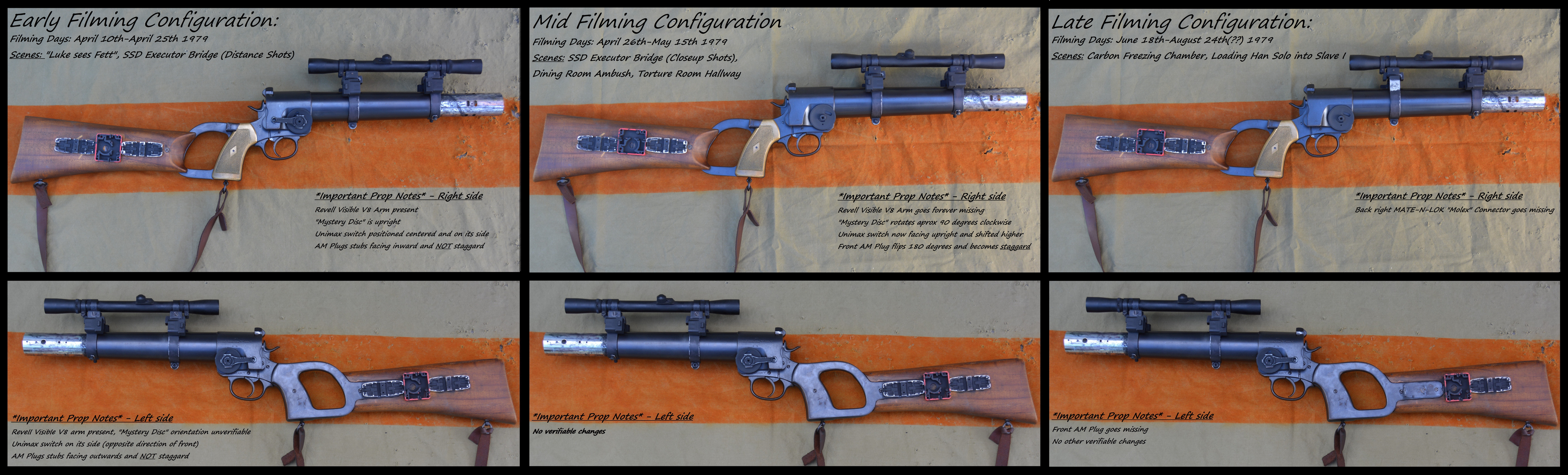

Hey guys
Some of you already probably saw these on FB and such, but this is the official post for this little side research project I've been doing for my favorite prop.
These are all the configurations for the ESB Boba Fett Blaster as seen on screen throughout Empire Strikes Back, which I have divided up into Early, Mid and Late Filming configurations using the help of RafalFett 's wonderful research here The Empire Strikes Back - Boba Fett's on stage chronology , to which I've no idea why it doesn't have its own sticky
I did my best to replicate all these changes as accurately as possible in regards to what happened and where/how parts moved or disappeared. Oddly the Mid filming configuration is what looks to be on screen the most, and is what most people do for their stock greeblies configuration.
Hope these all help you in recreating whichever variant of this prop you like. I'm kind of slightly more partial towards Mid configuration myself where it has slightly more "character" with all the wonky stuff
Early Configuration: (The original state of this prop, but least seen in the film)
Boba-Fett-Costume-Empire-Strikes-Back-10a.pngBoba-Fett-Costume-Empire-Strikes-Back-Hallway-05.png242696881_10216189032917512_5050138368941033000_n.jpgBoba-Fett-Costume-Empire-Strikes-Back-Executor-07.jpg
Mid Filming Configuration: (What's seen on screen the most in ESB)
Boba-Fett-Costume-Empire-Strikes-Back-Executor-16.pngBoba-Fett-ESB-Gary-Kurtz-1-ABC-News.jpgMovies & TV 10_1_2021 10_55_49 PM.png242875252_10216189034197544_7564964933894543346_n.jpg

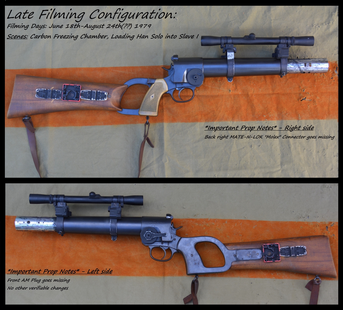

Late Filming Configuration: (the infamous missing molex variant)
Boba-Fett-Costume-Empire-Strikes-Back-Carbon-Chamber-22.pngBoba-Fett-Costume-Empire-Strikes-Back-Carbon-Chamber-24.JPG242751764_10216189035117567_5389481774191640170_n.jpg
All Versions Combined

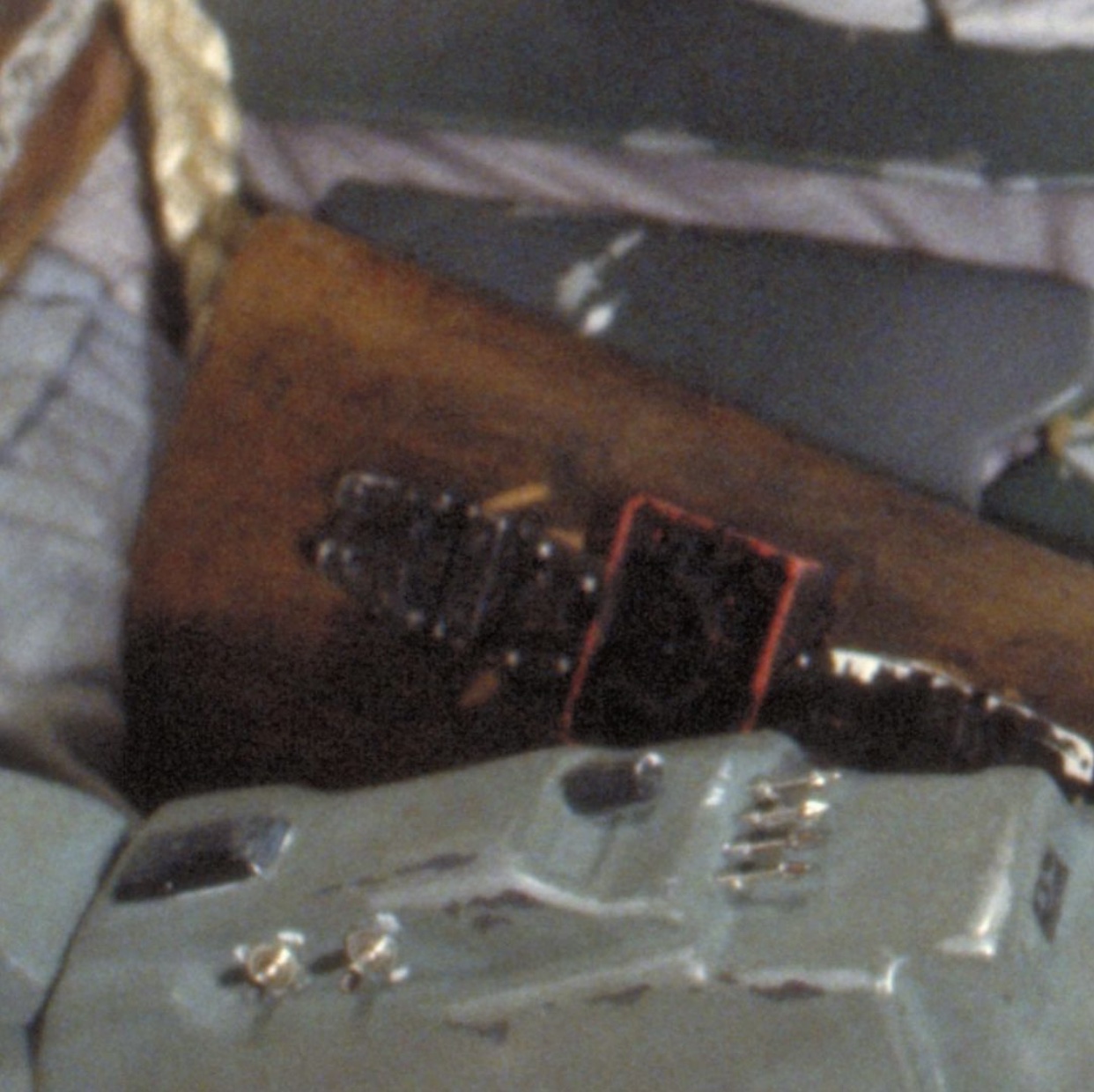

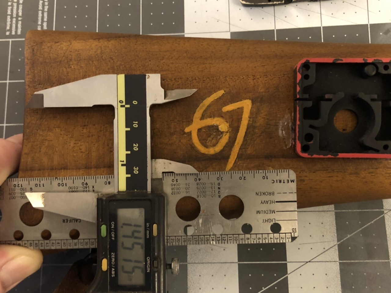

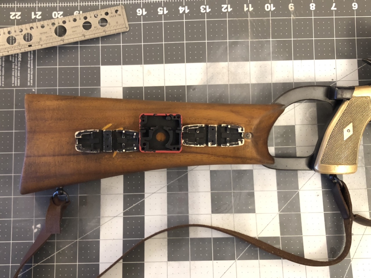

Thank you very much for sharing! One question though: what exactly are the two orange lines extending from the rear AM plug on the EE-3's right side? I'm working on an ESB replica now and while studying movie stills I actually noticed a blurred, orange, stringy-looking 'something' in the same area as where you've placed them - but thought I was just seeing things until running across your build.
Those are actually 2 numbers engraved on the stock (probably done by Bapty, a film armorer in the UK, who also rented lots of weapons for ANH and ESB) and might be 69 or 67.
Interesting! Thank you for clarifying! Am I seeing it clearly that it might even extend all the way to the middle of the center greeblie?

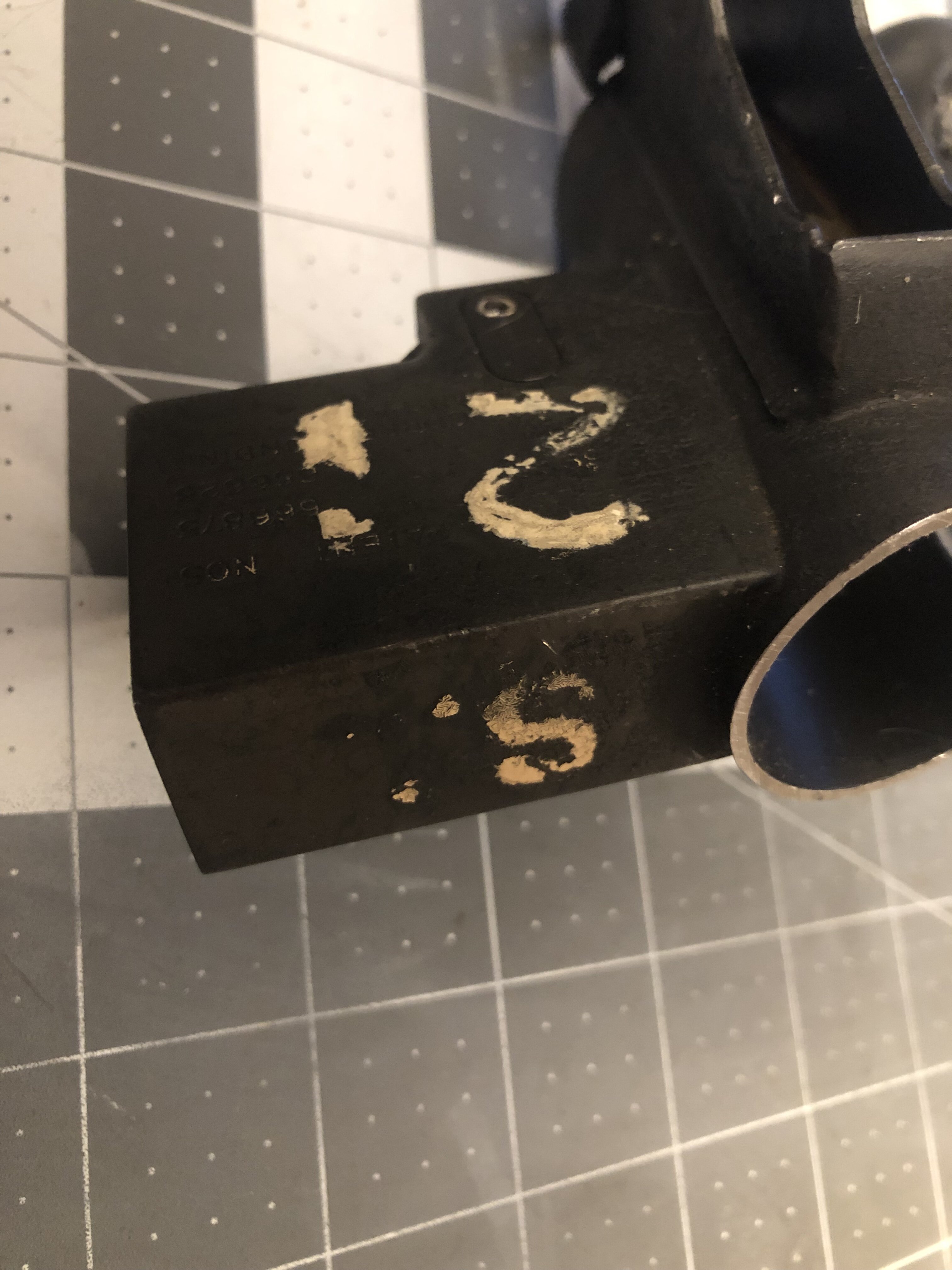

Regarding what I believe to be Armory Depot numbers, if they are indeed numbers (Initials is also a distinct possibility), they should actually be from the application of a thick ugly yellow paint, probably from a vintage style paint marking pen (wouldn’t be surprised if theres lead in it lol)
It’s possible they were applied by Bapty or the Film armorer but its more likely in my mind its a little older than that. Probably from its Military days in the 20’s-60’s I imagine before it finally ended up in the film house. There’s actually a little bit preserved on one of the ROTJ stunt casts of it along with the deep Webley&Scott stamp they were also trying to cover up with the greeblies. Whether the rest lifted off with the removal of the ESB greeblies or is just obscured by glue residue its hard to tell

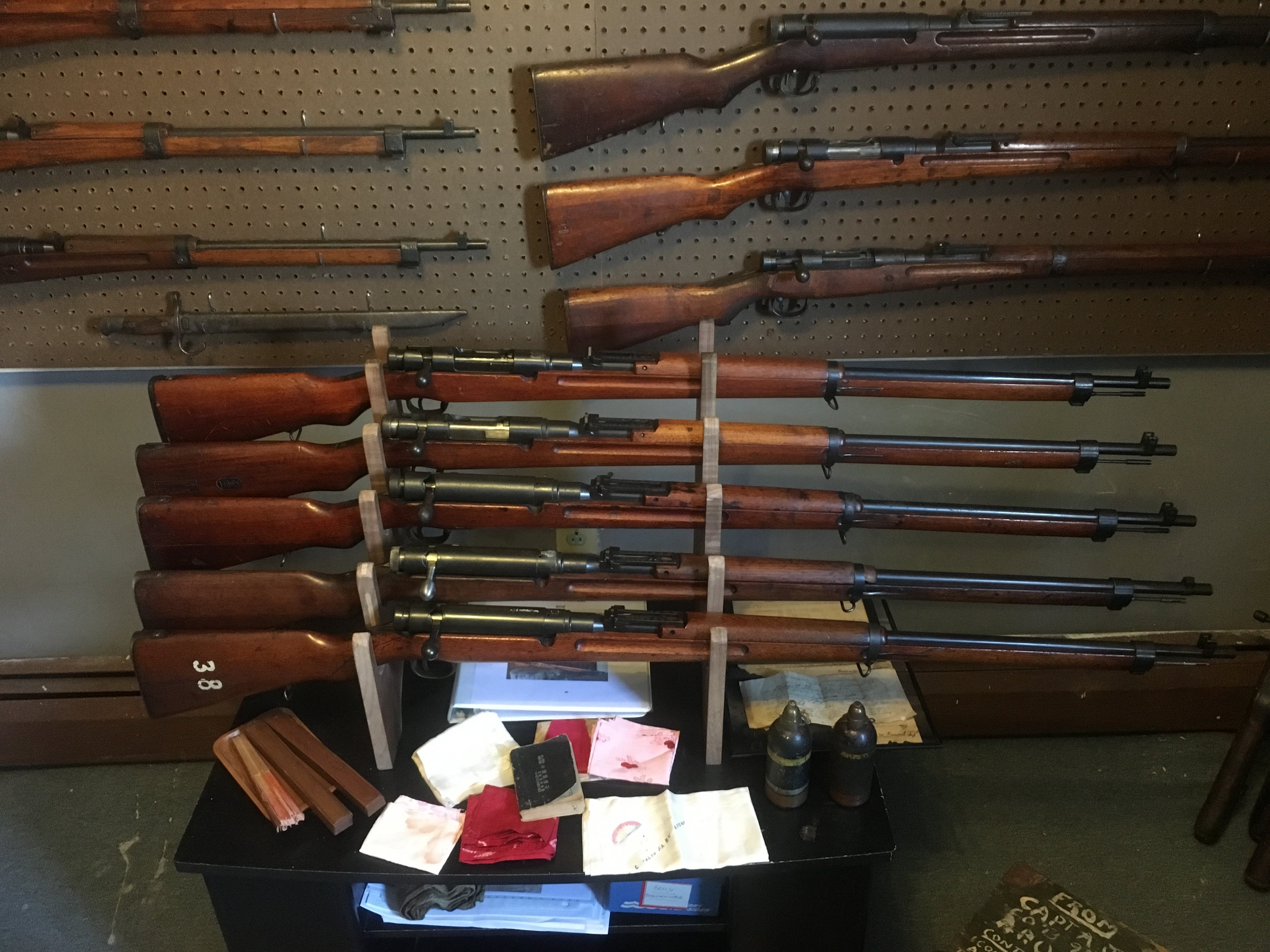

I collect a lot of vintage pew pew related stuff from the same era the Hero Webley lived in before its filming days, and come across these kinds of armory markings quite a bit. Usually its just a ugly plain white, blue or yellow marking color (although I have seen other colors used) as a means for the military units to easily account for all pieces they’re responsible for at the time that they are in possession of them; sometimes they're hand drawn, sometimes stenciled and sprayed.
Even one of my Sterling parts kits that im turning into a ANH foundpart build has some depot numbers crudely slapped on it hahaha.

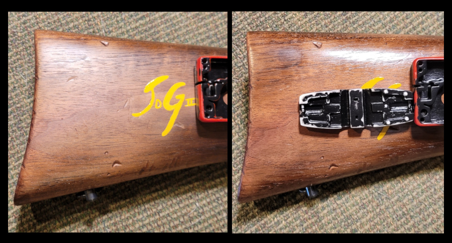

6FC95741-388E-473E-918E-D799927DB642.jpeg168E05CA-F662-46AF-807C-903A764E9257.jpeg1D61E519-702B-47E3-B51E-369D7CF3064F.jpeg
Very informative! Thank you all very much!! Now to add that to the build... =)
Yeah i had this little detail documented on my build page and on a tutorial for doing the missing chunk. Both are buried in the forum pages hahaha
I actually completely redid and reshaped my stock one more time after taking these photos, along with the “67”/“69”
This time I made it a lot more haphazardly “hand drawn” looking when doing it. I’ve still gotta 3d print a stamp for doing the Webley manufacturing marking as well, but I’ll probably redo these photo’s once more after I finish all that
Feel free to make a template of this if you guys like it! :)
*Helpful Tip* Id recommend drawing it in pencil first. That way the graphite acts as a barrier between the wood and paint in case you decide you aren’t happy with the placement or something. I keep redoing it because im a purist POS :lol:
While I found (and used; Thank you for that!!) the missing chunk tutorial, I unfortunately didn't find the details within your build thread but will certainly check that out before doing any more work to mine!
I so would've done that if I hadn't already painted mine. After hearing that there was no definitive answer for exactly what's there, I decided to make it into my initials. =)
