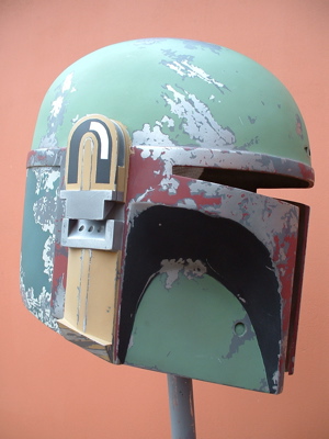

Heres the right ear with first the grey over silver masked areas, then re-masking and then Humbrol no.94 air brushed on. This colour has come out quite light, but it should tone down with the correct amount of weathering... Now to start masking for the rear...!

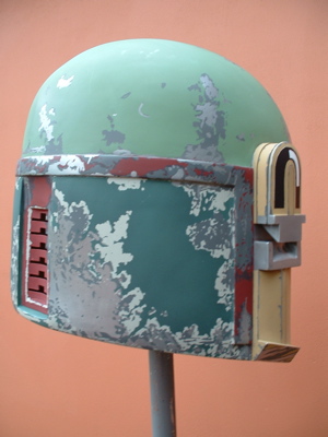

Apologies if you're getting tired of these pics, but i'm nearly done:)
The back did go a bit random in places, but overall the scheme seams to work. The only problem was with the light blue which i could not work into the masking scheme, it was just to difficult .This may have to be applied topically....

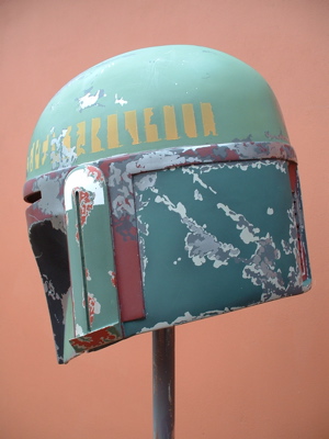

Thanks for the comments, the colours on the back were again humbrol grey no. 79 ( In retrospect this colour is a shade too dark) over the grey went no.23 ( this is too blue, i should have mixed in a smidge of 103, a creamy colour) the light blue would have probably gone on next, but it seemed like too much work! The final green i'm pleaed with and was no.76 and 96 with a smidge more green than blue. With the mask still on i darkened the green with black and ran around the colours perimeter....

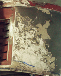

Light Blue color???
Spideyfett said:
Light Blue color???
I suppose its almost duck egg blue, appears in random small areas all over the helmet and would have gone on before the base grey, making it the first colour onto the silver. Or is it just me?:)
I'll see if I can pull a pic ...

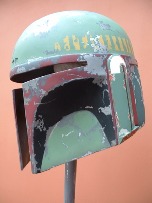

Thats the helmet painted.(apart from the symbols) All the markings were hand masked to get that slightly wobbly feel( i definately achieved that!) with some non intentional bleed on the kill stripes (oh well) I will now re-buff all exposed alu. to polish it and this will also knock back colour contrast before weathering is applied (i hope)...
Spideyfett said:
Light Blue color???
I see what he is talking about, I think some folks see that to be a sandy type color. Its left a bit unclear on the RS color list. I like the color you used TF, without seeing the bucket in person its hard to say what that color is.

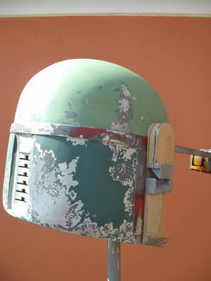

Here is a color corrected pic of the back. (as much as could be corrected)
I would venture to say that I feel it is an egg shell color but more of a tan then a blue.
Just looking at the picture on the right Evan, its the colour within the silver, not around it i'm having trouble with, is this what you're referring to? I 'm seeing this as "bluish" still:)
