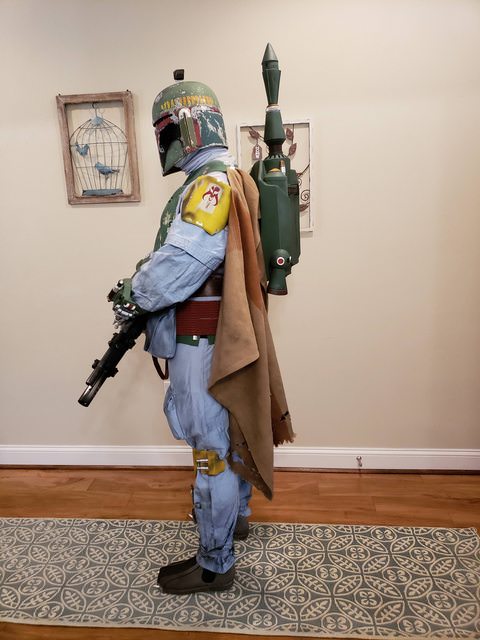

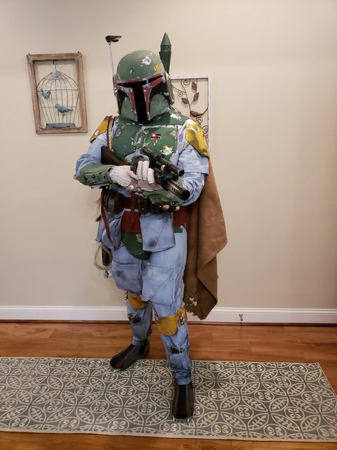

Keep up the good work and like stated above, don't get too discouraged. When I submitted mine, I also had the same issue with the black straps for the girth belt. I sent a bunch of pics of it attached, unattached with the black straps I used, and some that were sized more movie accurate, showing that there was no way I could squeeze my fat behind in it that way. My GML made an exception in this case, because aside from losing 40 lbs, there was literally nothing else I could do. I wish you luck with the same.
Things are looking nice. Sorry you didn’t get approved first try but that’s not uncommon so no discouragement. Couple things I’ll add that haven’t been talked about much, if you are having issues with the MOW cape I highly recommend the woodman cape. It’s smaller and I actually favor the look over MOW due to the fabric but that’s a preference thing. I have both capes and the MOW is too long while the woodman is perfect.

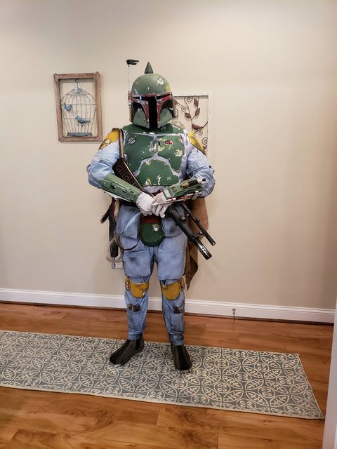

Your chest plates might look a little nicer if you clean up the lines there. Push the plates together a little more and make sure all the gaps are either exact equal distance or match reference photos where the armor actually touches. I’ll include a photo. It really tightens up the chest and makes things look nicer. Otherwise you are a breath away and Fett is never done anyway. Adjustments for life. :)
I have screwed around with those chest plates so much! Haha. I feel like I can never get them lined up right no matter what I do. Since I did the pin back method, they are pretty easy to move. I plan on doing some "comfort work" this weekend and I may have to add moving those around again to the docket.
I did pin back as well and boy and am I glad. I moved my chest plates so many times. Once I got it perfect though I haven’t had to touch it since bar fooling with the chest lights.

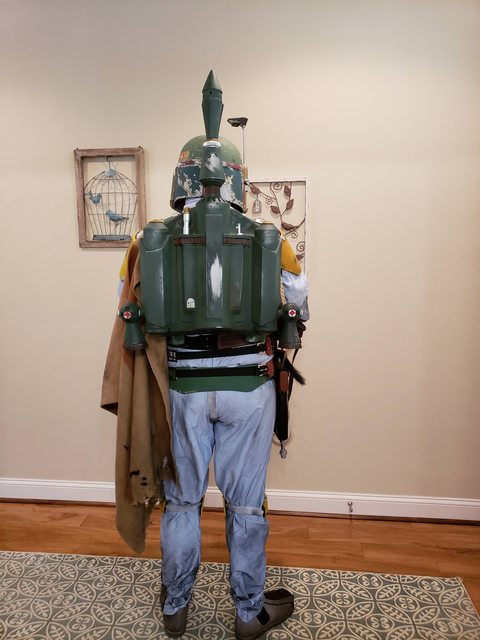

8. I need to take steel wool to my jetpack and tone down the darkness of the green. It is currently too dark to be approved but I think the steel wool should work its magic. Should more or less match the gauntlets and helmet and be lighter than the armor.
9. The vertical crack on my helmet shows up too much, I'm just going to get rid of the silver on it entirely and paint the whole thing black
10. I need to adjust my collar plate location, since where it is it's pressed up against my neck and makes the studs too low on my shoulder, my cape too low, and my back plate visible. It's caused by the jetpack harness straps tugging on the backplate just enough to cause a sag, so I'm going to move my collar plate down to account for the slight sag.

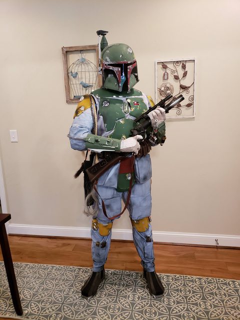

Is your cod and kidney armor not connected in those photos? Looks like on your left side under the girth belt there is a gap.
Yep, not connected. Normally the girth belt goes over it so you can't see it, it was riding a little high in that picture. I got RKD armor that only have the flashing cut off, but it still wasn't long enough to go around my fat self. So my ROTJ Fett buddy told me to connect them with elastic, that's what he did. If I get down to the weight I want to be at they should overlap, but there is about a 2 inch gap on either side.
Ah ok. I was wondering how it was staying up being unconnected. Your suit looks really good though it just always comes down to the little details. Good luck with the approval!
True that. Yeah the elastic is a really good solution and really easy to do. Since the girth belt really should be covering it it shouldn't be an issue for approval, but if I had a nickel for every time I thought that... :p
