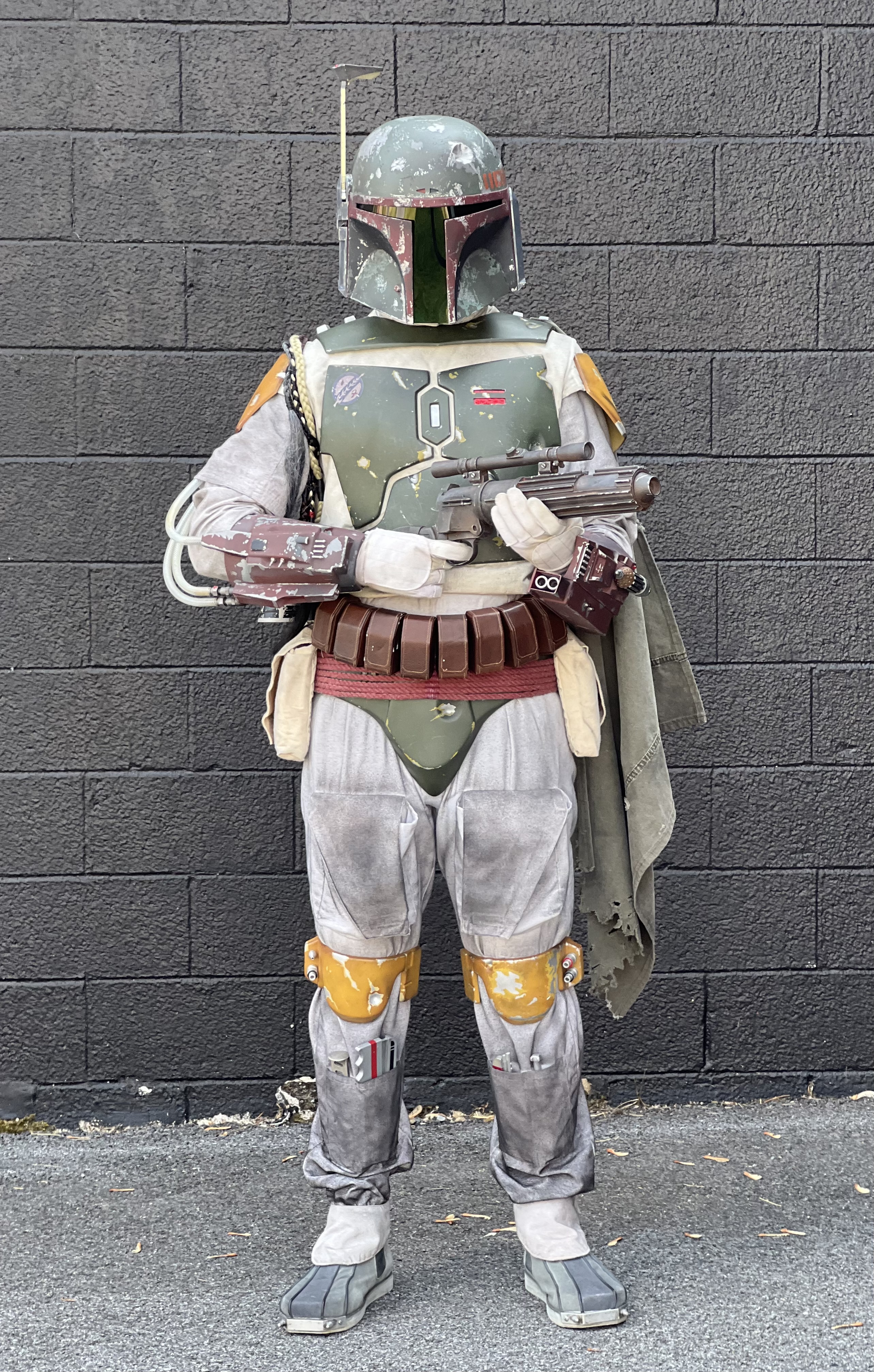

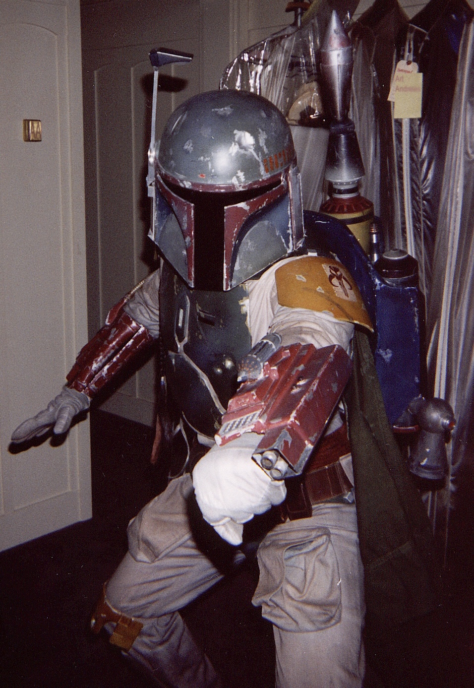

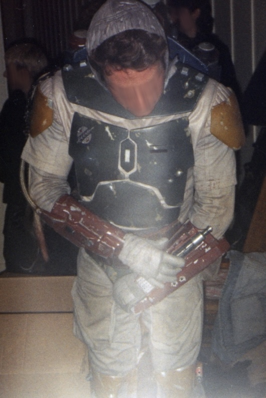

Here are the reference photos I was looking at:
ROTJ SE
ANH SE:

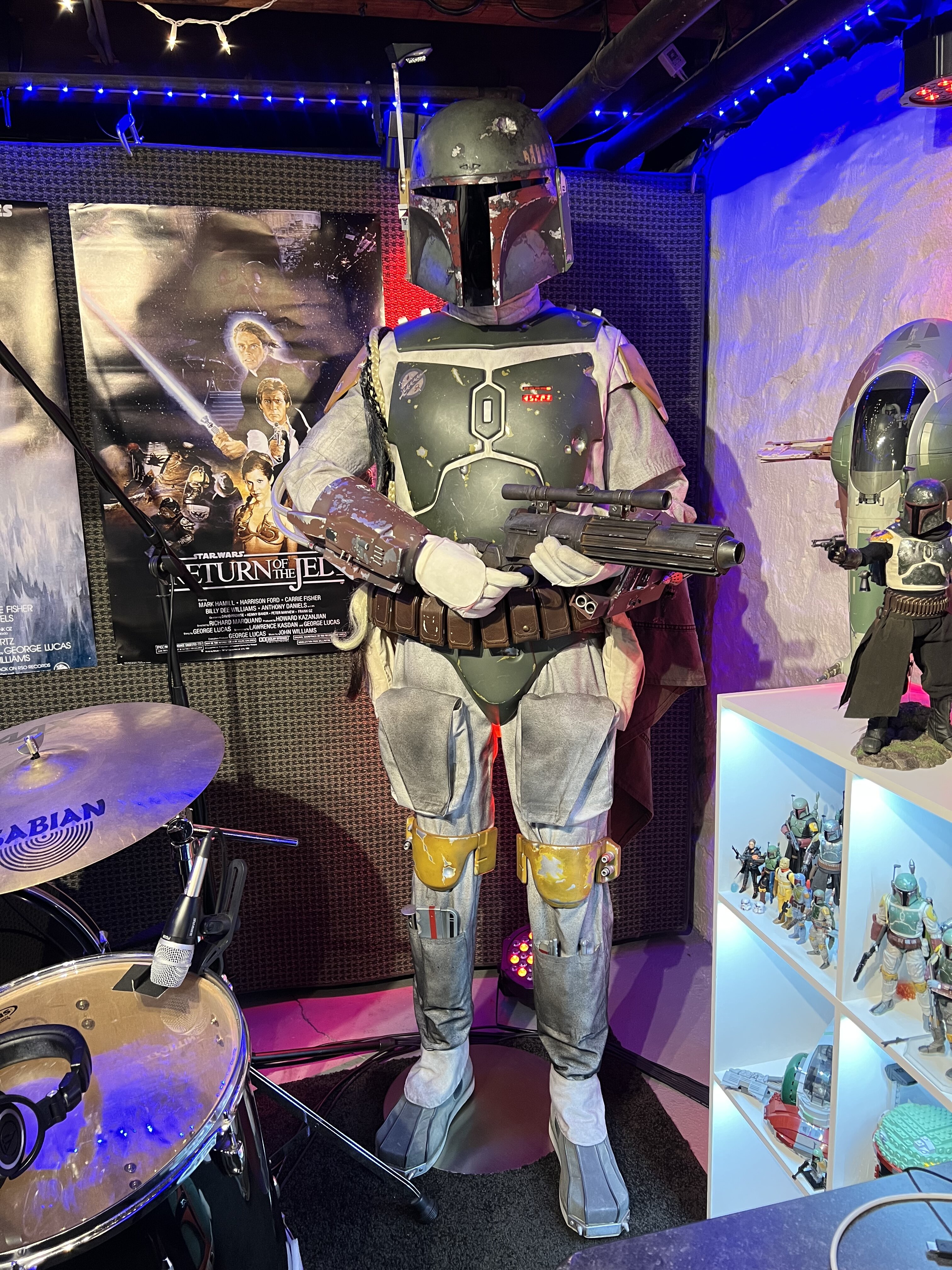

And here’s my costume currently (ignore the EFX bucket stand-in)
