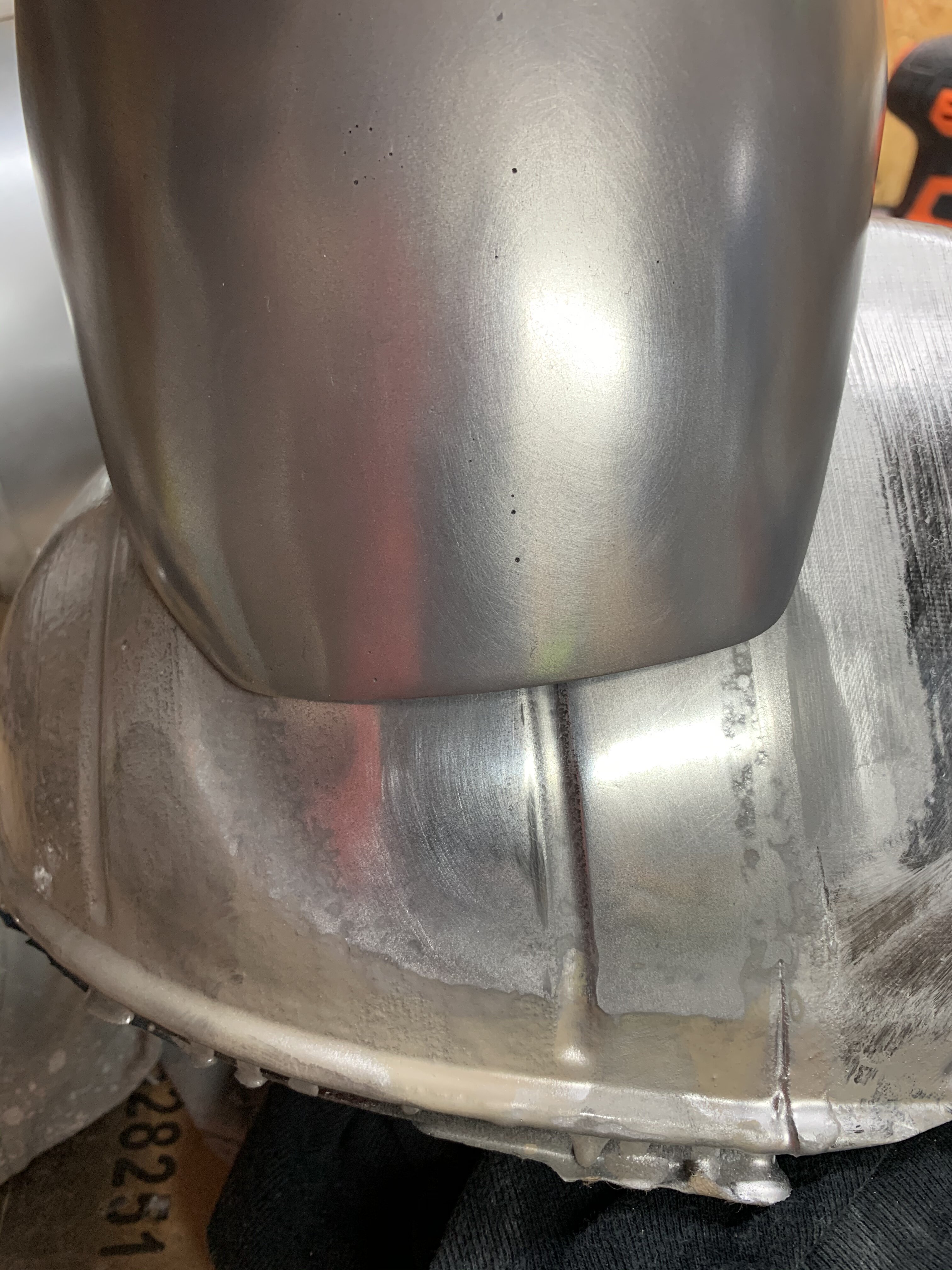

On the first picture is comparison of a real coldcast and my brush on trial. Second is a detailed picture. What I have learned already is to sand by hand. Otherwise your thru the coat to fast

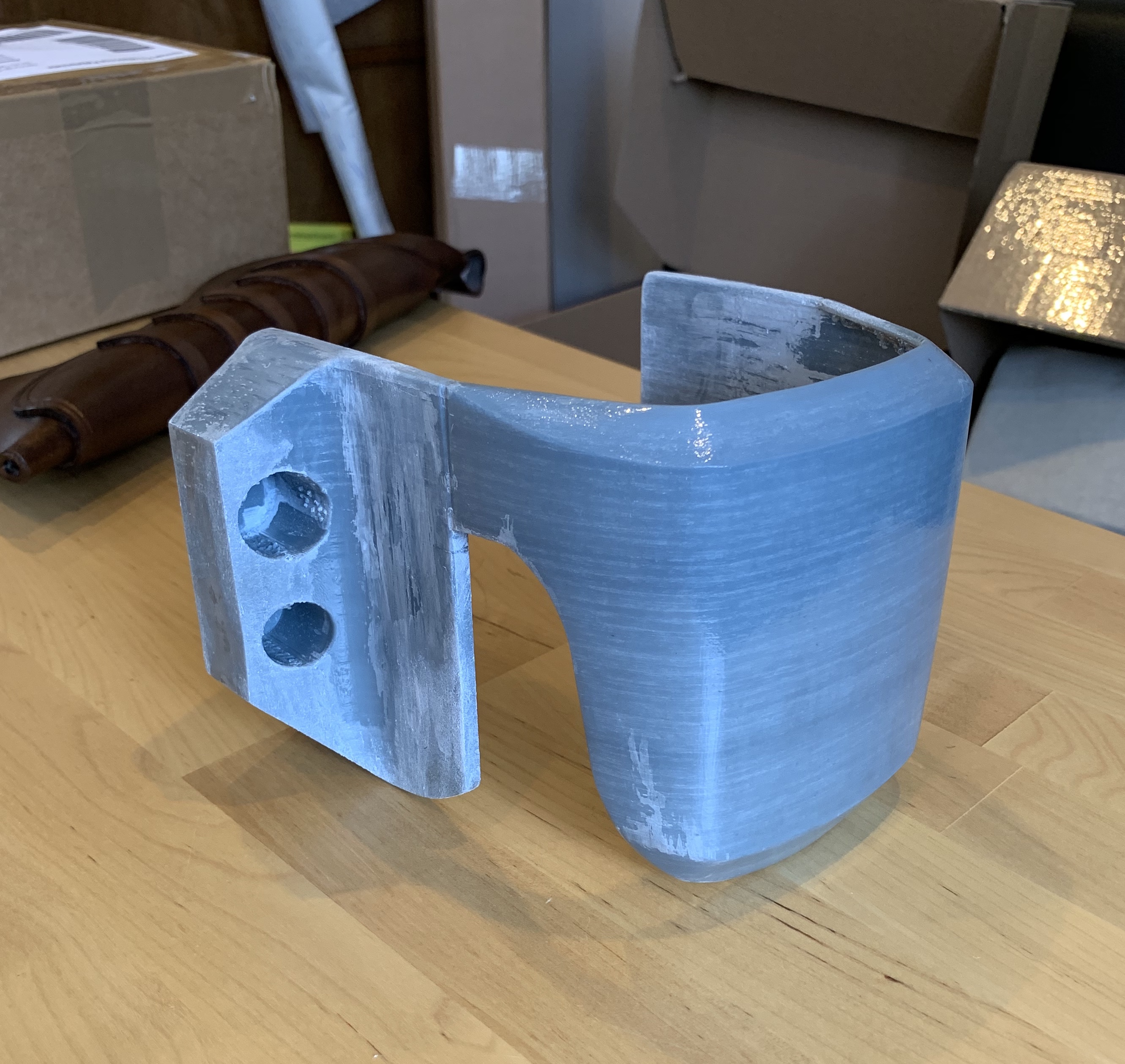

First trial of my selfdesigned Jango knee. It needs some mods to be more accurate. Also I need some epoxy with higher viscosity as my aluminum powder drifts away to much. Well the result is not to bad but also not good. I think the trash bin will be happy with it ;-).
Made some little modifications on my knee model. Printed it in ABS and brushed it with Acetone to enhance layer adhesion. Next steps are sanding to final shape and coat it with epoxy-aluminum mixture.

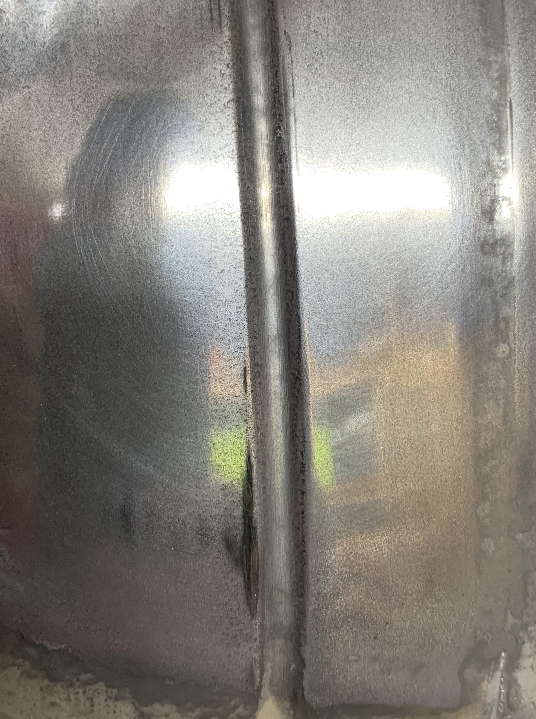

Interesting „issue“ that happen to me. As I usually brush my ABS prints with acetone to enhance layer adhesion it happend that I got some aluminum powder to freshly brush area. After letting it dry i sanded it and saw that it looks like real aluminum. So I decided to do a little test and brush everything properly with acetone and aluminum powder. When it was dry I sanded with 600 grid and buffed it a bit. On the picture you can see the result. I am really impressed as its very close to real aluminum and cold cast.
Looking Good!! Using the aluminium powder warrants more research. I wonder if you could get a better result
if you dipped it in acetone and dipped it in a tray of aluminum powder immediately afterward?
