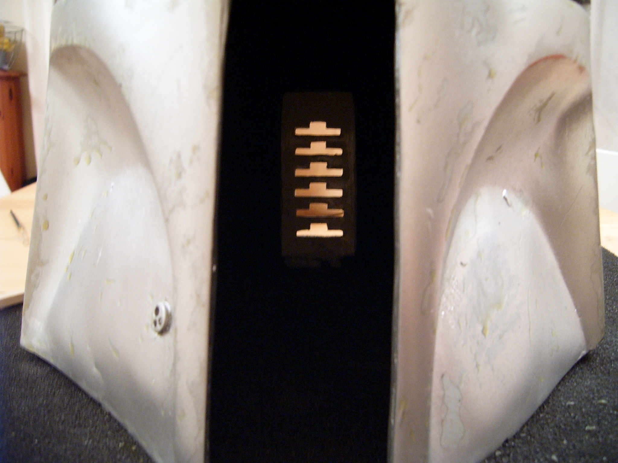

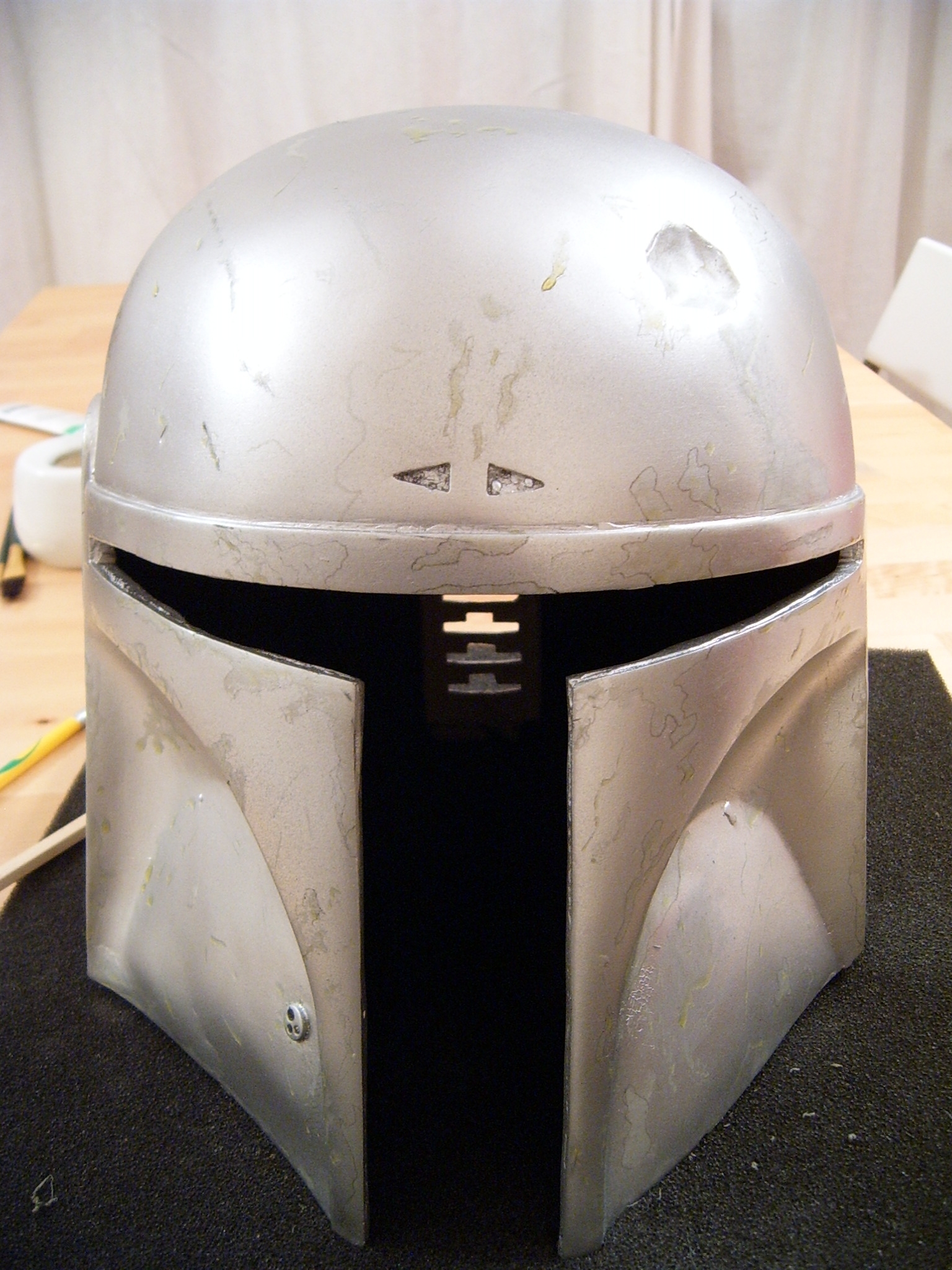

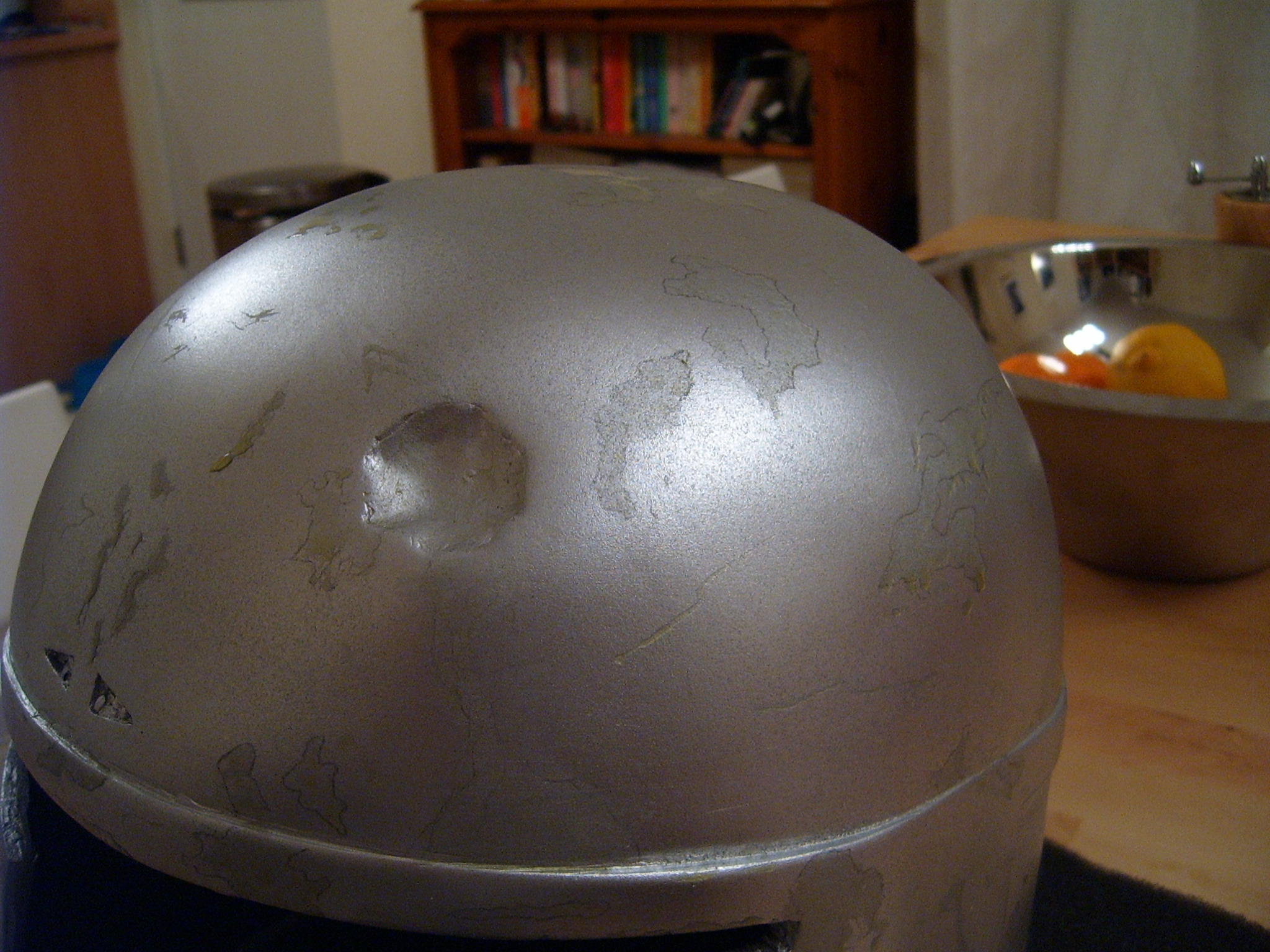

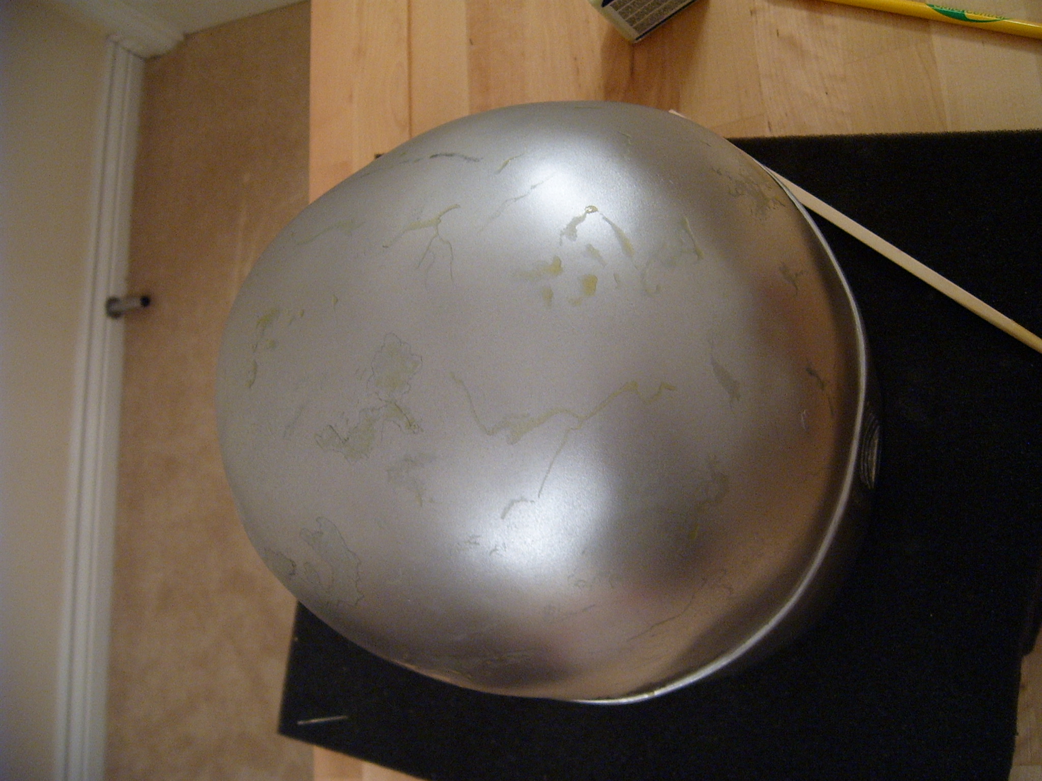

As I have been inspired by many of you to make my own helmet instead of buying one I thought I would start a thread and show how things are coming on. I’m lucky enough to have a couple of helmets (thanks to mmgraphics and fettprop). I’m starting out with a PP2 to see how I get on as I have never done anything like this before and it seems helmet is no where near as intricate as the ESB one. I'll tackle an ESB one later on down the line with the other lid.
I’m going for the layered paint job and I have gave the whole helmet a spray of aluminum silver
I did use brushes to put on the masking fluid however found that the brush became pretty clogged up (how do you avoid this?). I carried on using it as it gave some good shapes when applying damage to larger areas. I also used a needle to mask off some of the smaller scratches and a chop stick that I shaped at the end to assist in applying the masking fluid.
Air brushes, what is the best? the compressed air tins or am i better investing in a small compressor? (the cheeper the better) tried getting one on e-bay but the buggers keep outbidding me
Any suggestions etc greatly appreciated.

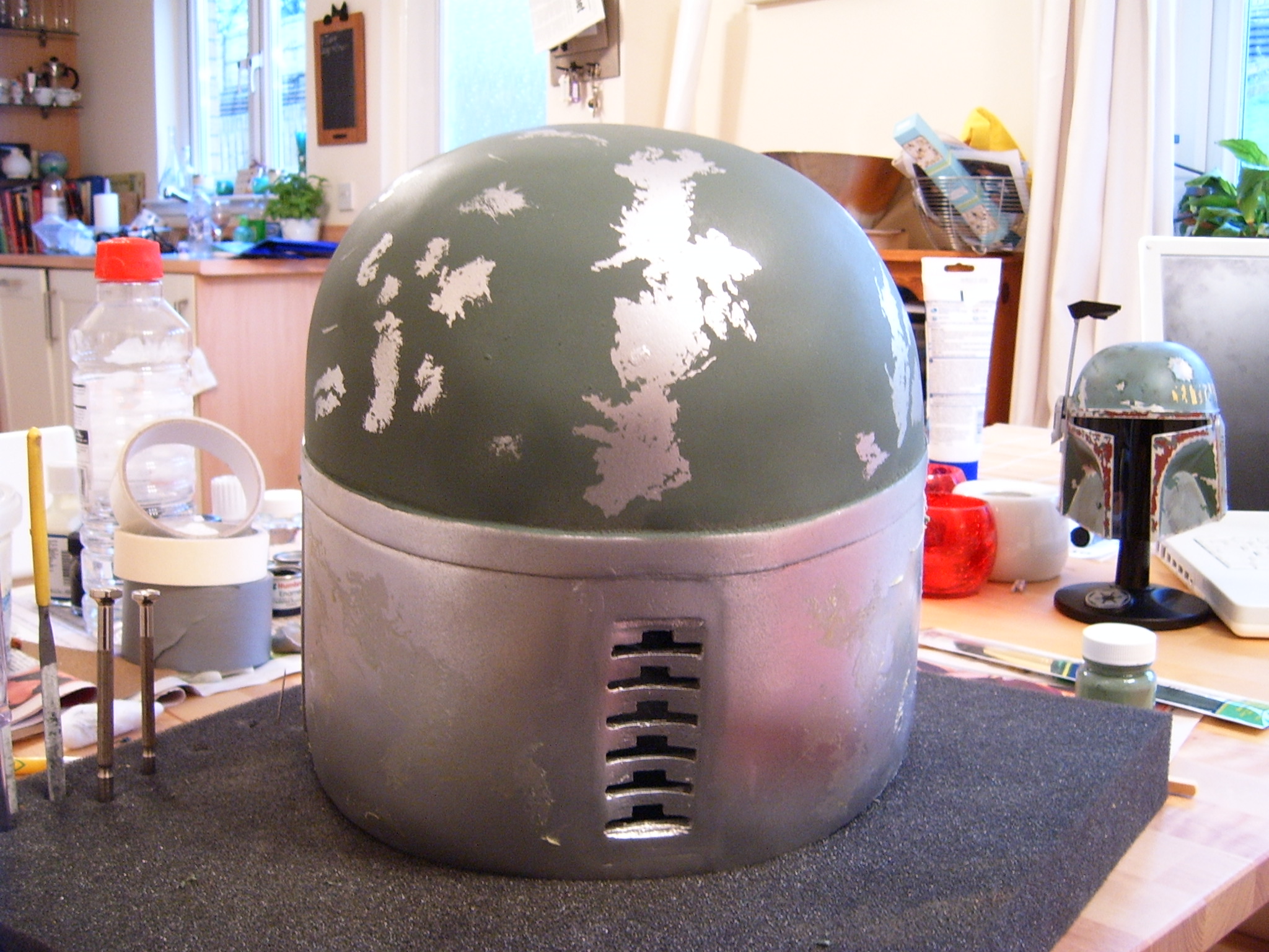

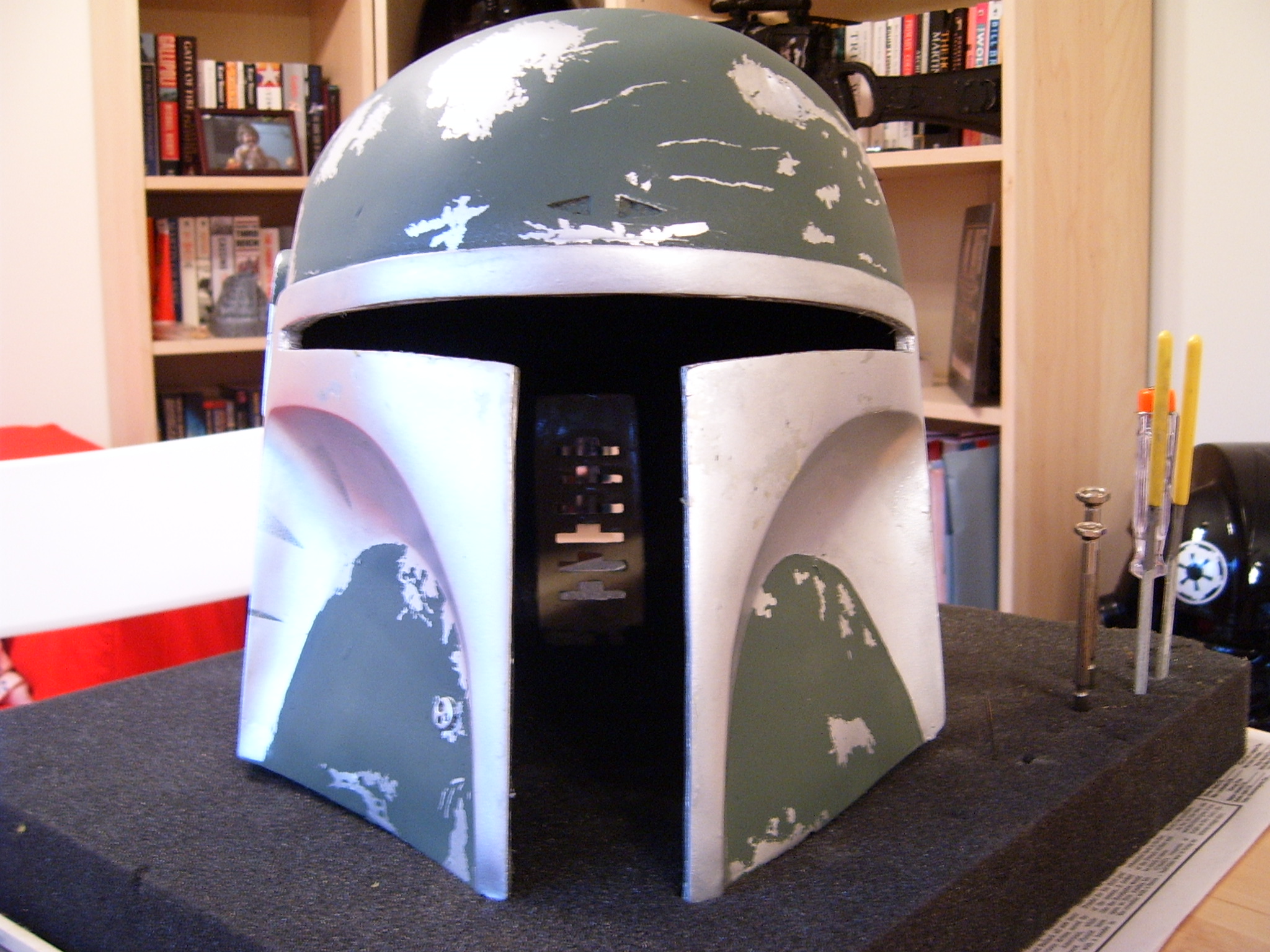

Update
Had some spare time to carry out some work on the lid. This is my first go and im having a bast at a PP2 style of helmet as i think it appears easier to paint, something to hone some skills on.
I have just painted the dome and the lower jaw. Looking for some advice on achieving the grey arround some of the scratches on the dome (is this done topical) and washed out red on the mandibles. Predatormv did an awesome paint job on his and im using this as reference.
Thanks
