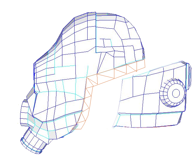

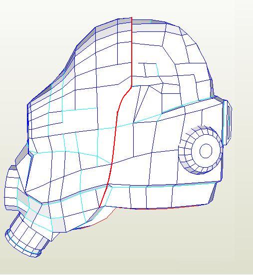

I was wondering where i should cut this helmet so that i could then clip it back together when its on my head. Similar to some storm tropper helmets and vaders helmet.
<a target='_blank' title='ImageShack - Image And Video Hosting' href='http://img707.imageshack.us/i/helmetport.jpg/'><img src='http://img707.imageshack.us/img707/8813/helmetport.jpg' border='0'/></a>
id cut it where the rear plate is, similarly as stated above, and then I would extend the remaining portion down an inch so that the rear can 'fasten to it (technically over it).
If it were me, I would break it into two pieces, and add a lip as shown in orange. Then after putting the mask on.I would slide the back around.
