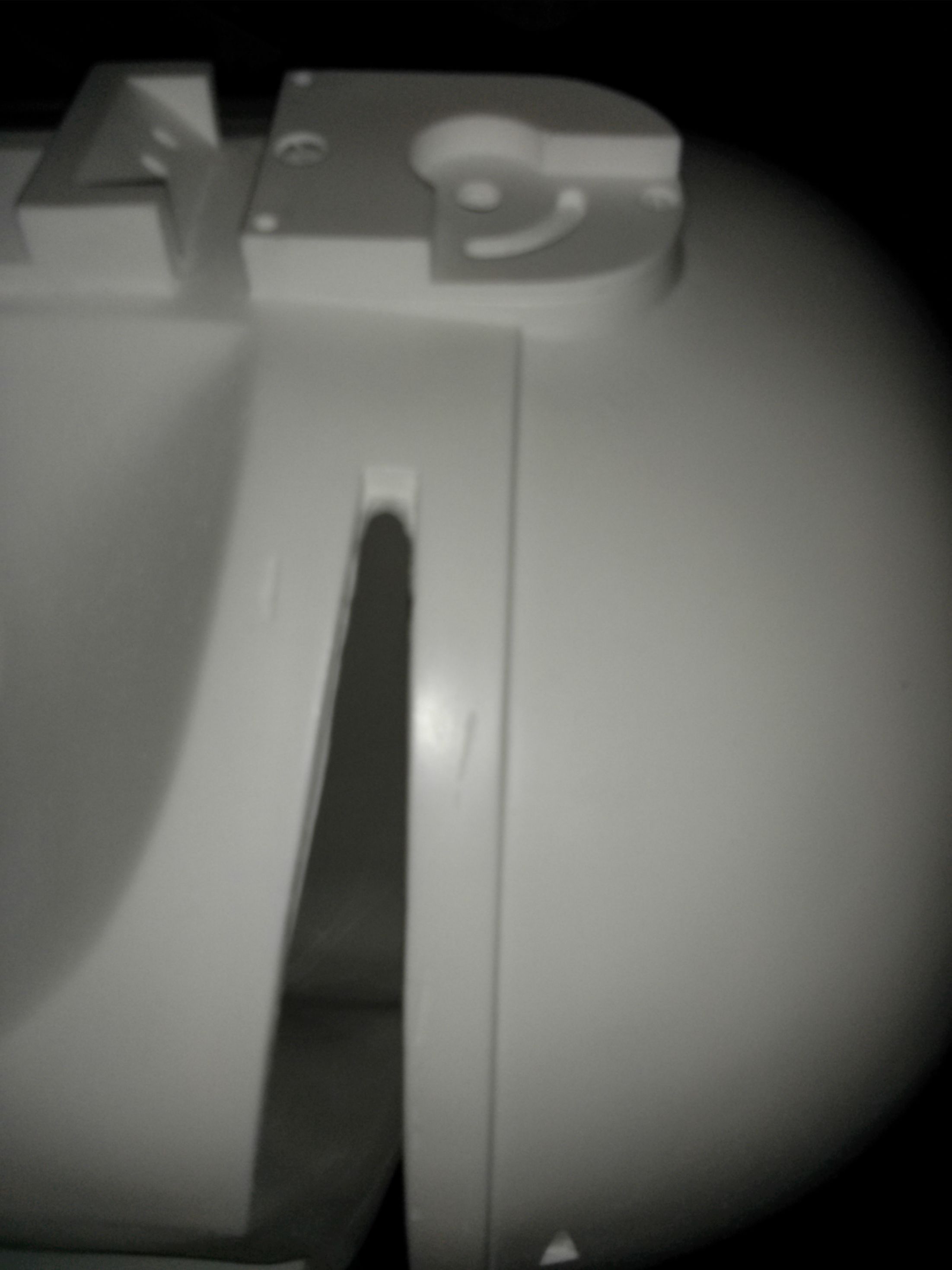

F frb13 Active Hunter Apr 29, 2014 #2 A small file. I got some from napa parts in the bin with the cheap tools.
AFettFullofDollars Well-Known Hunter Apr 29, 2014 #3 I have a small flat file that I fold sandpaper around. You can usually find them at any hobby store.
superjedi Sr Hunter Apr 29, 2014 #4 I have a set of jewelers files that I use to get into tight corners like these.
Matty Matt Active Hunter Apr 30, 2014 #6 Yeah, a small flat file is what you need. If that's not an option, get something flat and square like a paint stick and wrap sandpaper around it.
TheCafeRacer New Hunter Apr 30, 2014 #7 Awesome. Just got one today. Working like a charm. Thanks guys
TrevOwnz New Hunter May 8, 2014 #8 I used a dremel to get most of it and to refine the edge I took something the size of a credit card but 4 or 5 thick and wrapped it in sand paper. This way I had a solid flat edge of sand paper. Worked well for me.
