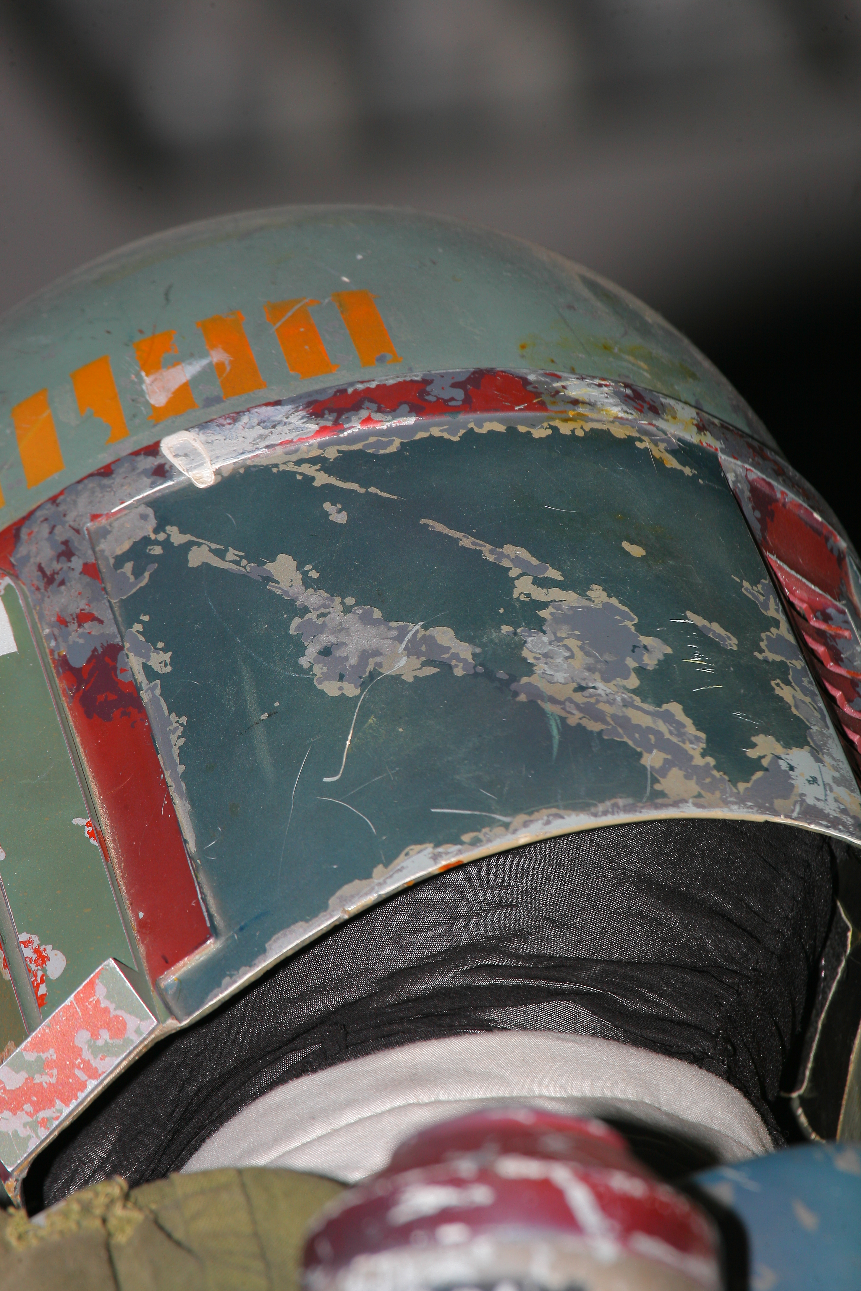

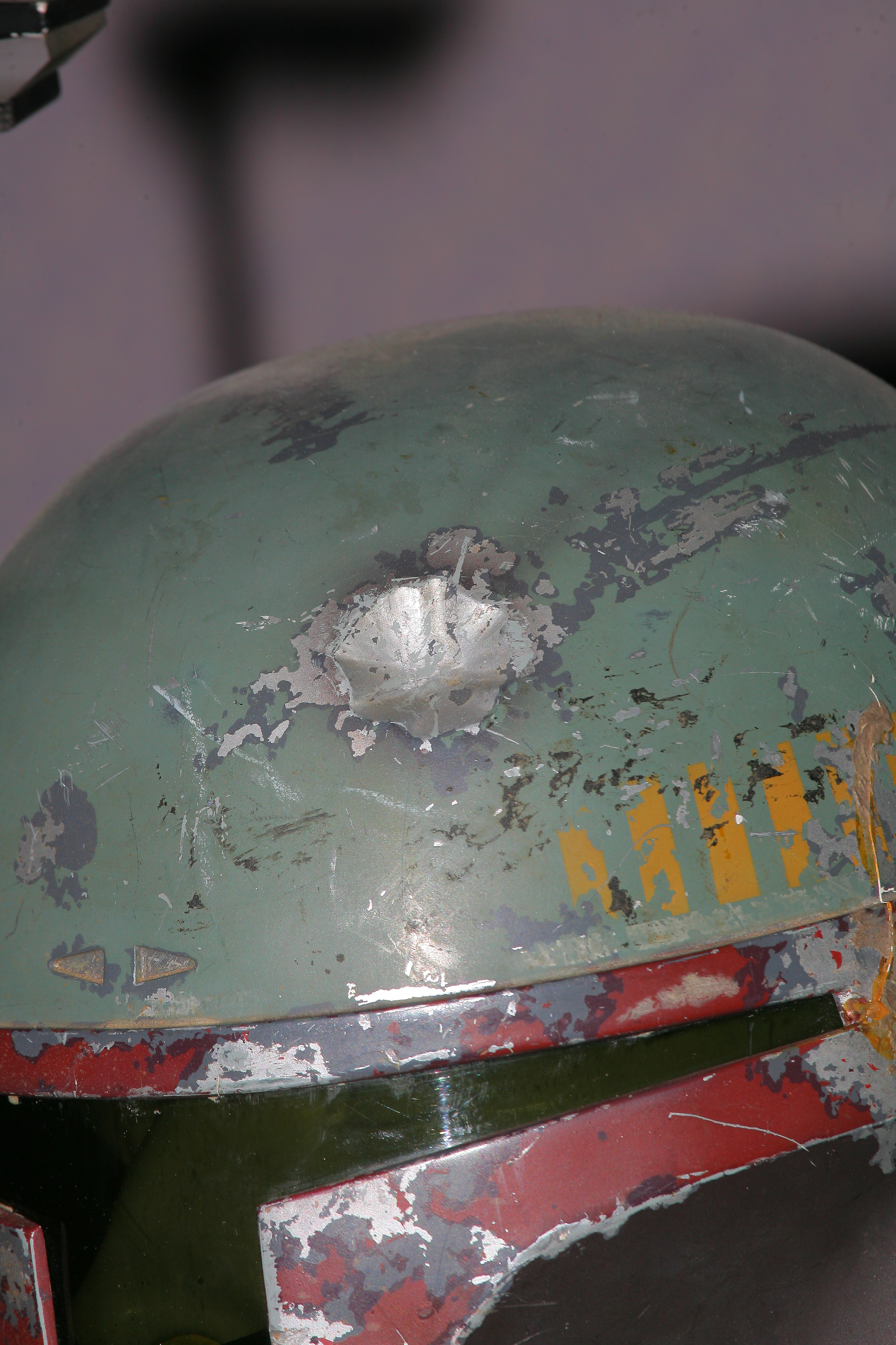

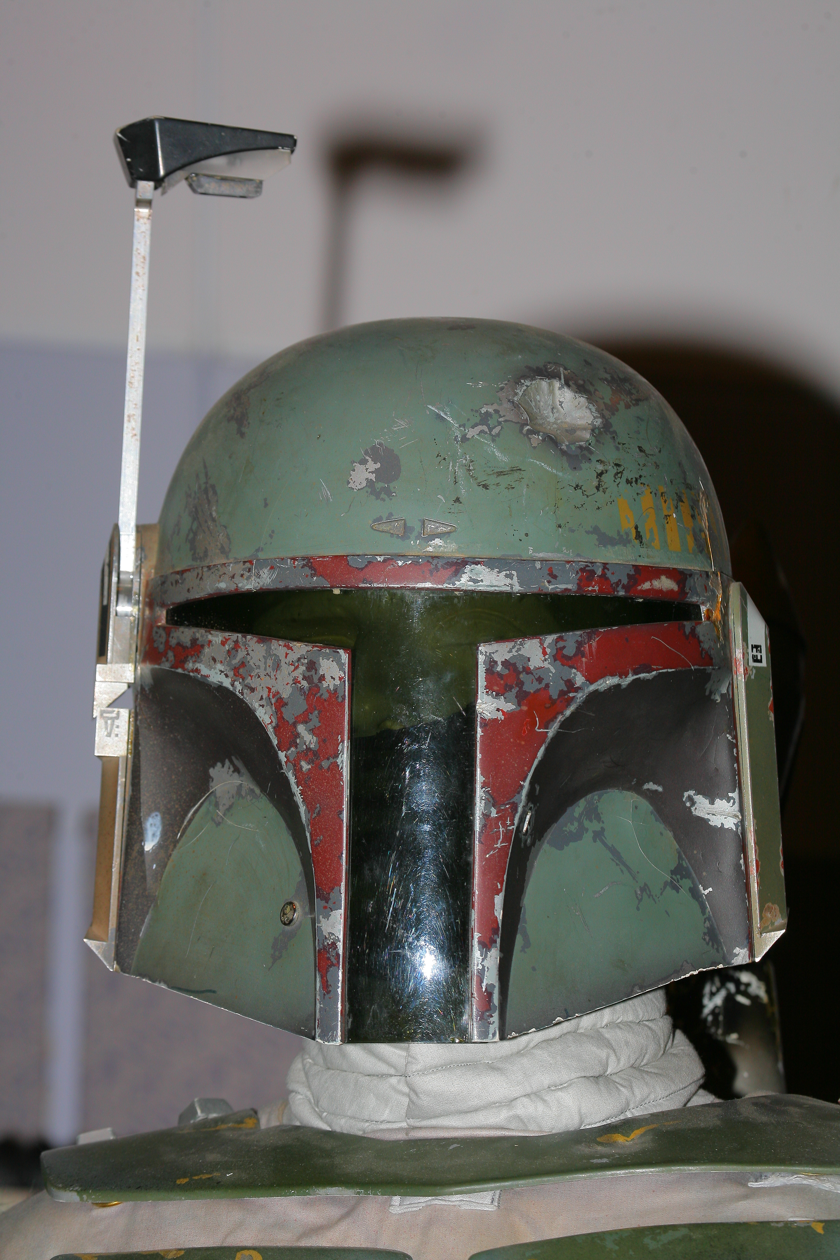

I'm no expert on painting, but here we go...
The layered areas are noticeable by the inconsistent, shapeless contour, while the topical areas have a more pronounced, rounded shape and sometimes you can see the end of the brush line (mainly visible on the lower cheeks and the back panels).
On the dome the silver and the killstripes are layered, the rest looks topical (it's the same on the lower cheeks). On the red areas the silver and the dark gray are layered, while the dark red is topical. The blue-gray colored areas you see inside the silver are accidental peelings and are the actual primer:
The back panels looks to be more topical than layered, which is mainly the silver:
On the upper cheeks the silver is layered, while the dark gray looks both types:
How can you tell??? Please teach me your ways! (Thank you for your time here btw)

And of course there are lots of touched-up areas. Some of them are present around the killstripe or on the red areas: these were silver areas that were corrected with green or red.
