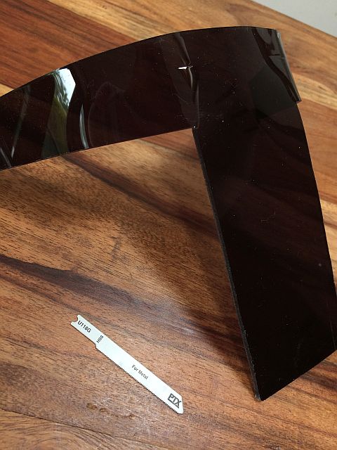

Pleased to say I bought some Grey Smoked Acrylic from Trent Plastics and, cutting with a fine-toothed jigsaw blade intended for metal (I couldn't find an acrylic-suited blade with a U-Shank) was able to cut it quickly and cleanly. Gentle heating with a heat gun bent it into shape, no problem...
Thanks everyone for the advice -really appreciated!
