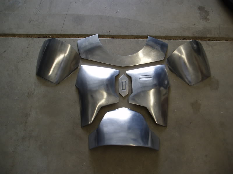

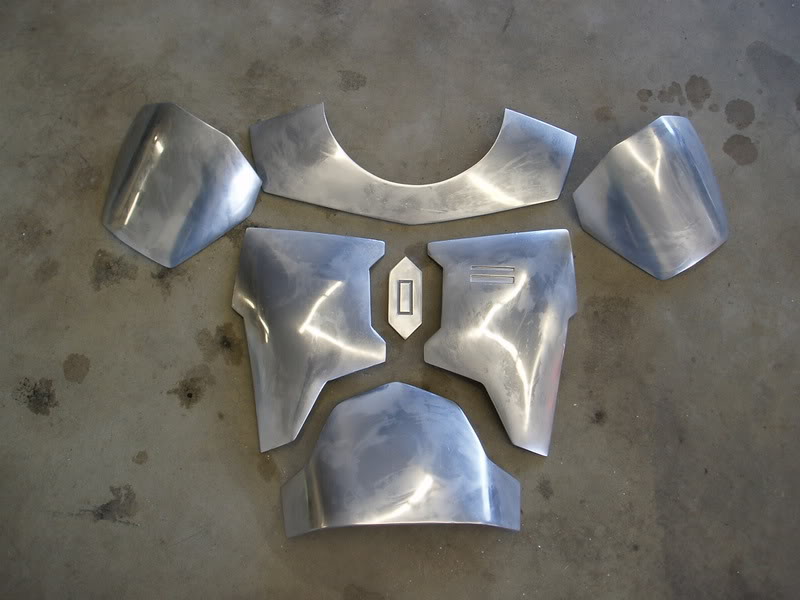

Alright, I thought I did it right. I wet sanded the armor. Used Dupont automotive primer, waited overnight, wet sanded again. Looked & felt really smooth. Hit it with R&B and some parts got shiny and others wouldn't turn out. I almost burned my hand I put so much friction on it. I tried it again and it looks like it gets dull around the edges as it's rubbed on. Any ideas on an even application process??
AFTER: Using Jimmybuffet's t-shirt suggestion. About 20 min of serious rubbing on each piece. Kept changing the rub spot on the t-shirt to keep it clean. THANKS JIMMYBUFFET!!!!!!

Definitely not a problem with the armor. I'm doing something in the application process. Too much, too little, not even , haven't figured it out yet.:facepalm

Thanks to everyone. Used Jimmybuffet's t-shirt rubbing method. Worked well, I just rubbed harder and much longer on the R&B that was already applied. Should've skipped the gym today, that is quite the workout :lol:
I kept moving the t-shirt to a clean spot. If the silver built up on it, it tended to leave streaks from the silver already on the shirt. Turned out much much better.:thumbsup: :thumbsup:
