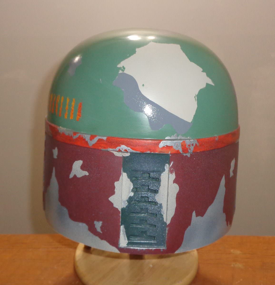

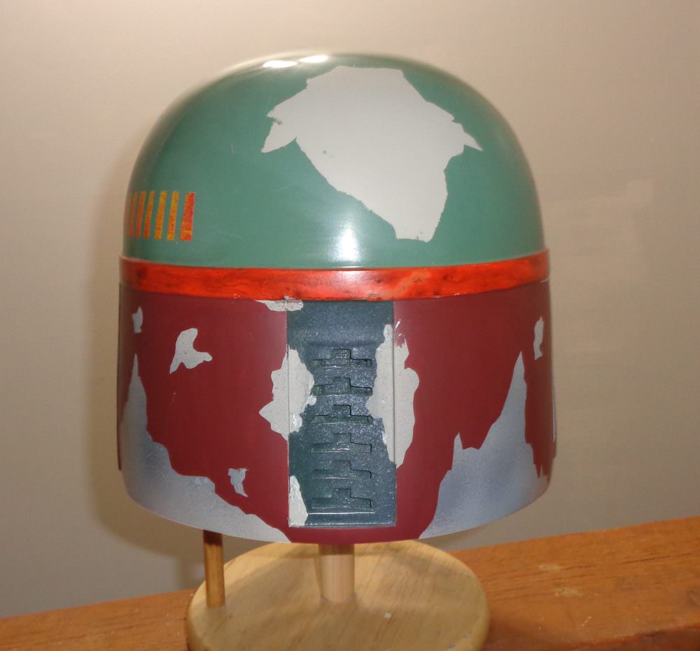

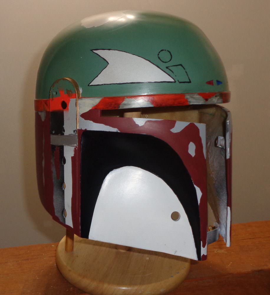

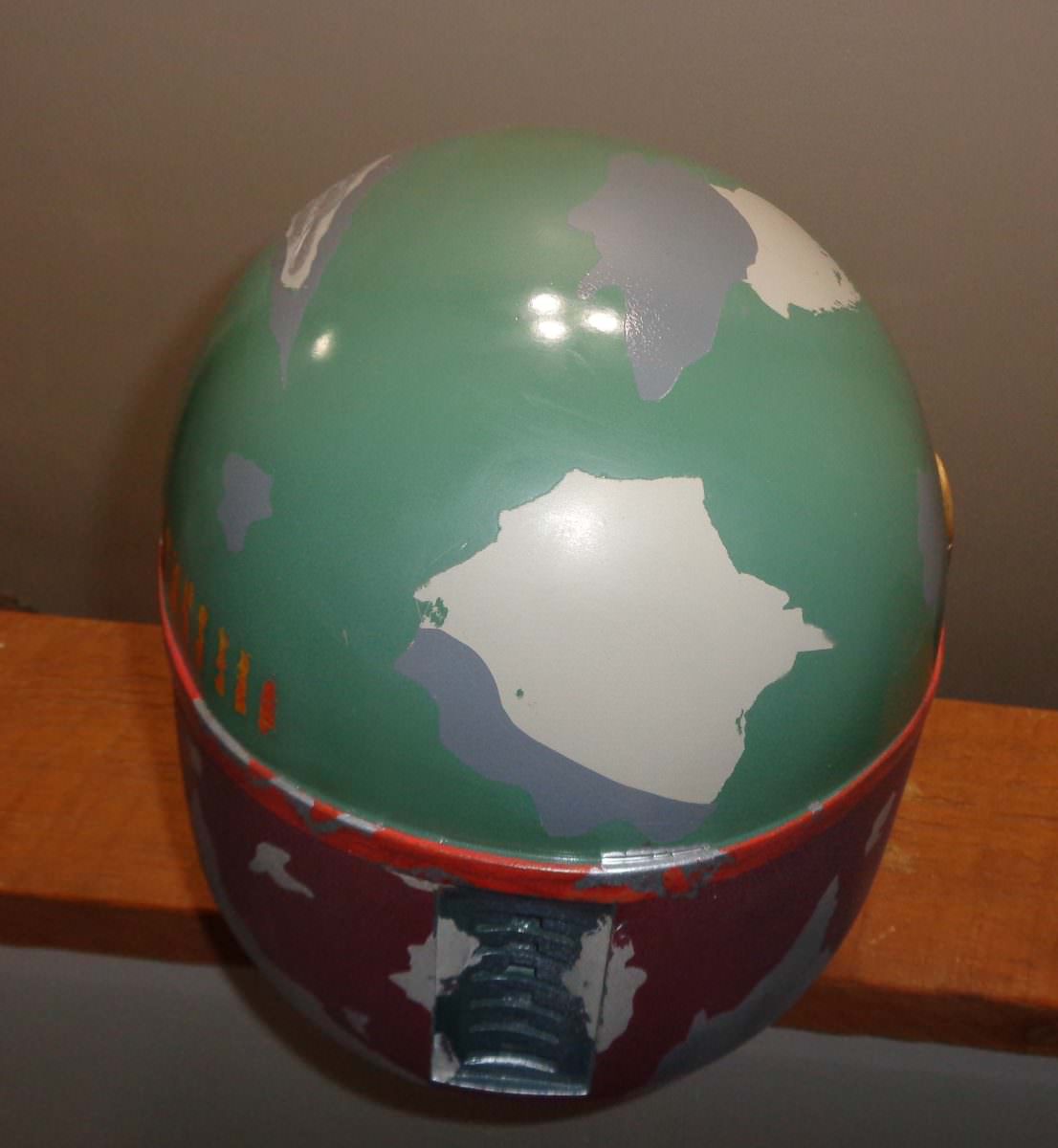

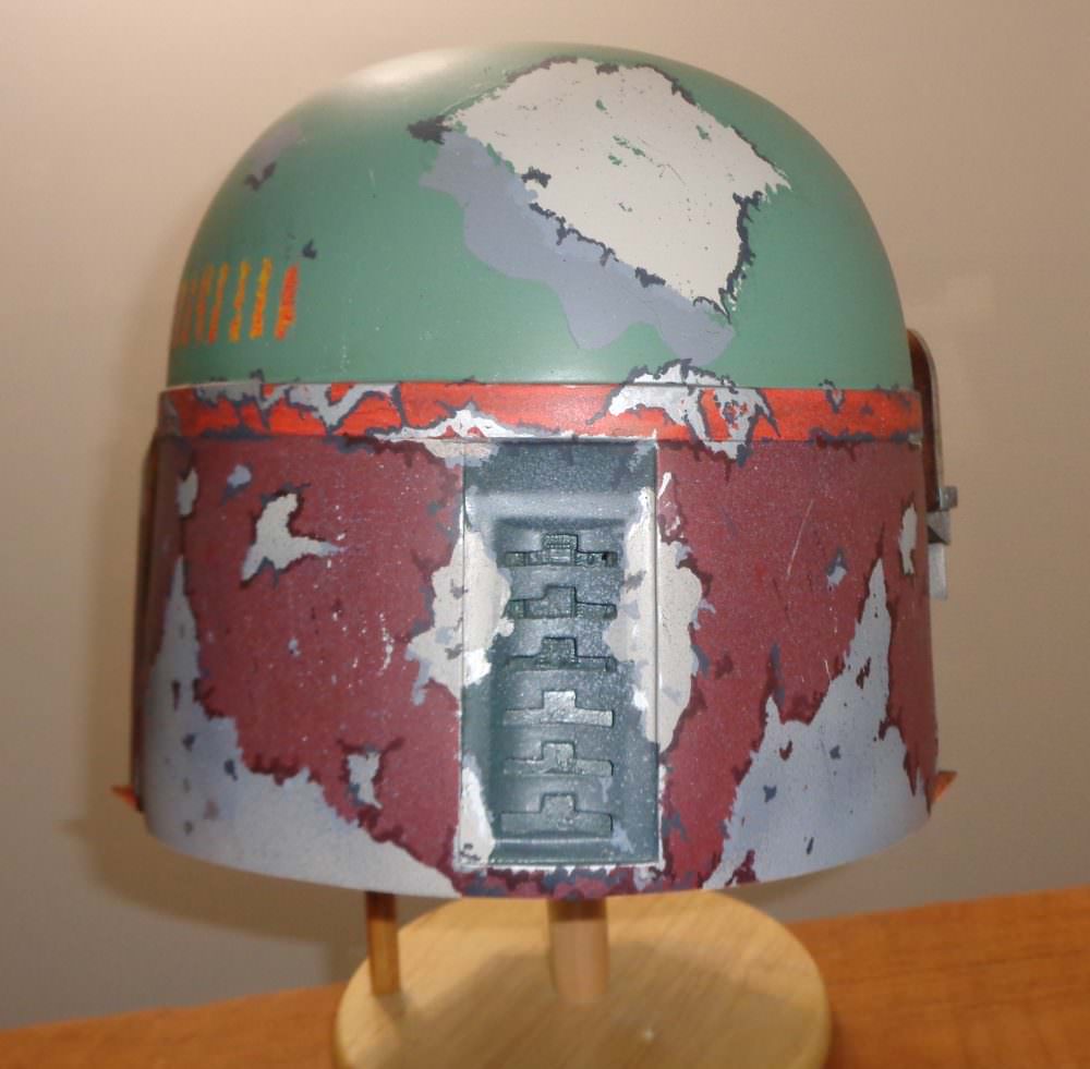

I'm trying to upgrade my helmet from the scratchbuilt one I made a couple of years ago to a nice new GMH in time for the Star Wars premiere next month. Originally, I was going to do the layered method but I've not left myself much time to do it so I was wondering what are the benefits to doing a layered approach? Obviously the paint is all through an airbrush so it reduces the risk of brush strokes but my topically painted scratchbuild doesn't show any brushstrokes either. There's the question of accuracy as well I guess but the same steps could be taken to mask off the damage and a brush tends to provide finer detail anyway. At this rate, topical seems to be a quicker method for very little disadvantages.

Topical isn't really any faster IMO more precise for sure....and if you do it right you cant tell its topical. Super Jedi does a really nice job with topical paint application. I have used his method and it works really well. Mind you it may not come out just the way you want but if you follow along SJ's ways you should do pretty well....theres still air brushing the main colors so the dome green isn't hand brushed on. It still takes a few weeks to do a layered job.

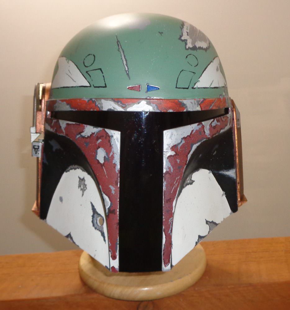

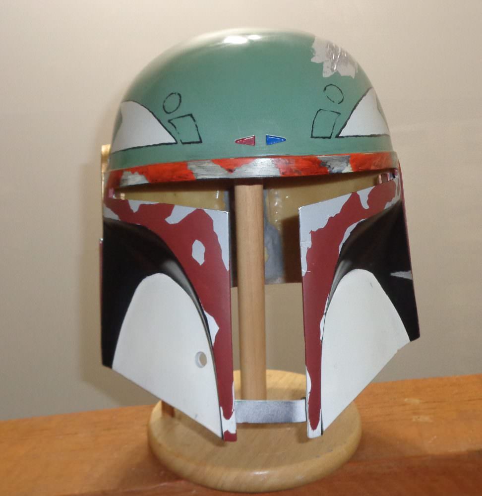

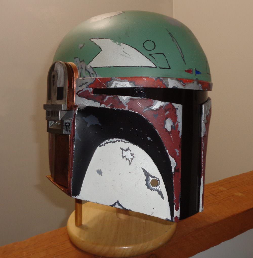

I painted mine topical, I've got more control over a paint brush than airbrush, so it worked better for me. Dom/Fett 4 Real gives solid advice. I drew each stencil on tracing paper, lined up each section and transferred it that way. took longer, but everything lined up where I wanted it. I too followed Super Jedi 's painting threads.

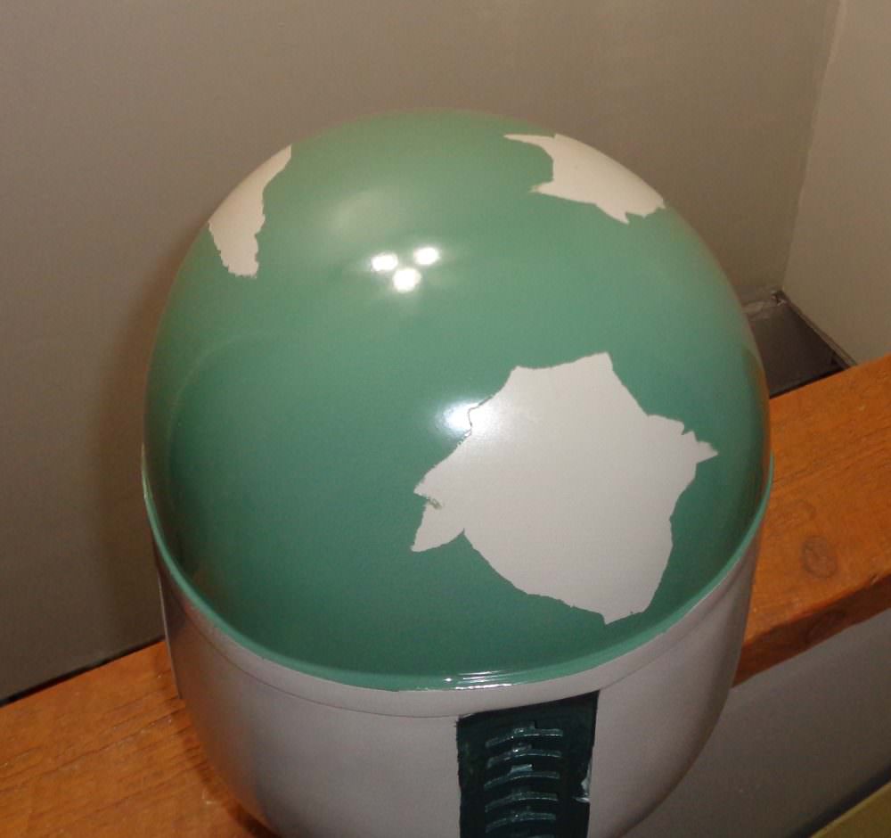

I did a combination of topical and layered on mine. Worked great and cut a lot of time down. For example on the dome I put down the gray then masking fluid then the green then painted on the silver with a brush. Of course the other parts were similar but more colors but still hand painted the silver last. I just found it quicker.
