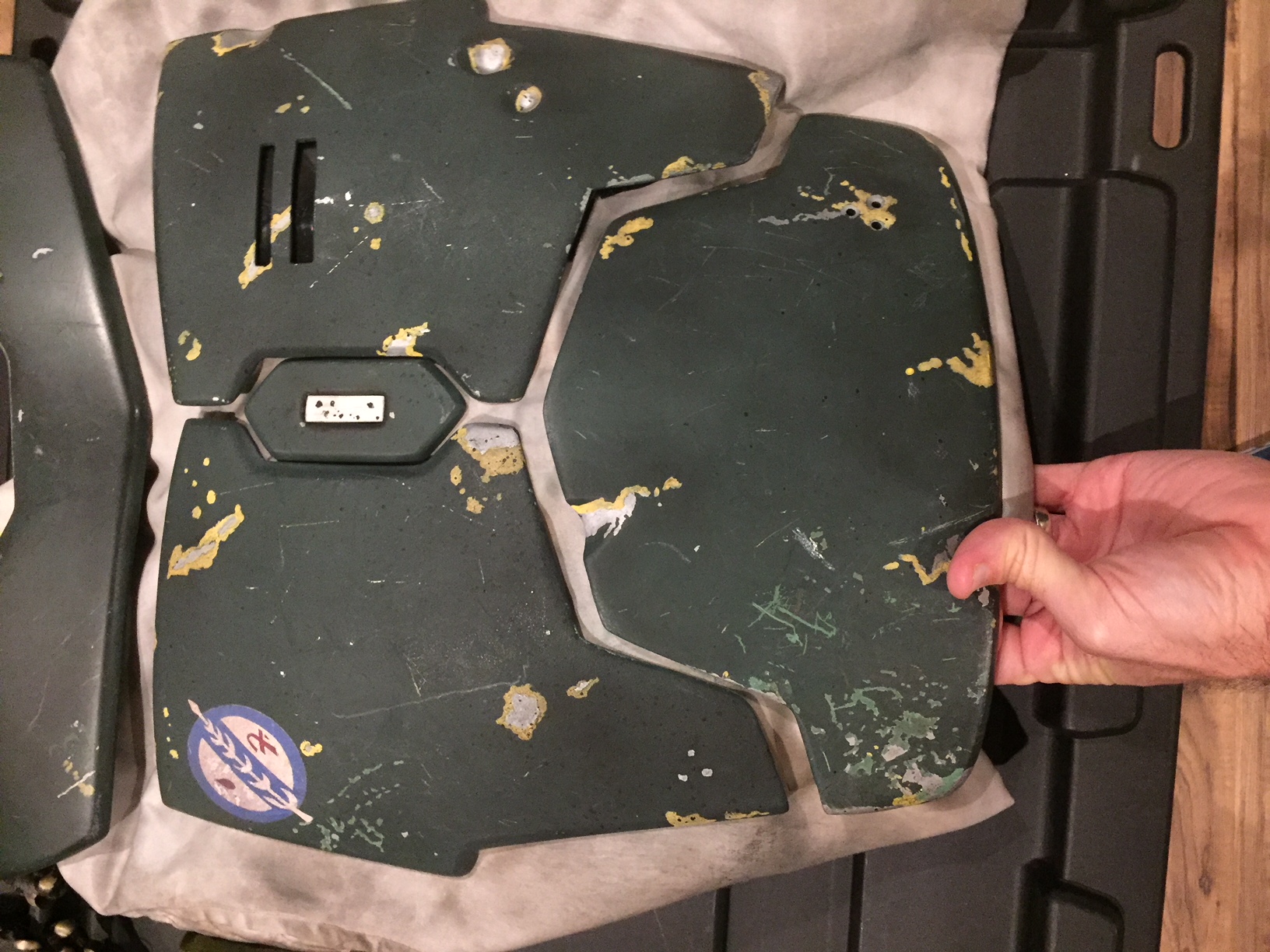

Therefore, I was wondering if I could get second opinions on this armor? I realize there are pieces missing and that the soft parts are too large. The kit is one I am considering purchasing from a fellow garrison member. It has been approved twice in the garrison, but the last time was 2016. I have some concerns about it but wanted to get additional feedback from more qualified eyes. Namely on the gauntlets and jetpack. I am only looking for basic approval criteria for now. Thank you all in advance.

Front (Close-Up)
Back (Close-Up)
Right Side
Left Side
Gauntlets
Front

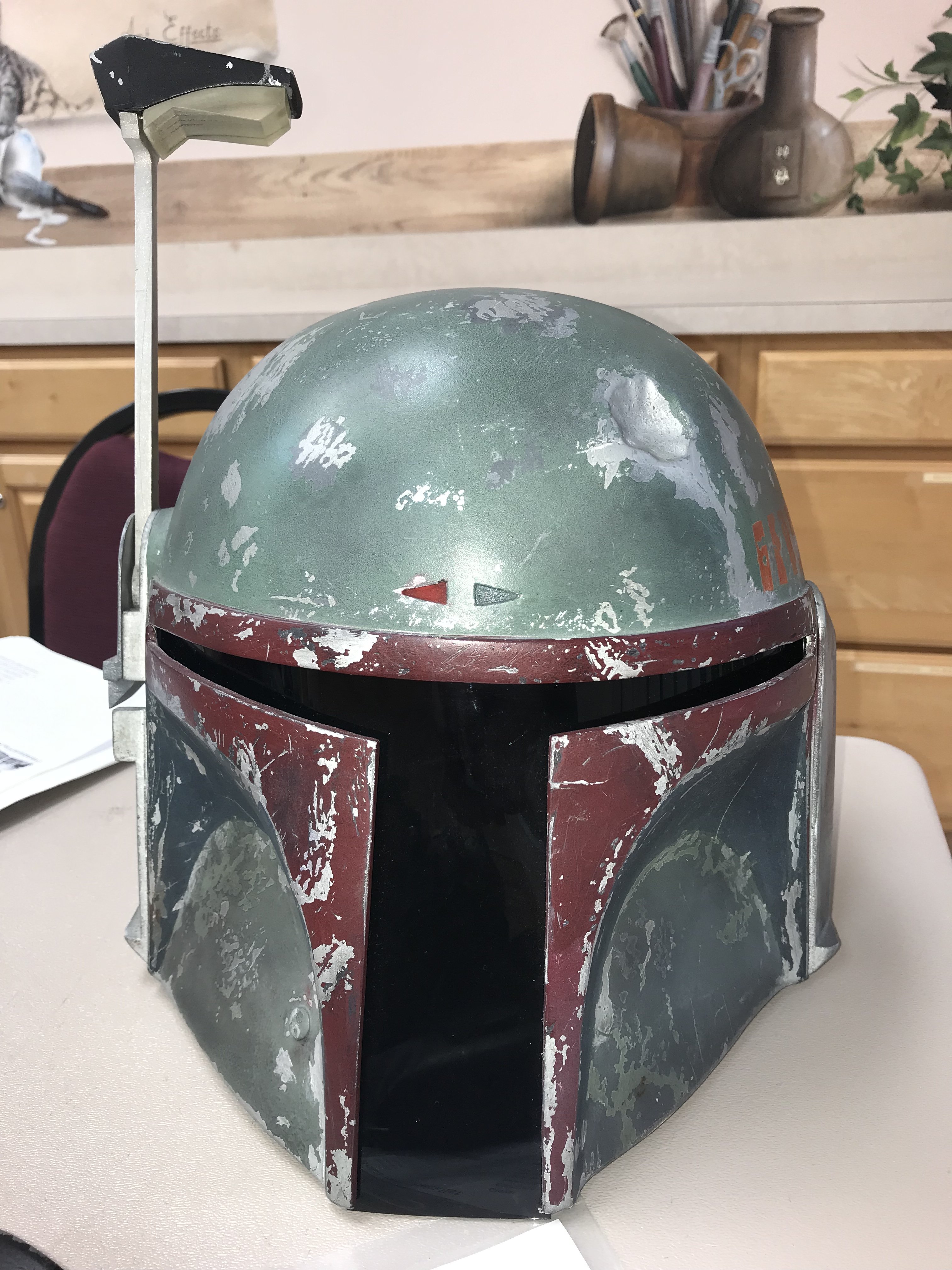

Everything looks okay to me other than the overall shape of the helmet, it's very wide and the visor portion looks squished vertically. The paint job is decent, other than having a very metallic sheen to it, I've known some helmets have been denied clearance for this issue but as you stated it's been approved twice before I guess it depends on the GML.
Get new soft parts, and in my opinion, a better shaped/fitting helmet and you'd be good to go.
Thanks for the input! I do appreciate it. I’ve yet to hear anything said about the shape of the helmet in the other places I have been collecting feedback, but I can see what you mean— especially in reference to the visor.
The helmet would be deal breaker for me. I’d have no interest in purchasing it if it’s going to prevent basic approval. Though it has been approved twice before, the last time was 2016. Naturally, there’s a different GML and even an updated CRL. I’m apprehensive to say the least.
I don’t see a reason why it would be denied. The paint job has all the damage and paint of a normal ROTJ helmet. What is it made of? As toofastrobot has mentioned, the shape is a bit wonky. And I’m thinking it might be a slush cast or resin helmet that has warped over time. What’s the price of the suit if I may ask? Depending on price I may say go for it and just sell some parts to purchase better fitting parts
I believe you hit the nail on the head. I think resin. Unfortunately, the seller bought it from another member and didn’t have much in the way of information about sources of the various costume parts. In his own words, he wasn’t interested in modifying it.

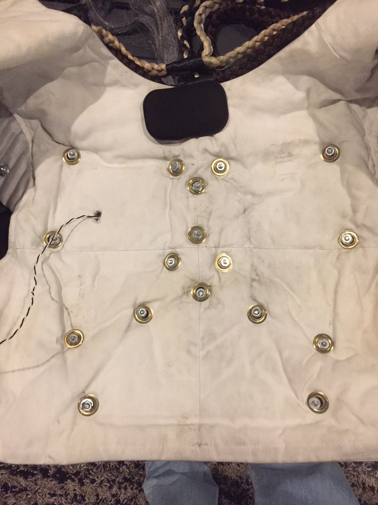

As for soft parts, from the very beginning, I knew I’d have to get them tailored. I wasn’t considering replacing these parts altogether, but should I be?

Edit: To clarify, you don’t think the shape of the helmet, albeit wonky, would prevent approval? I know you can’t guarantee anything one way or another because it’s up to the GML but just curious.
At that price this suit is a steal. You can sell the helmet and upgrade to a fiberglass helmet with minimal spending in between. I don’t think the shape will prevent it from approval, as it looks good in the pictures, but it would be wise to close the gap between the mandibles as that would be one reason I can see it being denied.
The overall bulk of the suit looks great in the pictures and tailoring won’t be so expensive.
If you’re cool with buying a new helmet or fixing it up, tailoring the flight suit and vest. I say go for it!
Just one more question then. By closing the gap between the mandibles, do you mean the widest, vertical portion of the visor? Here’s a picture of the space denoted by the yellow line that I think you are referring to. Correct me if I have the wrong idea:
If so, how would I go about fixing it? Is there a thread I can reference for instructions?

In reference to the paintjob, the damage is fine, it's the metallic coloring that has been denied previously. I recall another vendor trying to sell ESB helmets here but used metallic colors for the red and green and they'd been denied approval. IMO a risk I wouldn't take. As MF said above, I'd snatch up the rest of the suit and replace the helmet.

Like was already stated the helmet is wonky in terms of shape when that's probably one of the most expensive pieces, but you already know that.
