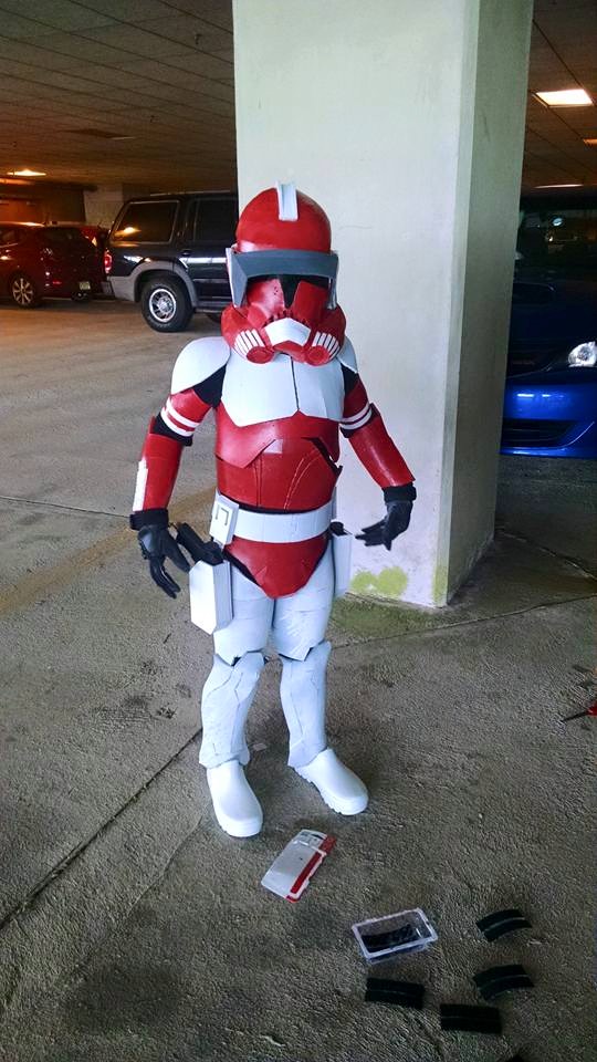

There's some guys doing amazing things with foam. Check out Punished Props, SKS Props, and there's a lot of others too. I made a Commander Fox for my son completely out of foam and it turned out pretty good. He's worn it to 2 cons and its held up okay. The seams are the worst part about it.
