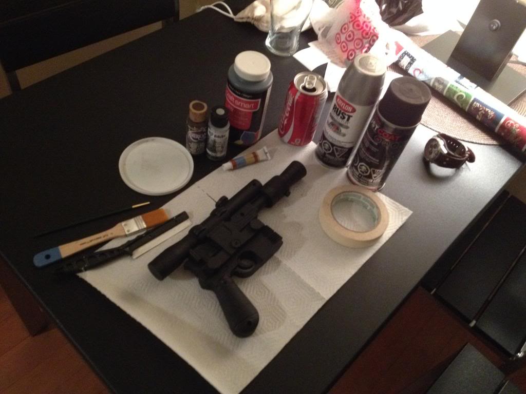

I'm in the process of painting a Hasbro DL44 for a friend of mine as a gift. I'm using pretty basic paints :
flat matte black
krylon aluminum
mix of raw umber and burnt sienna for the handle
krylon clear gloss to seal
testors dullcote to kill the gloss

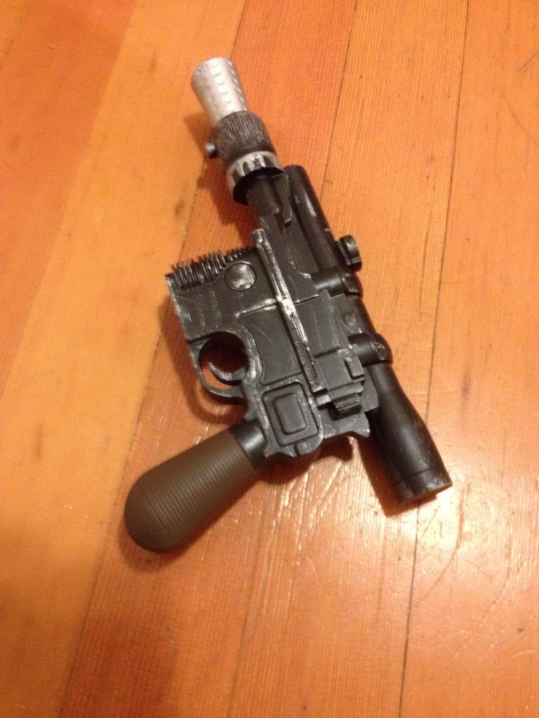

Update...
While I look now at the doopydoos that are out there that look like they have a lot more to them...the hasbro to me is fine for my buddy that's just getting into things...
After the matte black coat...which looks good :)
(I need a new workstation. Partner got a bit cheesed that I used our kitchen table....*gasp*)

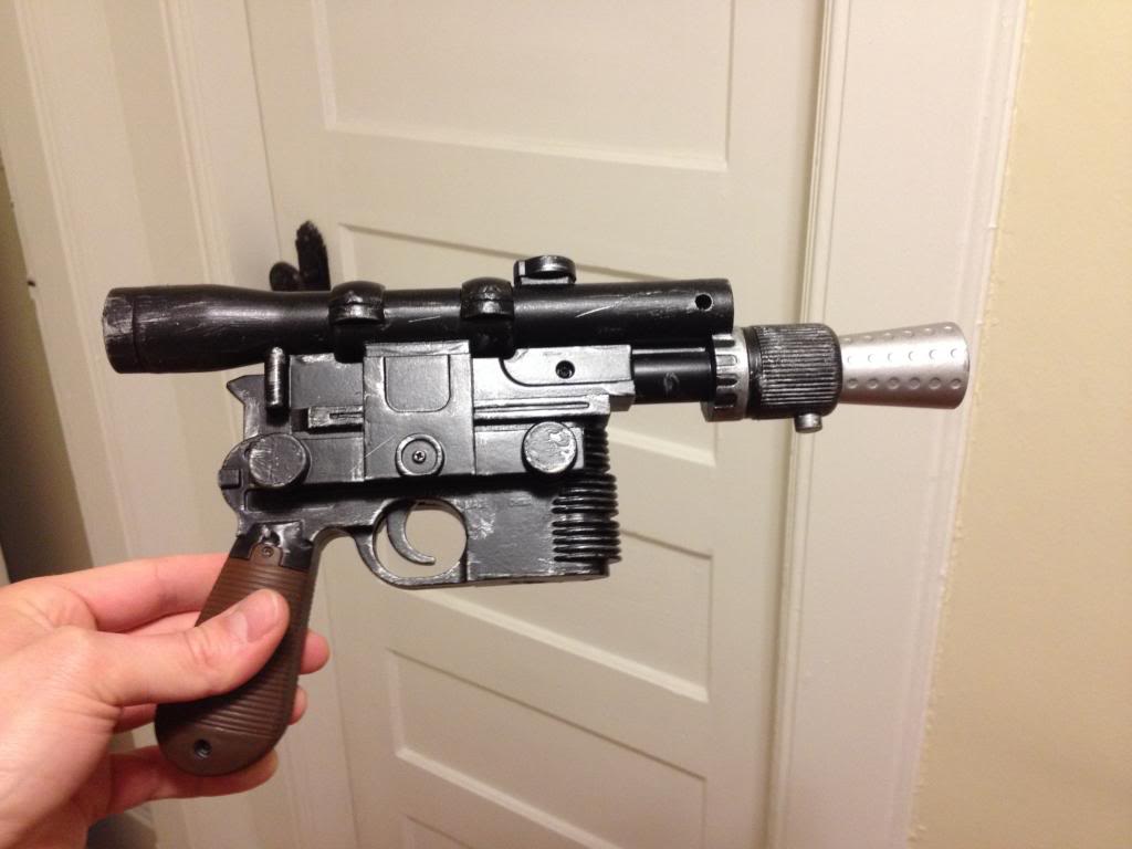

So, after warming my dullcote in a hot bath, singing to it, and then vigorously shaking for a solid 3 minutes...
Closer to the light, you can see it still has a sheen to it. At least it's not as bad....I'd say it's gone from a glossy to a semi-gloss....
Now, I know it should still reflect light...but it's at the amount that it is...I don't think it's fully matte. I think my conclusion for my armor will be to use a matte finish to seal, like the Krylon matte (a few coats), and then the dullcote and see how that works.
