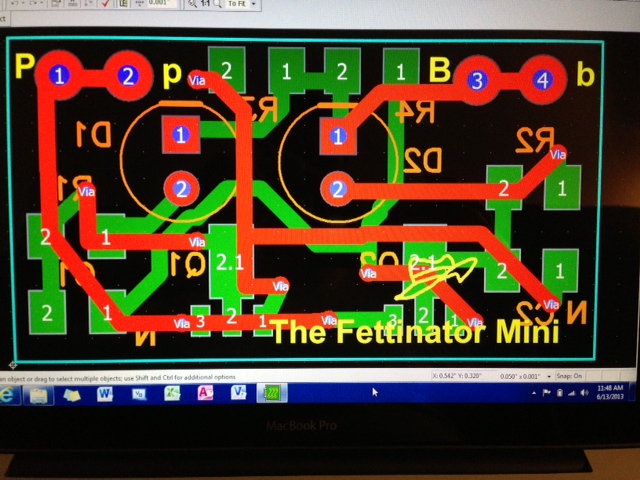

Ok, so after a long period of time of developing the circuit, I have ordered the PCB for the TF light kit. My plan for this kit is to have it be easy to install and require no soldering by the buyer. This kit will be using the honeywell 1sx1-t micro switch and not a tilt switch like in my Asok kit. It will also be using 12v DC grain of wheat bulbs to light up the perspex block, and everything will run off of a 9v battery. When I build the mock up I will see how much of a difference a 12v battery makes on the GOW bulbs and how long it will last compared to the 9v and if it seems like a better option, then I will change the circuit to accept the battery to a 12v.
I already have a few of the honeywell switches and parts for the board, and once I get the boards and my hollow stalk from fettpride, I will start the mock up. As this porcess progresses, I will post pics to show everyone how it is going to work. As of right now, I don't know if this is going to be an ongoing run do to the price of the boards and the micro switches. The possibility of making it an ongoing run is open, but there must be a reaonable amount of interest for this to happen; the boards are about half the size of my Asok kits and are going to be very difficult to build since I do all of the soldering by hand.

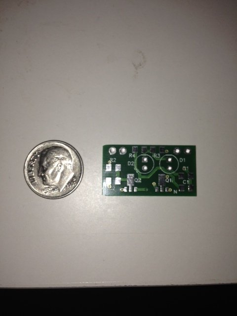

I have the boards and will post a pic when I get home from work tonight.
Yeh was going to say something about how small it is in here when i saw the pic on email last night i was VERY impressed....
The other kit for the FP/Asok RF is small and very well made but this....is CRAZY small bro amazing work

F4R, your Asok kit is done. Also I just finished a TF board and it works perfect. I took a video of it and will post it before I go to work Thursday. Now I didn't run it through the Honeywell switch because I still need the hollow stalk, I just used the switch in the battery holder to turn it off and on. I used an old 9v so the GOW bulbs are a bit dim but everything works like it should and everything fits perfect.
Here it is. It was a pain because its so small, but it works. Its not running through the switch, but that will be the easy part.
