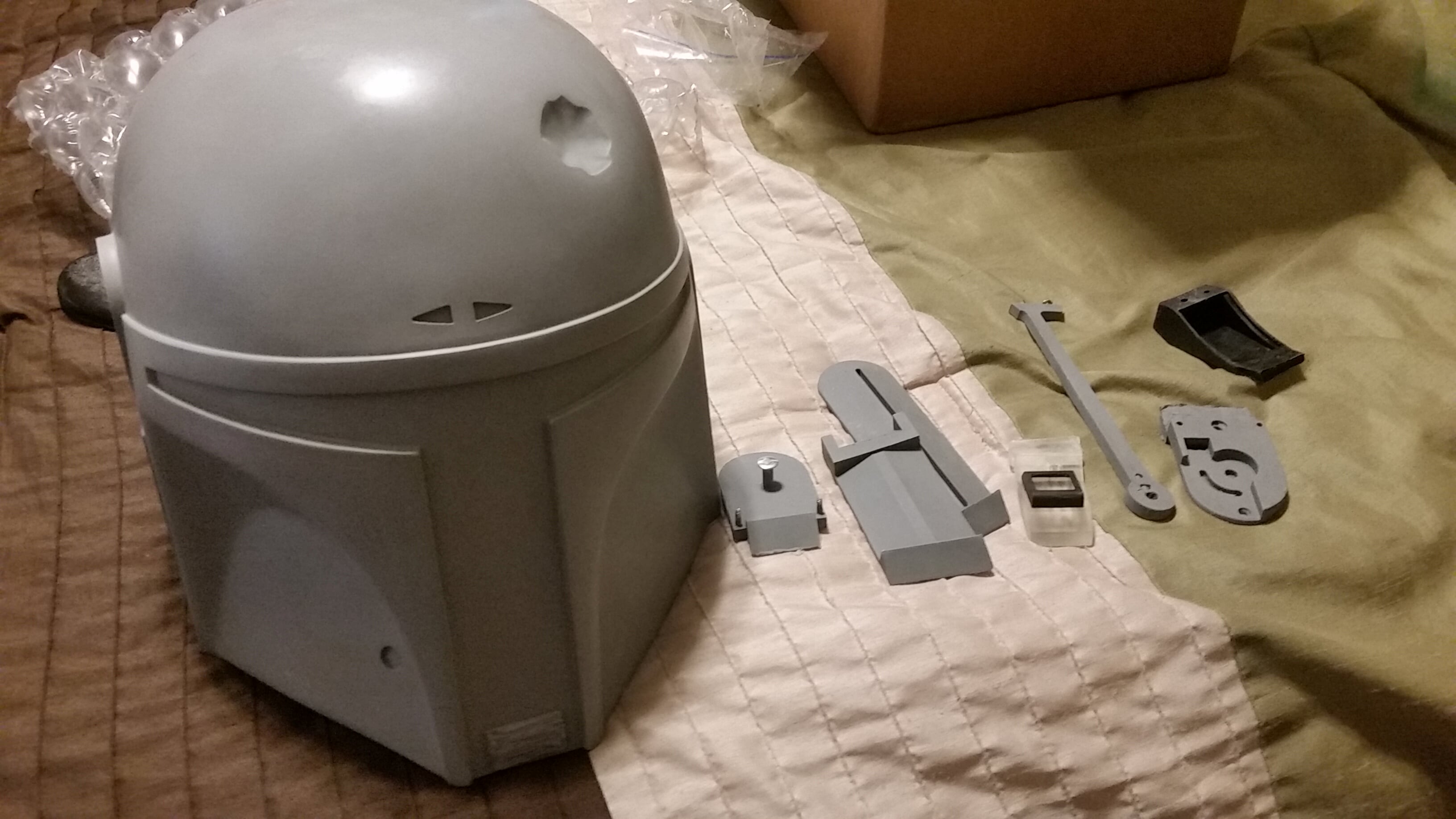

Here's a pic of the parts as they arrived.

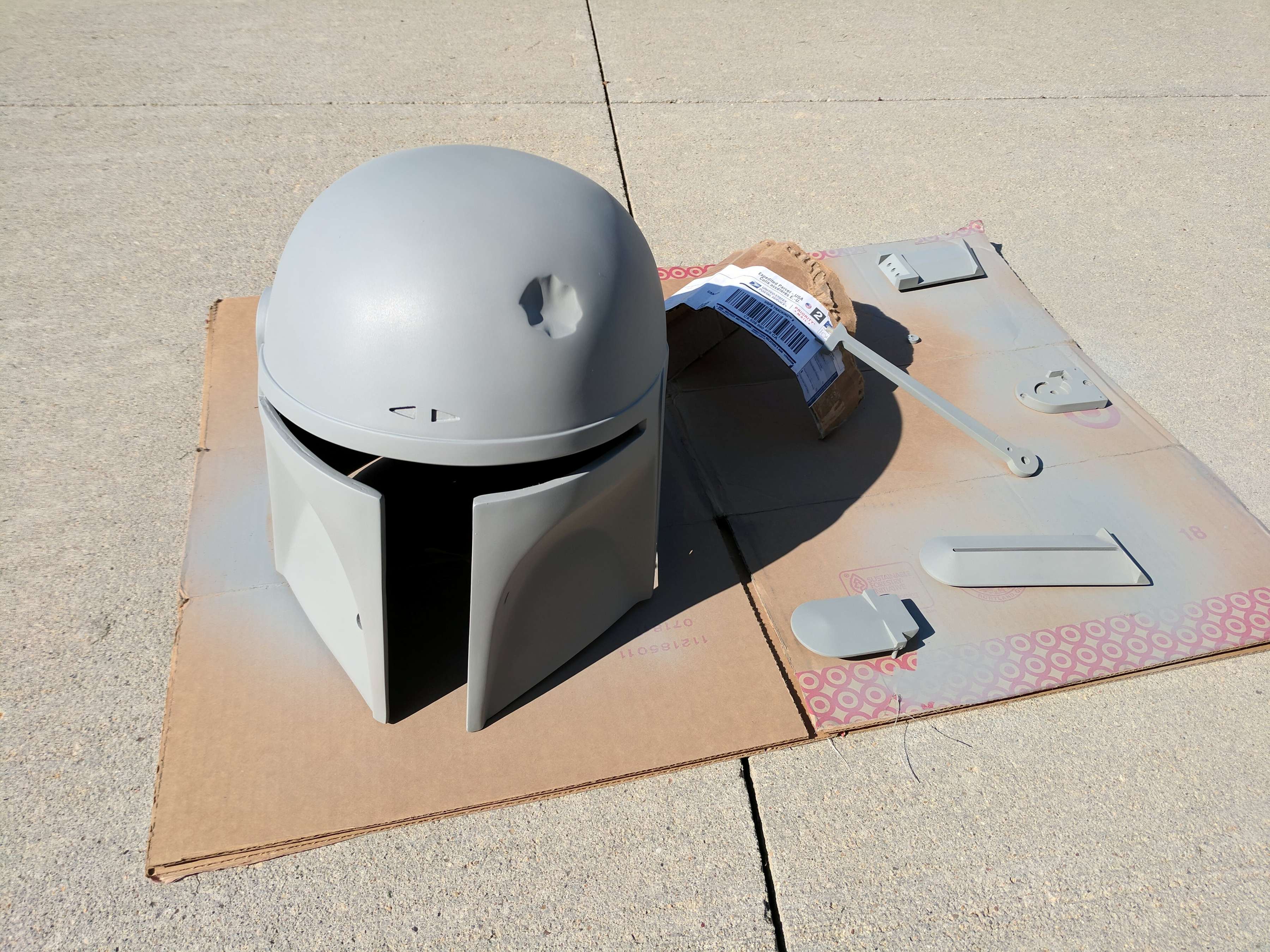

Then gave all the parts a basic rattle can primer.

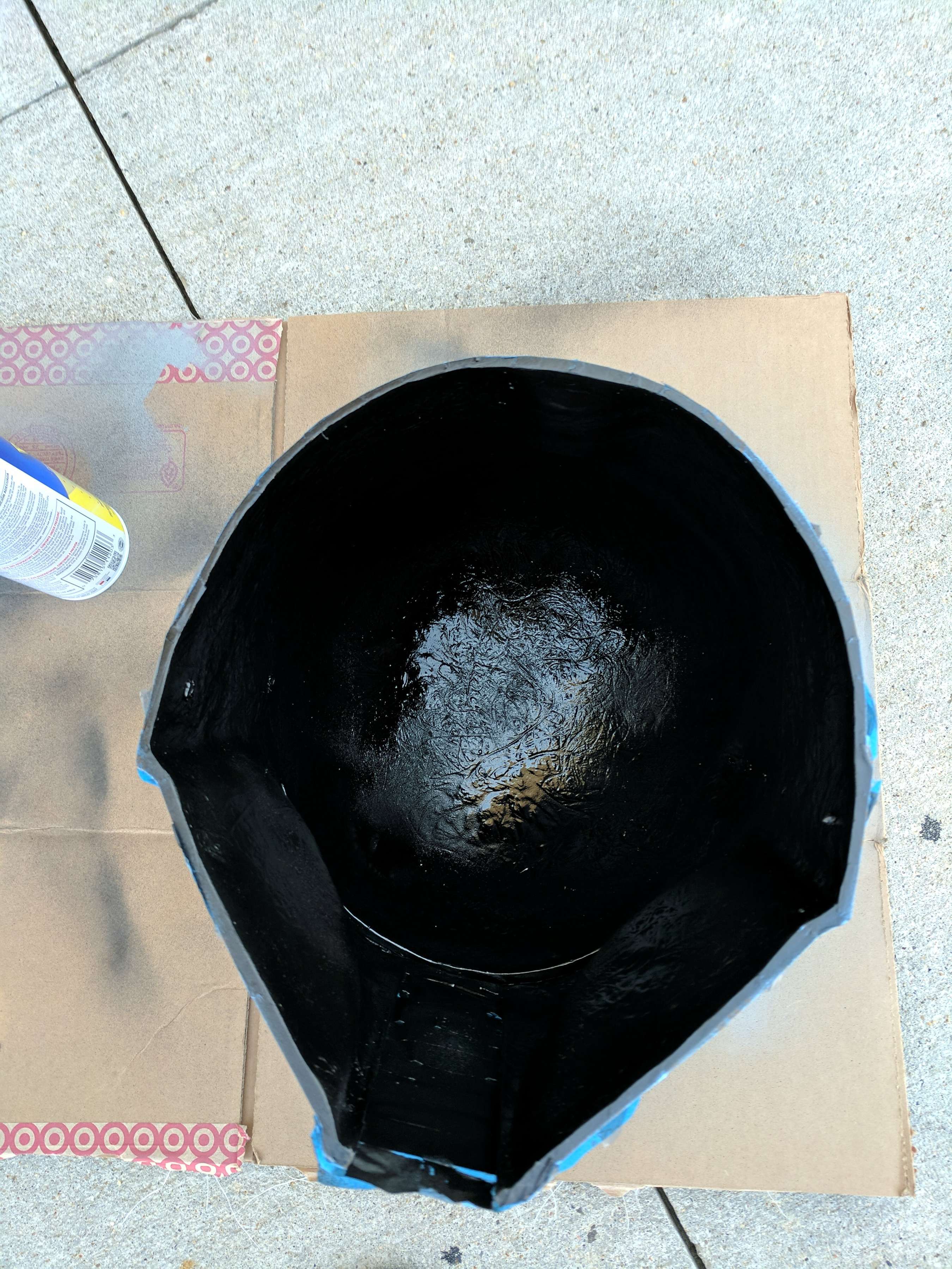

Lastly I did three coats of plasti dip inside the bucket. Don't think it was necessary but I liked the look inside my TK bucket and I think this turned out pretty nice as well.

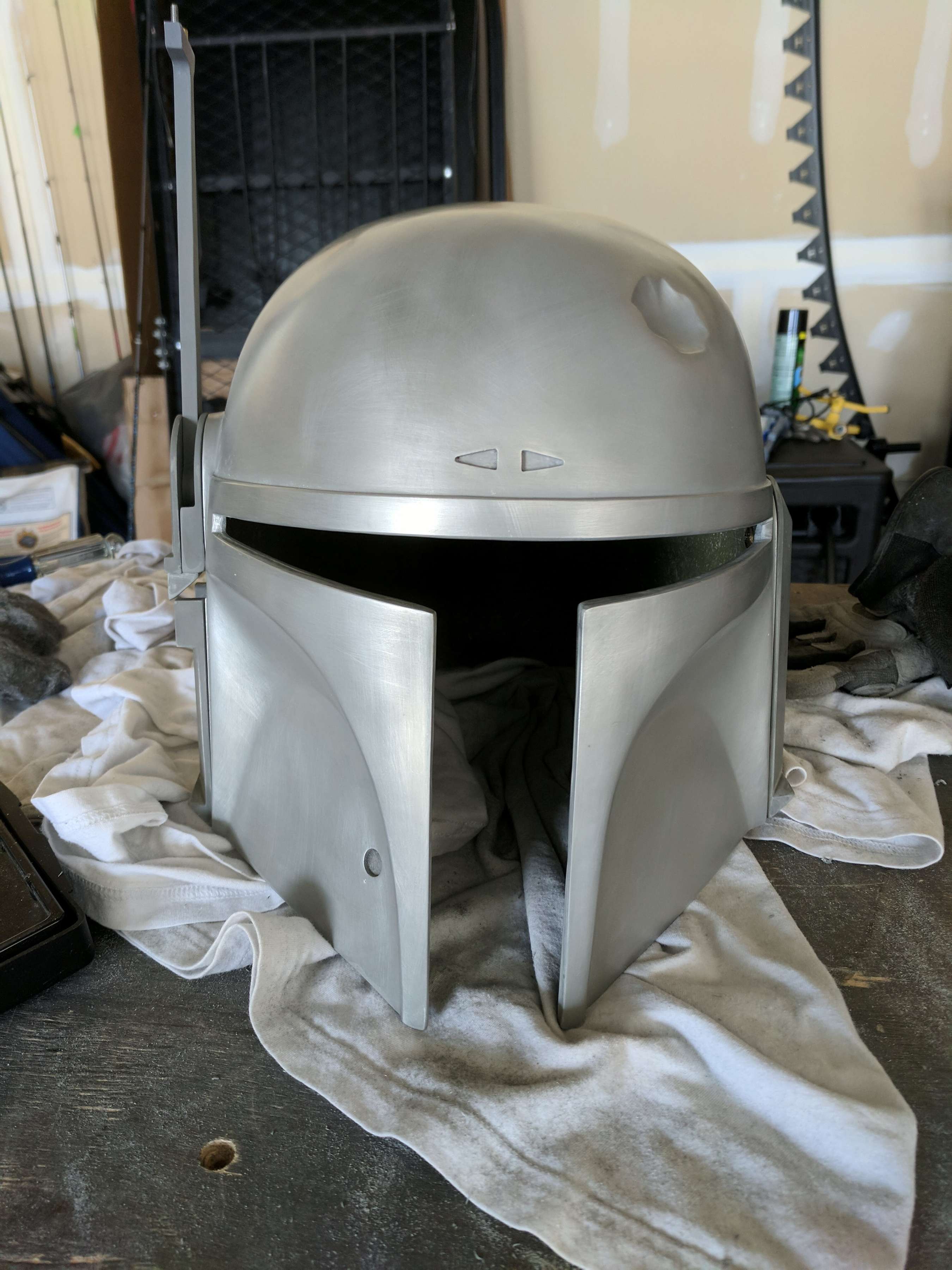

SupRsloth

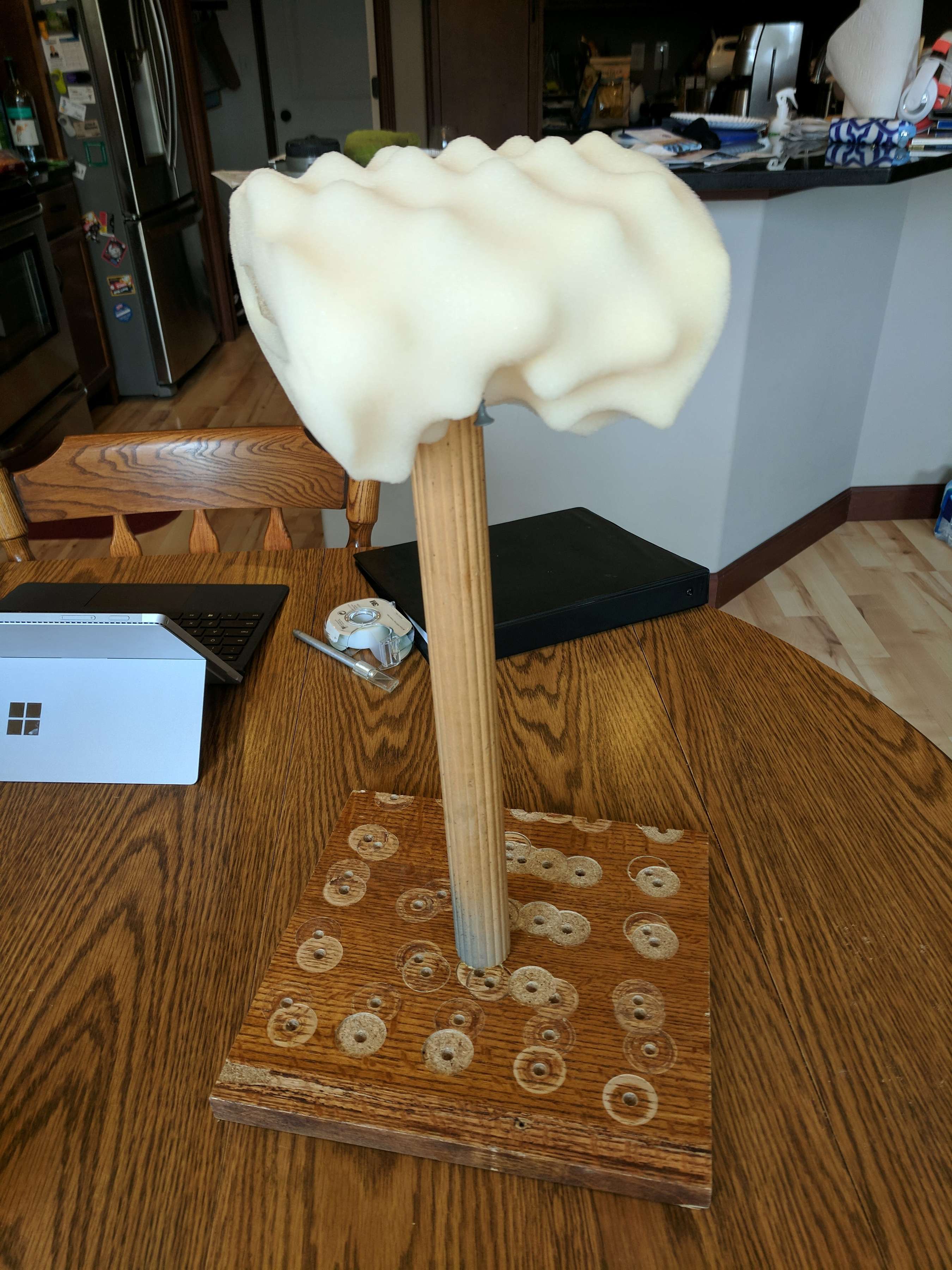

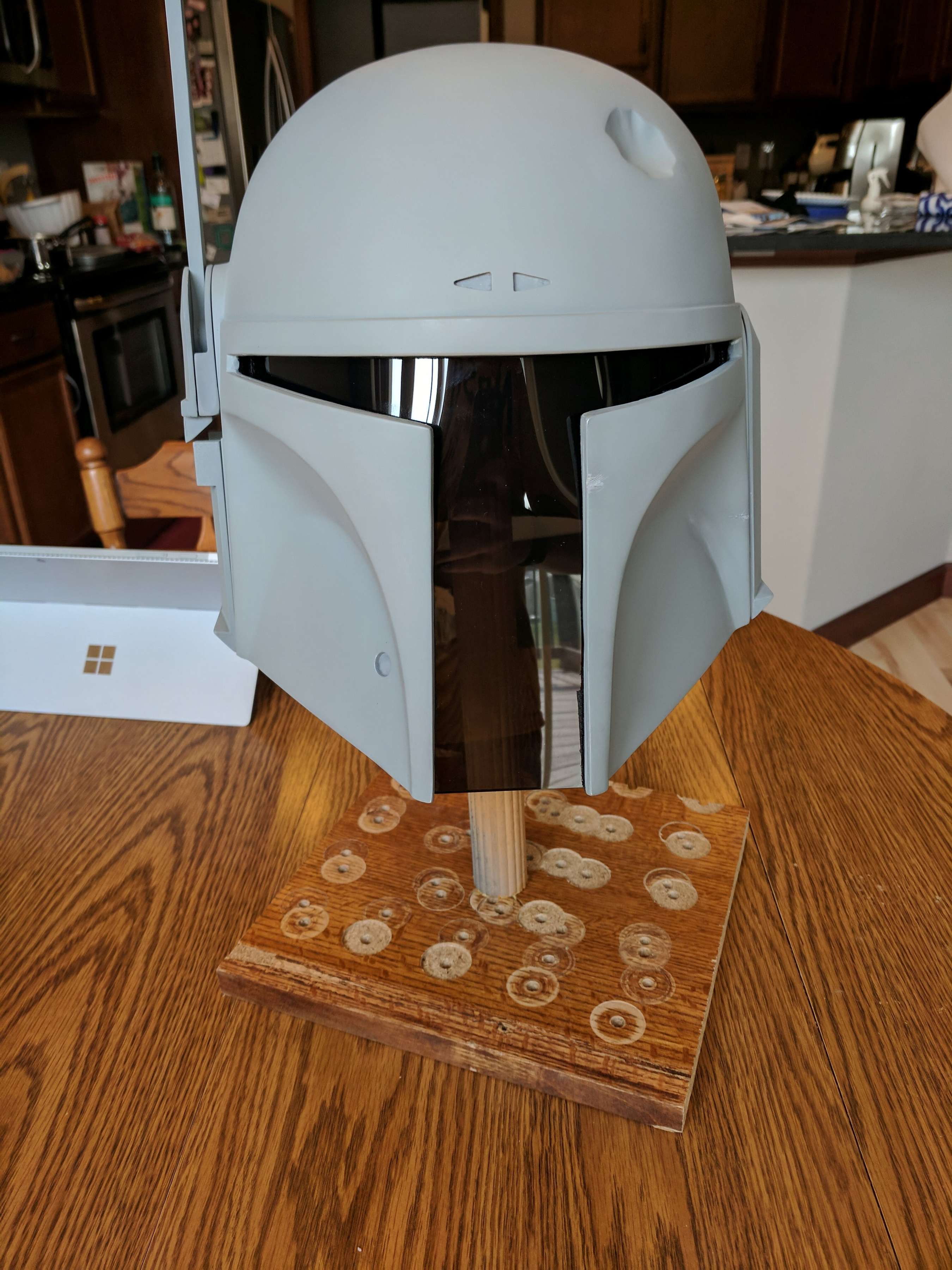

The work for this weekend was adding the physical damage to the left mandible. Thanks to Cole (a former Fett) for pointing out that I missed that. Also my son and I built a helmet stand out of some used wood I had around for some other projects. Should do the trick I think once I start air brushing even though it's ugly as as could be ;).
6YqrAk4aJtPFcsYOzVwlSL1hM7hVE8vsKdhwgMi2YHCwpQ-86mc1IAKFvrA?width=3036&height=4048&cropmode=none.jpg
ABZvwrPau15lpXE9FiLayZ2G6ninnhlAcb96H6f3xdEcOfV4WAsLPbn4unw?width=3036&height=4048&cropmode=none.jpg
Next is trying to paint this thing...... :cautious: I'm a bit nervous and excited as I've never airbrushed before. Already got the airbrush and I ordered a bunch of paint and miscellaneous tools today to get started. Hopefully will get started on that next weekend.

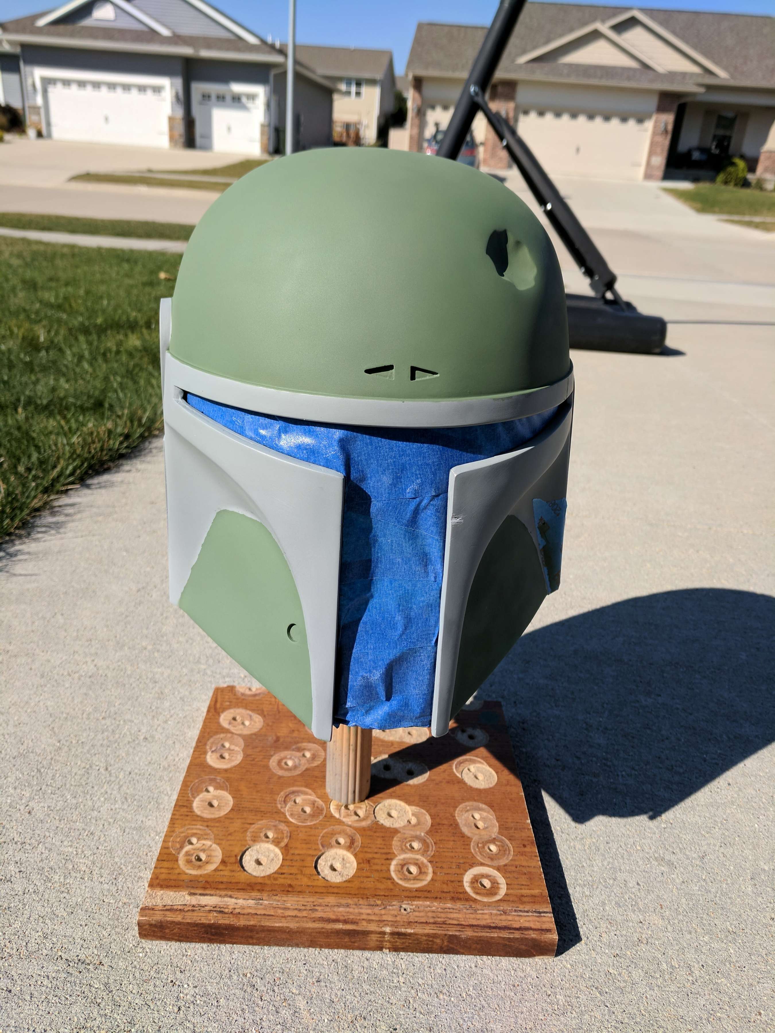

SupRsloth
Finally started a bit of painting today. Took me forever to get the air brush working for the first time. I needed to add quite a bit of thinner to get it to flow. Now I know. :) Looks pretty bright but once I get the main colors on I'll do a bit of weathering with some 0000 steel wool. Hopefully that takes the shine down enough.

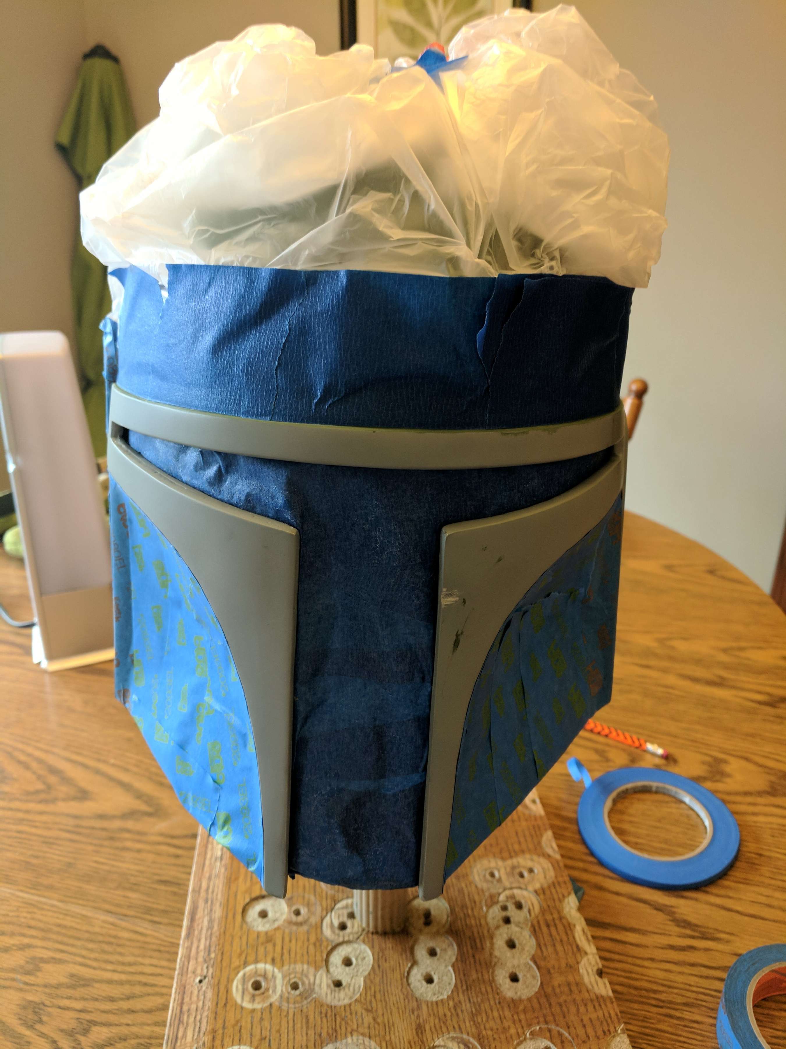

SupRsloth

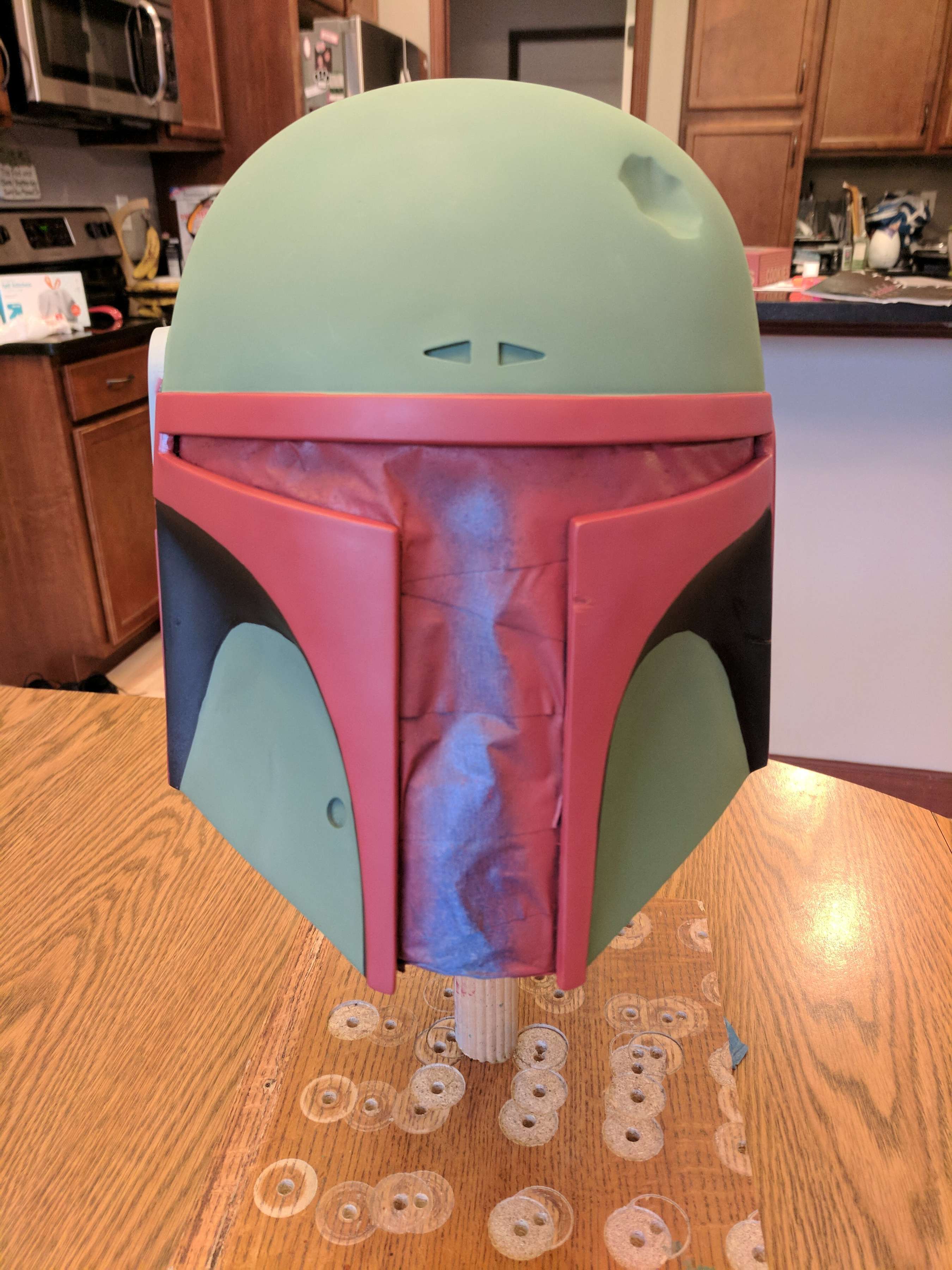

Made some more progress between this weekend and tonight.
Painted the black on cheeks and got the dark red painted around the helmet.
QhNANkA6odueuigYP2l1eS3ySjPj_BsA96-dHsluJ-17kdNQ98Tt4dm6zLQ?width=3036&height=4048&cropmode=none.jpg
l-325Vblip55Zk2I4KLVy12hhJgfDqIa1e0fR0NcJ9uG5J8iFLqQ7_2M0LQ?width=3036&height=4048&cropmode=none.jpg
B6TKeVujCHww7Zc4TDD2-uDsQ5OsQCqKoZpGbtJHqqW6bDiLDvxl2t3mhsA?width=3036&height=4048&cropmode=none.jpg
cApJZ9bOOqYTr_wk9rq-Ck0kN3yODsBPGN9PXo9-_CGhFVTlWvsGVTUJjfw?width=3036&height=4048&cropmode=none.jpg
Few spots around some of the edges that I cleaned up after taking these pictures. Didn't do a perfect job of taping evidently. :p
So that was the easy part but was a pretty big struggle for me as a first time air brusher. Now onto adding the damage. Can't imagine that will be any easier but I'm pretty happy with the progress so far.

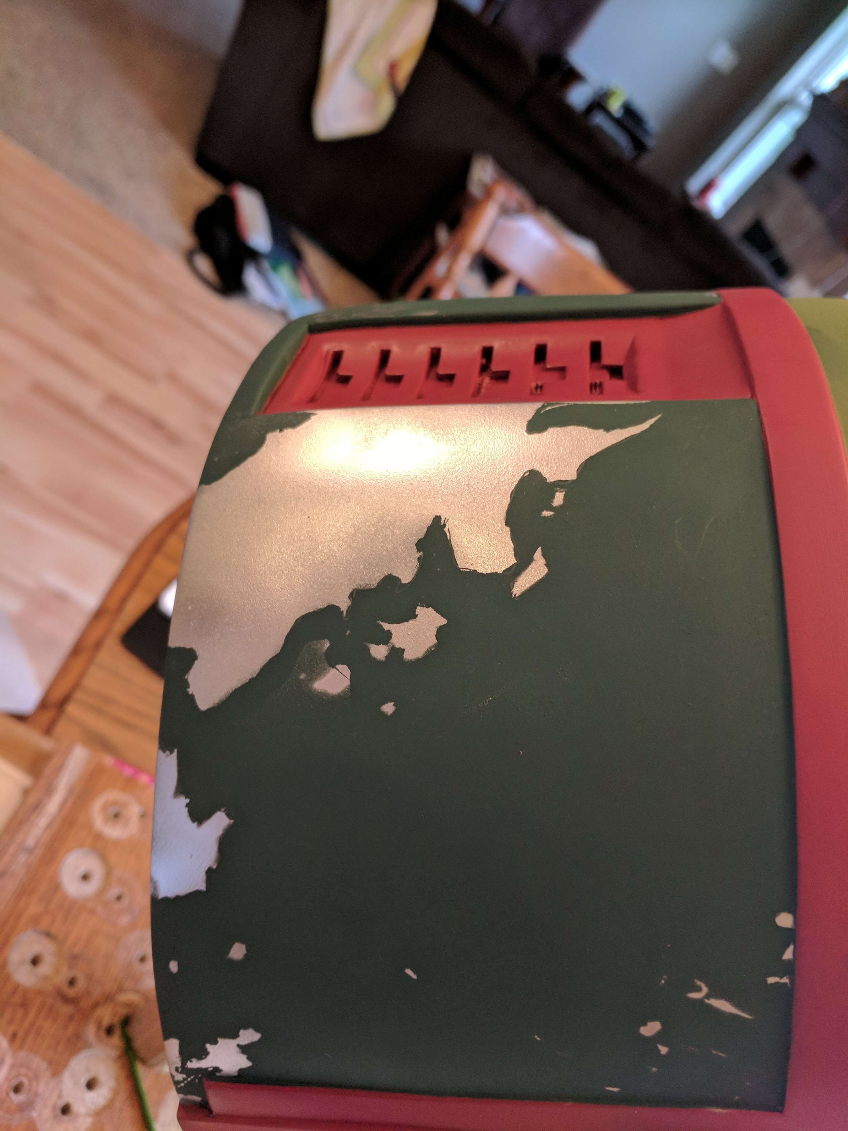

SupRsloth
Got a little bit more work done this weekend again. This is more slow going than I expected and I expected it to be slow.

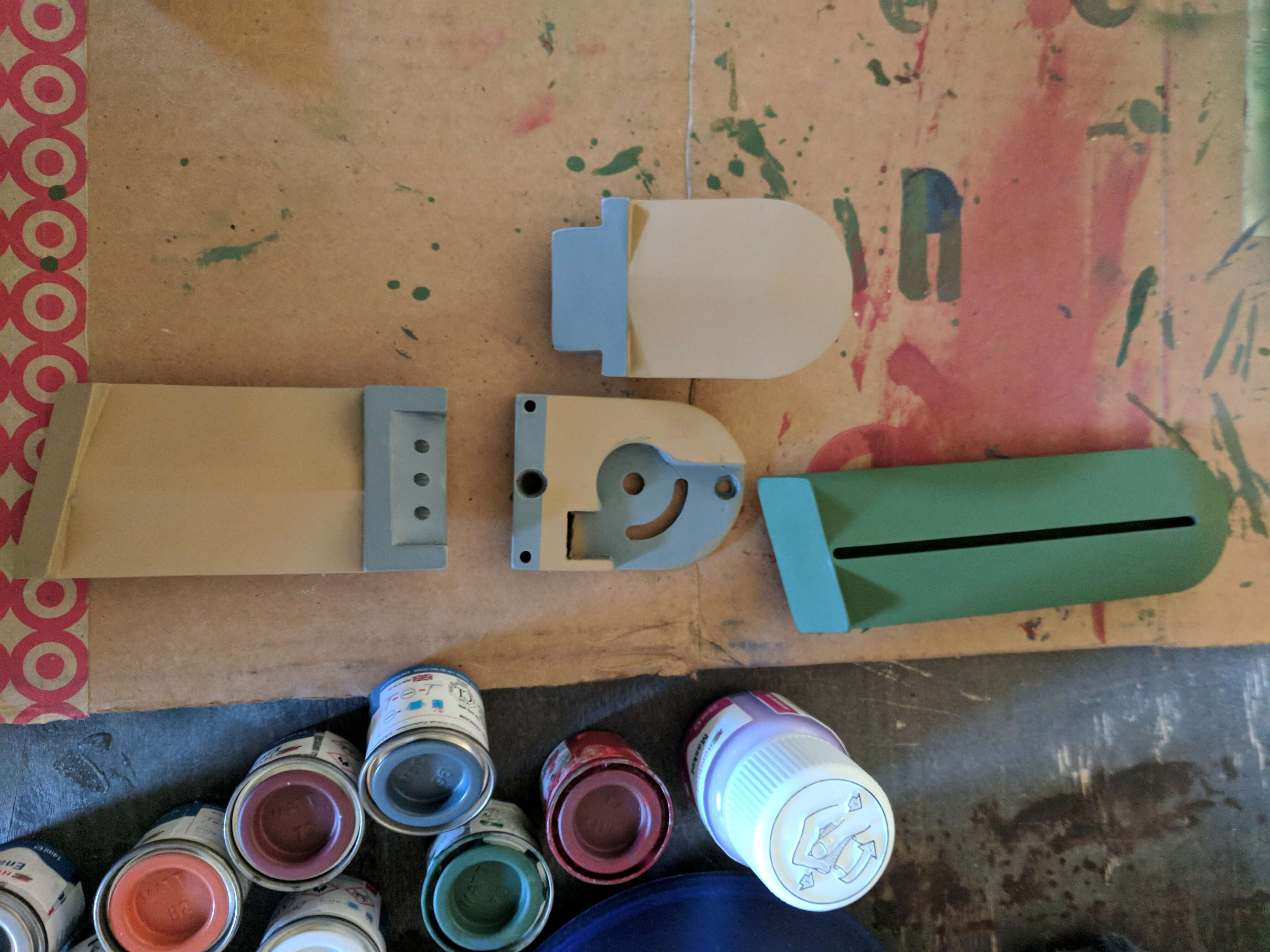

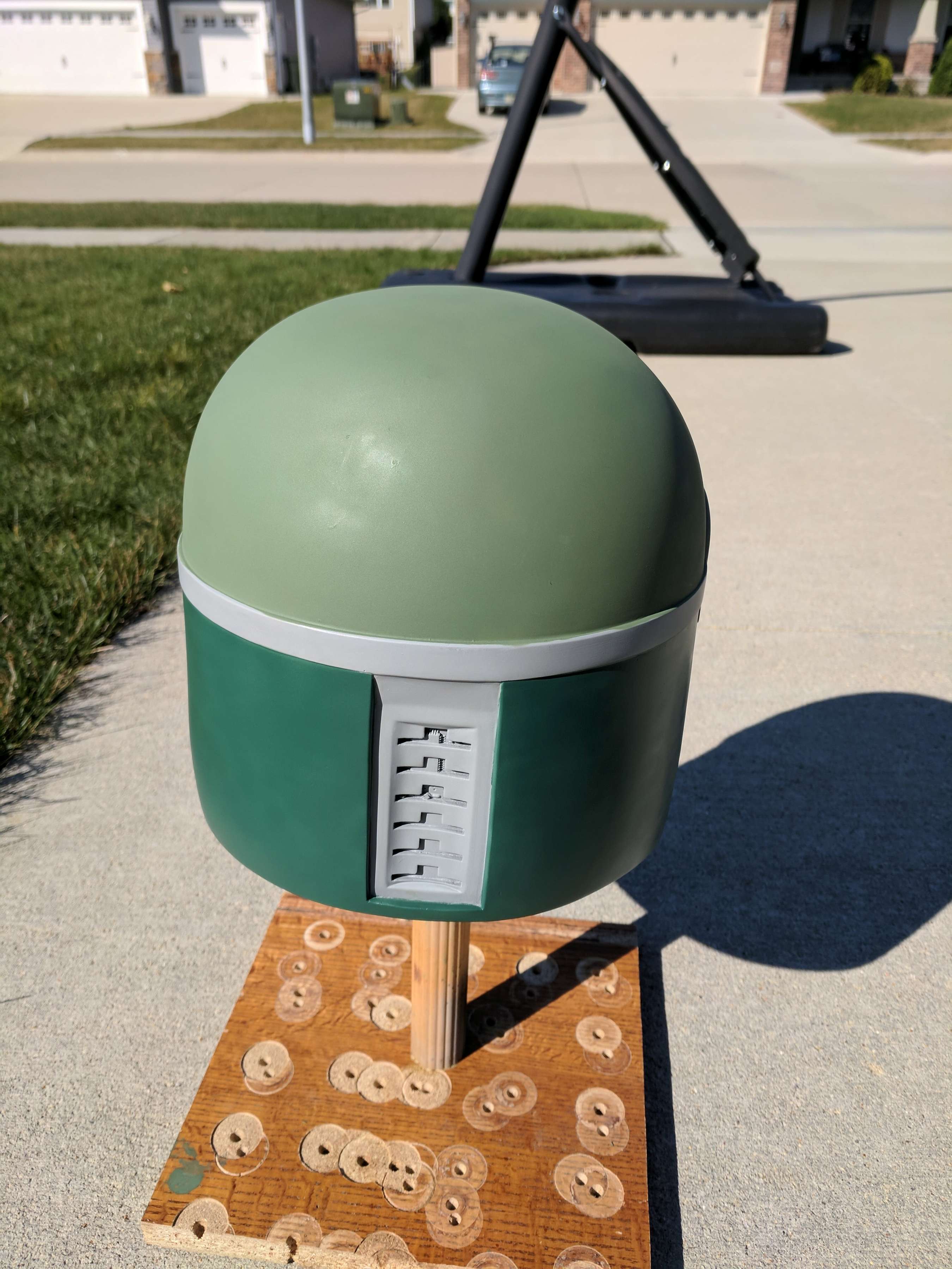

First got all the ear pieces painted with the main color.
vf0zFYGPIGRryHWPCSugRMeIXymGs1kg3JRf5YDX573WFtjw_gOiLL0fjDQ?width=4048&height=3036&cropmode=none.jpg
Then did my first attempt at a portion of the damage. Doesn't look exactly right I think. Hopefully will start looking a bit better as I add the other colors on top.
MAr_sUr36q8C9W4y-XdPW0-aE05kDZnyubS63MEKx5nJ5XkpvESRr85sqDA?width=3036&height=4048&cropmode=none.jpg
aUtWXKGosVLWGXaP76iRTXhs4HhffiW8OfRDzEDXcZio2Kfgd4NNzTtj8cA?width=4048&height=3036&cropmode=none.jpg
I'm not very good at cutting out the stencils evidently so my shapes are not quite as crisp as I had hoped. Hopefully it will look good enough.

SupRsloth
Thanks for the feedback! I ended up repainting the green on the back panels to start over. Any brand recommendations on the transfer Paper?
Evan1701
You should be able to pick some up from any craft store. I picked up a couple packs of the wax transfer paper from Michael's, the package is pretty generic looking and just says "transfer paper" or something like that. I like the wax since it's easy to see with most colors, although I pretty much couldn't see it at all on the concrete layer and had to freehand it.
TK50175
I used spray clue to clue the tracing paper on the scaled stencils. Try this so you dont have to deal with to sheets of paper (stencil and tracing paper).
hvacdon
Amazon has black and white carbon paper available. The spray glue is a good idea for keeping the stencil and carbon paper from sliding around.
The link to Jayvees ESB paint up should help you figure out some of the steps and processes. Jayvee is very talented !!
SupRsloth

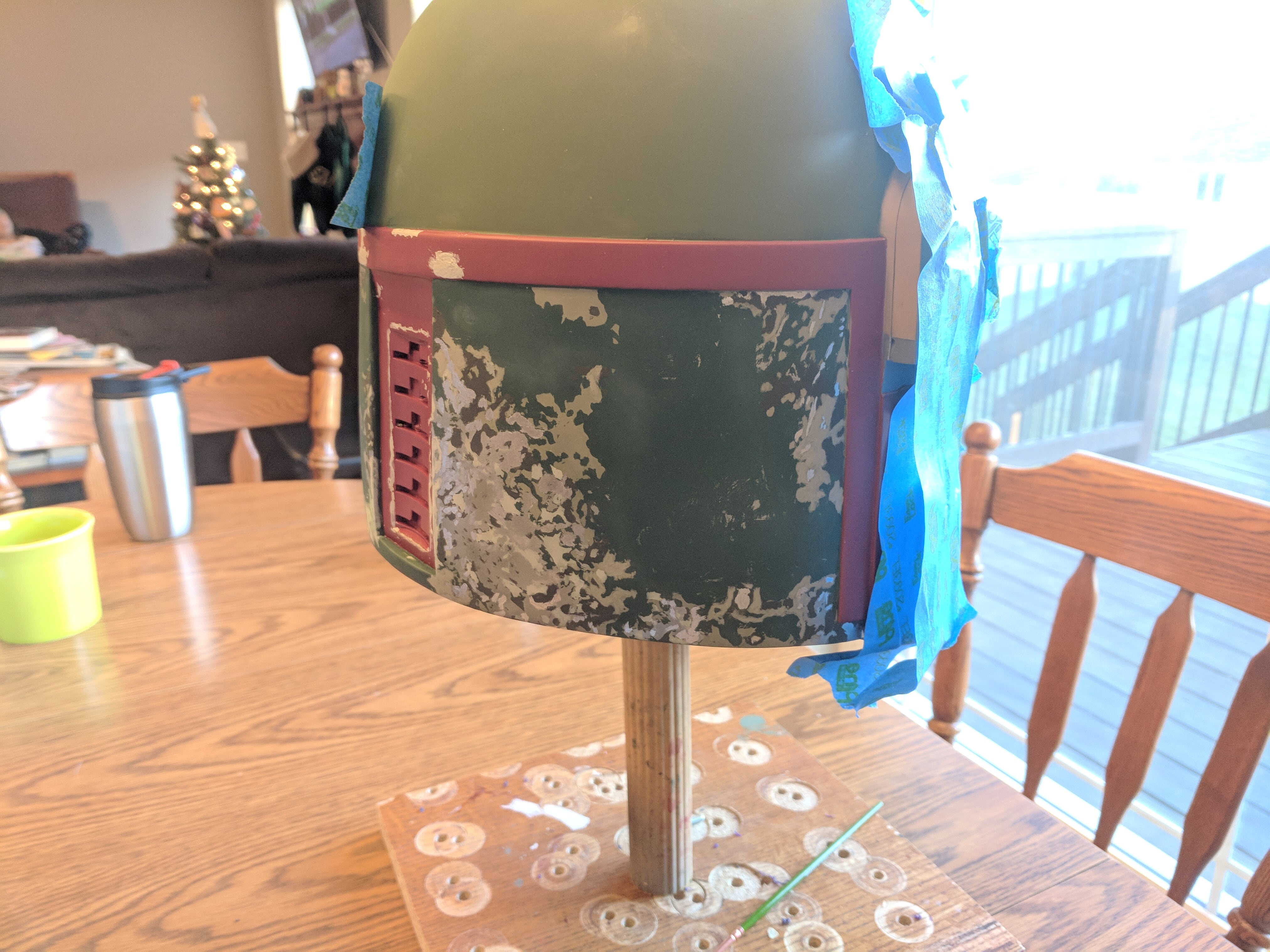

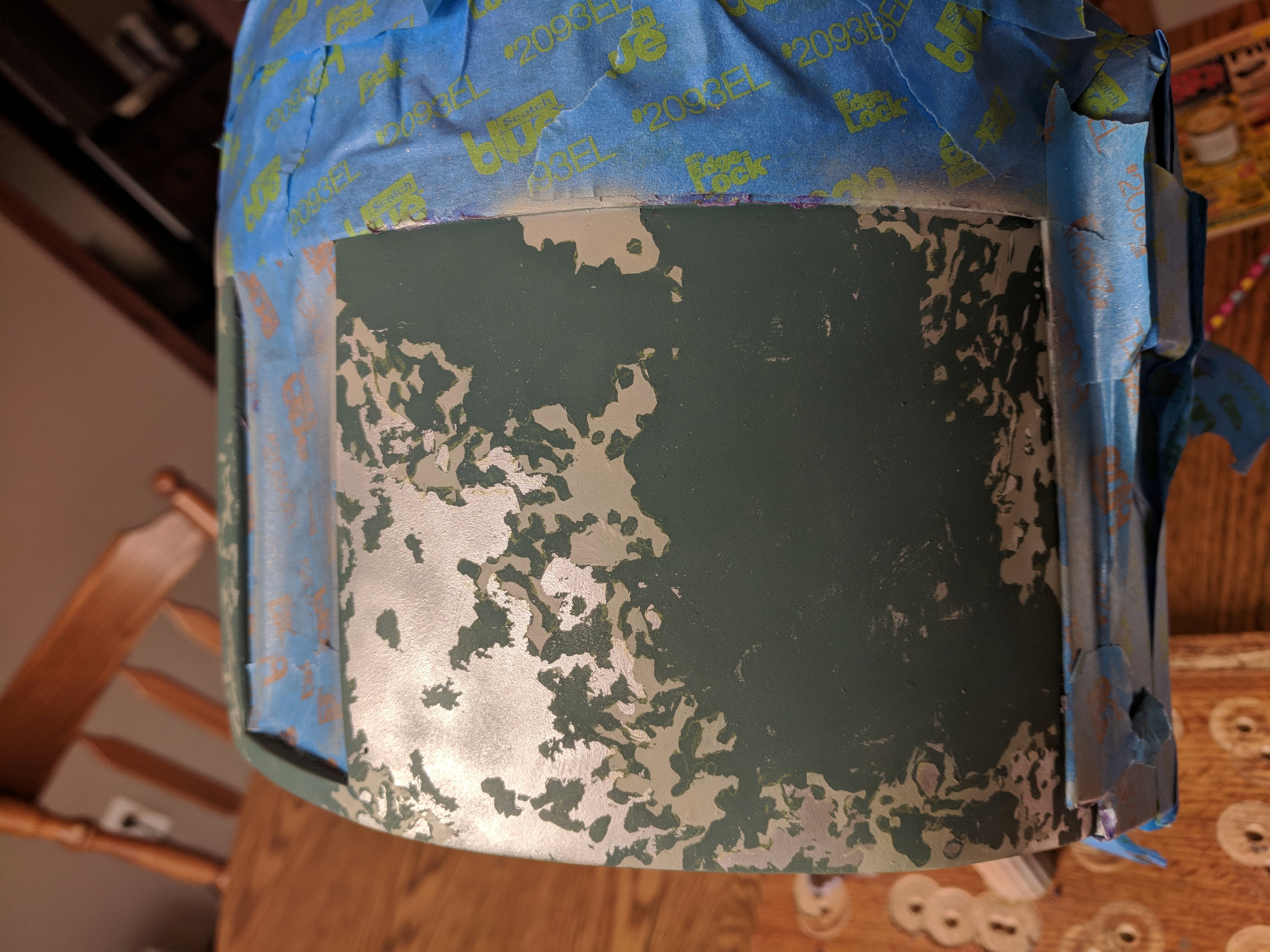

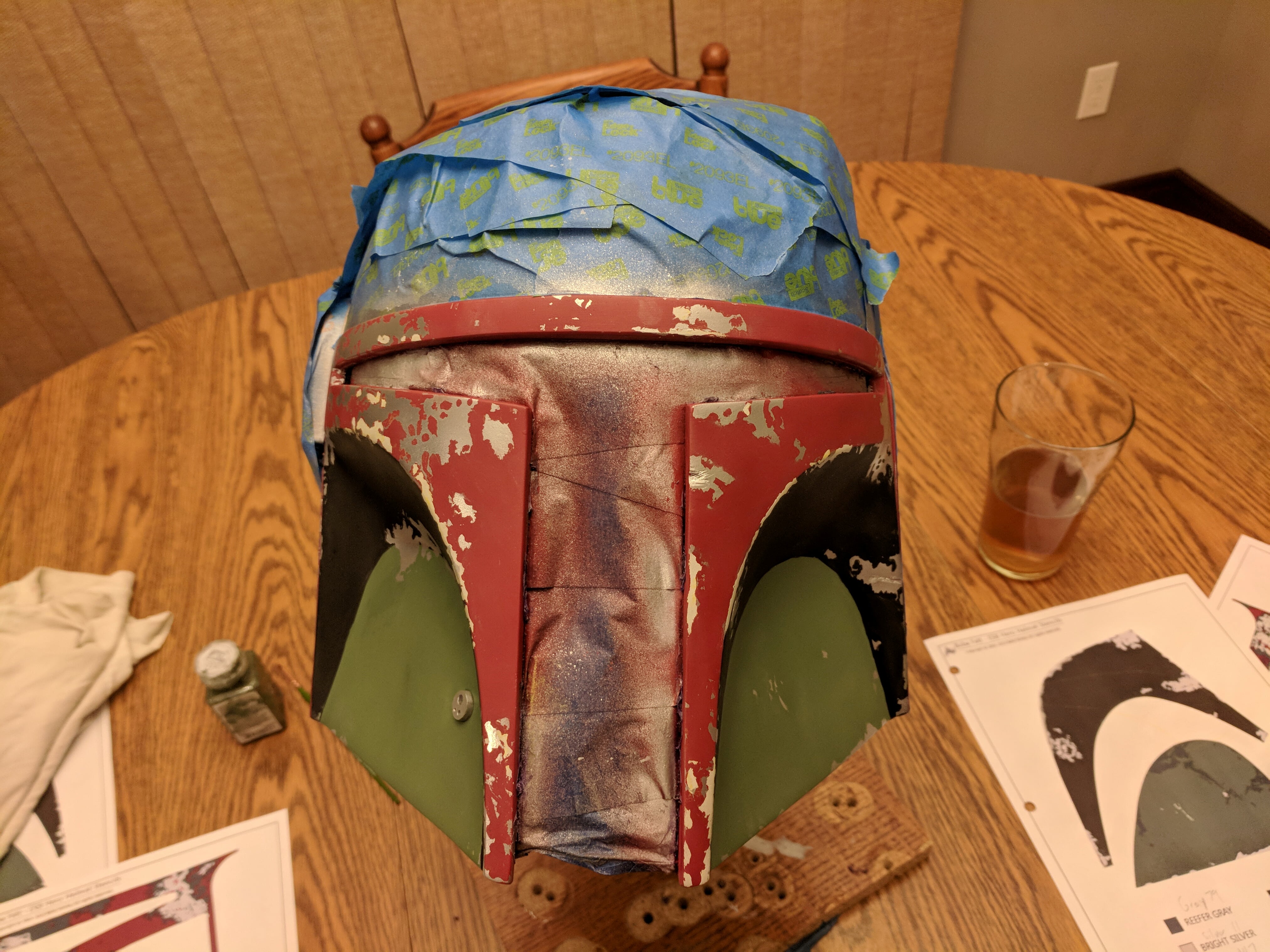

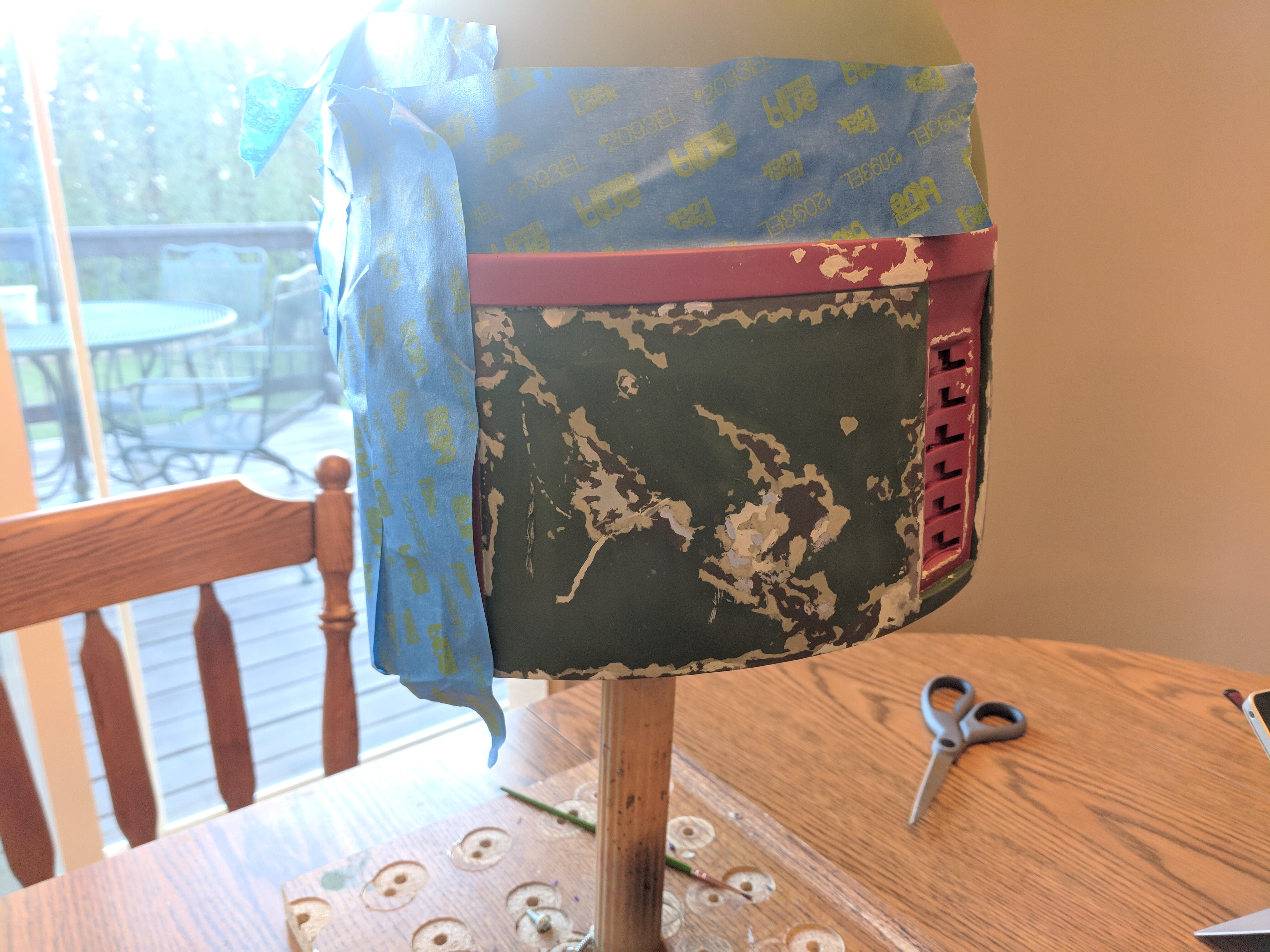

So I gave it another shot using some transfer paper and masking fluid. Nowhere near perfect but defiantly way better than the first attempt I think. You can see that I didn't mask perfectly as there is still some of the transfer paper lines showing. They wipe off pretty easy so won't be there long term. Looking close enough? I still have two more major colors to go.

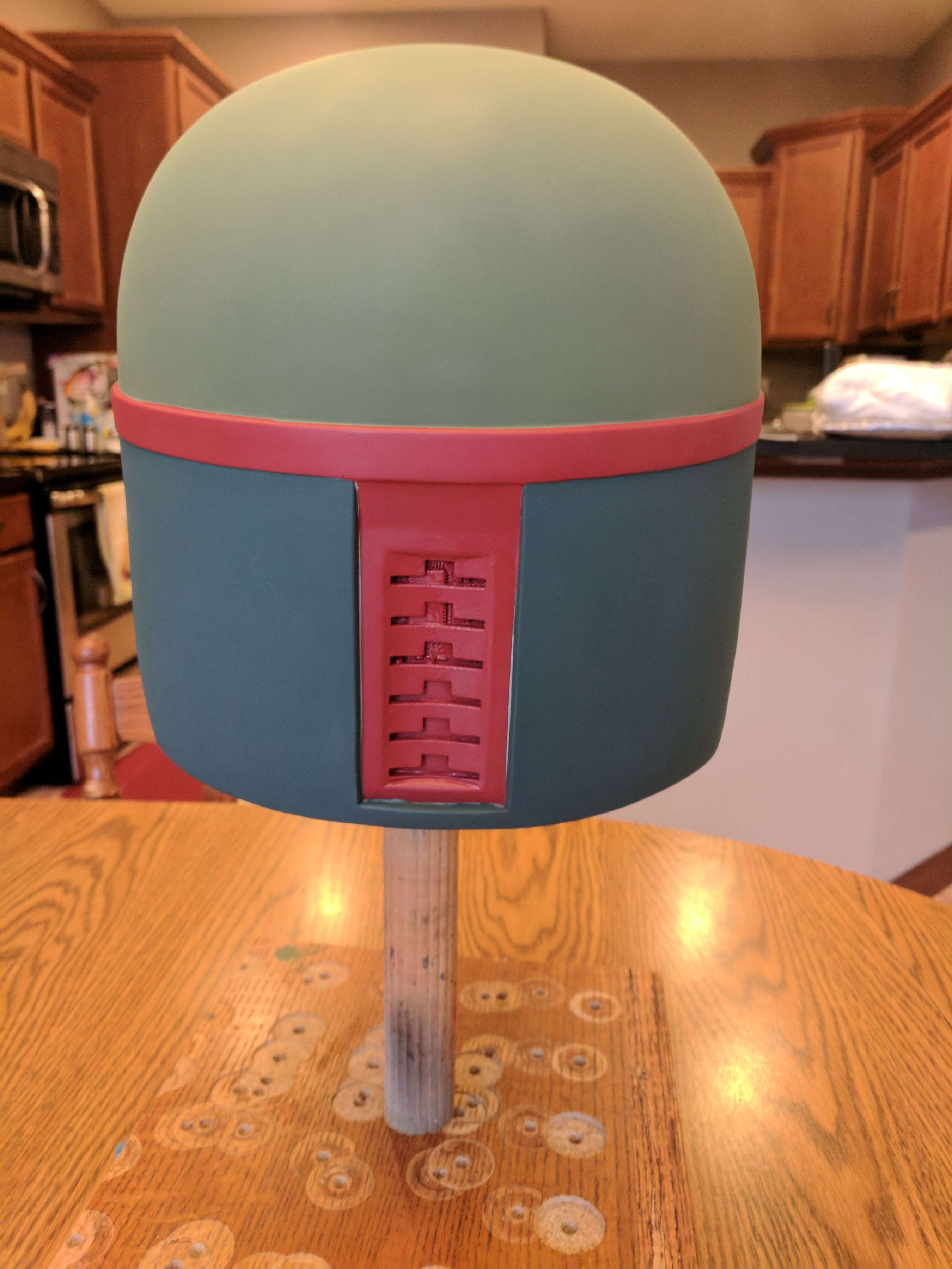

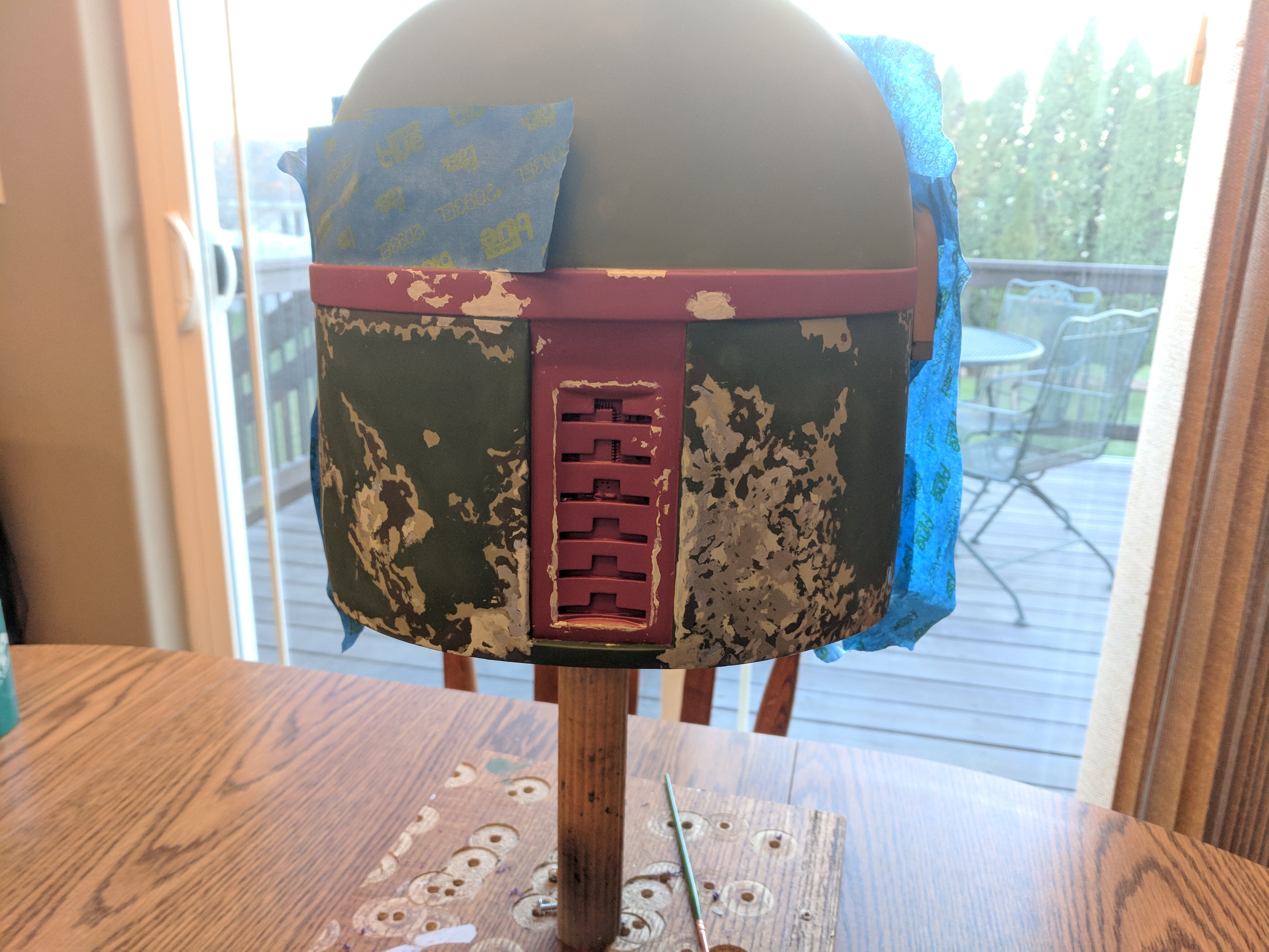

SupRsloth

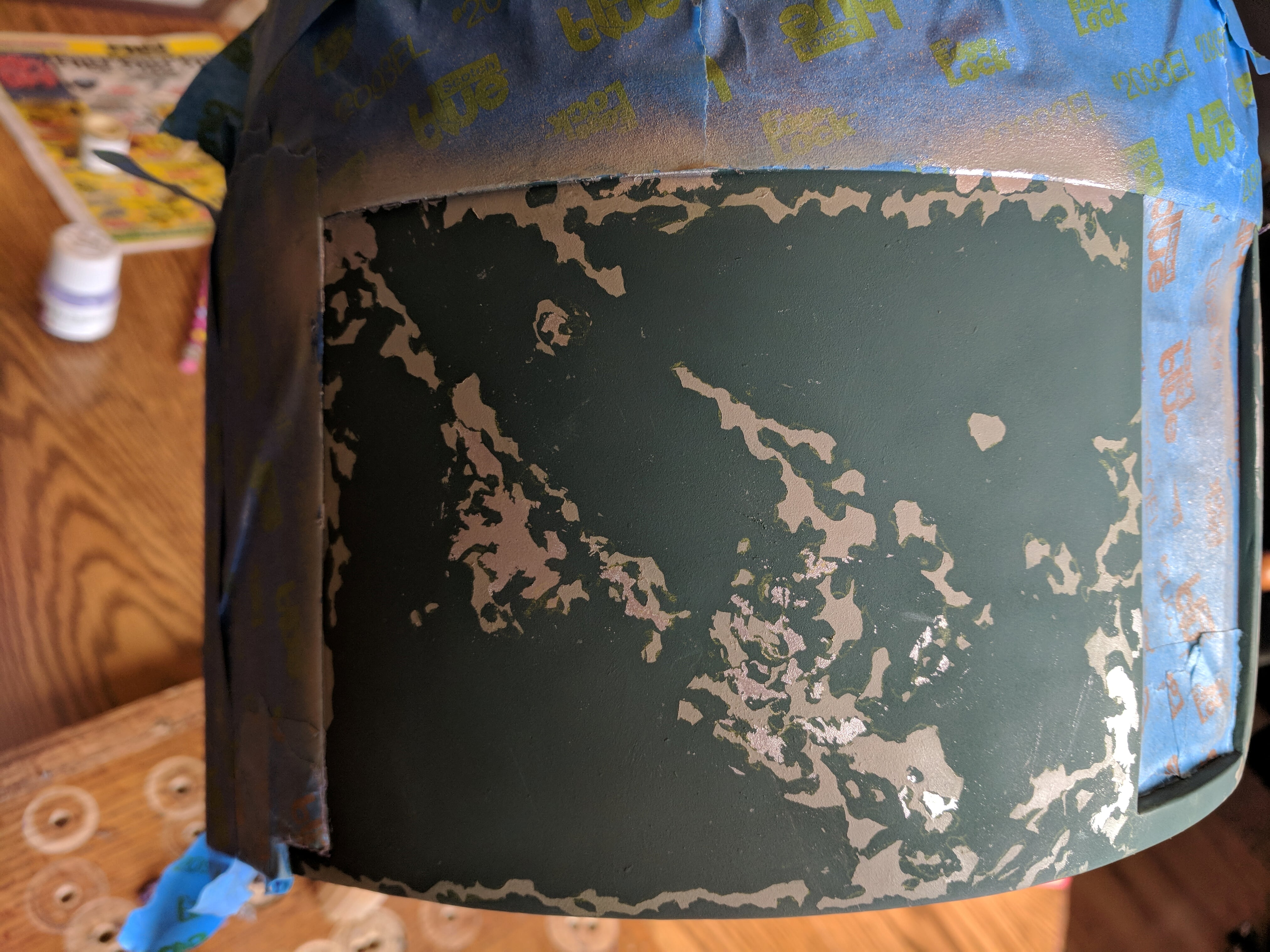

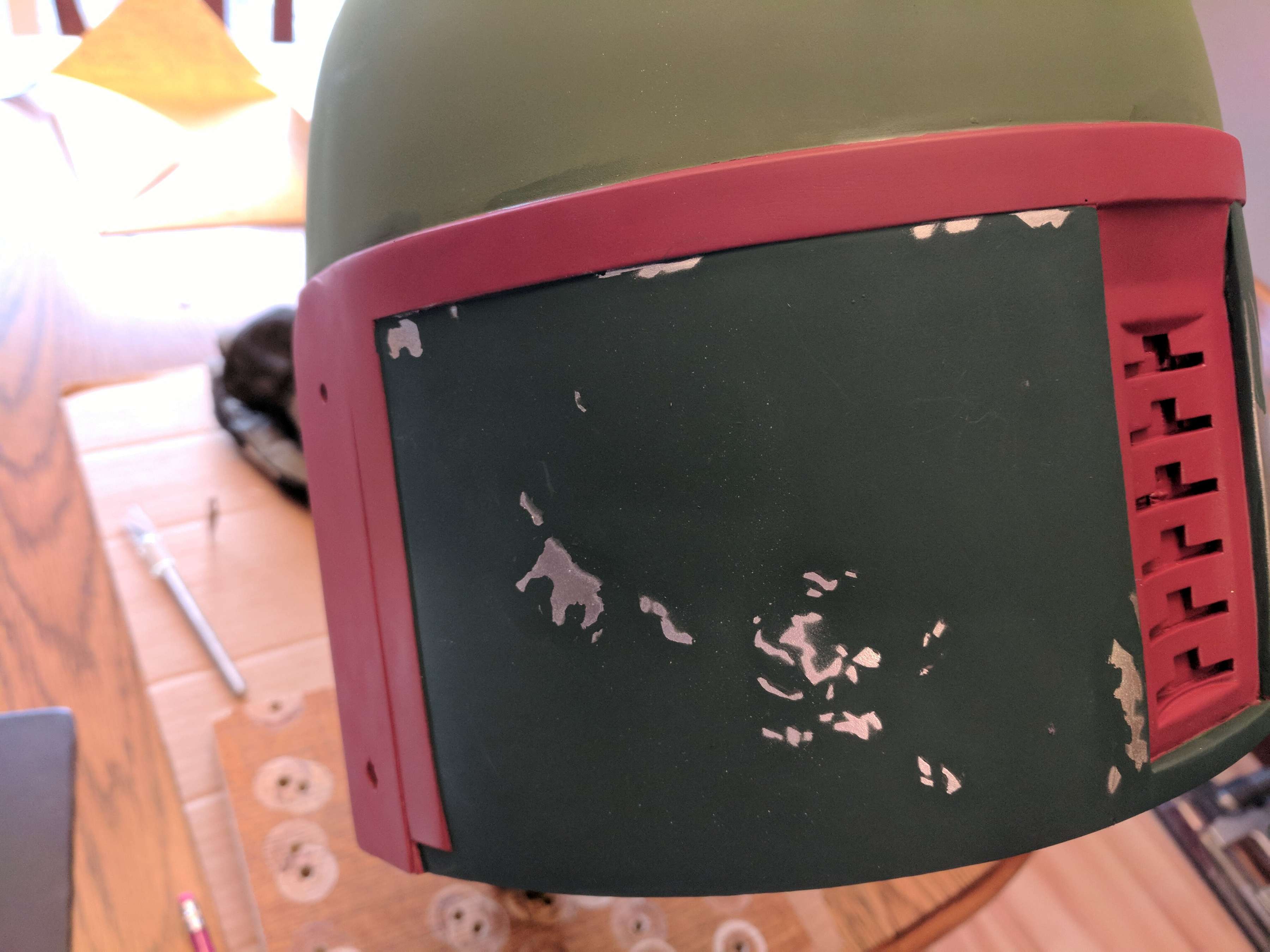

Made some progress over the long weekend.
Completed both of the main back panels and started on the red pieces on the back.
RG44GPoo1LJ31VgJ_3gwltvwxzzJyMaraKCs1n2Ft3jmNR5C9o9t-MGcqiA?width=4048&height=3036&cropmode=none.jpg
pMk1XvxvtiU1OAUEUc5t6zosP_FktVE3atZK9UDnpvYtqPF98d-uEoVwKAQ?width=4048&height=3036&cropmode=none.jpg
_qz-VfVoayBe9PLR67-hHgdprj-3rGJMY5cW08MLPApN3yuR8Wq-P1VLiEA?width=4048&height=3036&cropmode=none.jpg

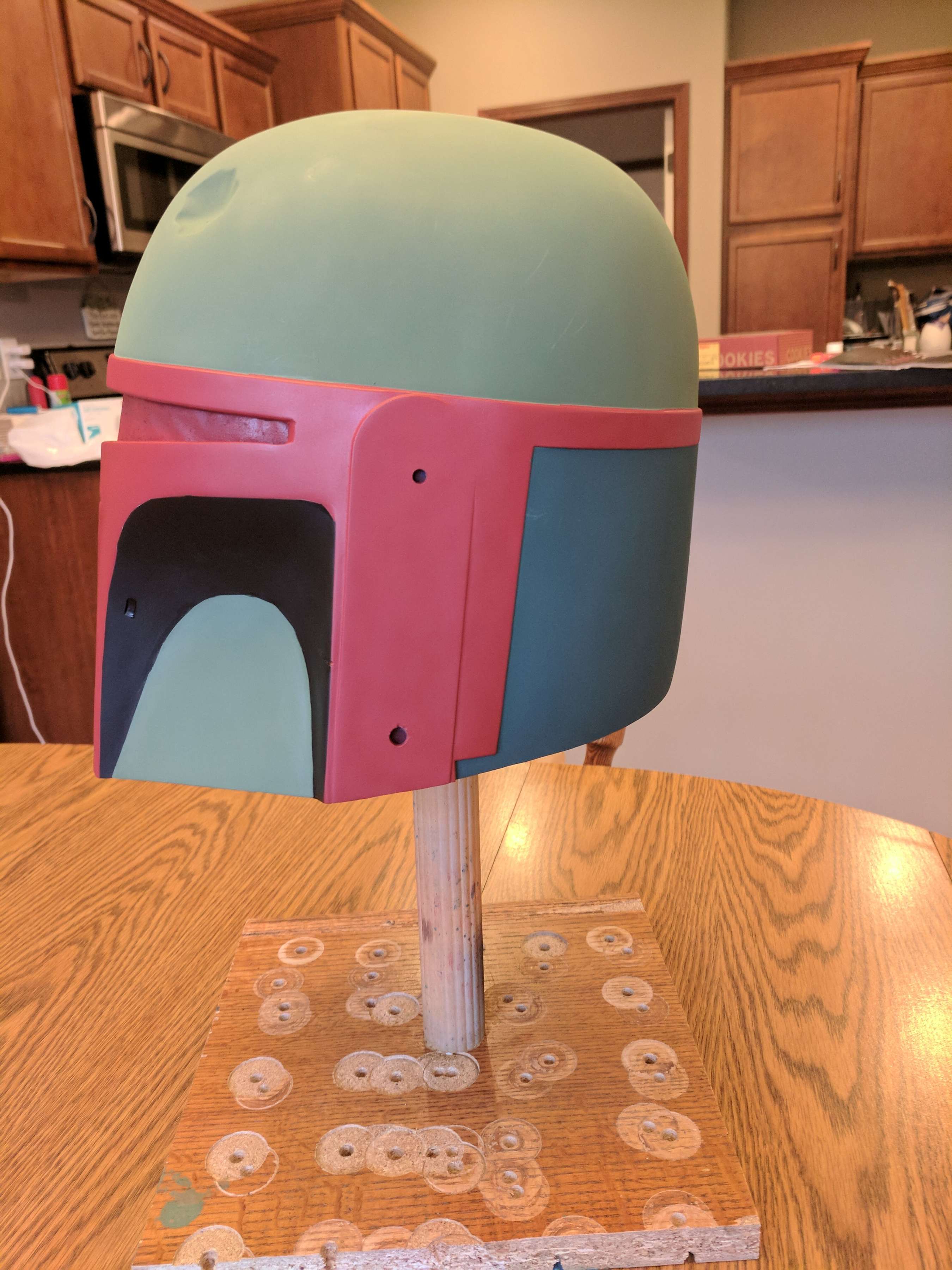

Also got the silver and base grey on the front pieces.
s3TcDsacIxM-IJlWQ1mk-1tJjDNj8RAFKObg3thgofFvs1wA2GMnZEAWNeA?width=4048&height=3036&cropmode=none.jpg
It still amazes me how long the prep for each color takes. It's literally hours spent stenciling and masking and about 1 minute painting. Although it drives me a bit batty, I love seeing the progress with each step.
