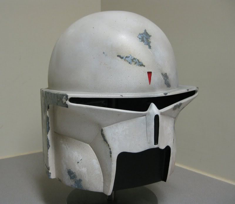

I don't have any progress pics on this one, just the helmet as it stands right now. Although there's only one drawing of this helmet (that I'm aware of), I wanted to paint it up as it might have appeared in the Star Wars universe, and that of course means. . . weathered!

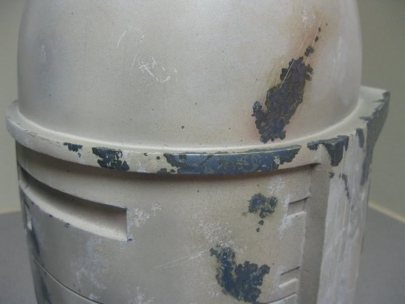

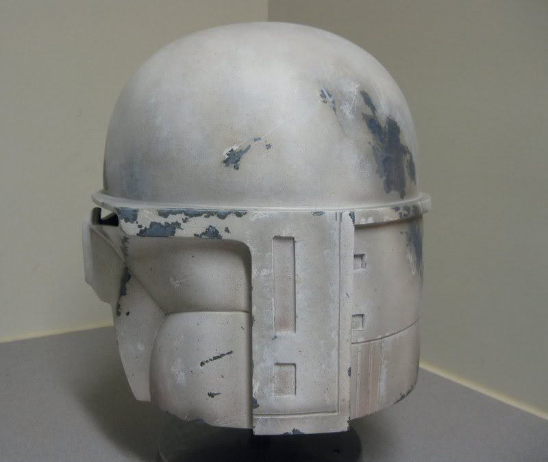

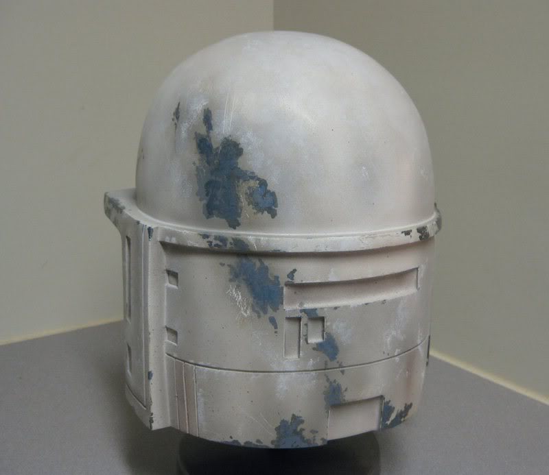

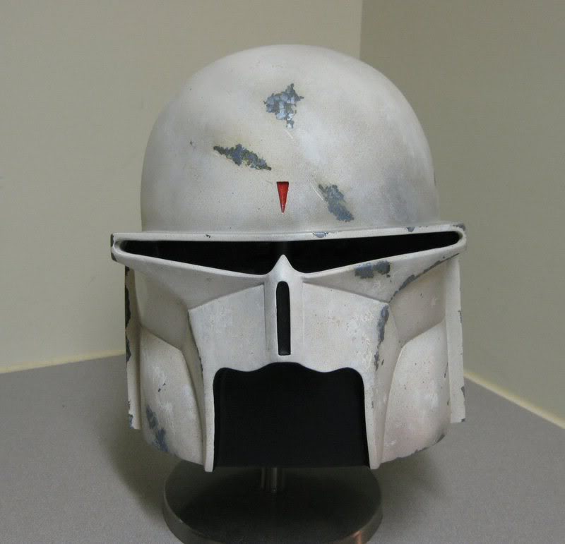

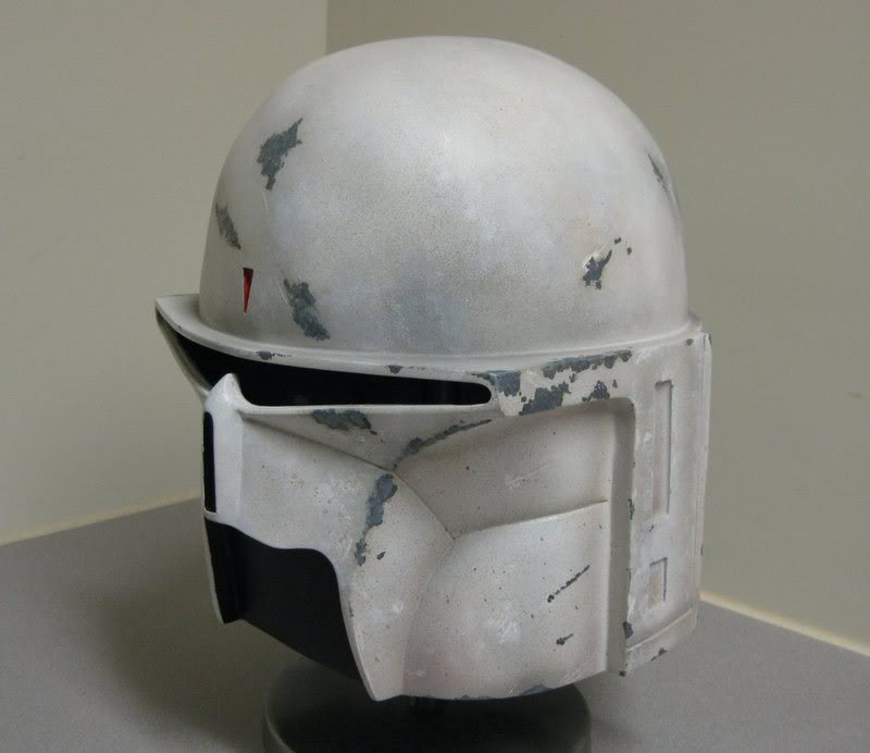

Here's the helmet after my weathering frenzy this evening.
I started out by trimming out the visor section, giving the helmet a light sanding, and spraying a base coat of plain ol' Krylon gloss white. I did a couple of light coats, not worrying too much about getting a perfect finish.
After the base white coat dried, I began the weathering process by sponging on some Tamiya Field Gray in random areas. I was going for an effect similar to the weathering on the ESB helmet.
I used a smaller chunk of sponge and added some Floquil Gun Metal. This is a darker, bluer metallic than the Bright Silver a lot of us are familiar with.
Once that portion of the weathering was done, I got out the airbrush and started dirtying this bad boy down! I airbrushed 4 different tones, again putting them on in random, streaky patterns. I used Polly Scale Earth, Boxcar Red, Reefer Gray, and PRR Brunswick Green. Hmm. . . I wonder why I would have those particular colors lying around??? ;)
After letting the airbrushed colors dry, I went back with a small chunk of sponge and some Testors Acryl flat white and splinched some white back on in some areas. I wanted to sort of give the appearance that the helmet had been banged around even after getting all dirty.
(Yes, I did use the word "splinched." I like making up words :lol:)

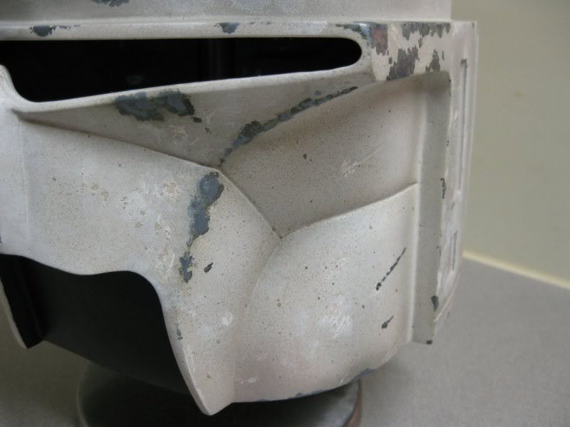

After the "splinching phase" I went back with a Microbrush and reapplied the Gun Metal color, and used an old dental tool to make some smaller scratches on the helmet. I also scraped down to the bare resin in some spots. Just another aspect of weathering.

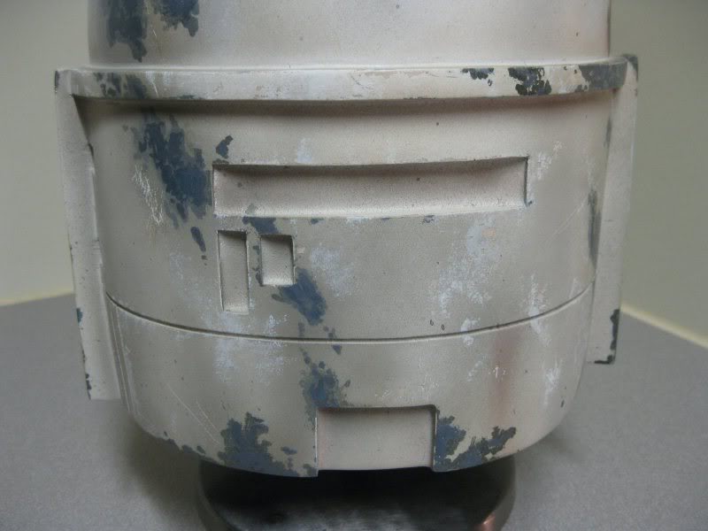

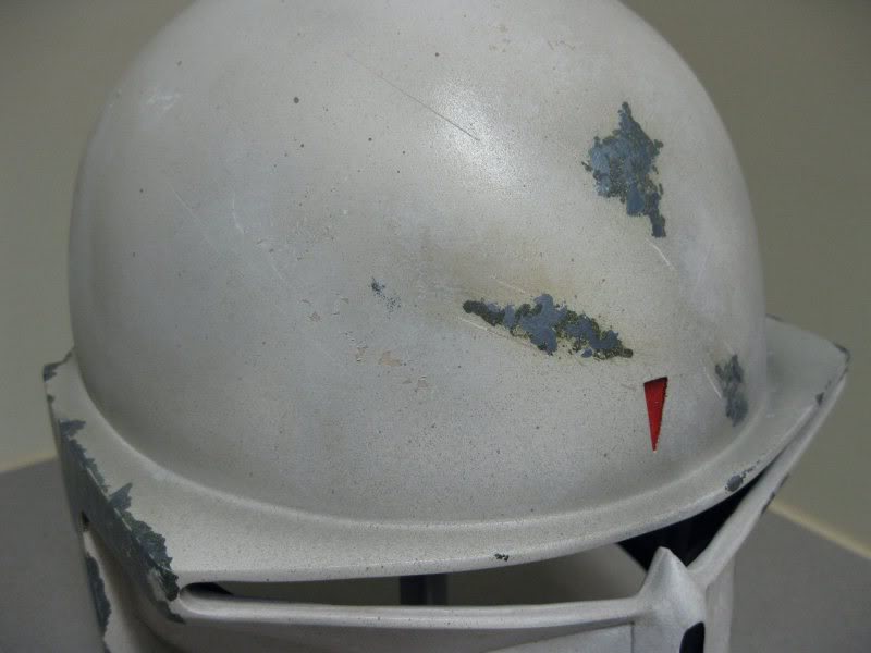

Here are some closer shots.

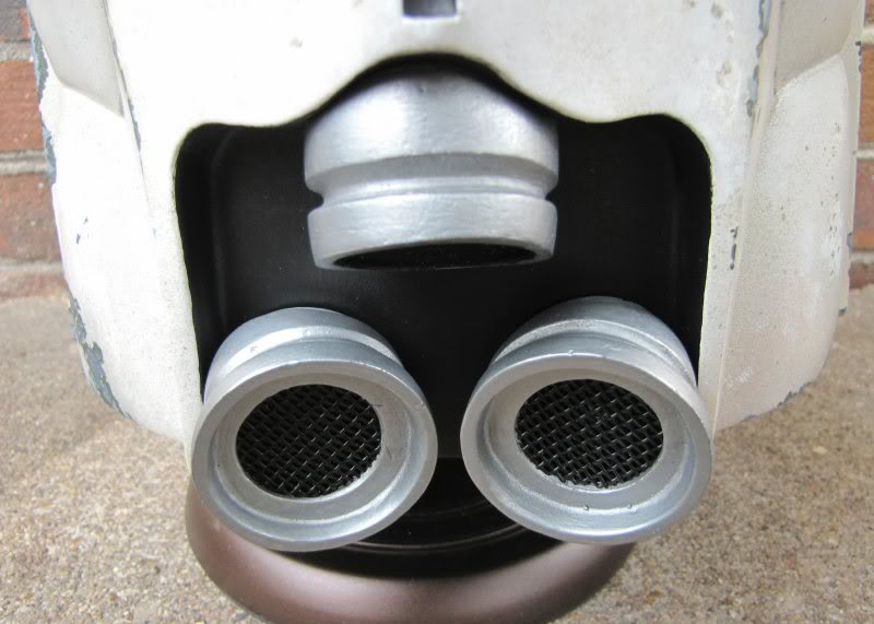

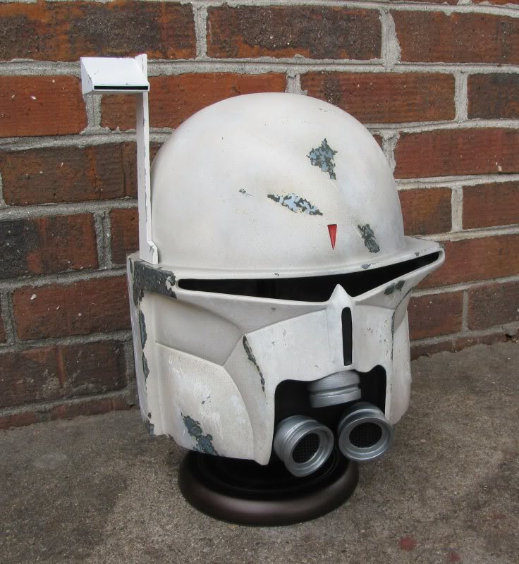

All I really had left to do was work on the aerators and RF assembly. For the aerators, I finished sanding and trimming, then gave them a coat of Model Master buffing metalizer in Titanium. The flat faces were painted in basic black, and I added some black plastic screen to the two lower ones. Just some added visual interest.

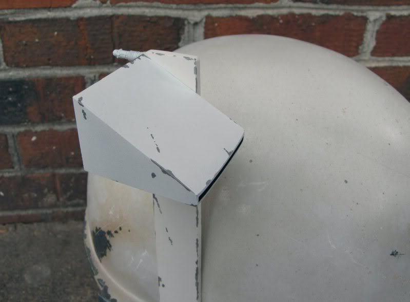

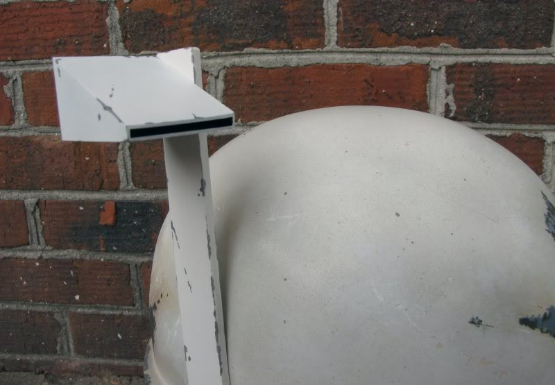

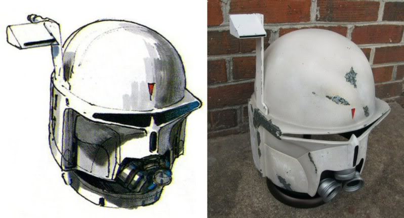

Now, I made a big change from how Jason designed the RF stalk and topper. First I decided I preferred to have the RF on the right side. This was based on the "published" version of the original McQ sketch. I know there's some debate whether this was intentional or not, but it's what I chose to do. :) Next, I decided to scratch a new RF topper. In the drawing, it's a very basic wedge shape. Jason had sculpted a really nice RF that had more of a streamlined shape with a couple of simulated LEDs, but I wanted to stay closer to the concept drawing. I also built my RF stalk much shorter than the way Jason had sculpted it. In the sketch, it appears that it comes just over the apex of the dome, whereas his is significantly taller. Again, just personal preference.
Here's an overall comparison of my helmet to the artwork.
I made the RF stalk from some Sintra I had left over from another project, and made the topper from some 1 mm black styrene sheet. I used black because the little slot in front is actually open, and it was much easier to just spray the exterior white than to paint all the interior faces black before assembly. (I'm lazy! :D)
In this angle you can see I added a small doohickey at the back of the stalk like in the drawing. It's not exact, but the stalk is too thin to add a fatter detail.
Another shot.

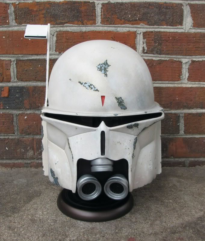

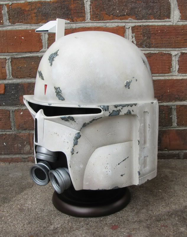

So here are a couple views of the completed helmet. I bought a little bronze colored paper towel holder to display it on. :)
I think this was the longest Fett project I've done to date! But that was based on being overseas and not having access to all my hobby stuff. It's a really cool helmet, a terrific sculpt by Skygunbro, and I love having this addition to my "Fett Lineage" collection.
