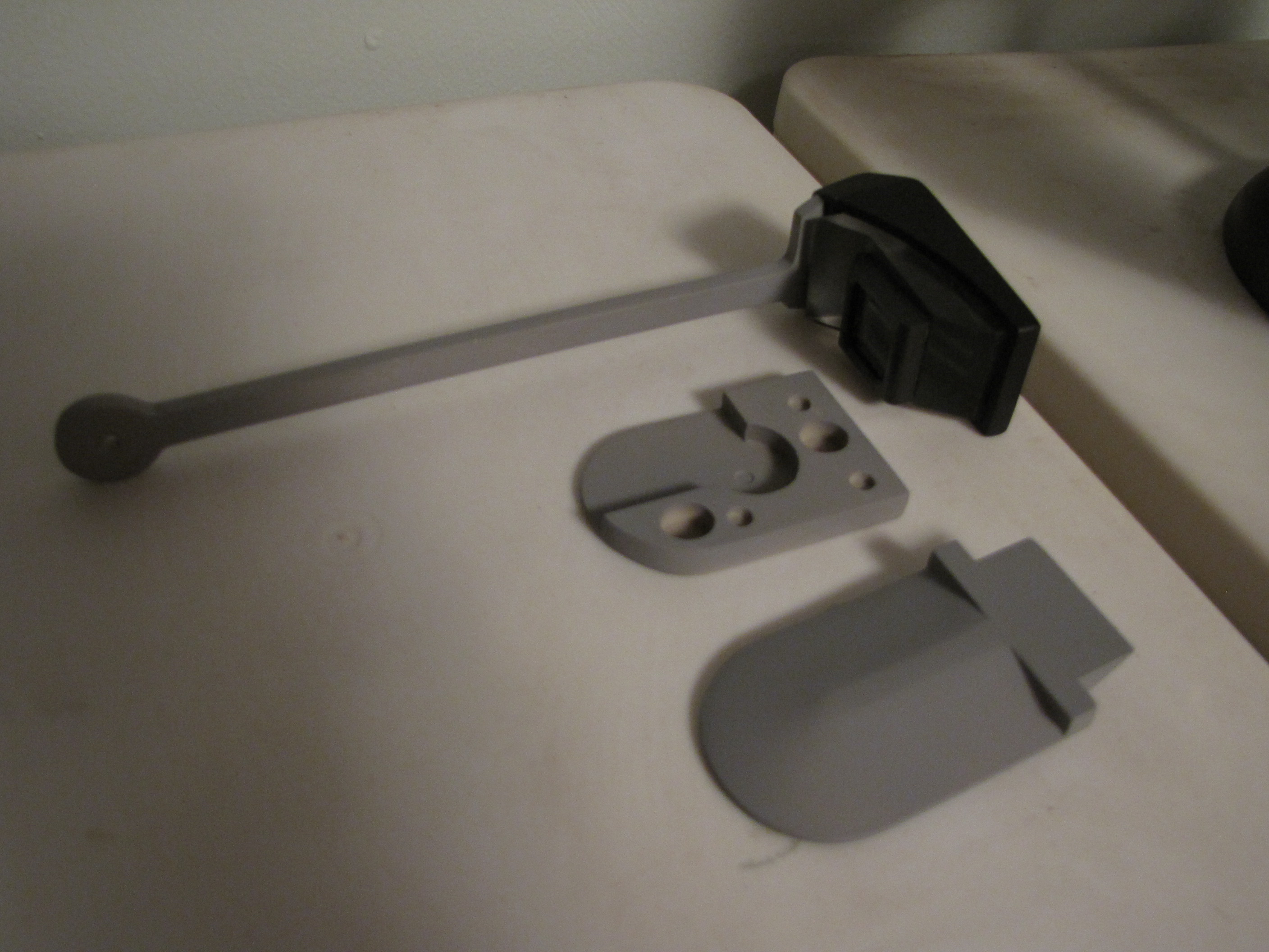

Here is a shot of the kit's parts. Again, I have done nothing to the components. . . these are right outta the box.
The RF parts (I have press fit them together for this pic). I had ordered the 'deluxe' RF as part of my order, and it came like this. Fully assembled, painted, with 2 non-functional red LEDs. Very nice satin black finish.
Here's the circuit board part, which fits very nicely behind the keyslots.
To top it all off is a well formed smoked visor.
A very comprehensive kit, eh?

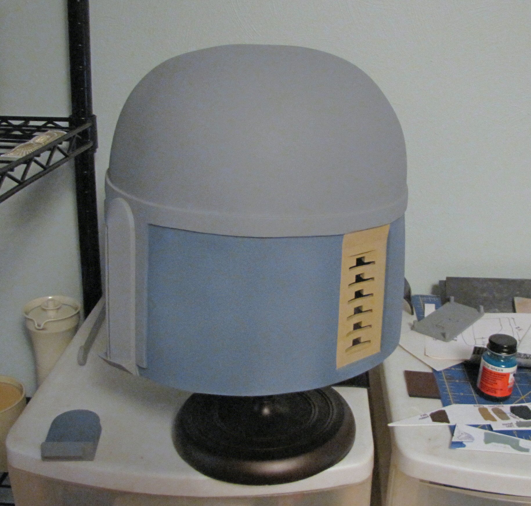

OK, off to a good start here. :) The following pics show the first 2 stages. I first masked off the helmet except for the keyslot area and painted it with Floquil Foundation. It's a similar color to Concrete, like on the ESB helmet. Once I get all the colors on and begin to do some pastel weathering, the tone of this color will shift slightly.

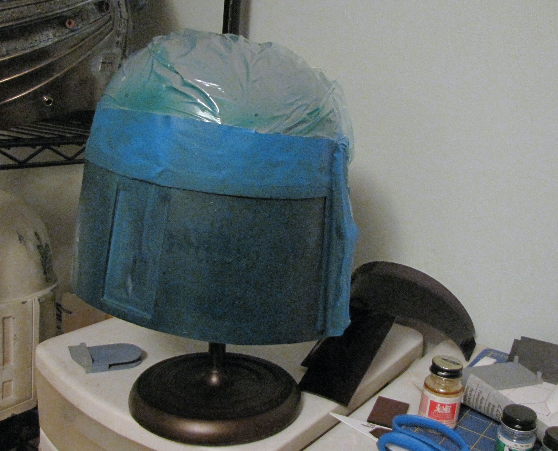

Once the Foundation was dry I masked it off along with the bulk of the helmet, leaving the rear panels and right ear exposed. This was airbrushed with Polly Scale Intermediate Blue.

The next step will be rather time-consuming as I will have to make tracings/templates for the damage on the rear panels. This will be much trickier than working on my usual ESB paint jobs because the reference isn't nearly as comprehensive. I'll have to use what I have and try to extrapolate for the curvature of the helmet. Once I get that done, a dark green will be airbrushed on.

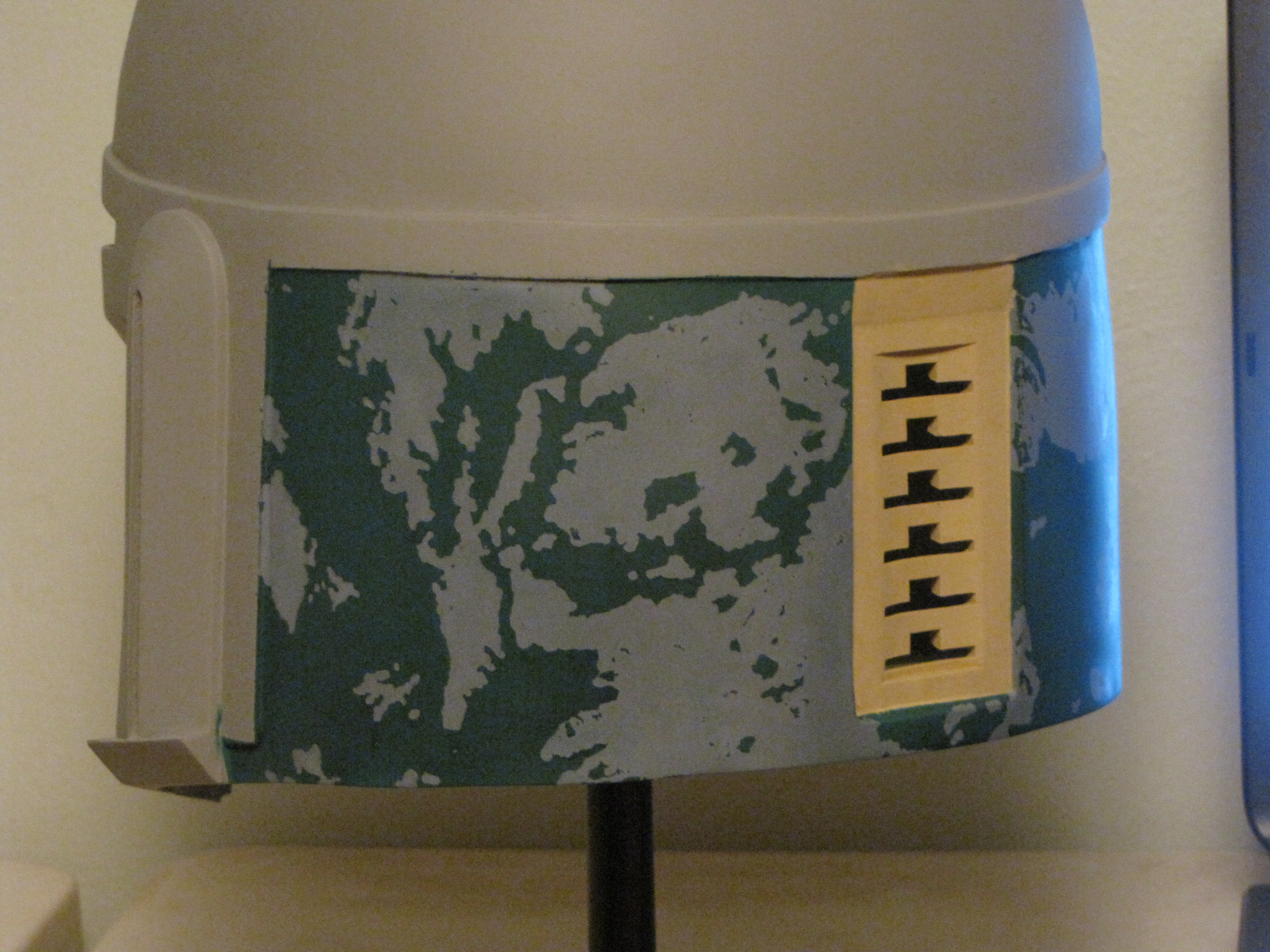

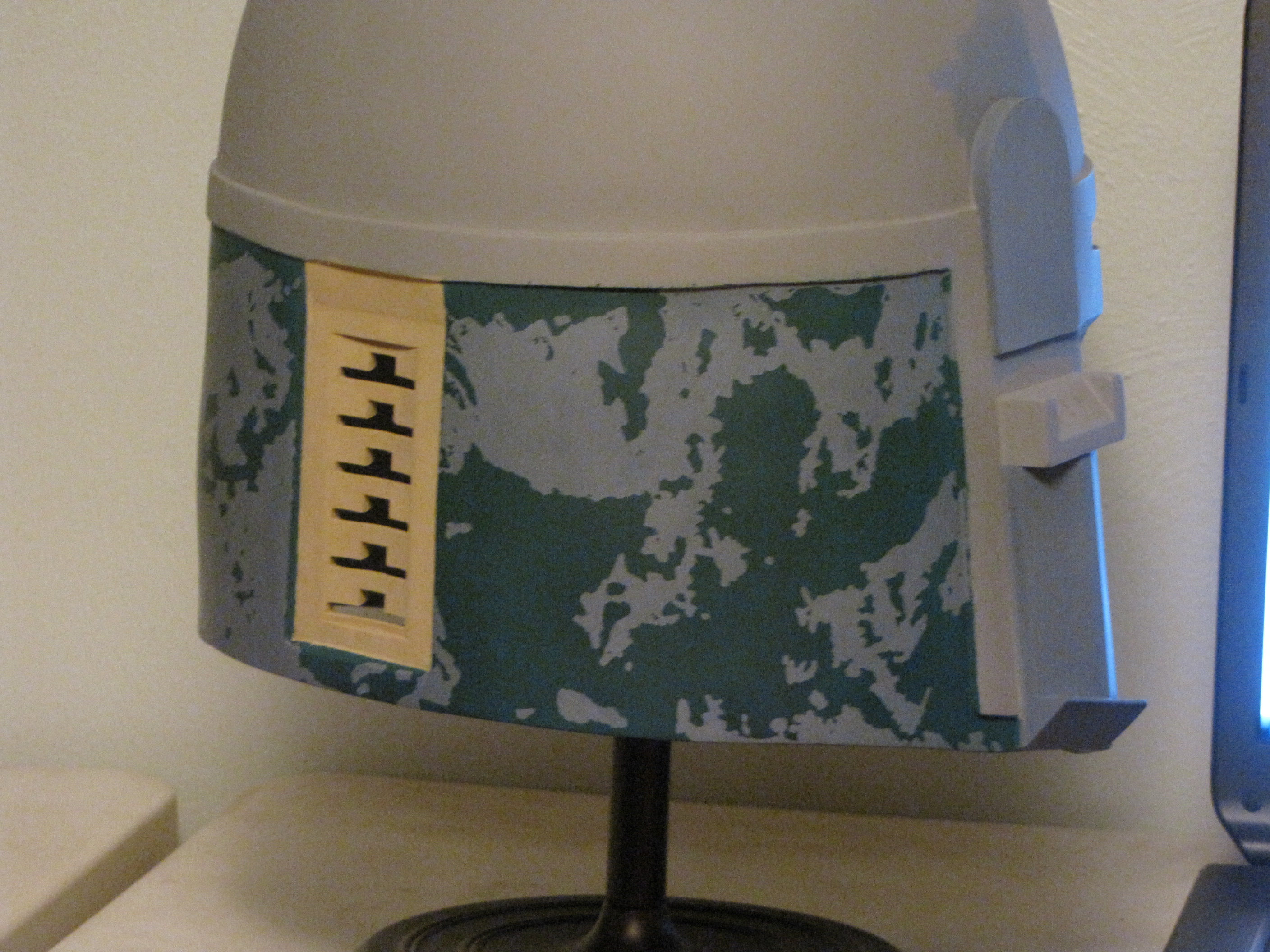

Took a handy rubber cement eraser and went over the masking fluid on the rear panels. It rolled off pretty well to reveal the Intermediate Blue. I'm happy with the results. :)
Here are 2 shots.

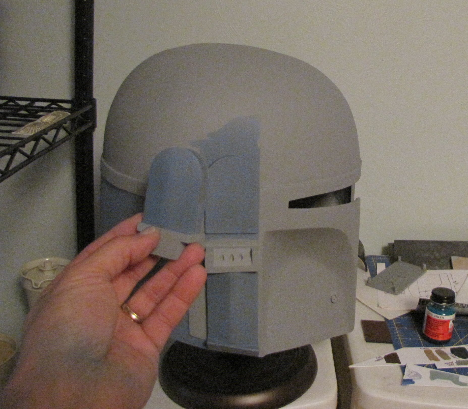

Now here's a pic comparing the right panel with one of the only four reference pics I used to lay out the damage patterns. I'm not a huge photography expert, but I tried to match angles as best I could.
Pretty close? Still a little tweaking to do, and I need to add some silver chips, too.

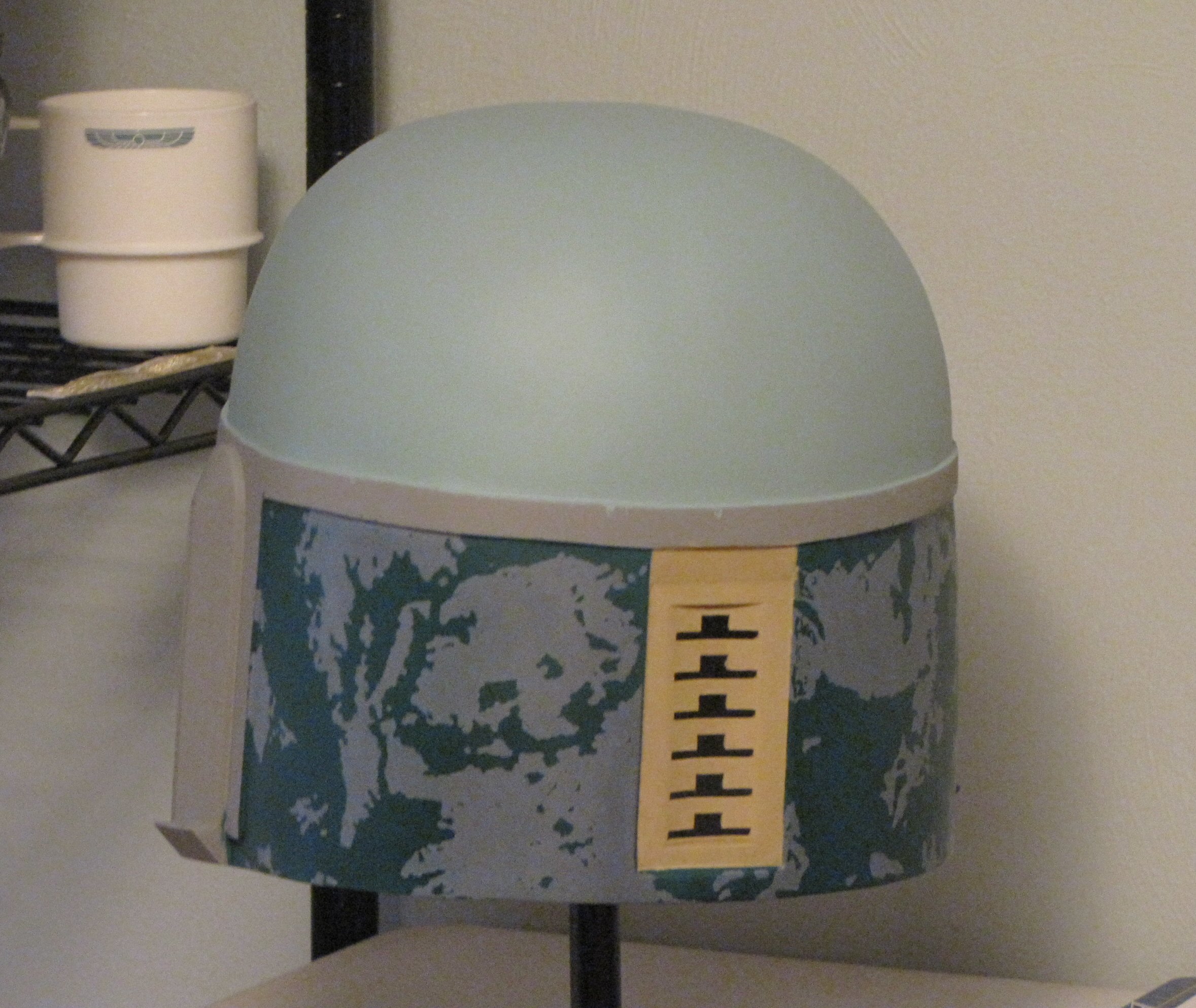

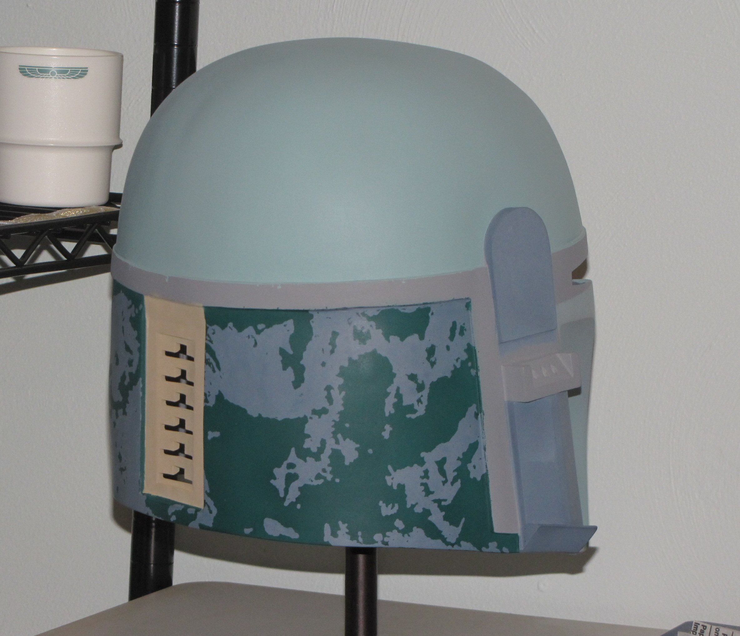

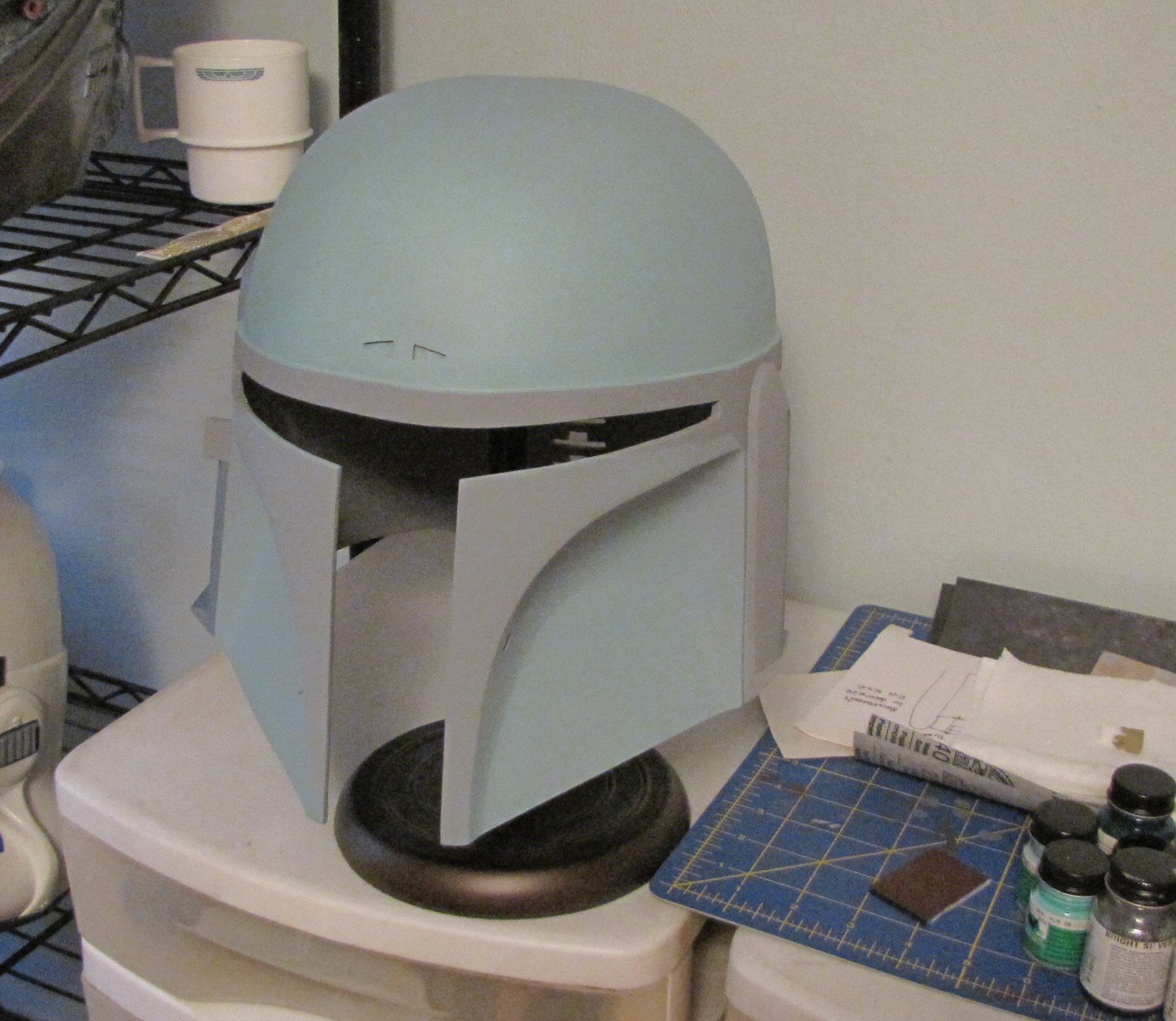

Looking a little more colorful now! Got the dome and lower cheeks done. This was one of those colors I went back and forth with many times. As I just mentioned, Ryan was a tremendous help in narrowing down the choices. What I went with was Polly Scale RLM 78 Lt. Blue. As military modelers may know, RLM colors are Luftwaffe colors.
Since this is by no means a pristine helmet, I decided to slightly tone down the RLM 78 with Polly Scale RLM 65. This is pretty similar to the RLM 78 but with a more grayish cast to it. I just misted it on unevenly. I think it gives a very slight oxidized look to the base color. It's hard to even see in these pics.
