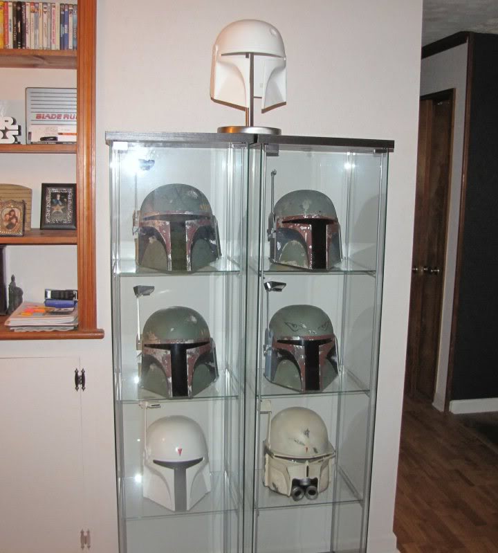

Here's my current helmet collection in my shiny new Detolf display cases. I picked them up a few
weeks ago and they're fantastic for helmets!
But wait, who's that poor unpainted guy on top of the cases? Why it's. . . Shabad's GMH! *gasp*
This is one of the resin helmets, and it's just as gorgeous as the gelcoat version. Superbly cast and smooth
as a baby bounty hunter's bottom. (There are baby bounty hunters, right??)

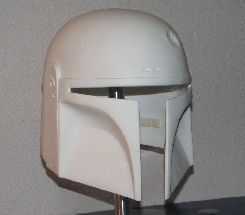

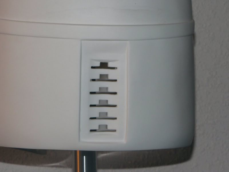

I spent some time out in the garage doing the cutting, trimming, sanding, and filing to get it ready for paint.
Using the trusty ol' Dremel with a cutting wheel and a sanding drum, I got the visor and keyslots cut out.
Finish work was done using my jewelers' files.

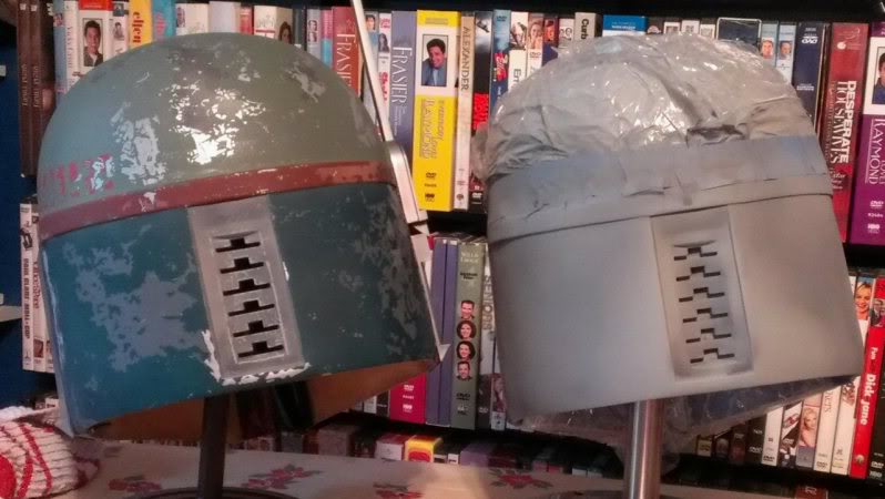

Here's Shabad's GMH 91 alongside my number 9. :)
This is also a photo experiment as I took this shot with my new HTC One S 8MP phone camera. Not too bad!

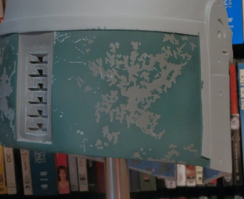

I started by stenciling and using liquid mask for the damage patterns. Rafal's templates came in very handy
as usual. If anyone's painting a helmet, I highly recommend checking out his templates. Even if you choose
another method, they're an amazing reference and may show some details or patterns that are tricky to make
out from reference pics. The darker areas below show where I have applied my Winsor & Newton masking fluid.
The fluid dries pretty quickly, so I was all set to airbrush the green. I took a cue from Jayvee and experimented
with CNW green mixed with another Floquil green in varying ratios. I wound up using a 3:1 mix of CNW Green and
Southern Sylvan Green. I think it brightened the tone just a touch and came out looking great! Thanks for the
tip, Johnny. (y)
I misted the green using Reefer Gray, and I began adding some of the tiny chips and scratches as well.

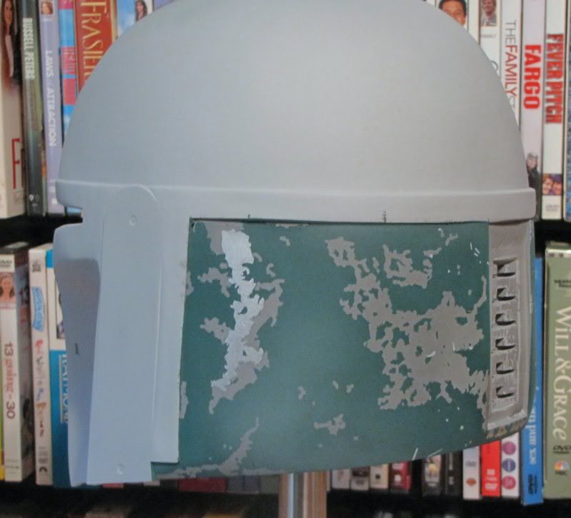

Here are a couple of shots of the back panels.

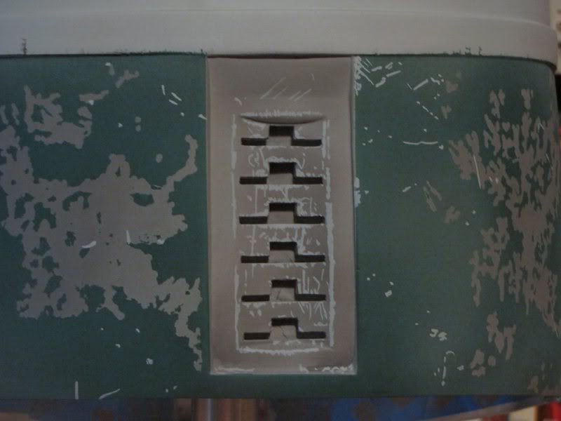

Another closer shot showing the fine scratches in the keyslot area. All the fine scratches were done with
Floquil Primer and a size 000 brush.
The final stage for the back panels will be to add the silver. Then it's on to the dome and cheeks.

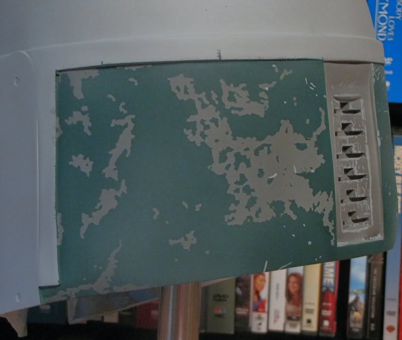

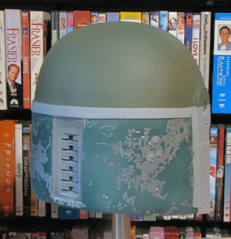

Back panels complete! :) I stenciled on the silver areas and painted them with Floquil Bright Silver.
I love using this paint. It levels and blends very well.
Rafal's templates were a huge help. His right panel template is more defined than the set I used when I
painted my own PP2. You're getting the improved version, Luke!
Here's the helmet all masked up for the next step: the dome and cheeks.

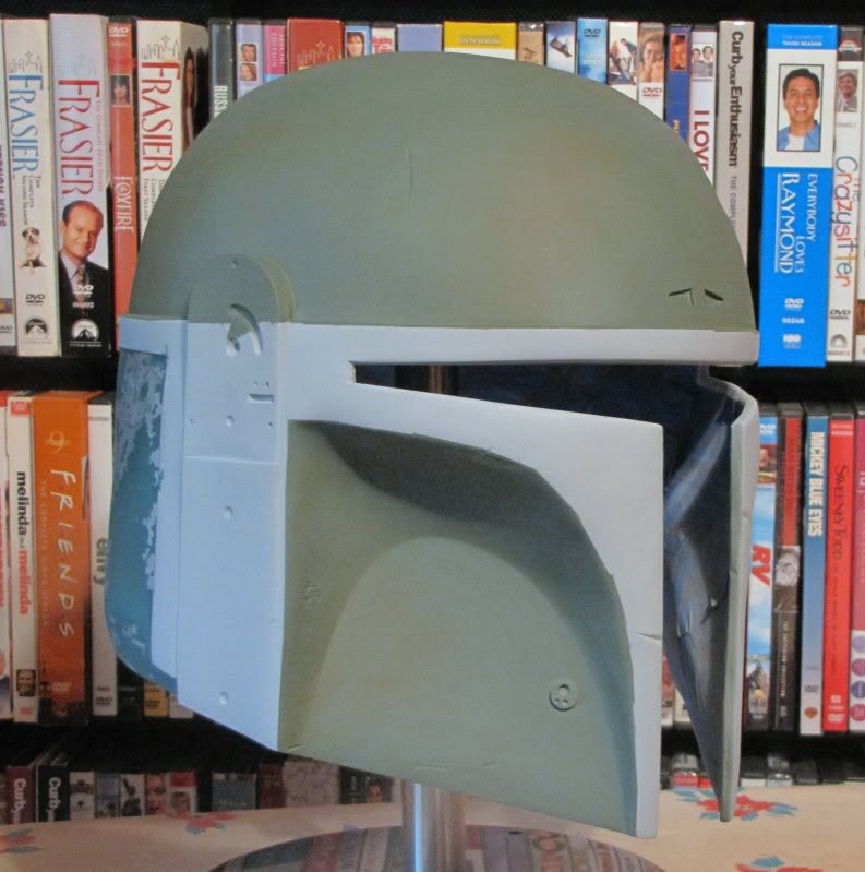

UPDATE: July 7th, 2012

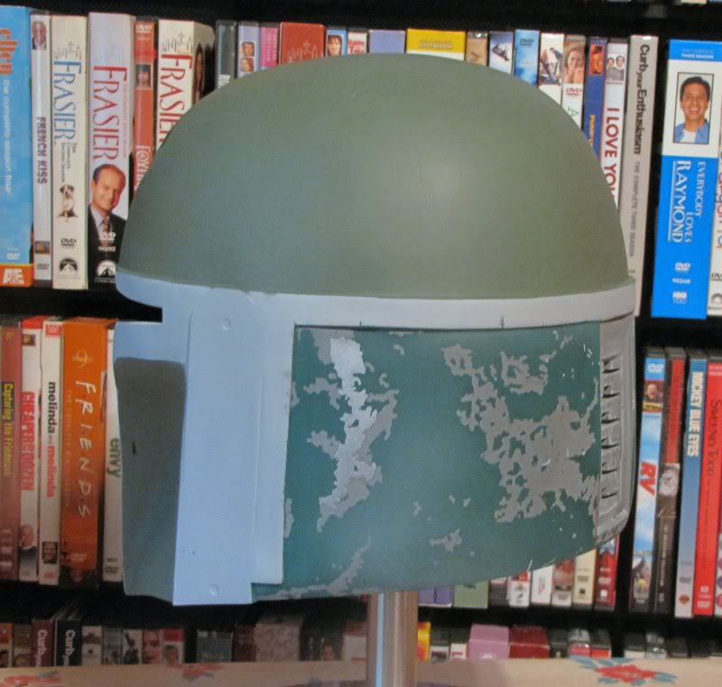

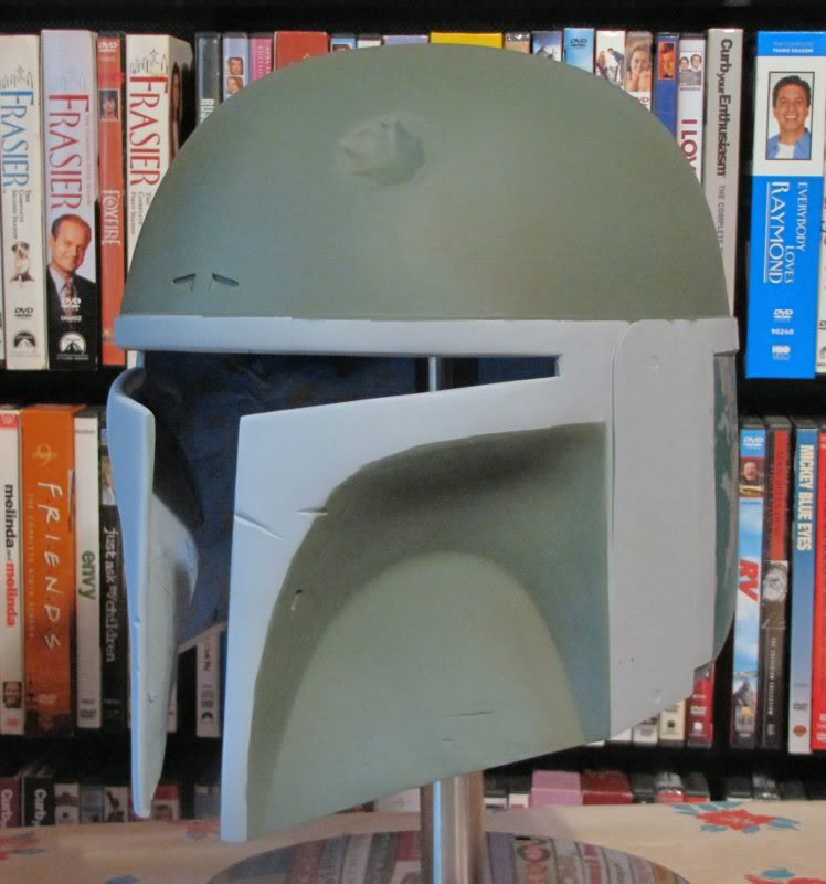

Dome/cheek stages 1 and 2 complete. I sprayed on the base green and then the olive misting.
Most of this will change tone with later mistings of gray.
Here are a few shots around the helmet.

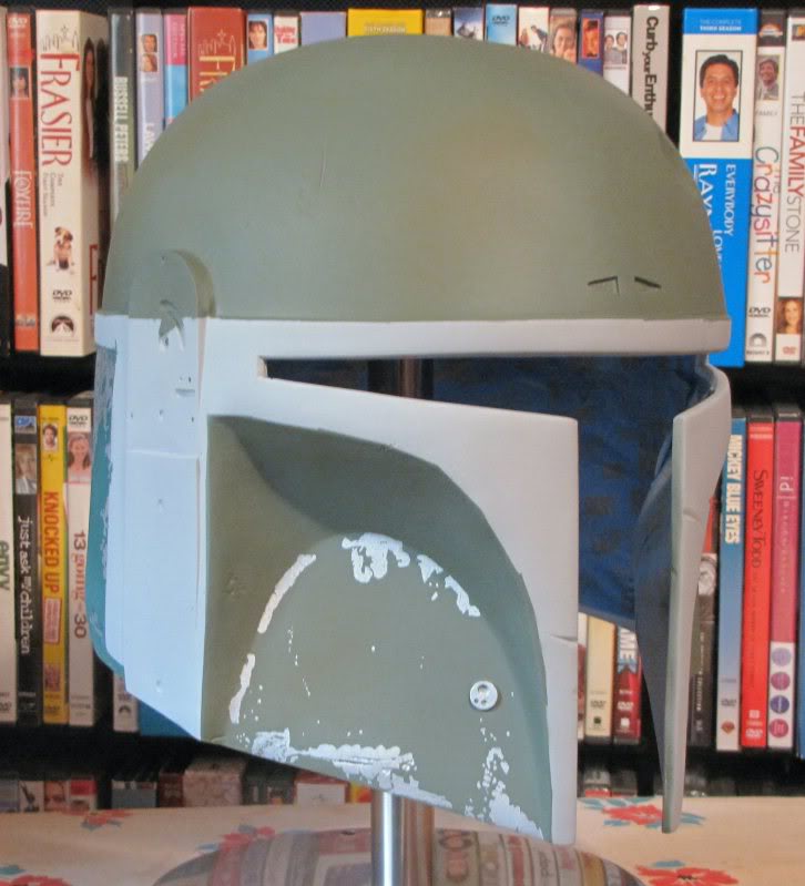

UPDATE: July 8th, 2012

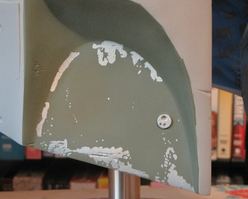

Got an early start this morning and did the first section: the lower right cheek.
Here's a closer look.
