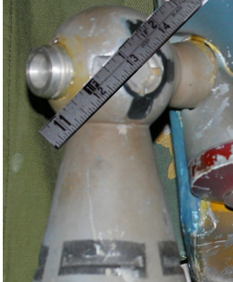

http://www.thedentedhelmet.com/gallery/g569-boba-fett-return-of-the-jedi-jetpack.html
You can CLEARLY see next to a ruler FFS the size of the thrusters. This isn't much of a stretch that theyre about 3"
Look here for example
Probably more important is relative sizes. Meaning, the thruster ball is almost as big around as the "tanks". And, the large end of the cone is bigger than the ball, that sort of thing.

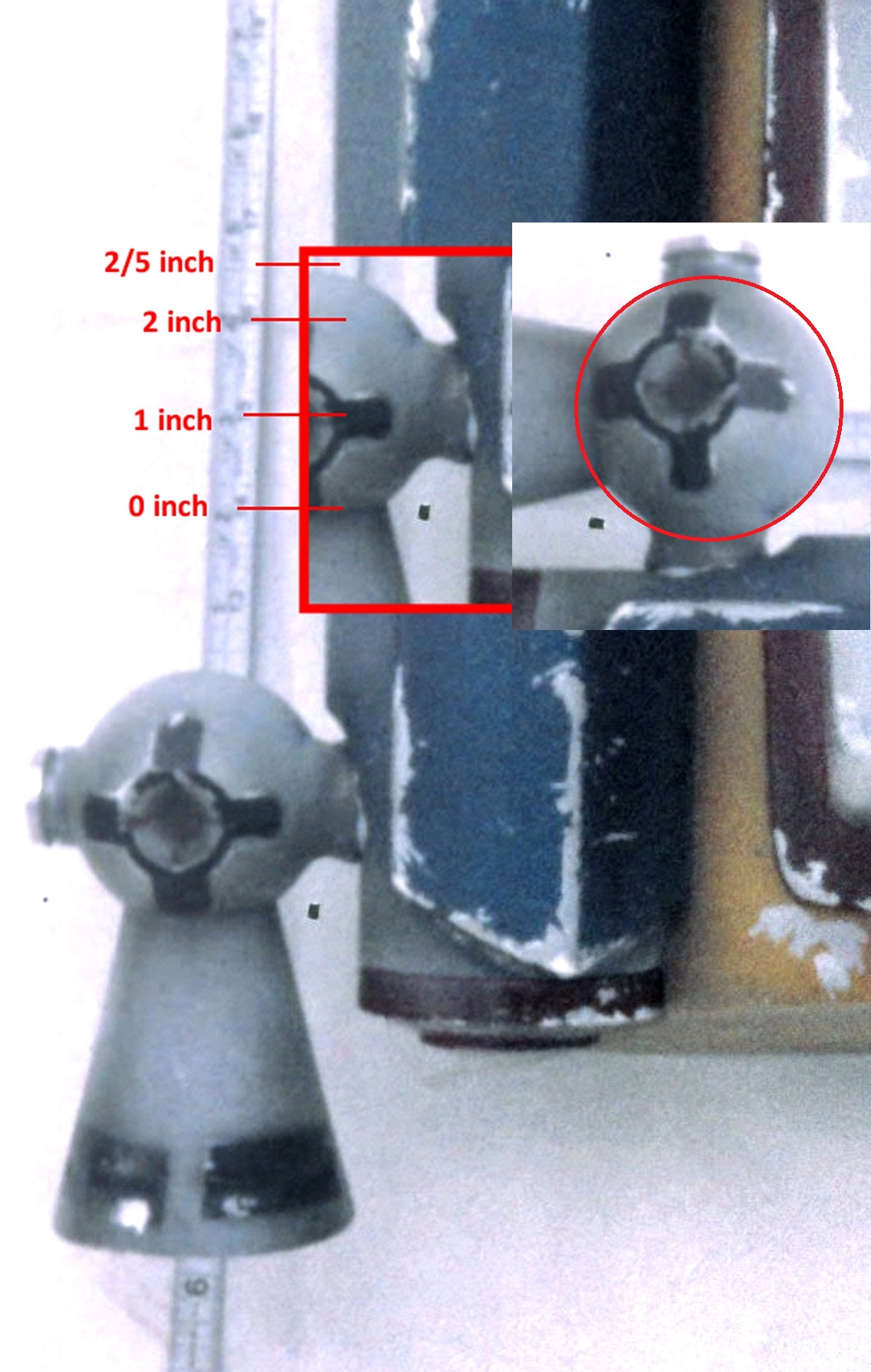

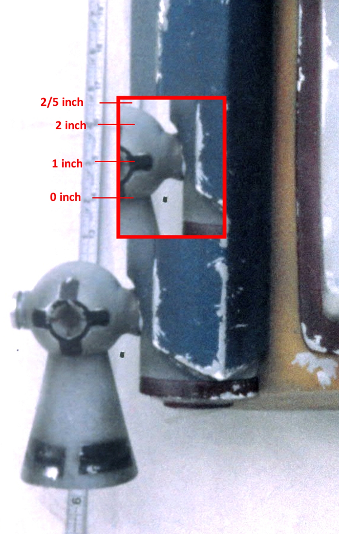

The thruster balls have around 2.5 inch (or 61-63mm) diameter:
Also note that the uler is much lower than the thruster ball, so the 2.5 inch might be smaller. On my 3D model the thruster ball has a 61mm diameter or 2.4 inch.

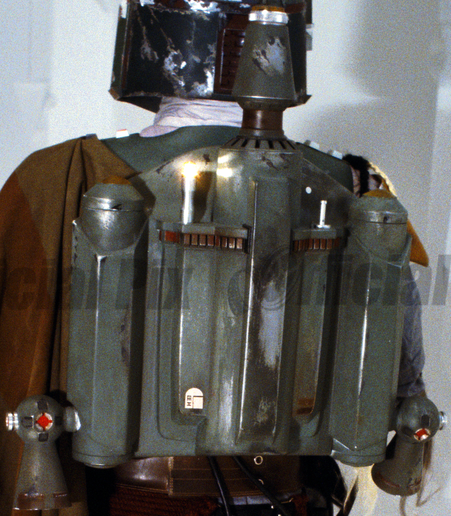

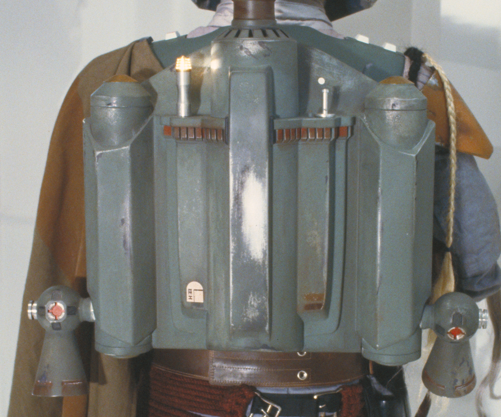

Also it looked like the thruster ball was about the same diameter as the fuel tank tops which im pretty sure are 3" and i think keegan had also agreed with this size for the fuel tank top diameter.
I agree with this throwing the perspective off...I think theyre closer to 2.75" and if they were a full sphere theyd be about 3" like Lou is saying but since the sides/bottom are flattened it throws off your measurement

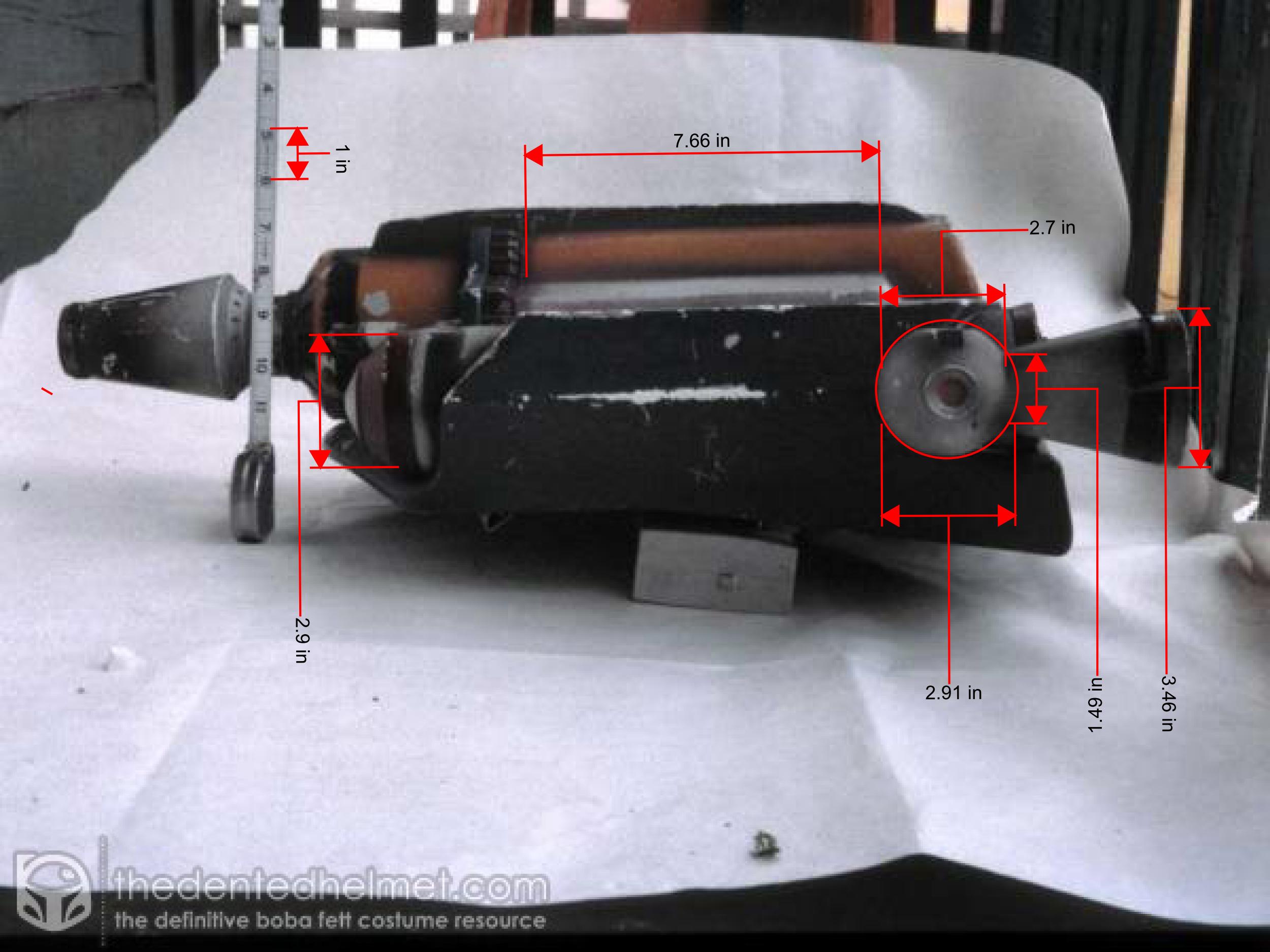

Been doing some checking as well on this & I agree with what Raf came up with in that top view but if you go by the side view the arc on the back side of the ball & making a true circle it is coming out to be 2.9" for the ball diameter with the distance from the narrow portion of the cone to the top of the ball at 2.700". The problem with the photos is that there seems to be some lens & perspective/depth distortion that skews things. The areas of the attachment & where the cone meets the ball give the illusion of it as an oval in that top view giving it a squashed look. I have the tank caps at 2.9". Here is a photo of the side view that gives merit to the larger ball diameter.
But with this the bottom of the cone gets much larger as well which doesn't show well in that top view. By going with the side view it is checking 3.46" at the large end of the cone.

All that said depth perseption plays a big part in the photos as well. Even trying to base the thruster ball size off of the stabilizer..the thruster ball sits further back than the stabilizer which would make it seem smaller trying to check a measurement on a flat photo. So again, it supports the thought the ball is bigger than the measurement we'd get.

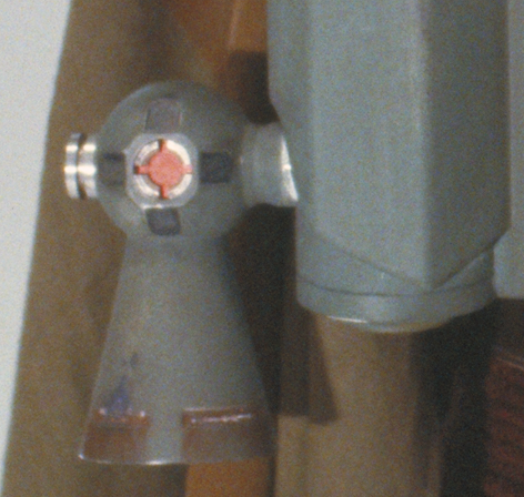

Here is the cropped part of the promo pic i thought showed the size the best:
here is the main part of the photo:
here is another shot:

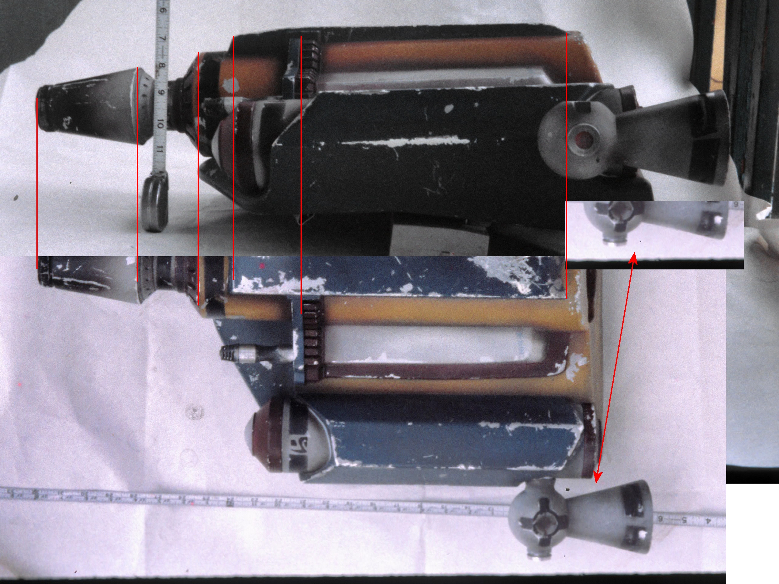

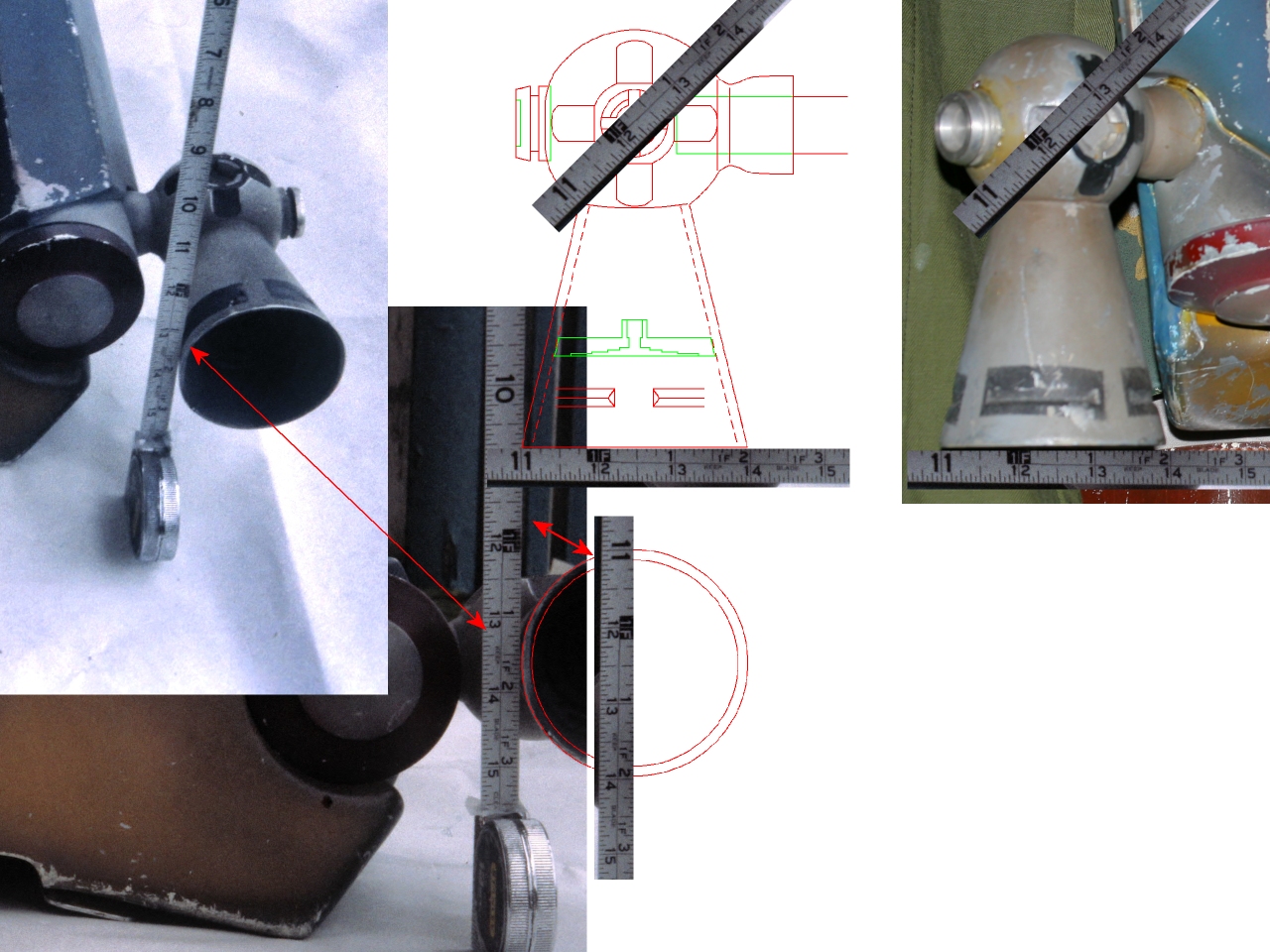

I don't recommend the use of that image with the measurement tape as a guide for the thruster, as the tape sits on the rocket base which is further back than the thruster. This image shows the difference in shape when viewed from another angle:
I agree Raf, that tape measure is way further back than where the thruster is.
See those measurements are saying its 2.5"..which is what i made mine, and why. The one image on the upper left, you photoshopped the ruler on, which leaves room for interpretation. i could do the same thing and make it appear 3", or 2".
see:
You are showing there the cone bottom at 3" and the ball at 2.5", which is exactly what i have on my kit, which again compared to what i saw in person, is smaller than it actually is. But it does show the proportioning is correct. So Toolguys measurements seem closer to me to what they should be going by what i saw in person at the exhibit.
There is no way to get the size of the measuring tape that close in scale with the actual thruster..there are to many variables..it will always be slightly off. And since we are talking about a small amount of size over a sphere its very hard to get right. Even if we assume your rule size is correct in relation to the thruster, i can tell the difference between the size of a orange and the size of a grapefruit just by looking at it, and what i was looking at was bigger then my current thruster size.
So going by that.. i am telling you, the ones on the pack in the exhibit are bigger than 2.5". Now i suppose there is a possibility they made more than one set..why id have no idea, ..or maybe the ones on the exhibit are not the originals, but again mine are 2.5" i have held them in my hands and looked at them more than anyone should findle thrusters lol...while i was making them...and the ones on the display are clearly larger than mine.
