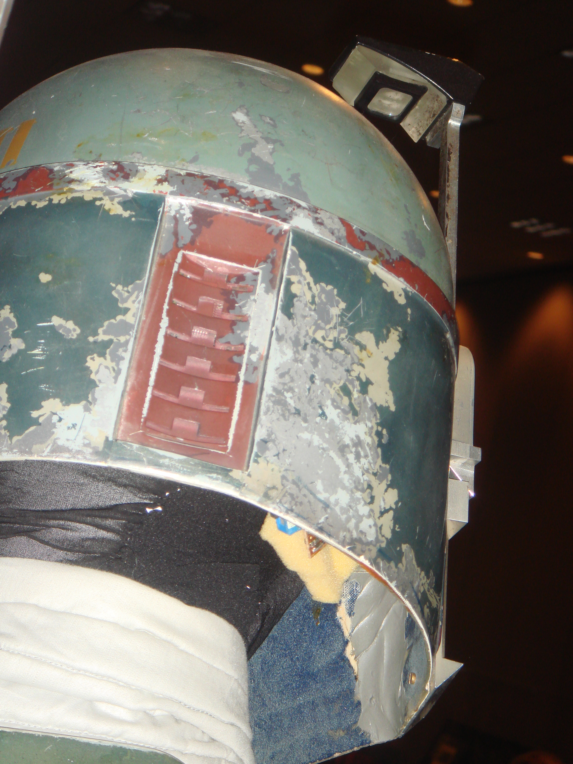

Some reference images from the C-IV exhibit gallery:
Boba-Fett-Costume-CIV-Britt-001.jpg Boba-Fett-Costume-CIV-Britt-026.jpg Boba-Fett-Costume-CIV-Britt-083.jpg Boba-Fett-Costume-CIV-Britt-251.jpg Boba-Fett-Costume-CIV-Britt-309.jpg Boba-Fett-Costume-CIV-TFP-025.jpg

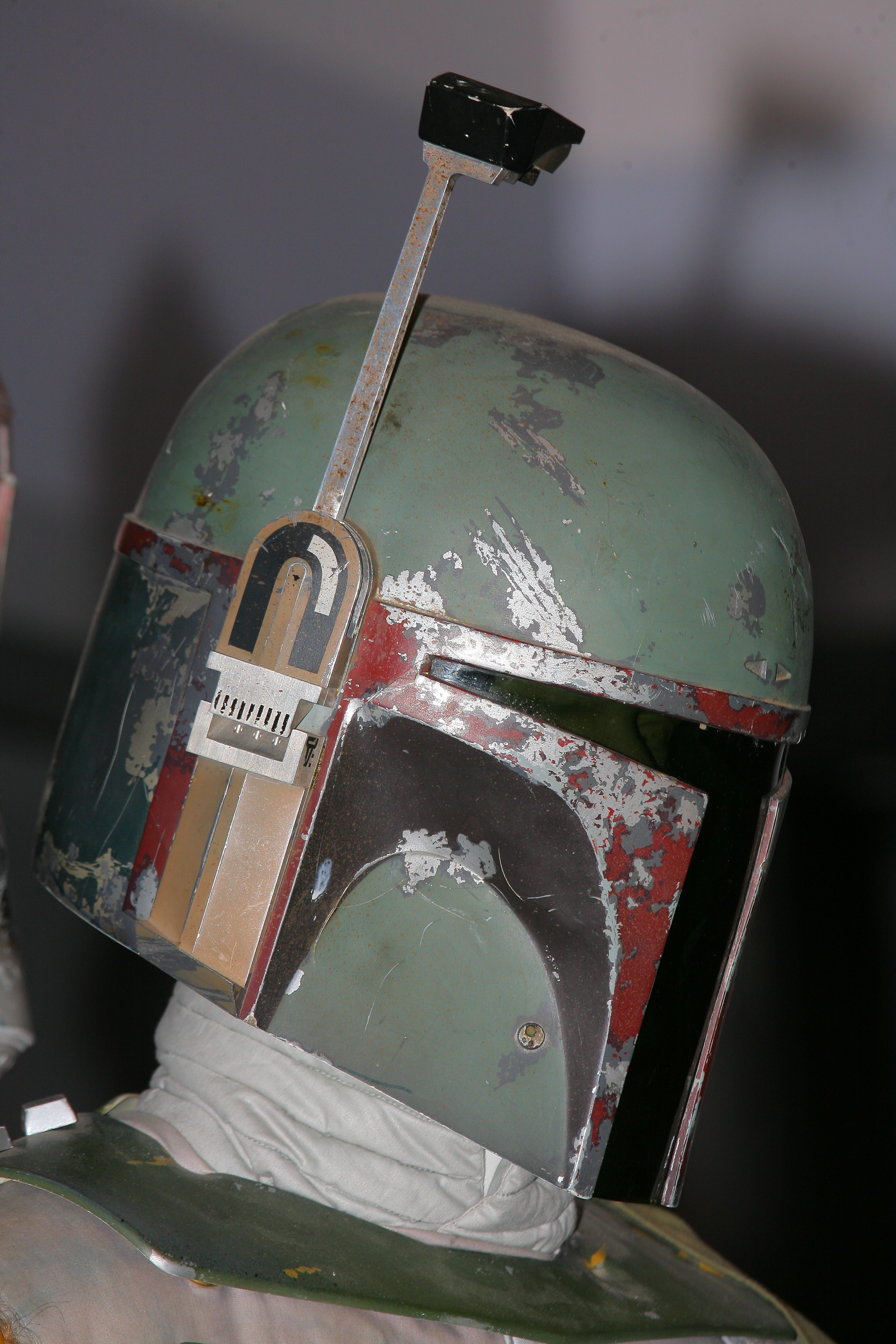

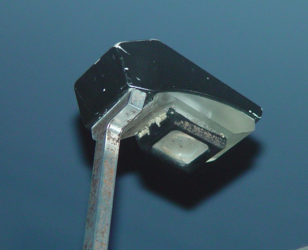

Few more detail shots from the same gallery too
It's worth keeping in mind though that it always looks a bit more muted in most all the set photos of the time; more dim and less noticeable, vs the super high-res flash photography of the Ceb-IV photos. You might wanna apply it a bit more conservatively if you're goin for the 'in the movies' look.

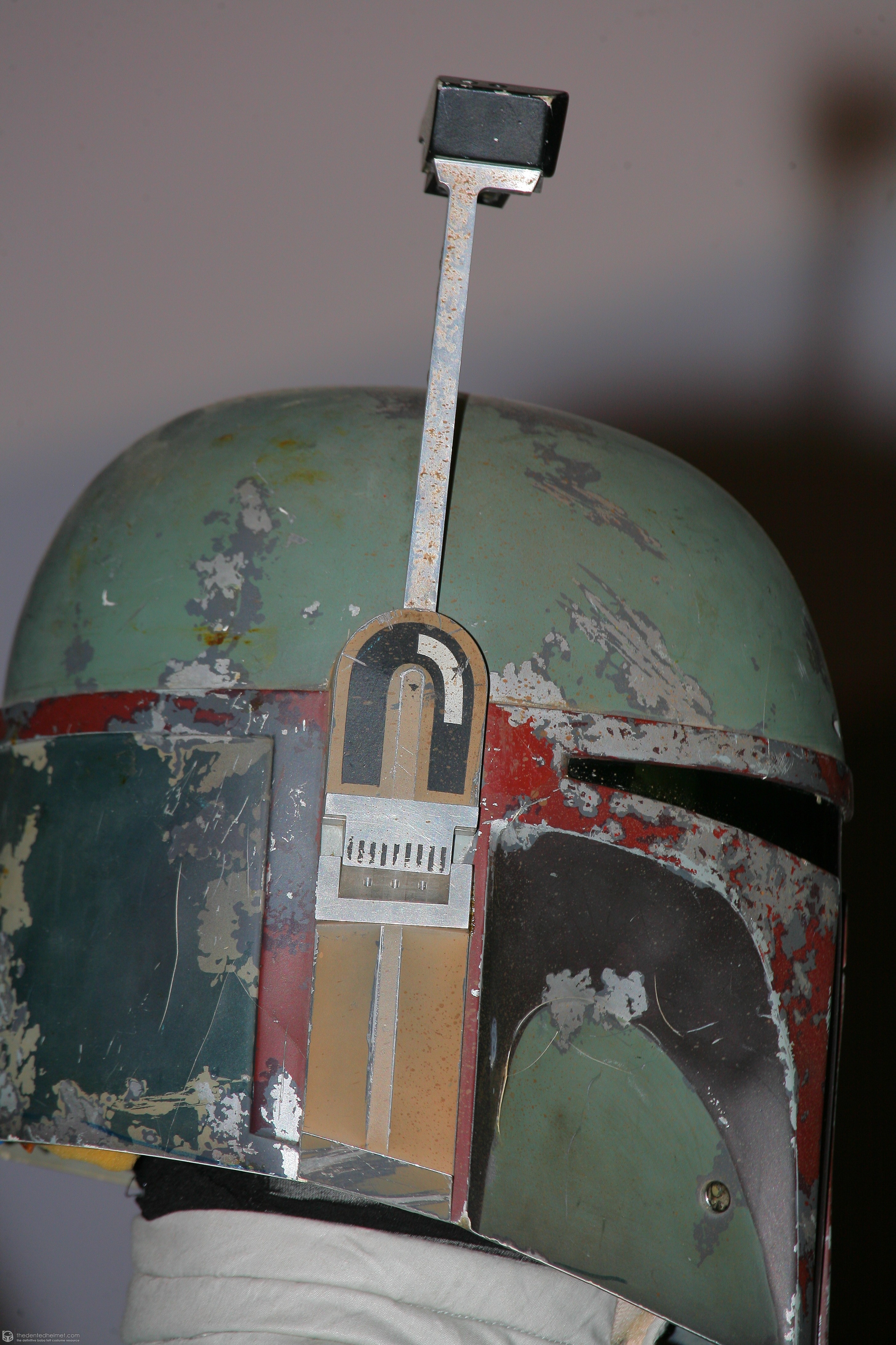

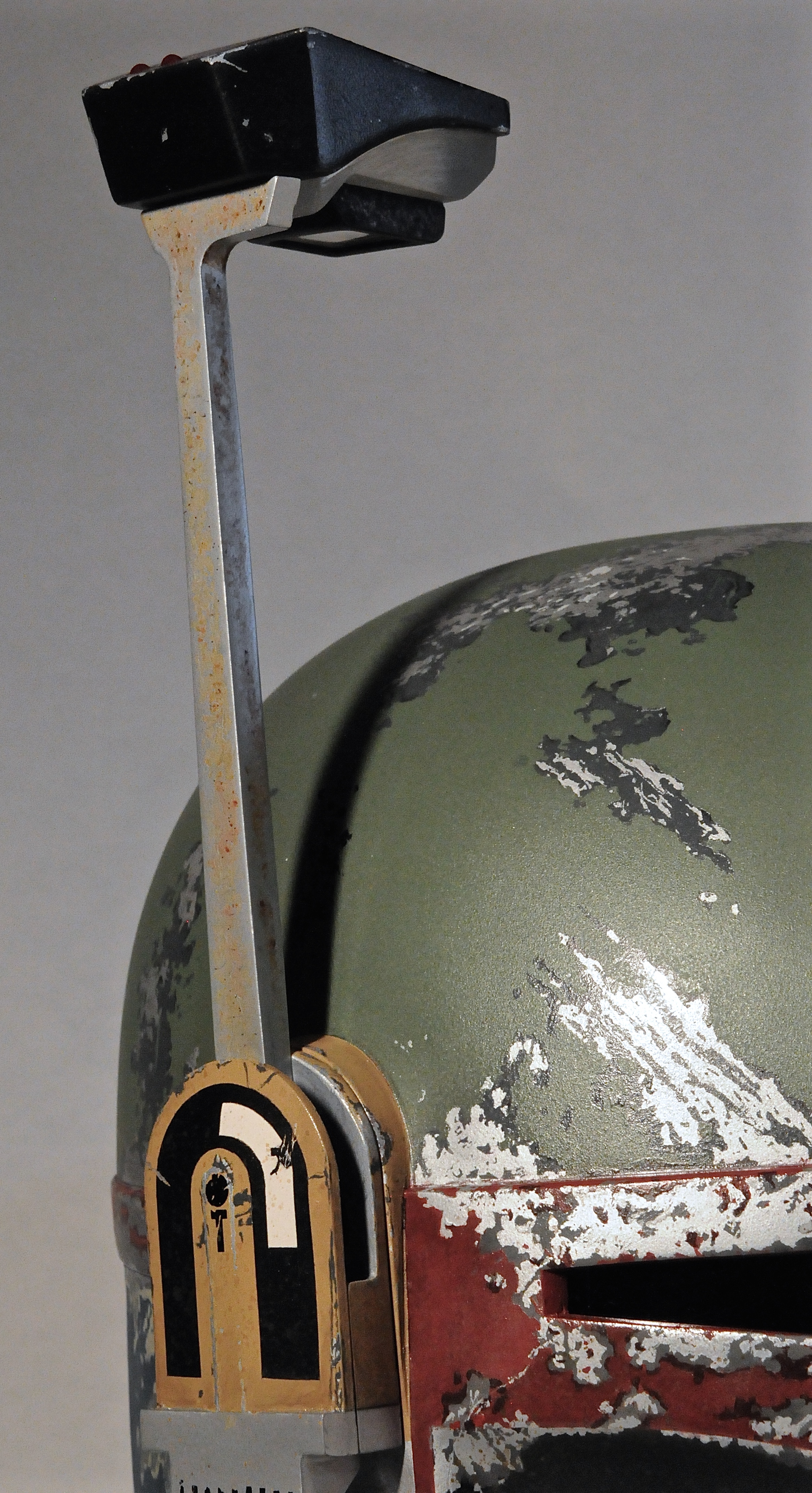

This is the extent of the weathering that I did. Just washed on a combination of rust and brown until it felt right to me.
Because I use enamel paints I just worked slow and let it dry a little between coats. Enamel wash over silver slides around a bit. The darker spots give you a basic pattern to start with. Remember that there is a balance of values in the colors in the different areas of the helmet.For instance,how much lighter in value is the stalk and its weathering than the dome colors? You have to make that judgement for your helmet colors. Make it look good to your eye. To me it's a moderate amount of weathering so the stalk isn't too dark. Value balance is almost more important than color in art. There are some close ups of my approach to the paint on pg. 2 of our costume thread. Hope this helps.
The big takeaway for me from my research is that the stalk is heavily weathered, but in the lighting for all of the scenes in ESB, you just can't see it very well. So the key is to weather it in a way that is is heavily weathered and yet washed out in the proper light. The spots that don't wash out in the light are leather colored paint. For the other colors, I used a mix of rust and earth colored Humbrol weathering powders.

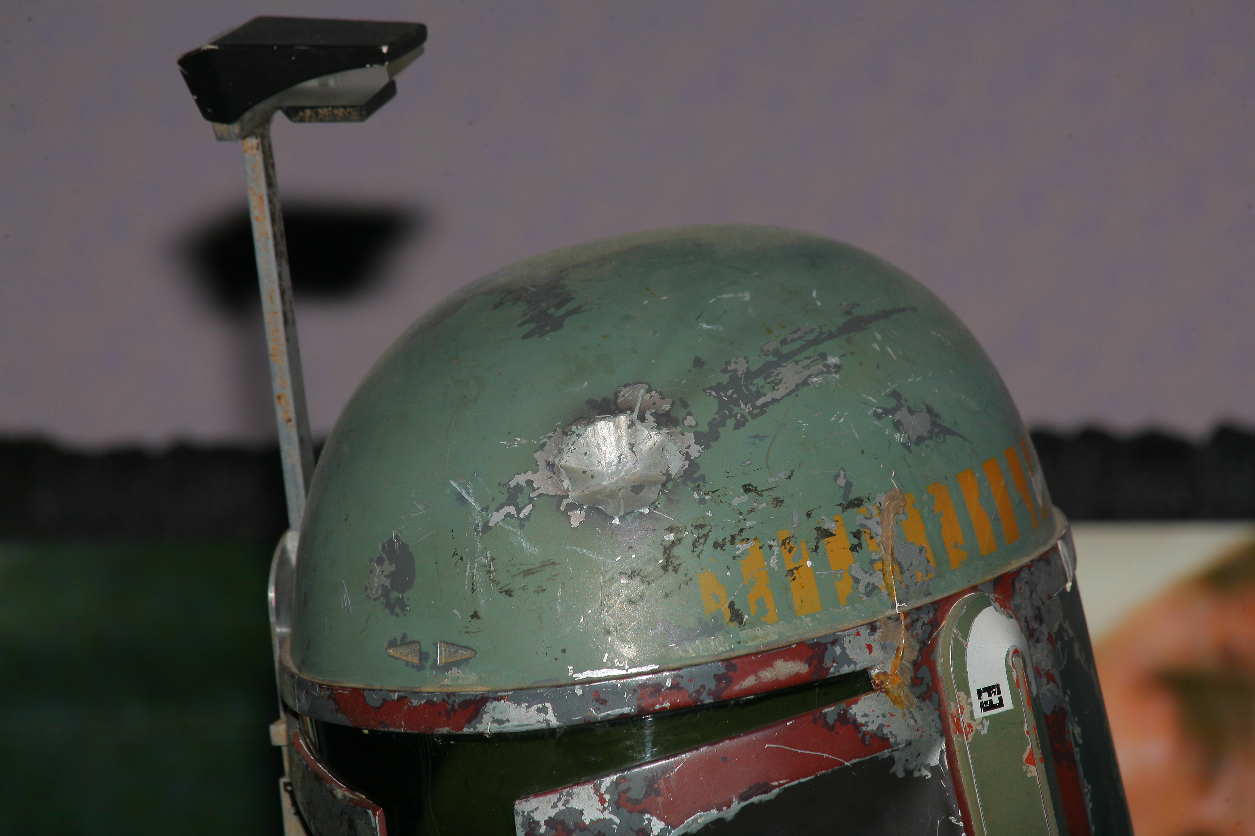

Here are a few more shots of our helmet just to show how, just as in the movie, light angle makes a lot of difference in the amount of weathering that you see.
