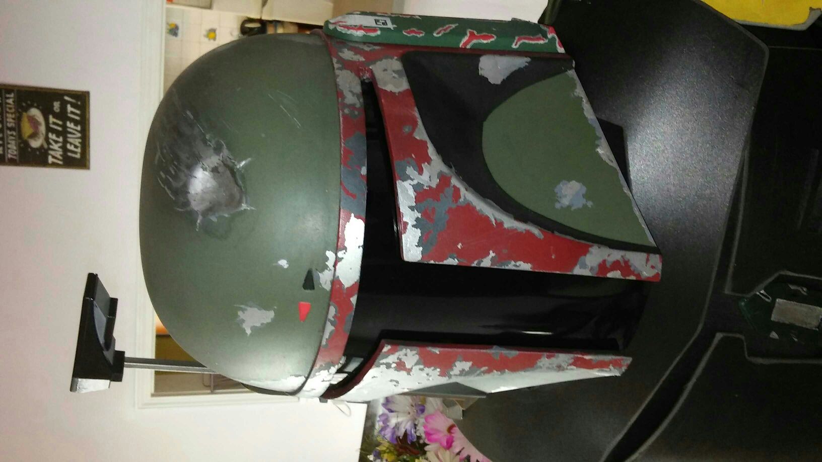

I used a mix of Humbrol and Tamiya model acrylic sprays for my bucket.
Base coat: Humbrol silver 11
Between silver and green: Humbrol Matt grey 64
Cheeks and dome: Humbrol Matt green 30
Rangefinder ear: Humbrol Matt sand 63
For the mandibles I used Rustoleum Matt red wine spray paint, but I found tamiya ts-33 flat dull red could also be used.
The only colour I found difficult to buy straight up was for the back panels where I used a mix of grey blue and green airbrush paints to get the right colour, can’t remember the exact ratios.
The other ear was Matt white under tamiya Matt red and then dark green.
