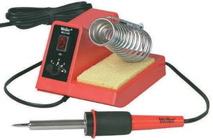

This is pretty obviously the most important tool you'll need. Irons come in varying shapes, sizes, wattages, and levels of quality. Here are a couple examples:
30-watt pencil iron
40-watt station with adjustable temperature control
At a minimum, I recommend a 30-watt pencil iron. Lower wattages will mean less heat, and less heat makes the job harder. A 40-watt unit will run about as hot as a 30W, but will be able to maintain that heat level better while in contact with the work. Either is a fine choice for virtually all home and hobby soldering, but if you can spring for a 40W or greater soldering station (temp control optional, but can be handy) then I recommend doing so.

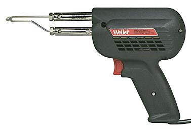

Don't go overboard!
This picture shows a soldering gun, which typically starts at about 100 watts and is waaaaay overkill for doing small work. I own a soldering gun, and I don't believe I've ever actually used it.
All three units shown above are made by Weller. They produce good, quality soldering tools and to the best of my knowledge they are available worldwide. They have a huge selection of models in varying price ranges.

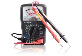

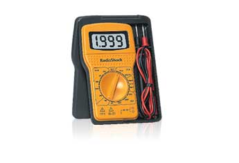

Multimeter
Analog
Digital
It's always nice to be able to check voltages and circuit continuity. I do like Radio Shack's selection, and both units pictured above are under US$20. Just don't count on the sales person to know much about them.

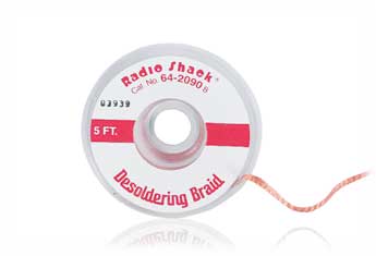

Solder Wick
Solder wick, or desoldering braid, s a length of braided copper that actually removes solder from a connection when applied and heated. Very handy stuff!
