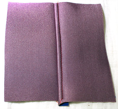

This is a closeup of the first piece I did using a straight stitch (2.5mm length) ... The first seam went smoothly, but the second one was more difficult. It did not want to go straight and tension will need to be adjusted, at least on my machine, if I use a straight stitch.
This is a closeup of the zigzag stitch I used (The one recommened 0.5mm wide, 2.5mm length). The seam isn't nearly as noticeable and the sample has more stretch to it as well, in both directions. It really doesn't look "zigzag," and appears more "straight" to me than my straight seam!

Also... here are the full-sized pics of the seam samples...
The straight stitch sample ...
The zigzag stitch sample ...
