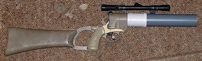

Ingredients pic:

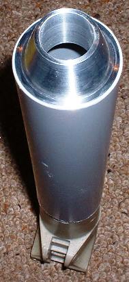

I've done some aly blocks for the scope to sit on and am turning a biggish piece of aly for the muzzle based on pics of the real one.
Are lathe motors supposed to smoke?? :lol:
Regards pipes and the ROTJ, I would do the muzzle/barrel/T fins all as one piece so it could be slipped on over the webley barrel.
Pic now added - it's almost too good to paint!
SAS
I'm thinking of doing a casting of the whole lot as one piece, including the Webley bit seen in the pic. That way I could cast up just the finned/white bit or the whole lot depending on what people want/have already.

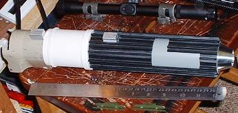

There is a handy layout diagram of the rib position on the barrel that I used (Ta whoever). Except it shows the front scope block replacing a section of one rib, whereas I believe it should go between two ribs. The photos of a real prop back this up.
Ribbed for your pleasure (Scope blocks not fixed in place.):
Wow, that nozzle looks great... I see what you mean about not painting it, but the natural weathering (when it get's scratched) on it would look cool...
