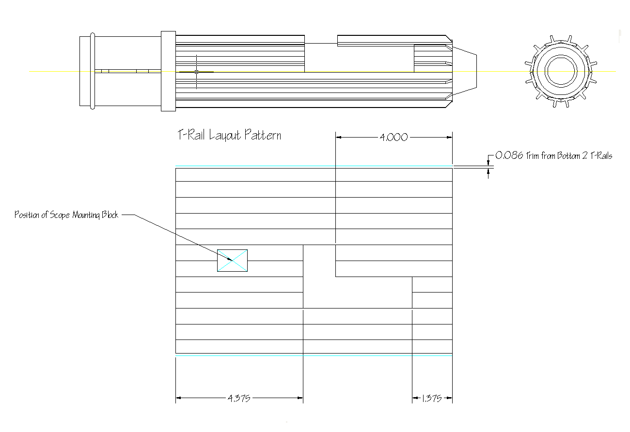

Maybe this will help?
Here is what I came up with. The overall dimension for the t-rail section is 9.5".
Alan
P.S. because of the size of the pic you'll most likely need to view it full size to see everything clearly.

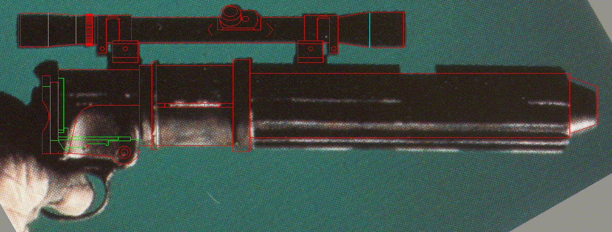

I couldn't find the MR reference, but here is a comparison overlay that I did of my drawings to the real deal. I'll keep searching for the MR data.
Alan

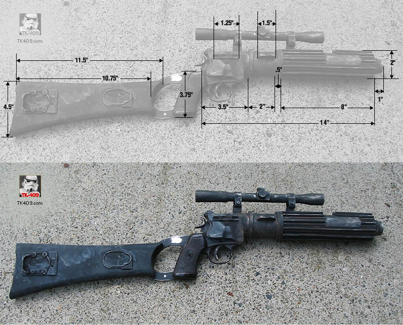

This is a pic of the real EE-3.
My measurements are based off my MR EE-3 so this pic will show what measurements I am referring to. Sorry no time to get a pic last night of my own MR. I'm a firefighter and I was busy last night.
1. 3/8"
2. 1/8"
3. 2 3/16"
4. 1/2"
5. 9 5/16
6. 13/16"
Let me know if you need more measurements. :)
