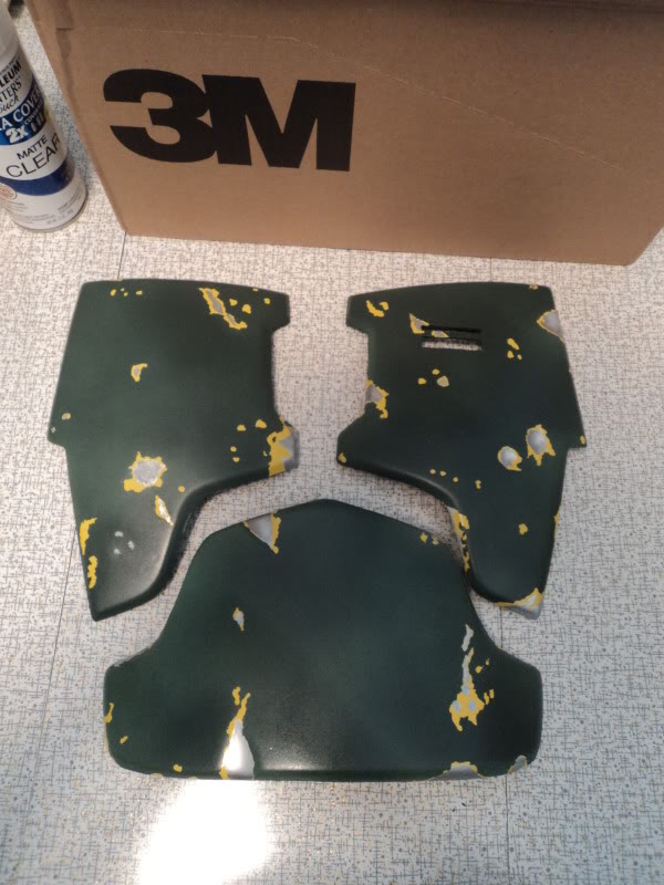

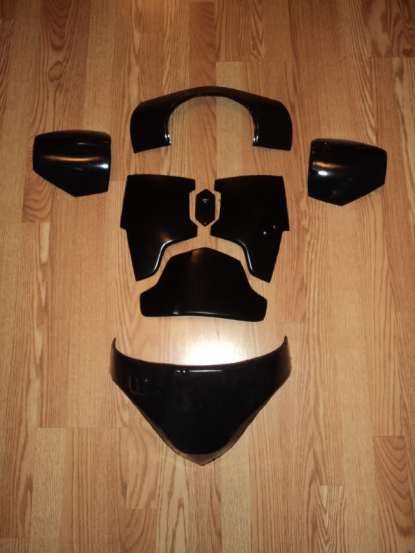

So here is the progress on my ROTJ Fett. This is my first time doing a Fett. The armor is from RedKraytDragon.

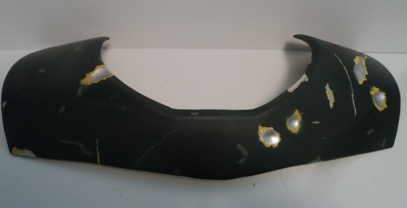

A layer of Rustoleum Metallic Finish Aluminum.
I then used some liquid frisket to do some masking.

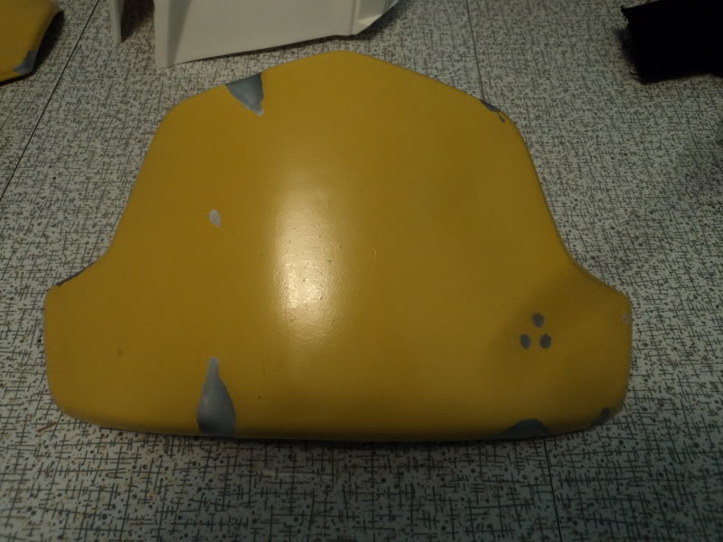

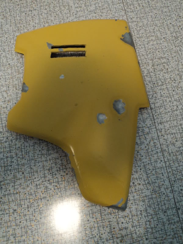

A layer of Krylon OSHA Safety Yellow
Rustoleum

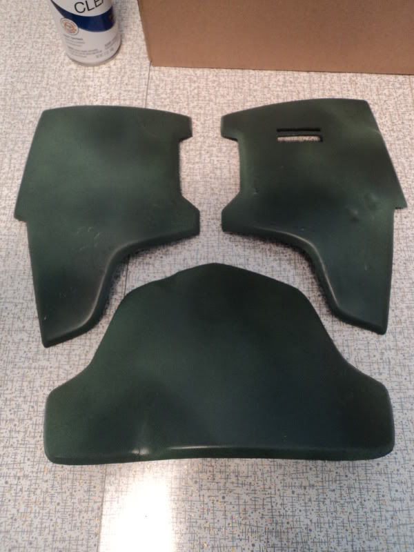

Some more masking followed by alternating mistings of Rustoleum Painter's Touch Satin Green Moss and Hunt Club Green on the chest plates.

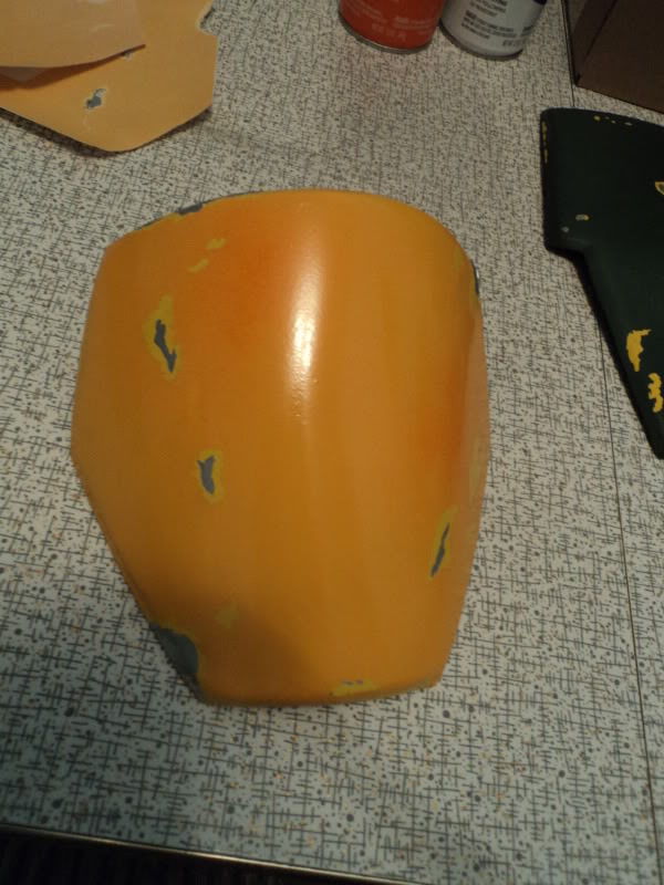

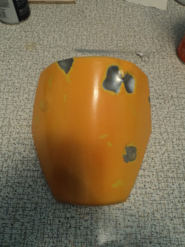

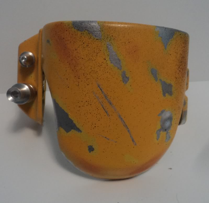

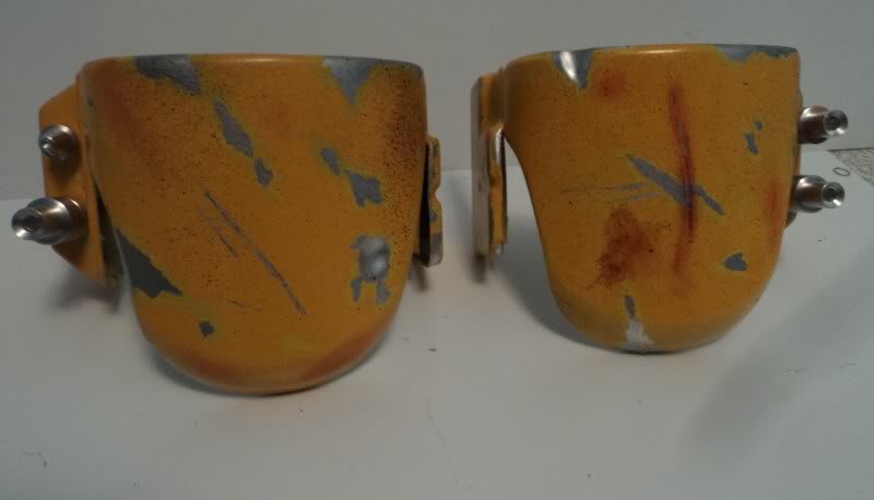

The shoulders get a layer of Rustoleum Bauhaus Gold followed by a slight misting of Rustoleum Painter's Touch Real Orange.
Hopefully this weekend I can begin the dirtying it up a bit.
That looks great. RKD's armour is really good stuff. I have one of his backplates and I'm so pleased with it.
Your layering and paintwork looks really nice.

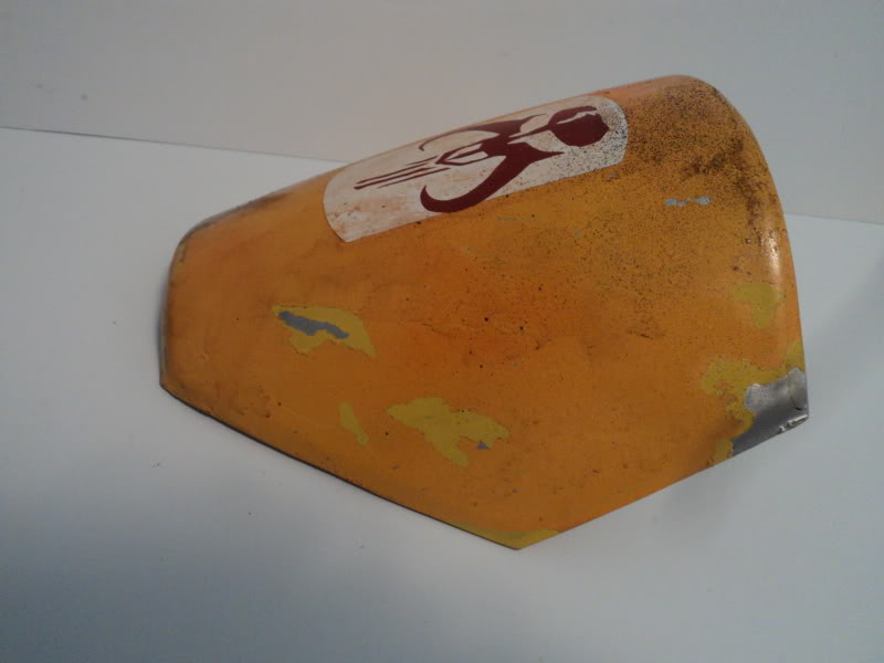

looking good so far, but you have the wrong shoulder decal for ROTJ. Thats the ESB one there. The ROTJ one has the tusks separated from the main skull
