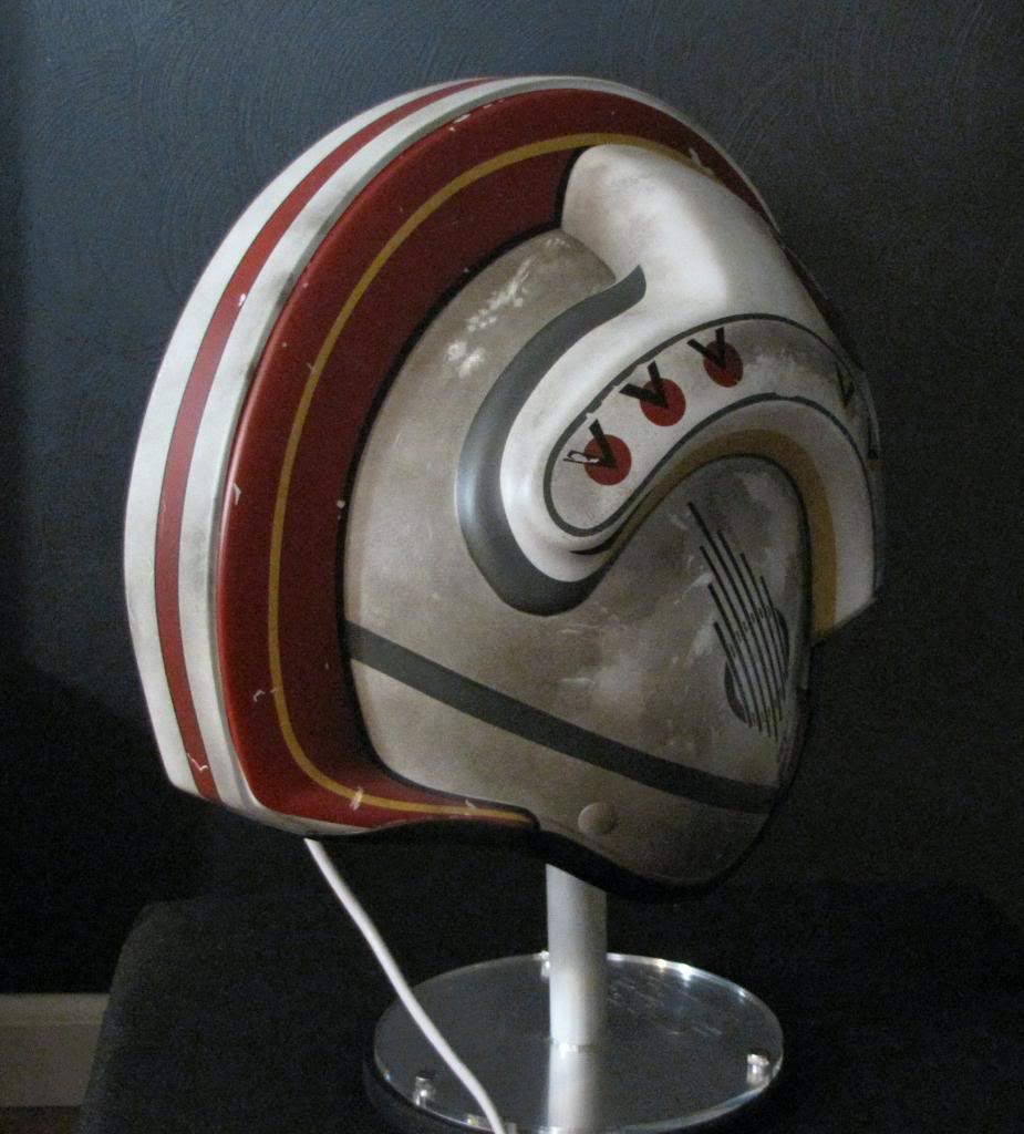

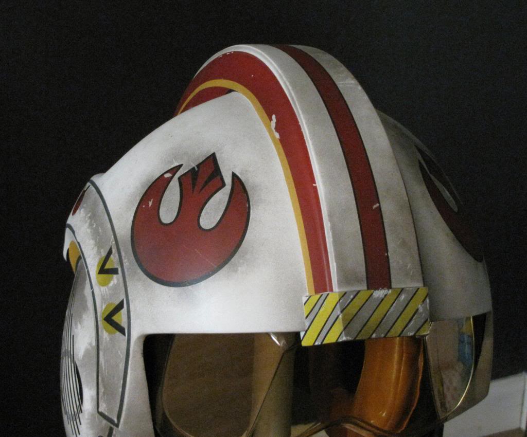

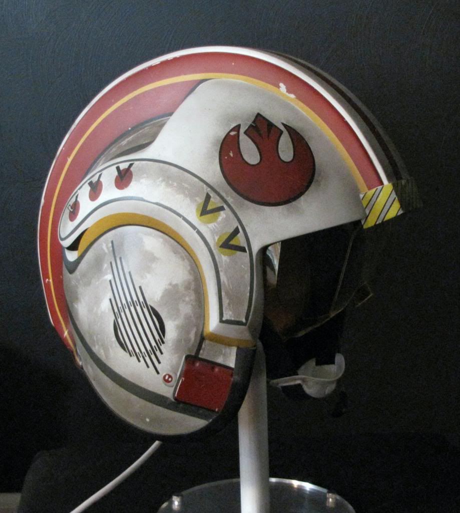

I don't have any in progress shots, but here are a few of the finished re-weathered bucket.
If you're familiar with the eFX X-Wing helmet, the weathering is fairly light overall. Using
some black pastel powder darkened certain areas nicely.
I used a large brush to "pounce" the pastel dust into the surface after getting it approximately
where I wanted it. Then I used some balled up masking tape with the sticky side out to remove
some of it. Steve the Swede had some awesome pics up on the RPF that served as a guide for
the weathering patterns. He's the one who did the paint master for eFX, so what better guideline!
Where the patterns were a little more intricate, or where they were scratched down to a brighter base,
I used the back of an X-acto blade to dig through the pastels a little more aggresively. Most of what I did
was pastel weathering, but there were a few places where I added some chips. Most noticeably on the red
portions of the helmet.
After I was satisfied with the weathering, I sealed the whole helmet with a couple of light coats
of Krylon low odor clear flat.
So that's pretty much it! A nice 1-day project for a change. :LOL
I really like the way the helmet came out. Much more grungy than eFX had originally painted it.
Many thanks to Steve for sharing his amazing paintwork and for once again providing inspiration to us
crazy detail-obsessed fans.
