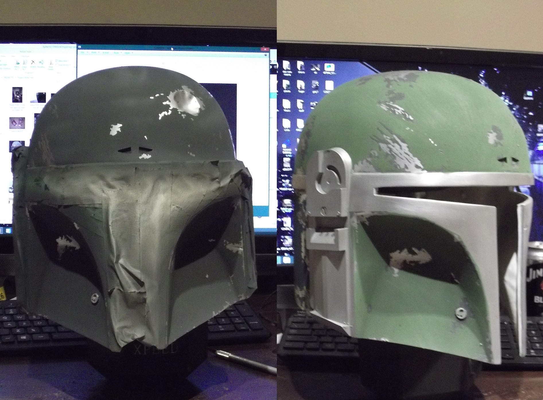

So I dived in and yes, there is no issue with humbrols sticking to my Asok CC. I began with the backpanels and painted the dome which I'll show. Its surprising how much you can see a proper Fett helmet once you peel the masking off the cat scratch and dent.
Thanks
I think I might start over though. I had the psi up to high on my new compressor and perhaps not enough thinner although the consistency was good. Anyway the paint was drying before it hit the helmet and was left with a sandy texture which made the kill stripes look very average.
I paint and draw portraits but this is usually with oil and a brush so my airbrushing technique needs a little improvement and a better feel for my equipment.
Anyway. Its all down to experience and I will make it better this time.
