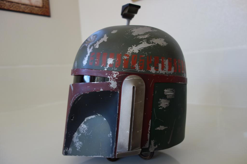

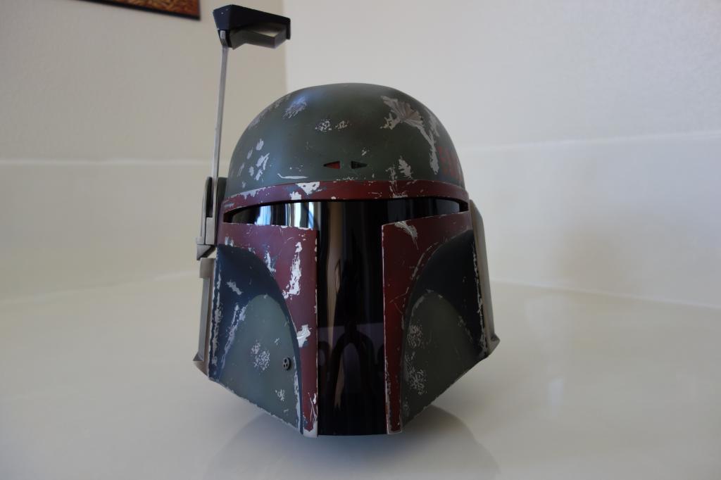

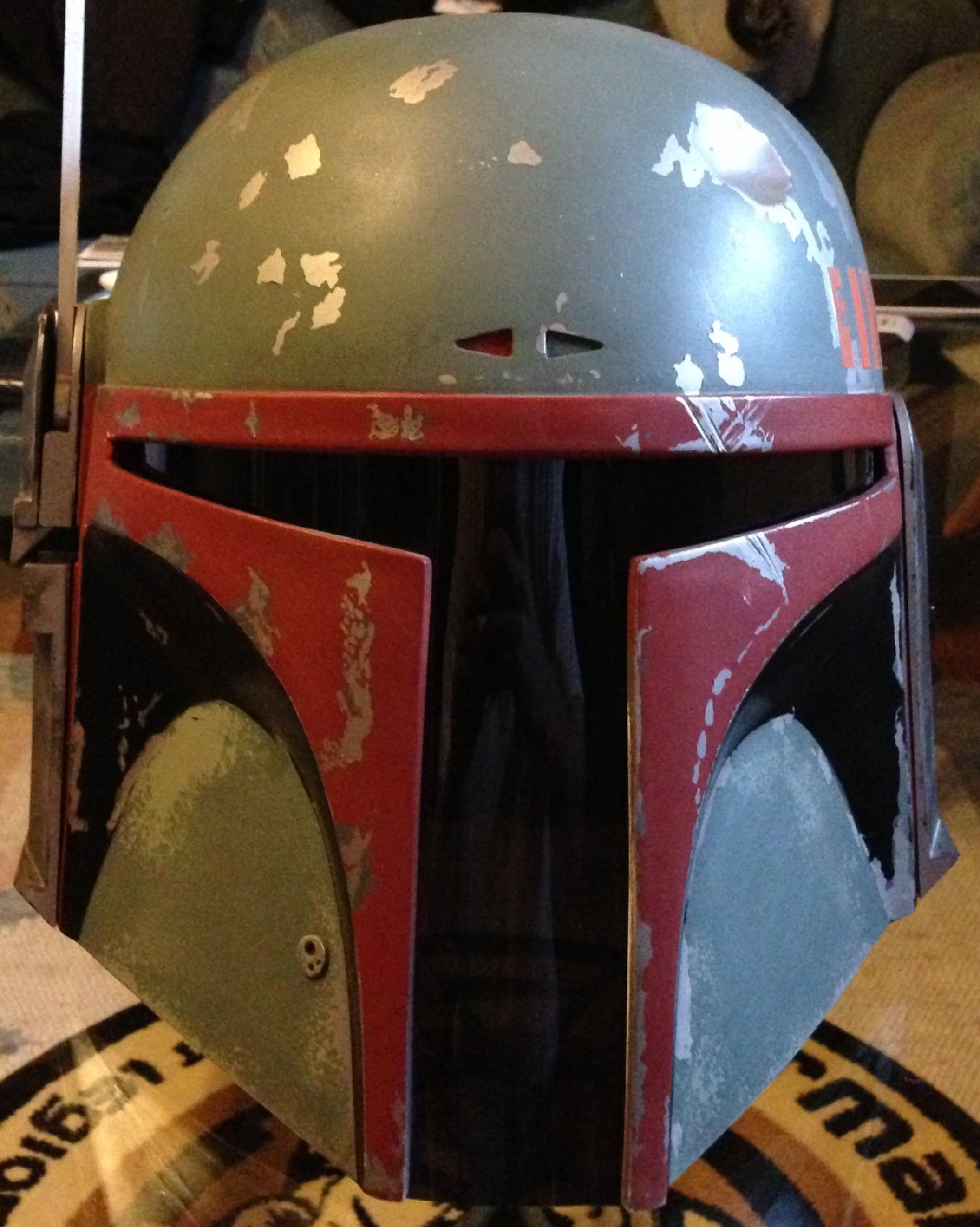

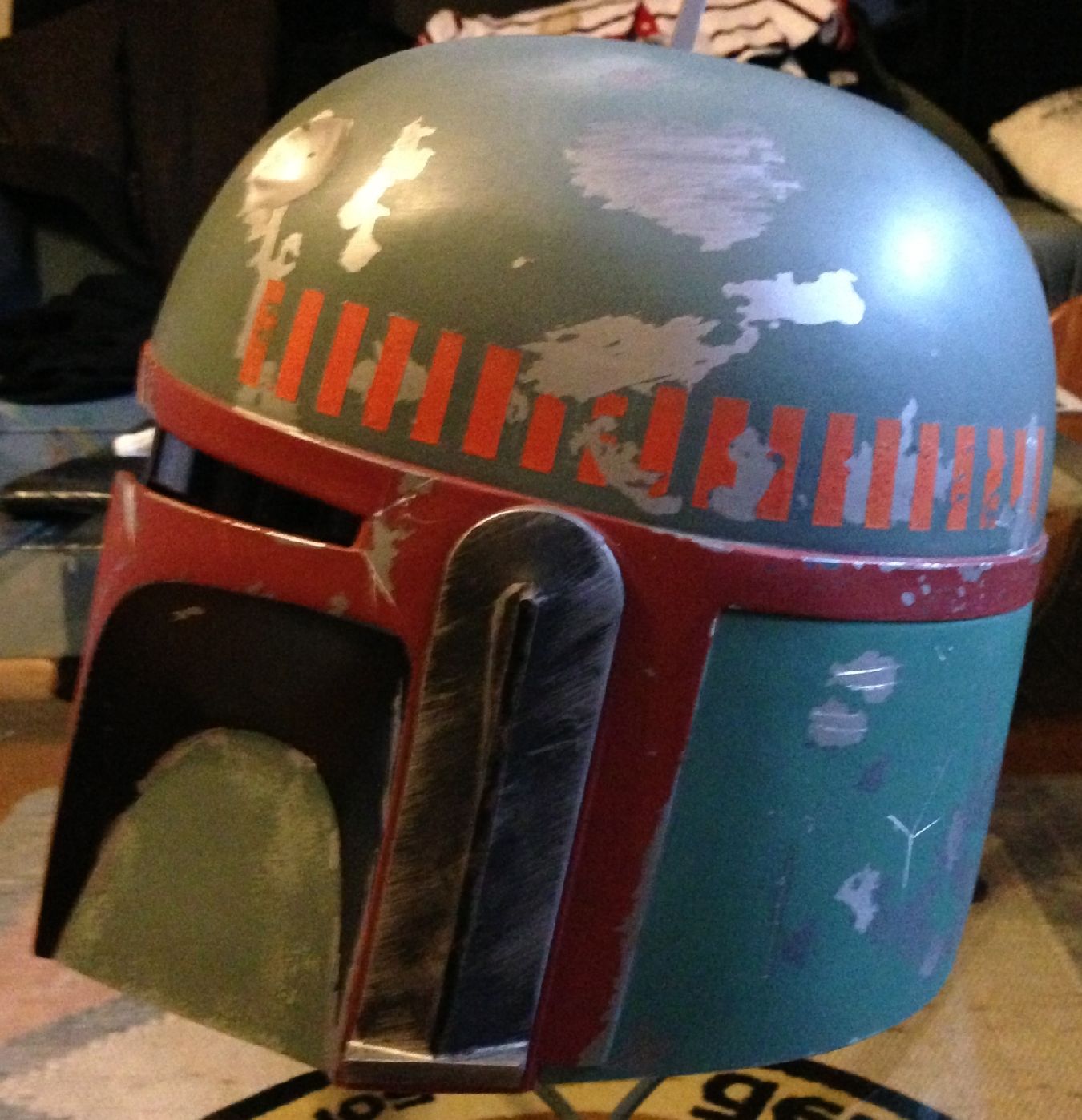

Hey,
i'm Christian from Germany.

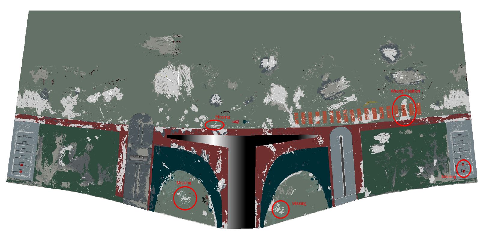

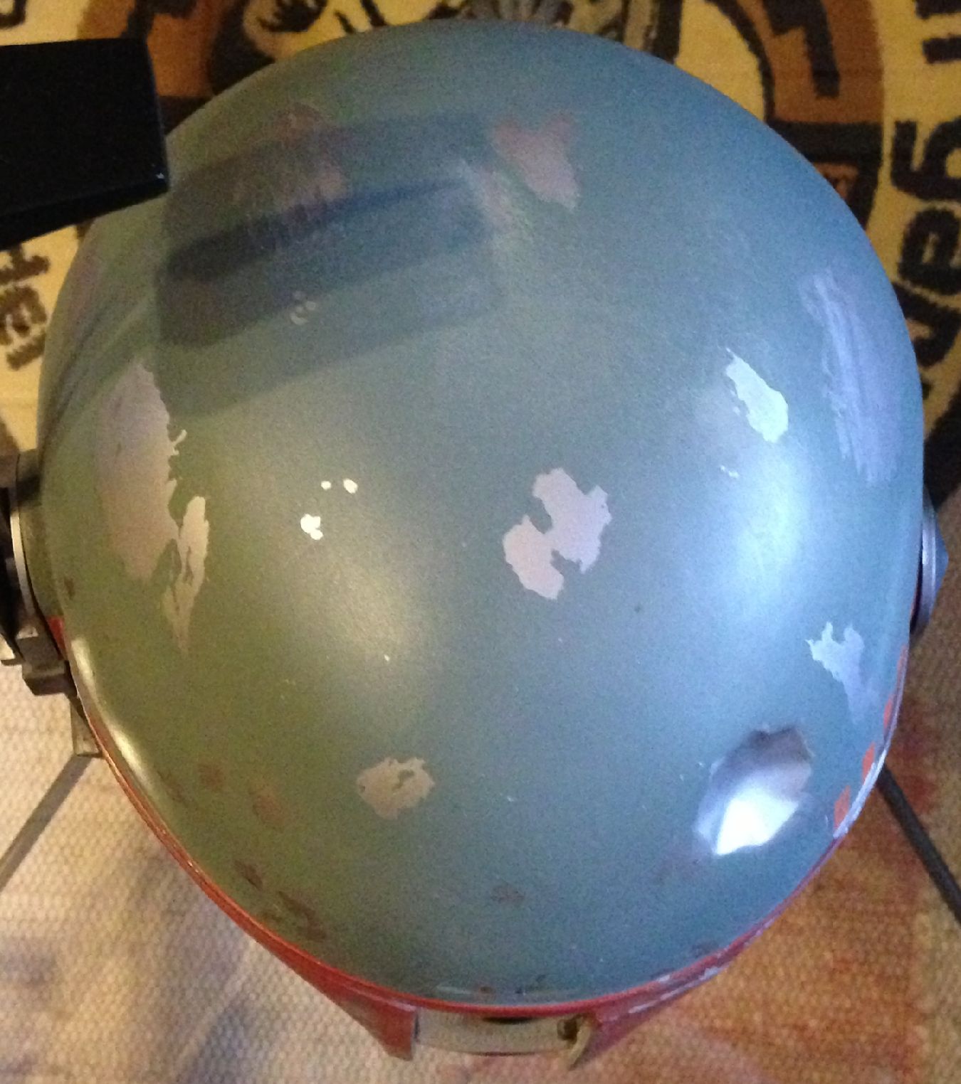

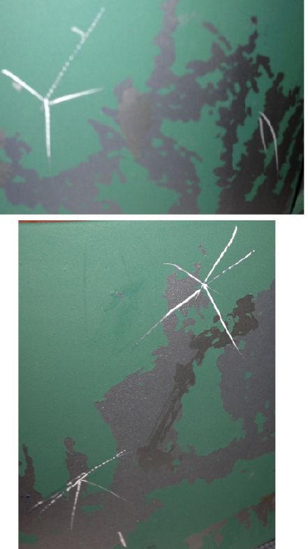

i'v bought this helmet. I think it's nice but there are some Peelings/scratches missing or on the wrong Position.
I marked those on the stencil.

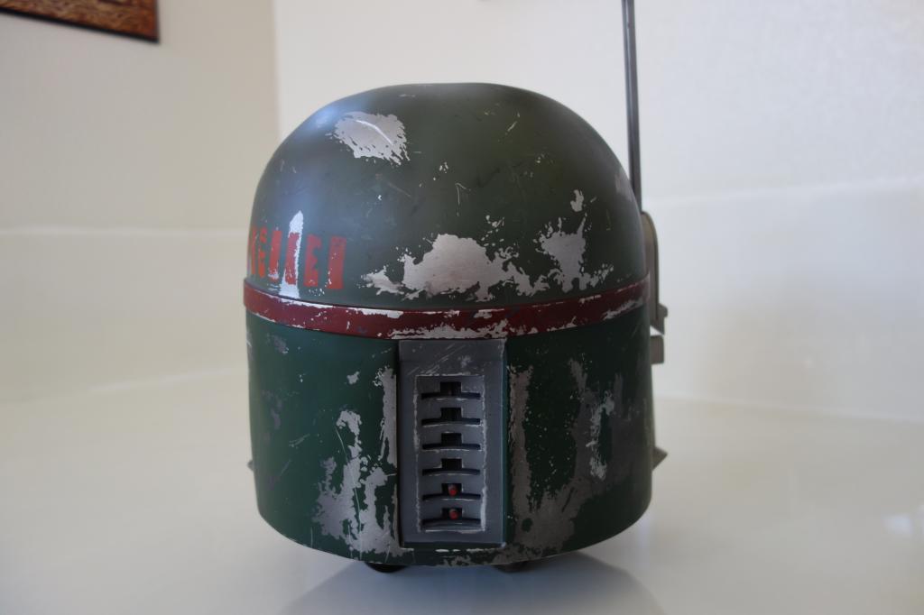

Besides of the missing/wrong scratches, there is just one whole in the back mq-1 plate. Do there have to be 2 or is it just important, that there is a red painted circle?
The Producer of the helmet made also some star like scratches which i dont find on the stencil. Are those still ok?
image001.jpg image002.jpg image003.jpg image004.jpg image005.jpg image006.jpg image009.jpg image008.jpg
Thanks for watching. ;-)

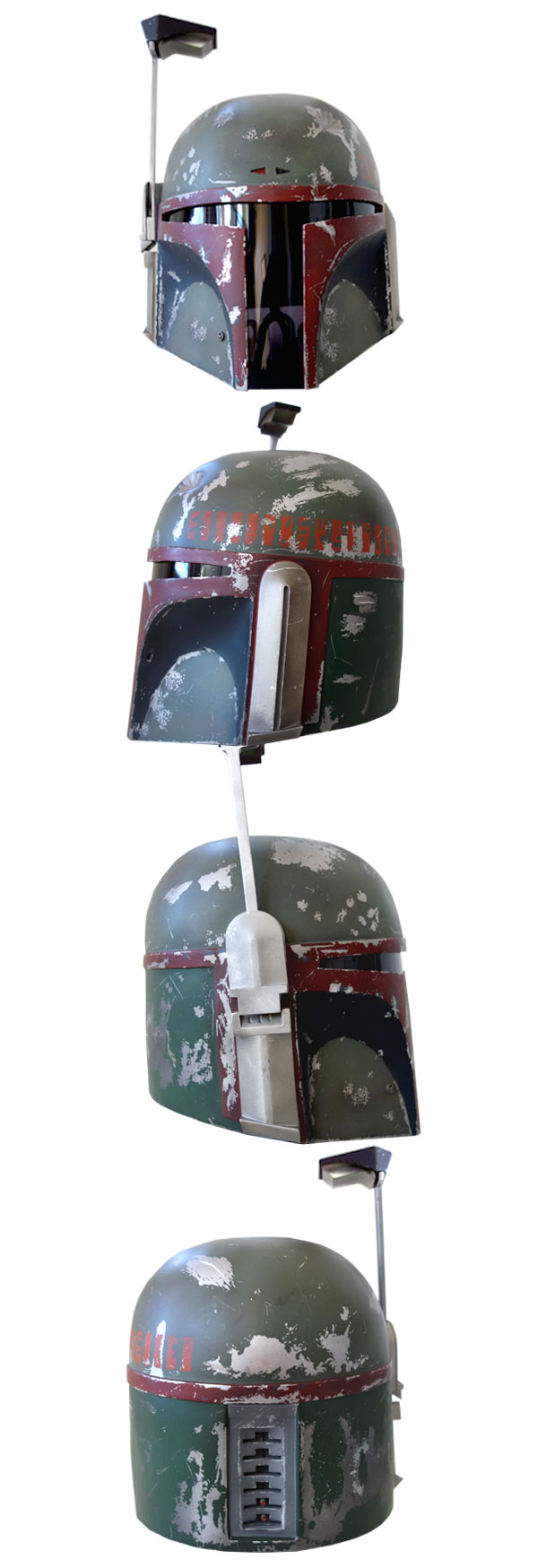

Below are the images stolen from the 501st web site
In addition here are the requirements..

Bottom line the helmet would not pass level two certification since its missing the dental files. Other comments I would make are that the ears look to be the wrong color and weathered poorly and the cheek colors (to me) look wrong. Other better experts will weigh in here. It really all depends on what you want out of the helmet and if it makes YOU happy.
Ty so far...
The colour of the cheek has to be black, so its right.
First of all, i prefer very accurate paintings, too. But in this case its important for me, that its correct, that means, the peelings are on the riht position and so on.
I think, the peeling on the last kill stripe is wrong, also the star like scratches.
I would appreciate it, if you could help me with some infos and what could be made better.

The cheek color is not black. 501st says blue-green but one of the write up colors on this forum says Tamiya XF-17 (Sea Blue). Master helmet crafters here can be more specific.
Dom is correct. By all means, the 501st CRL is a guideline, but not gospel. We are likely more strict here then the Legion is.
Thanks Darth, I quoted the 501st since some of the colors looked way out of whack...even to their guidelines. But it really only matters depending on how accurate you want the helmet to be....some of us have pretty demanding standards.
Totally wasnt knocking that you did that..that wasnt my intention :) Its good you did, but i just wanted Sai Fai to be aware that the legion photos arent the end all lol :) ..and this coming from the guy who is the ESB Fett CRL photos lol
So is the black color for the cheeks correct or not?
I apologize. I think you misunderstood what I meant to say. The color of the cheeks is not supposed to be black...it must be blue-green or as the write up I linked says Tamiya XF-17 (Sea Blue). I am far from an expert with colors but it appears (to me) the cheeks do not match those colors in the normal picks but might come close on the panoramic you took. Its hard to tell from the lighting. Darth, Dom, Raf, and others would be a better judge here.

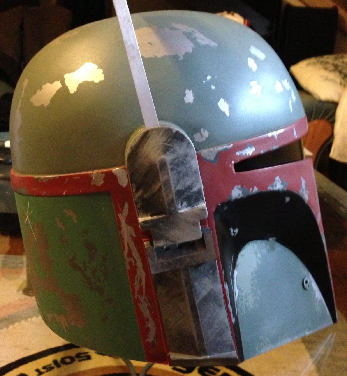

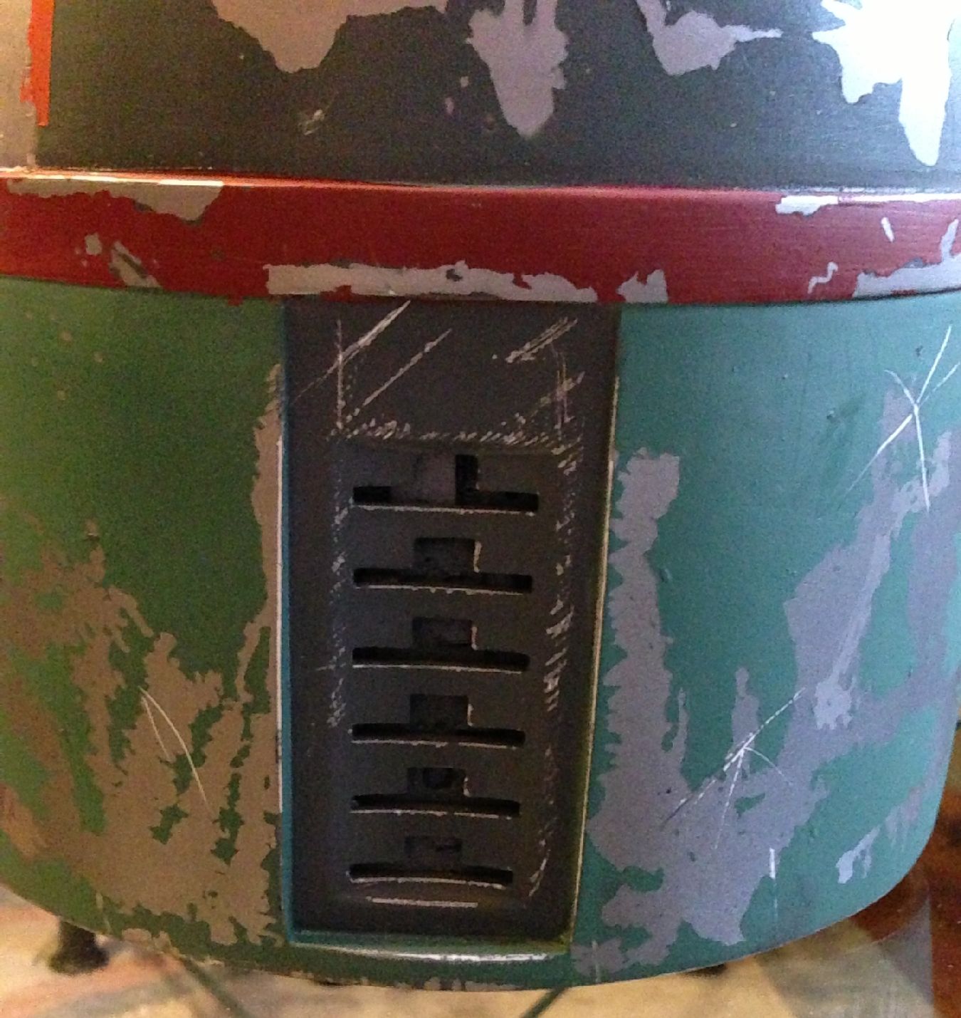

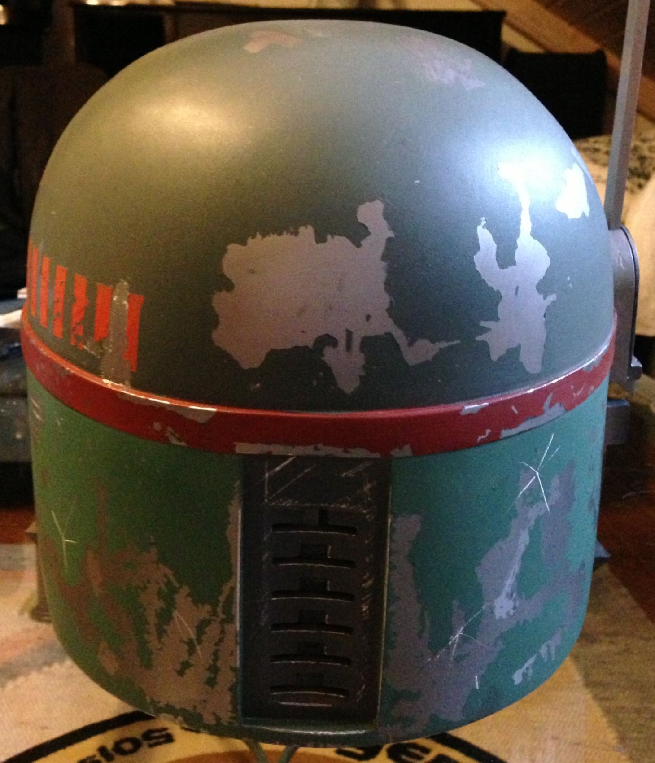

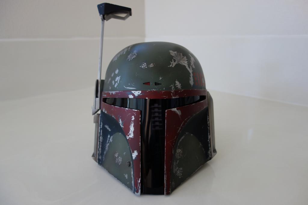

Here's the original photos of that ROTJ helmet, not as compressed.
I wish the 501st asked me before using my photos haha. Thanks for bringing that to my attention though ;)
Hope it helps some.
Here's the original photos of that ROTJ helmet, not compressed.
I wish the 501st asked me before using my photos for their own or at least give credit to the taker..Thanks for bringing that to my attention though ;) anyway... Heres some larger photos. Hope it helps some.

The cheeks are more blueish than green on the helmet shown. If that helps anything.
