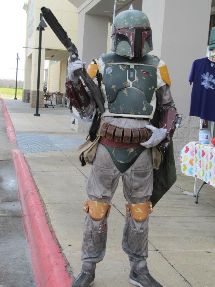

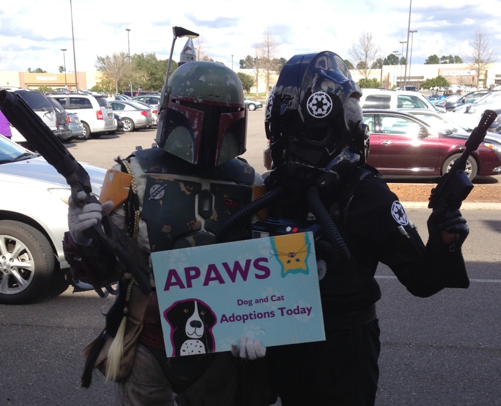

Here are some pictures from my first troop in my ROTJ Boba Fett. It was a troop to raise money, food and litter for our local pet shelters as well as draw attention to the adoption day that was gong on. The troop was a huge success as always.
Please let me know what i can do to wear this better. All comments and suggestions are welcome! I want the best looking Fett i can have when i put it on.

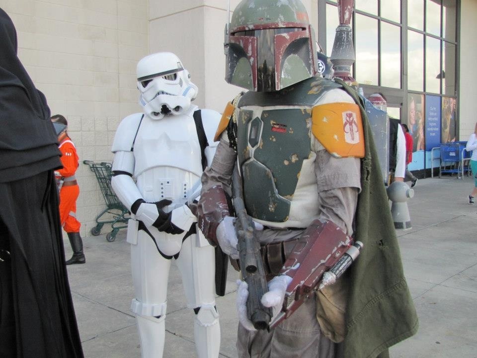

As far as my costume, i had nothing break and nothing fall off or malfunction! It looks like my ammo belt should be worn a little higher and i still cant figure out whats bothering me with my helmet. It just looks like its maybe sitting too far foreword? The Tie Pilot in the pics is my wife. Its still a huge work in progress as far as upgrades, but i thought it looked great for the first time out. Everyone loved it and the best part of the troop was when a small child ran up to me with a lego Boba Fett figure saying its you! Its you! ....Thanks for looking.
To get my helmet to look right, it's actually tilted back a good bit. Basically the bottom of the helmet is closer to being parallel to the ground than the eyeline is. I find it's tougher to see this way (cause you're kind of looking over the mandibles) but the helmet reads better for spectators.
Great looking kit. It looks like your ab plate is a tad to close to your chest plates and something isn't quite right about the diamond placement. I hate nitpicking and i hope you dont take offense. I may have been studying reference images too long, that i cant just enjoy a good looking Boba Fett.

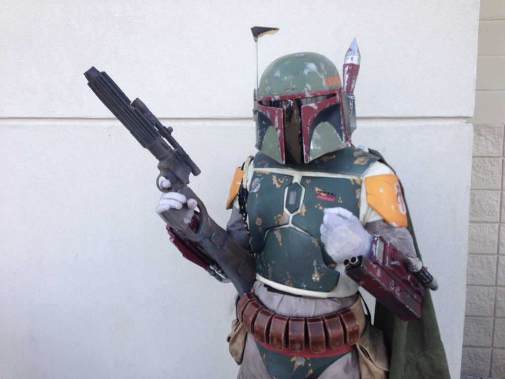

Thanks guys! I'll try and post a parts list tonight or tomorrow. Here is pic of how I have the helmet padded now. Just a piece of soft foam up front and a MCHE military pad in the back. Nothing on top or the sides as of now.

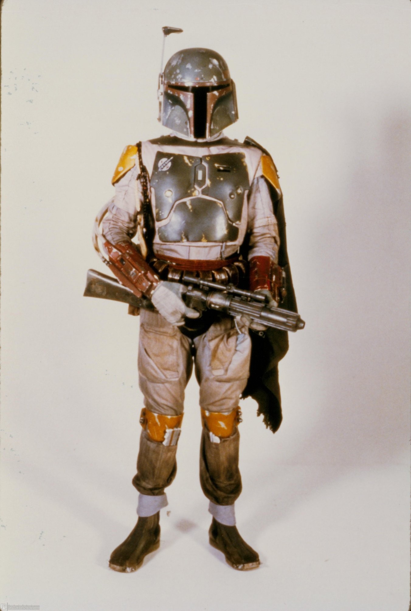

The overall look of the suit is great! The helmet is indeed tilted forward a bit, but the original was that way too. I think you might fix this by adding a bit of padding to the inside of the dome top to rise the helmet. If that doesn't solve your problem, then try to do the same with the back of the helmet. And I agree about the armor plates being a bit out of focus, more exactly the center diamond is too high, the abdominal plate's placement must be a bit lower and the collar plate should be higher, almost choking you. Here's an image with the ROTJ Hero suit that might help you with the new armor position:
The ammo belt is in the right position but you should raise the girth belt to the position seen in the image posted above.

The best thing about the chest armor, is I haven't snapped it down yet, so it's just velcro'd on until I find the perfect placement! So that should be no problem to fix. I'll look at some reference pictures to get the weathering on the gauntlet hoses. Thanks for pointing that out, I never would have noticed! I will definitely try out all the ideas for the helmet. It just sticks so far forward and looks like a bobble head. Not sure if the bottom shape has anything to do with it? It's a SGT FANG.

AWESOME! The only thing I could see comparing the picture Raf posted versus your pictures was the spats in the reference pic do not have weathering on them and yours do, your cape could be a little more tattered/ frayed at the bottom, and(previously mentioned) hoses need some weathering. Outside of that, you look like a psitting image of it and still look freaking awesome as is.
