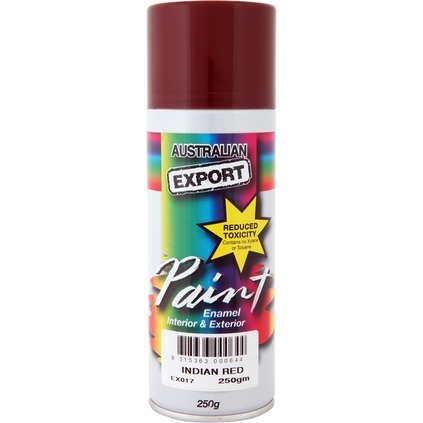

EDIT: this is my current red called Indian Red, it's a bit dark but I like it?
Other paints should do fine on the A.I. primer. Primers tend to be non-reactive once they are fully cured. Having said that though, it is best to test on a piece of scrap, allowing ample dry/cure times as you would on your parts.
i think the red looks good if the cap is a good indicator. You'd just need to be careful with the weathering making it too dark, but I think it'll work fine. Reminds me of Stormtrooperguys red on his ROTJ paint up.
I've been going over Stormtrooperguys paint job, it's very helpful to base mine off as a starting point. I hope that I'll smash it out soon.
