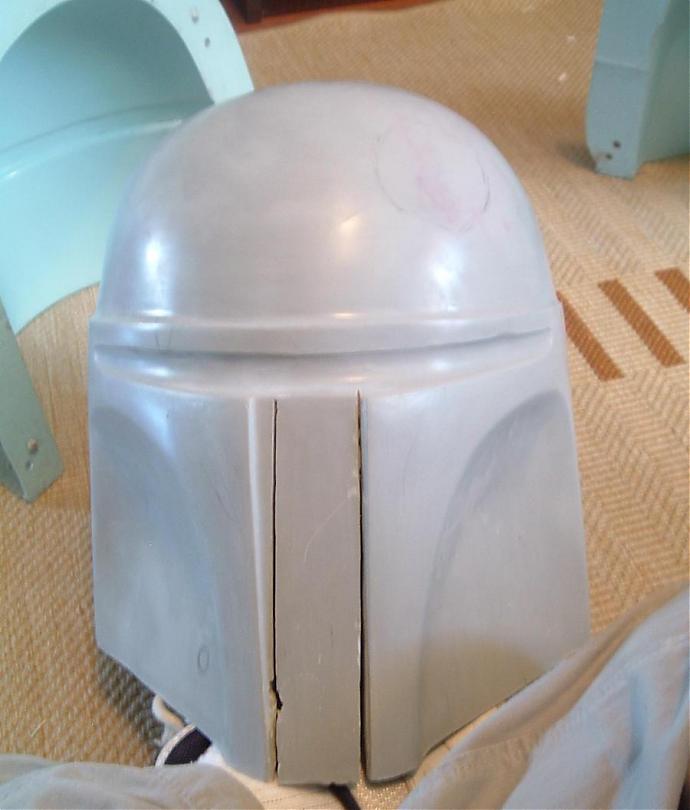

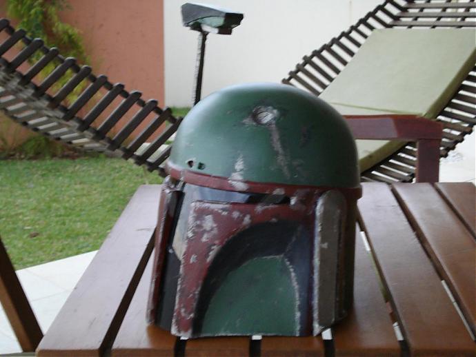

when my helmet was finished(whithout painting ) it was looking like this

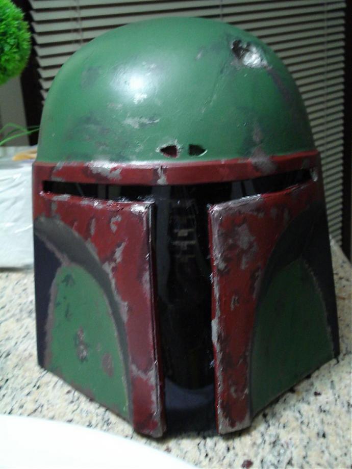

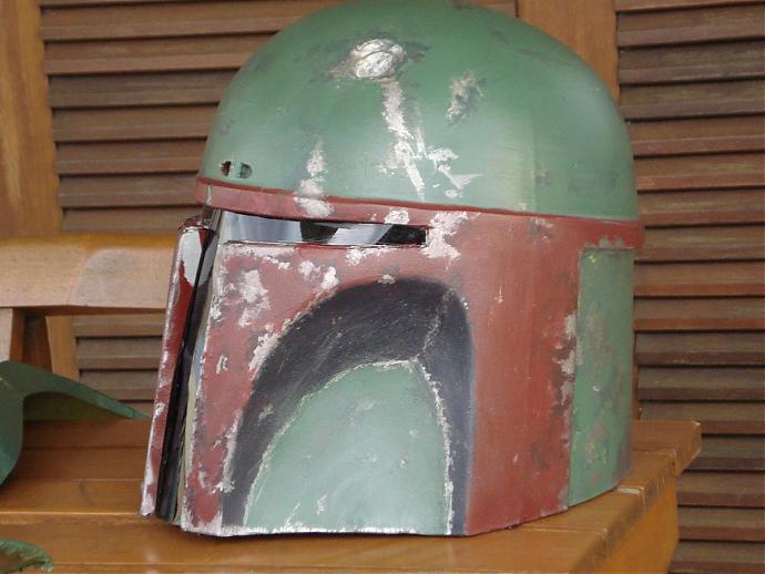

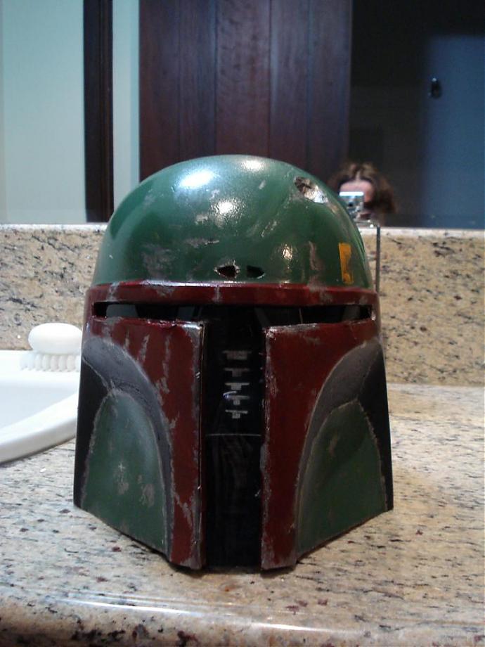

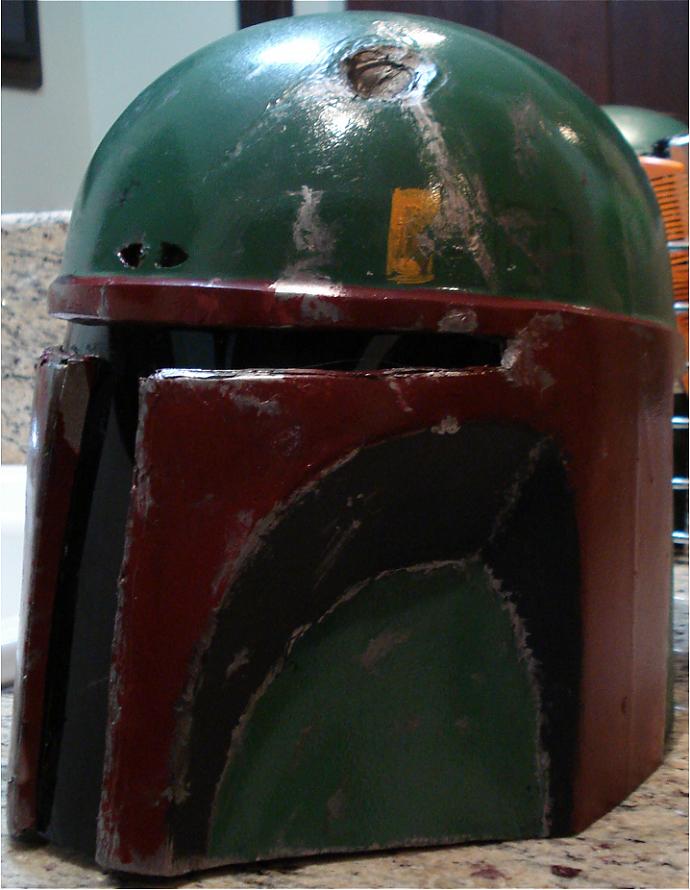

i just finished painting it, (the yellow line at the top will be replaced by some decals [if someone wnt to gimme adivices about it i wll be happy to hear them ]) it turned like this
and like this if u want a coolest angle then look at this

scratchbuilt means home made. One thing I would do is take the T visor out and cut the excess back to make a nice uniform edge. That will pull the mandibles back to live up with the brow at the bottom of the dome.

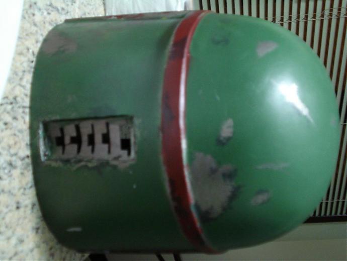

and i wanna know if the paint job is good because i spent 2 days making the base collor and 4 making the battle damage(tomorow i will post some sunlight pictures, becaus all those are just with my bathroom's lamps )
ManjiBR,
While your scratchbuilt helmet needs abit more work [just listen to the Hemet pros here and it'll turn out fine.], I must say I'm impressed with what you've done so far. Good work!

Now the helmet is under 3 layers of mate bernis (is this way we call "vernis fosco" here?) and it still shiny i will put something like 5 or one hundred until it gets totaly not-shiny(mate?).

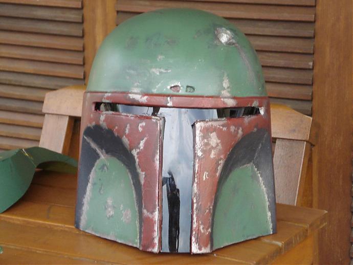

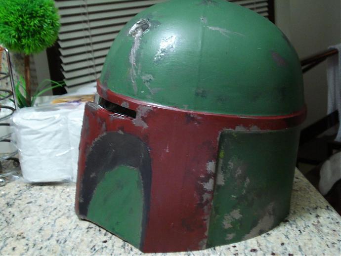

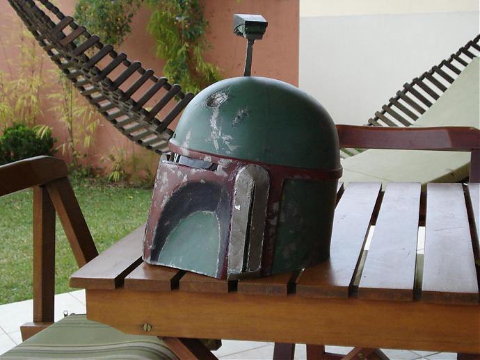

i took some pctures this afternoon and i think you will not say that my helmet is shiny anymore (i hope) here they are.

hey, not bad for your first one!!!!
you may also try some diferents ways to make the battle damage...in a way thats not looks like its made with a brush, and because it have been kicked, punched and blasted... :)
I use 2 ways to do it:
1- paint it all in silver and put some mustard where you whant that the silver scratches be...(it sounds weird, but ist`s work).
when the mustard really dry (really) aplly the other colors.
when the other colors really dry (really), gently remouve the mustard...and SURPRISE!!! autentic battle damage....
2-this one it`s my favorite...paint the silver, and the other colors ( not mustard requerid :)) use some metal brighter on where you want the damage, and gently rubb the other paint, when the silver start to show...
in both use a black wash to smooth the colors...
I really like the helmet, need some work on it, but if you made this, you can make a litle more...:thumbsup:
keep the good work!

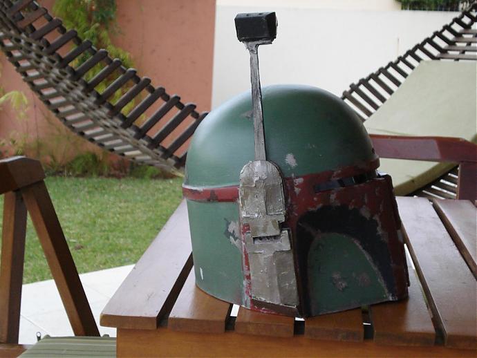

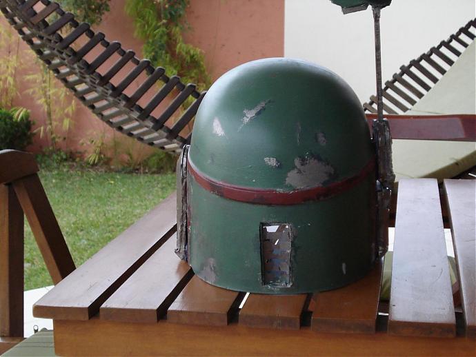

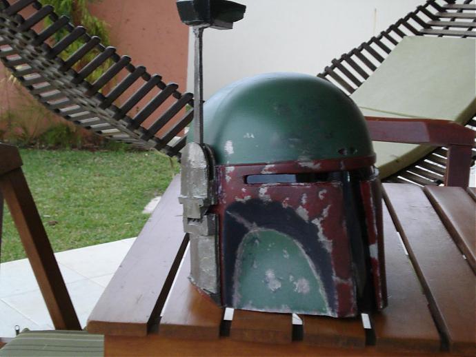

I took some pics of my helmet with the "ears" atached today

yep, the mustard is a real method...try it, if you don't like it, at least you can eat it...jeje
no, the mustard works good, it's a cheap way, instead the masked fluid...
I have painted all my stuff using both...
now that you have installed the ears, its's giveme a gloval idea, and I think thats your helmet looks good, only you have to sand the ears, make them more smoth, and it will get you one step more...
keep working on this...and remenber, only fails the one's that never try...
