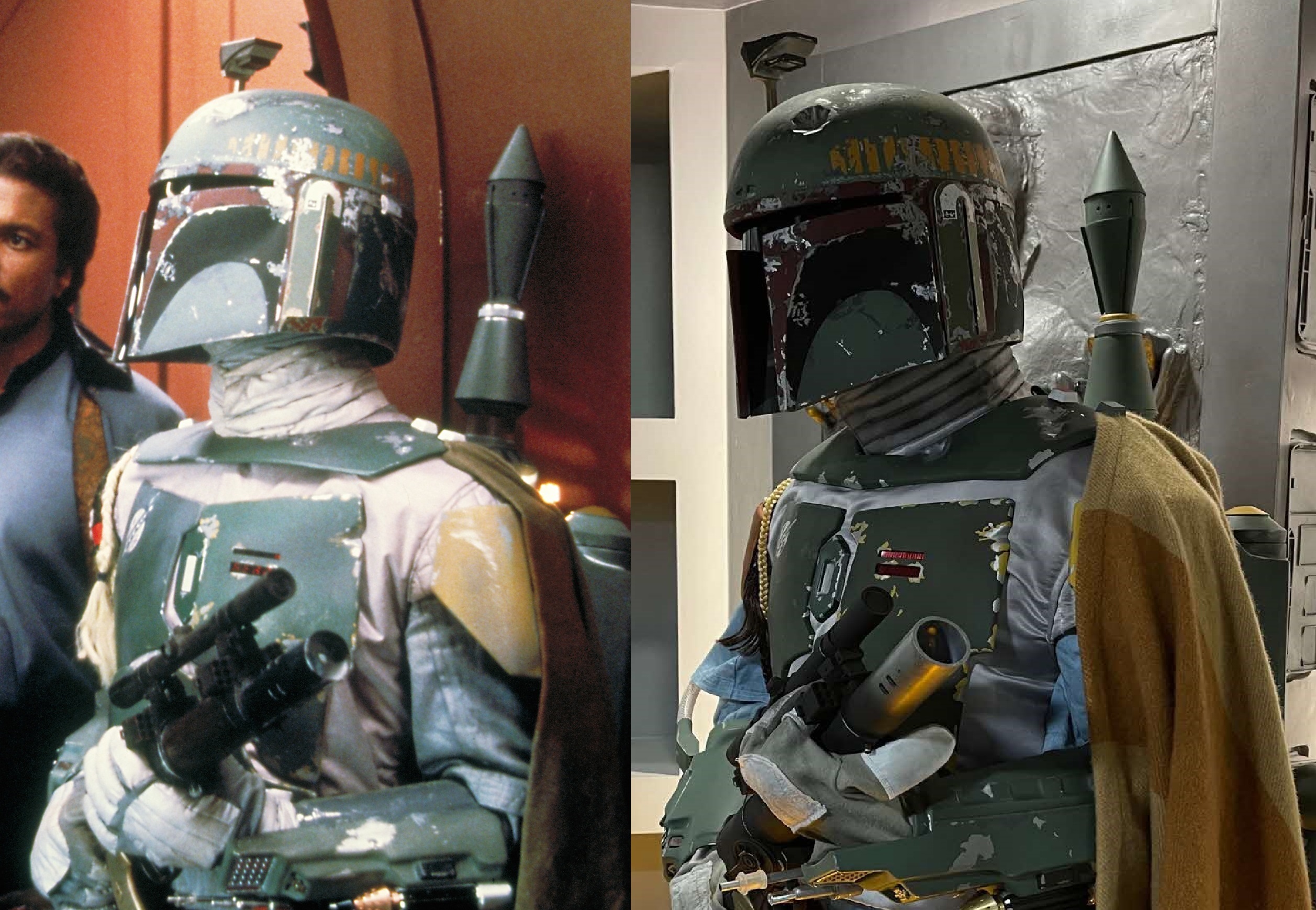

The first question was the first one I had after watching the same videos. I wanted to rush and get my first helmet done quickly and layered the masking fluid. It worked great on the back panels and I was like "ha! no need to do all that extra re-masking!". Then it didn't work on the dome...ON THE DOME! and that's when I converted from being in a rush to doing it with more patience. Totally worth it. The ArchiveX paint list that BudaFett shared above is what I used for my ESB helmet and I was very pleased with the results. The only paints I had to mix was for the dome and I used a 1:1 mixture of light green and grey/green. That's my current ESB on the right along with a comparison shot from ESB.
