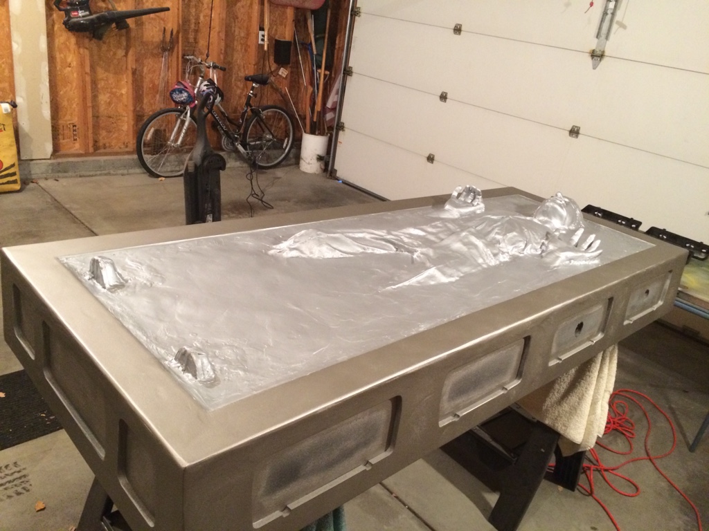

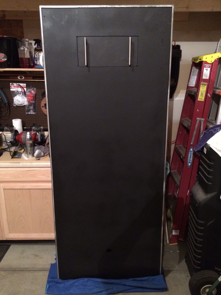

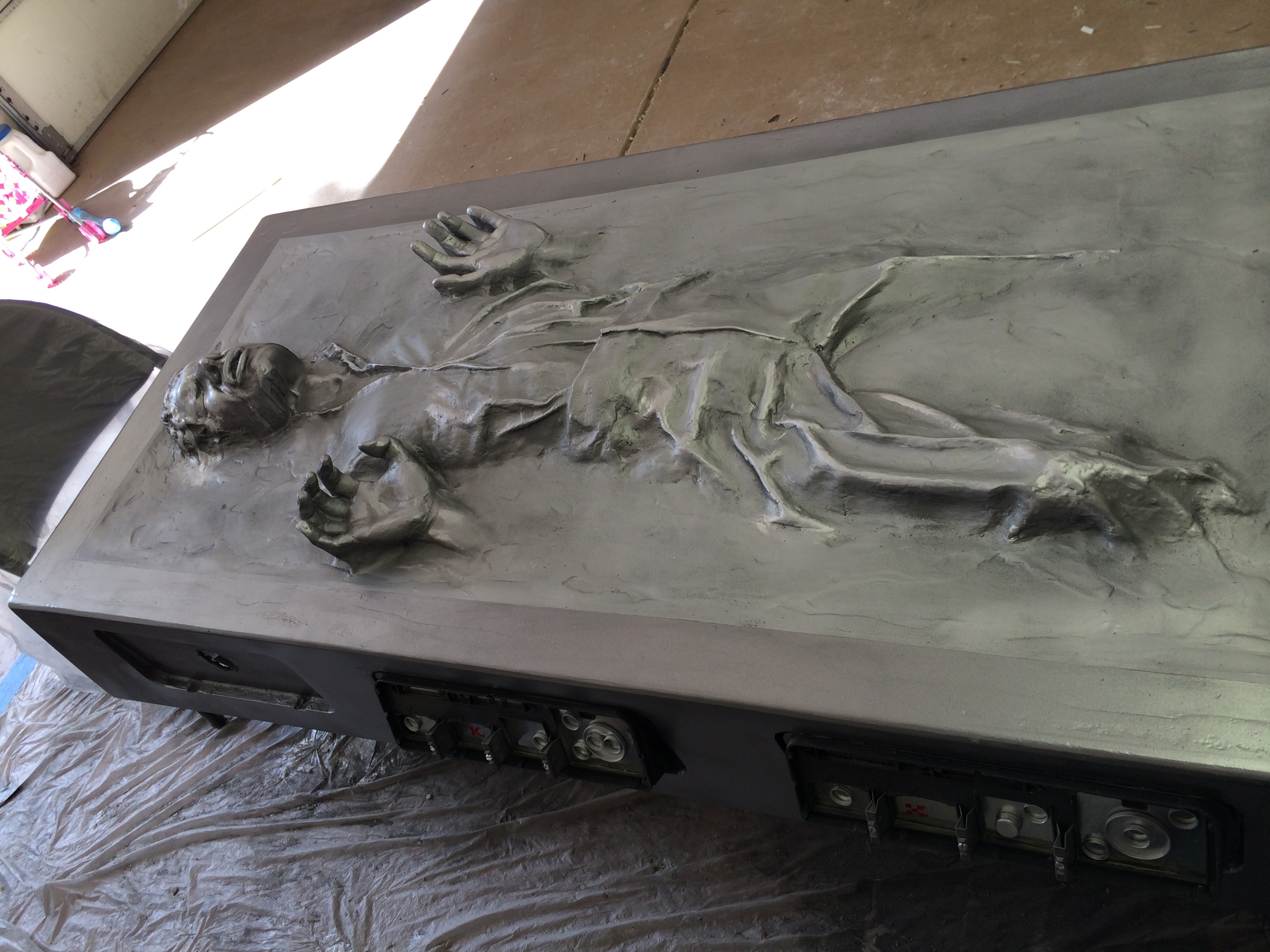

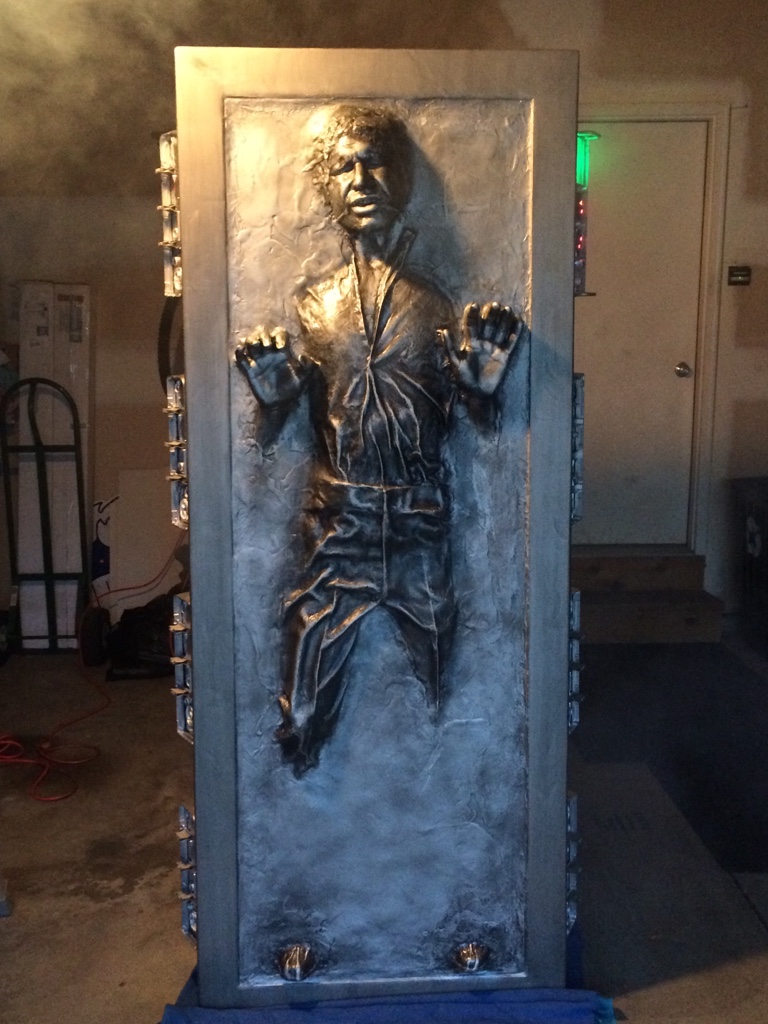

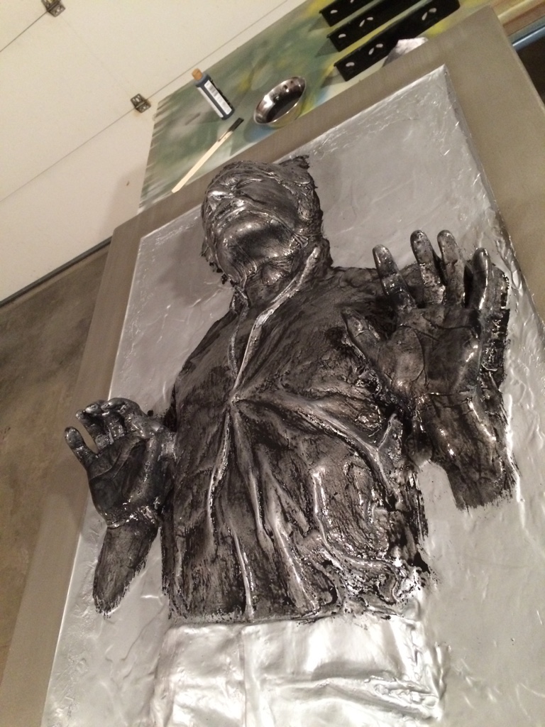

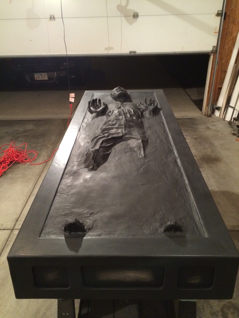

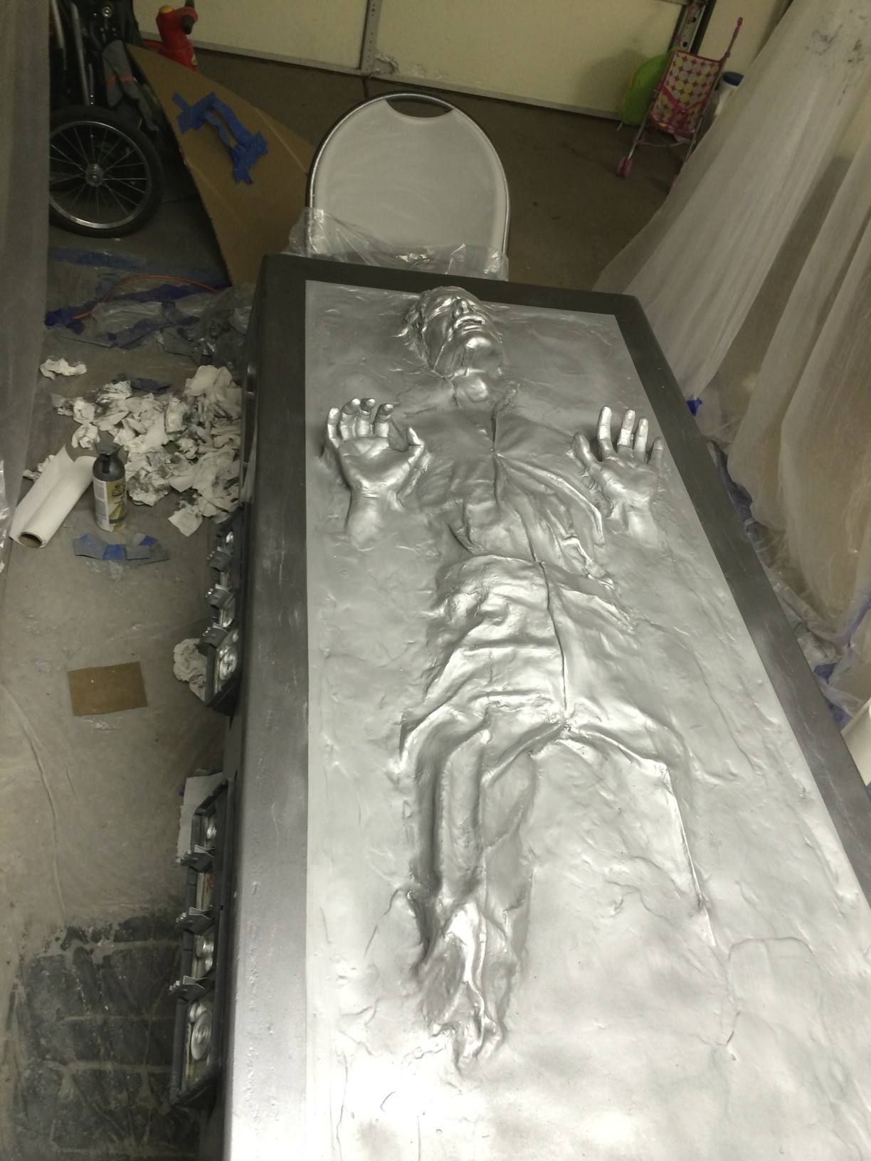

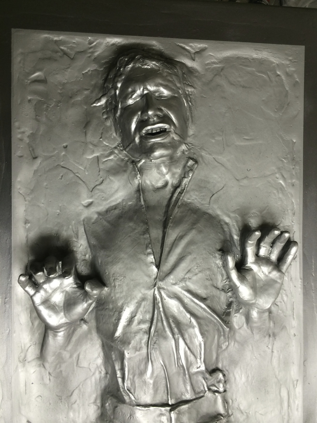

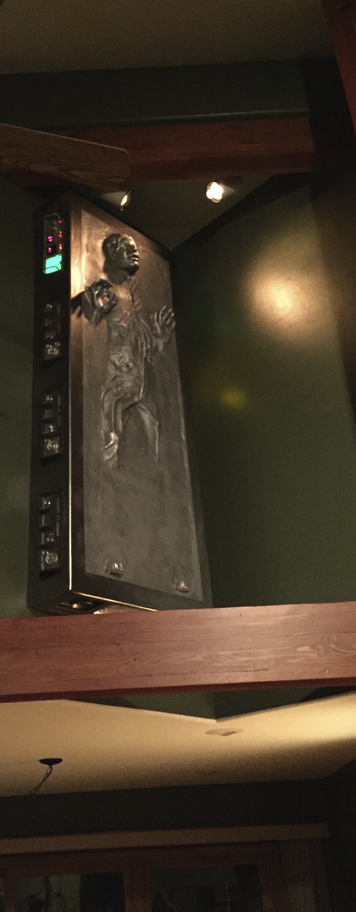

Hi Guys! I just finished my HIC http://www.therpf.com/f79/my-hic-build-2014-a-228019/#post3475456 and here are the paint codes I used.
All of it is Rustoleum...
Block Primer = 249418 Black Sandable Automotive Primer (4 coats, hand sanded between each coat with 1000 grit paper)
Panel Primer = 249088 Flat Grey Primer

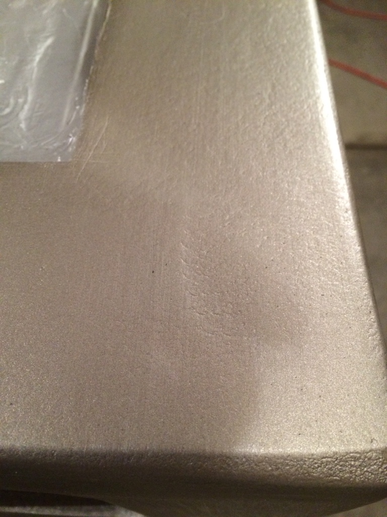

Block = 7519 Stainless Steel (also applied 4 coats, hand sanded between each coat with 1000 grit paper)
Han = 7277830 Metallic Matte Nickel
Volvo Panels = 7715 Aluminum
Back of Block = 7776 Flat Black
Shiny Metal Greeblies = 7718 Chrome
Small dented greebs (nipples) = 7715 Aluminum (If you look closely at the small parts between the turn signal arrows on the dash boards, you will notice that they not all dark grey.)
Wider greebs (nipples) = 7519 Stainless Steel
U Clips = 7519 Stainless Steel
Rings = 7718 Chrome

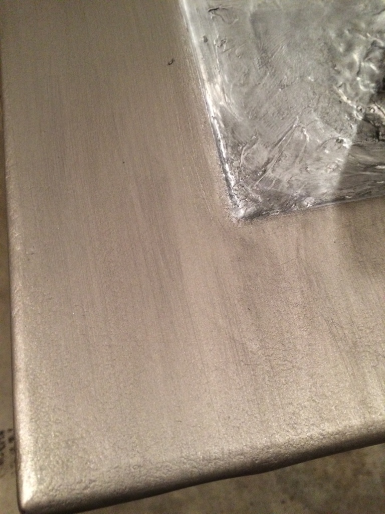

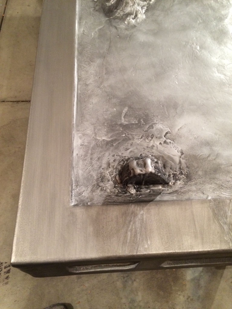

Black wash = Acrylic Black with a 1 to 5 ratio of paint to water. (Wait 7 minutes and wipe away excess with a wet towel. I applied 4 washes to get it right and then took a photograph in the dark with a flash to get a real wash exposure to ensure accuracy. Your eyes play tricks on you when the block is on it's back and you can't get away from it to see the entire wash. I actually took the photos from a 16 foot ladder looking down on the block.)
When I painted the block, I used steel wool and 60 grit sand paper after the final coat of stainless steel. I literally pressed the steel wool into the paint at the top of the block and walked down the side in one complete motion. This put a constant line pattern in the paint and allowed the black wash to fill micro grooves in the paint giving it that "actual stainless steel" look. The paint is stainless steel color but real stainless has small black lines in it from the rolling process. I wanted my block to look weathered; like real metal.
Any way, here are the pics of the completed product Hope you like it. I am having issues uploading so I will put then in a separate comment via Tapatalk.
Thanks,
Warp
ImageUploadedByTapatalk1414990780.816165.jpgImageUploadedByTapatalk1414990799.232854.jpgImageUploadedByTapatalk1414990817.101121.jpgImageUploadedByTapatalk1414990842.005119.jpgImageUploadedByTapatalk1414990854.623444.jpgImageUploadedByTapatalk1414990864.321822.jpgImageUploadedByTapatalk1414990882.273243.jpgImageUploadedByTapatalk1414990892.607823.jpgImageUploadedByTapatalk1414990921.878494.jpgImageUploadedByTapatalk1414990944.328485.jpgImageUploadedByTapatalk1414990963.596778.jpgImageUploadedByTapatalk1414991030.185783.jpg
Sent from my iPhone ImageUploadedByTapatalk1414991290.371819.jpgImageUploadedByTapatalk1414991339.725251.jpg

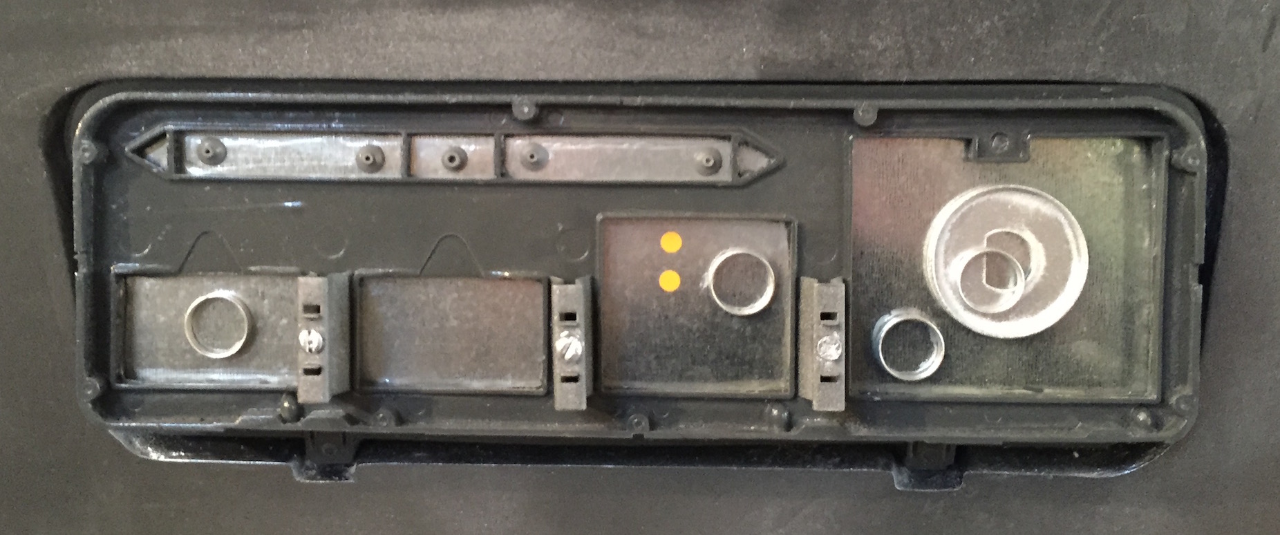

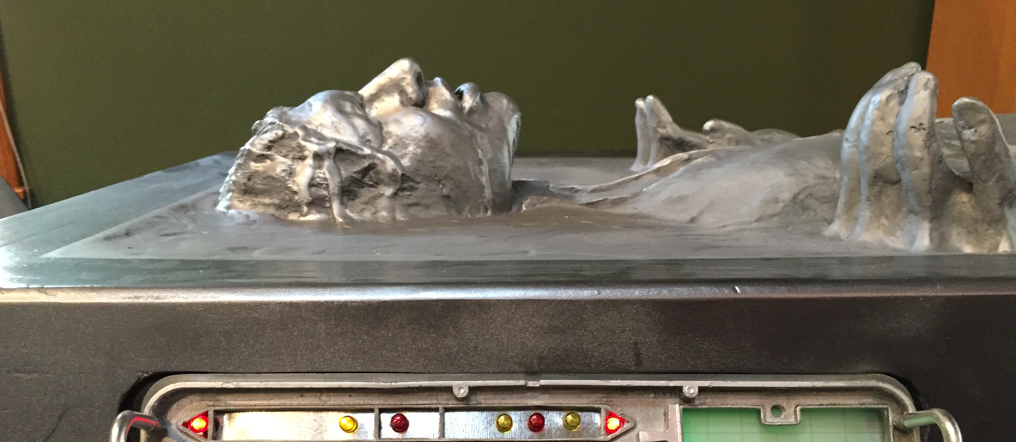

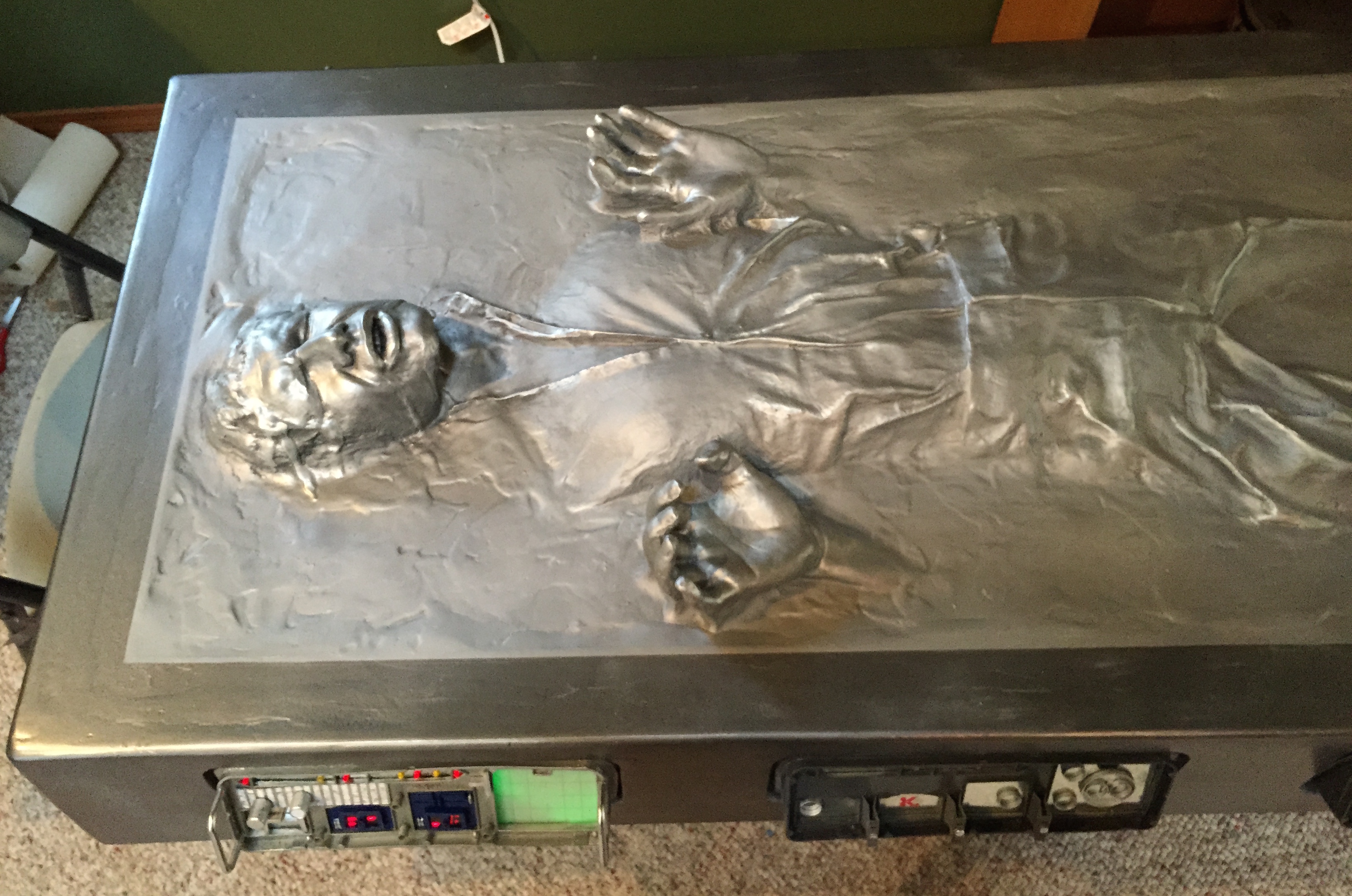

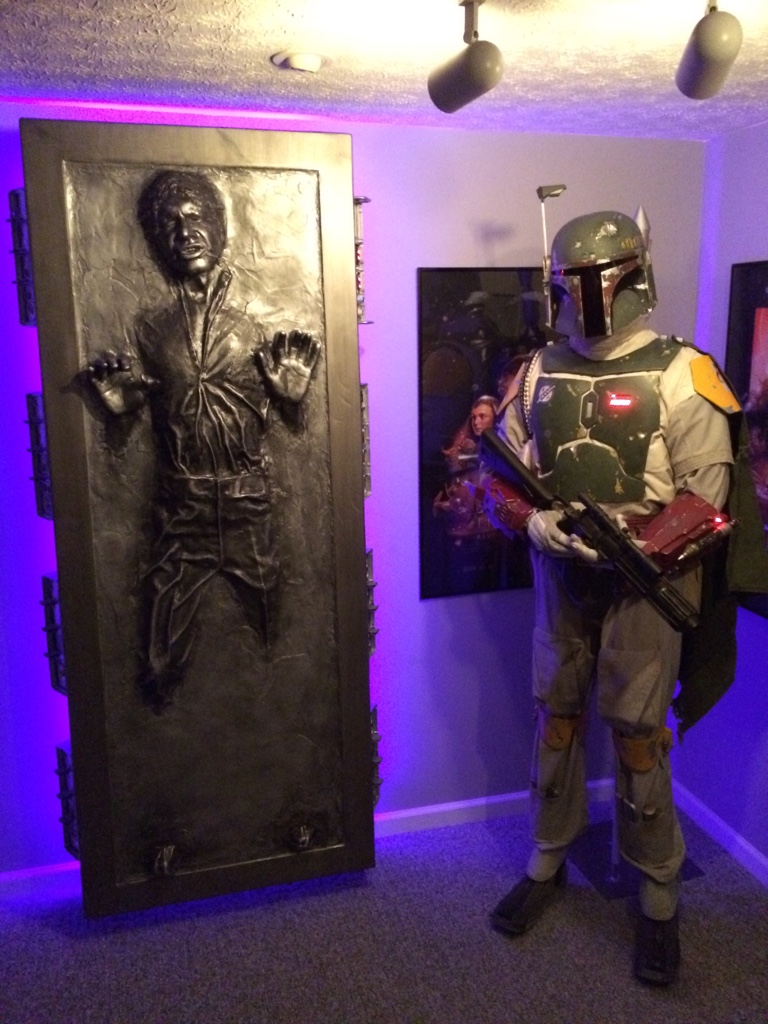

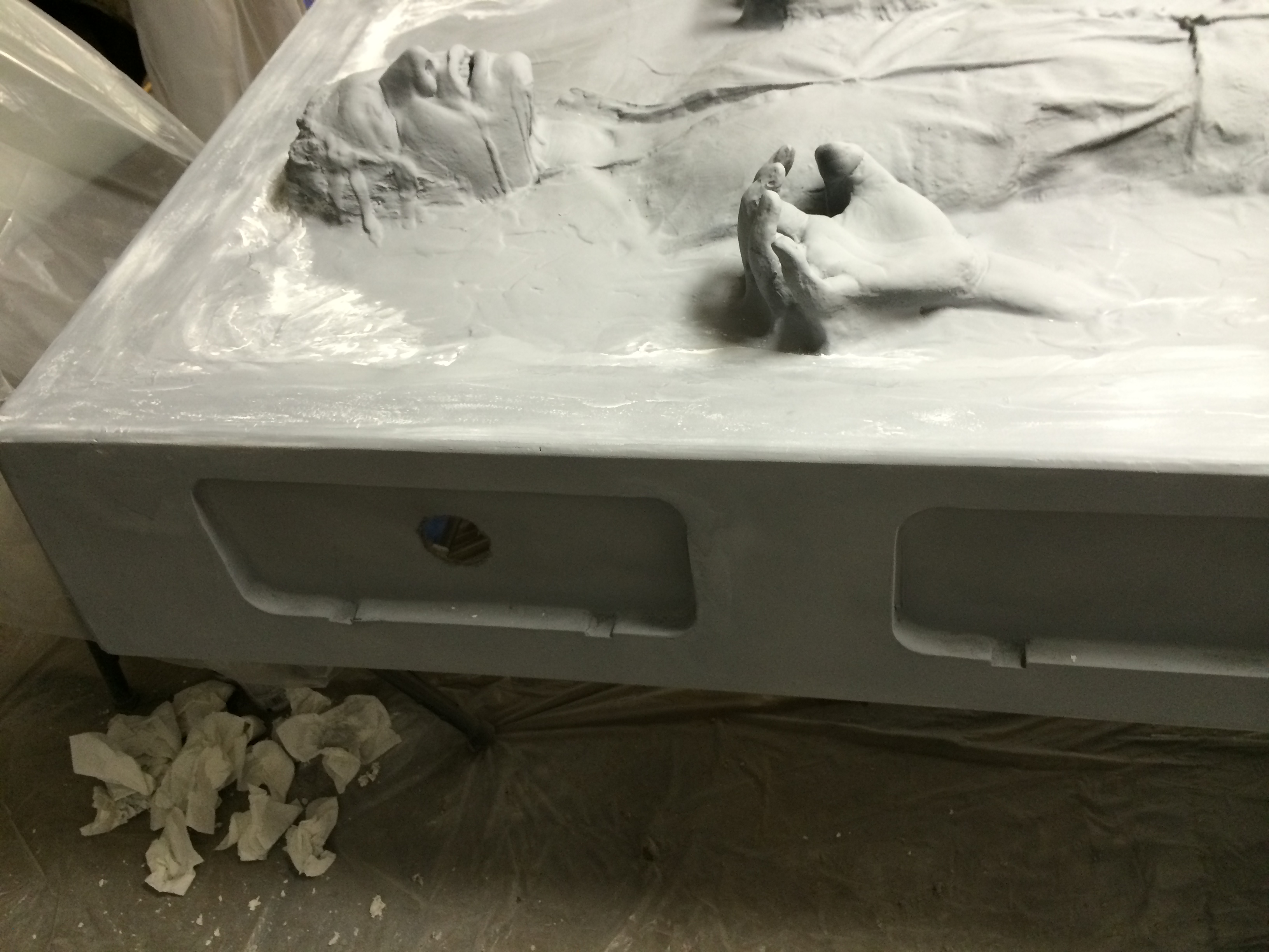

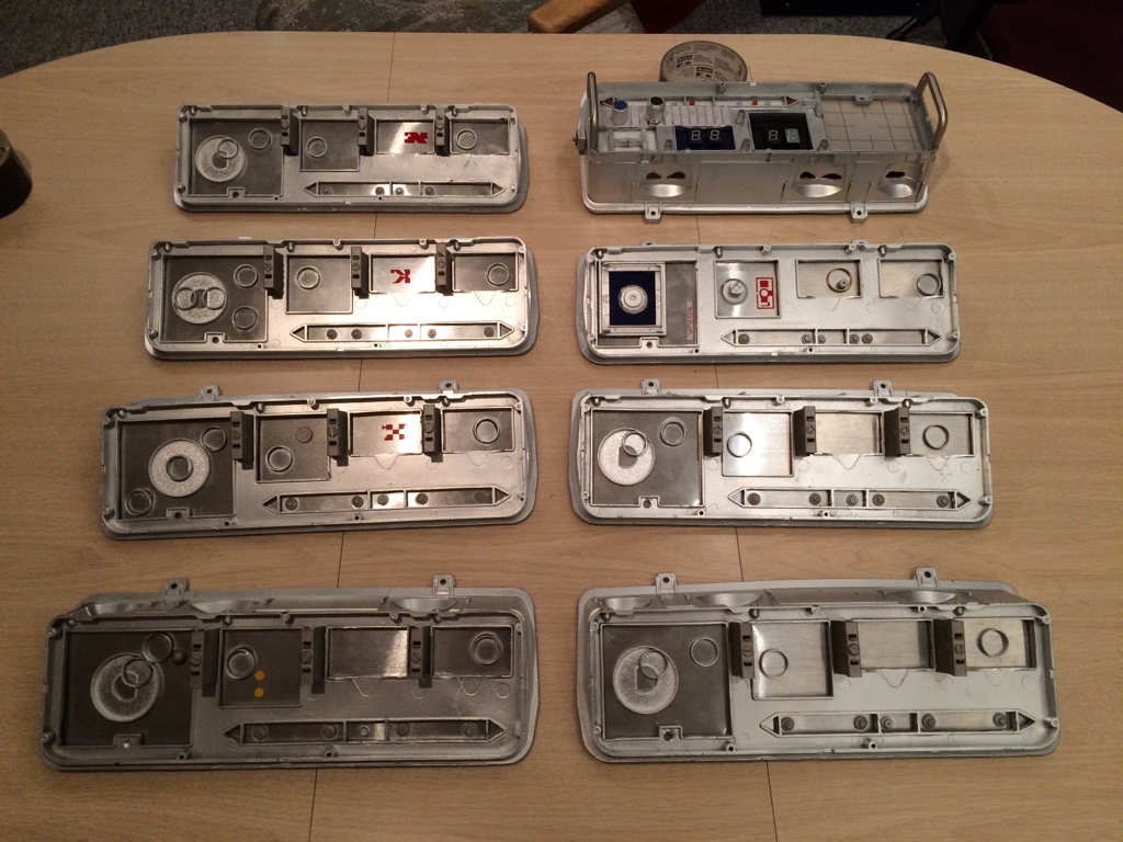

Here’s my HiC, which I just finished recently (full write-up of my build and wall mount). I went with the ESB color scheme. Here are all the paints I used.

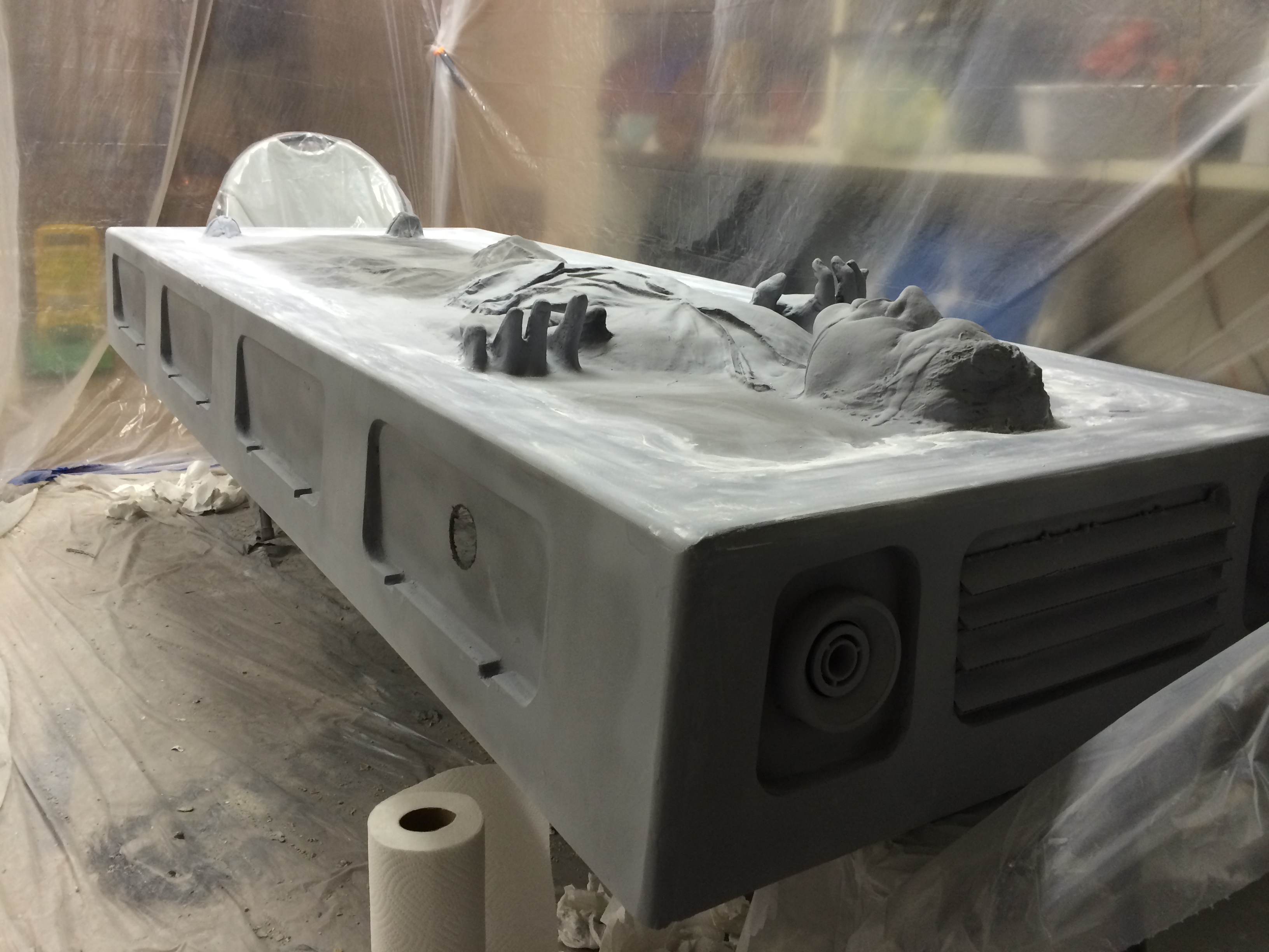

The entire build was primed with several coats of Rust-Oleum Automotive Flat Gray Filler Primer (SKU 249279):
Frame is Rust-Oleum Metallic Dark Steel (SKU 262662):

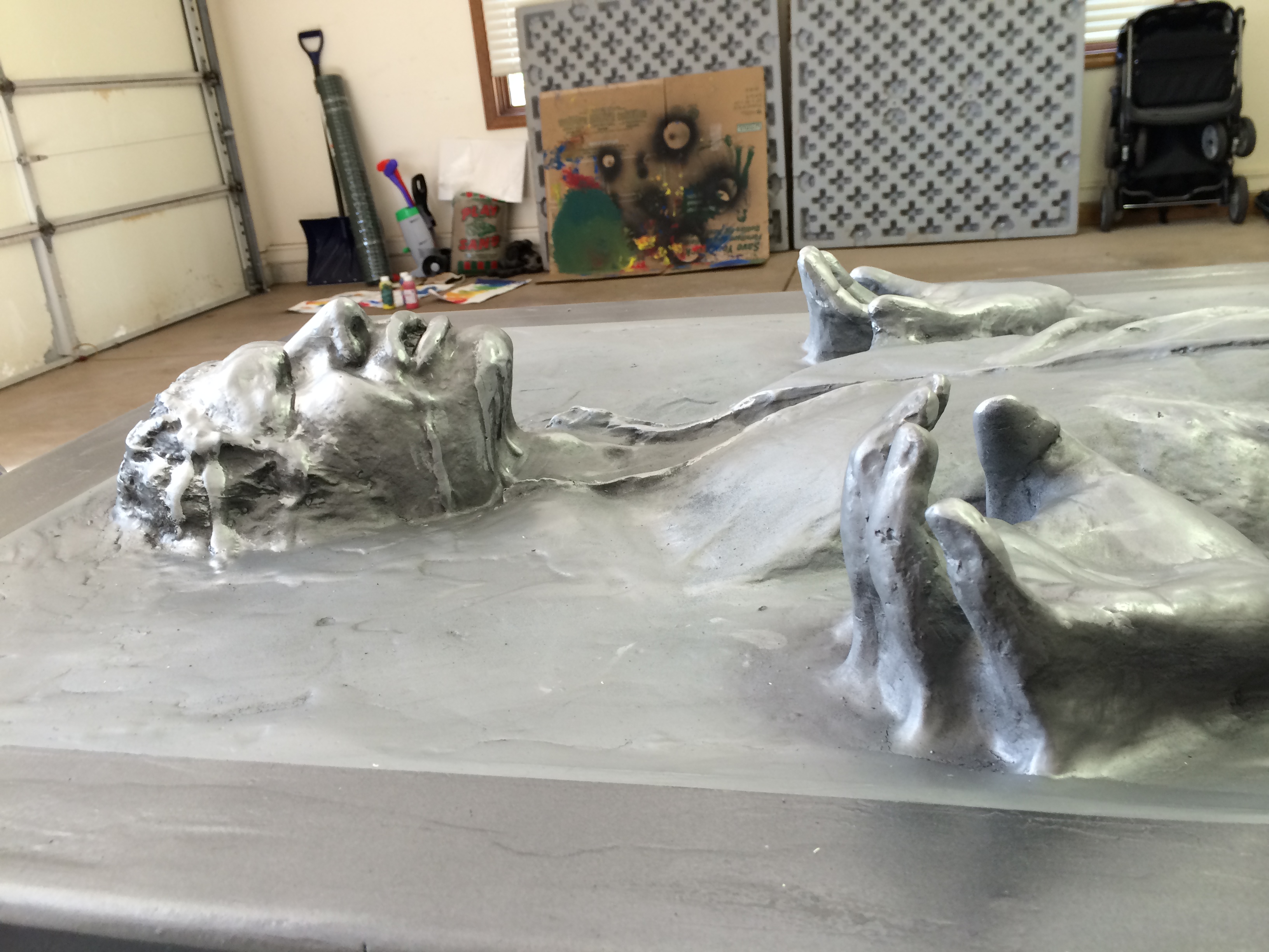

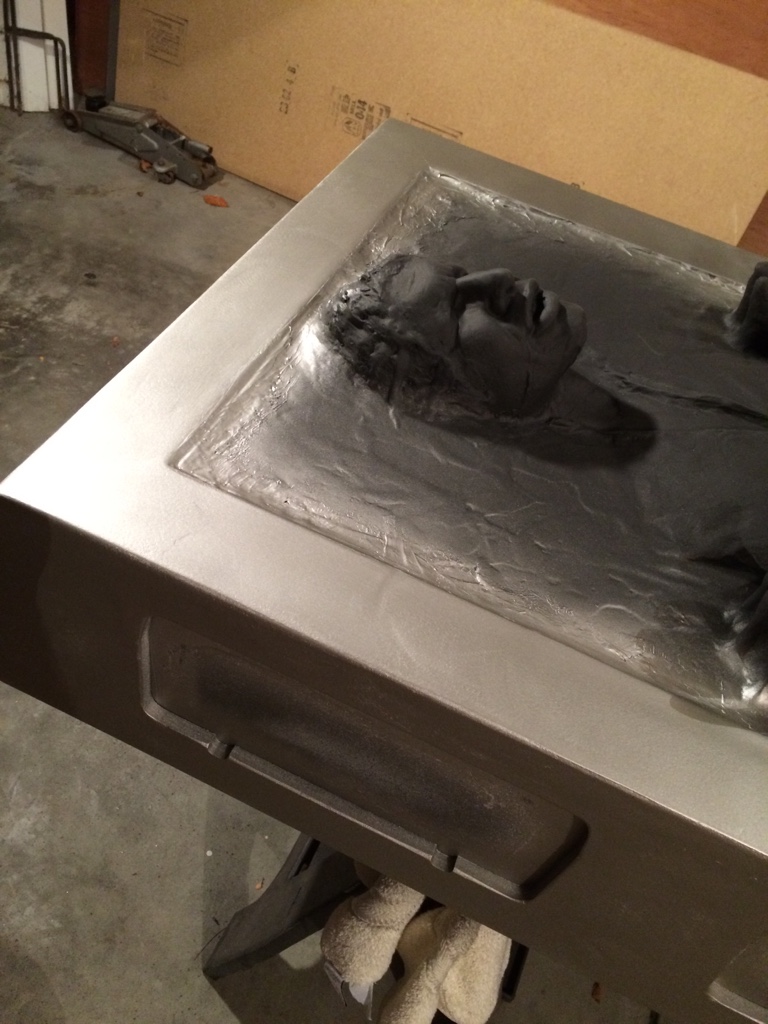

Carbonite is Rust-Oleum Metallic Matte Nickel (SKU 7277830):
Which was then given a wash with 10:1 water to Plaid Delta Ceramcoat Charcoal acrylic (SKU 024360202W) mix, with a little dish soap mixed in. I used a large brush and let it sit for a few minutes before wiping it away from everywhere but the valleys. Then I went back and used AMACO Rub ’N Buff silver leaf (SKU 76370K) to get all the highlights:

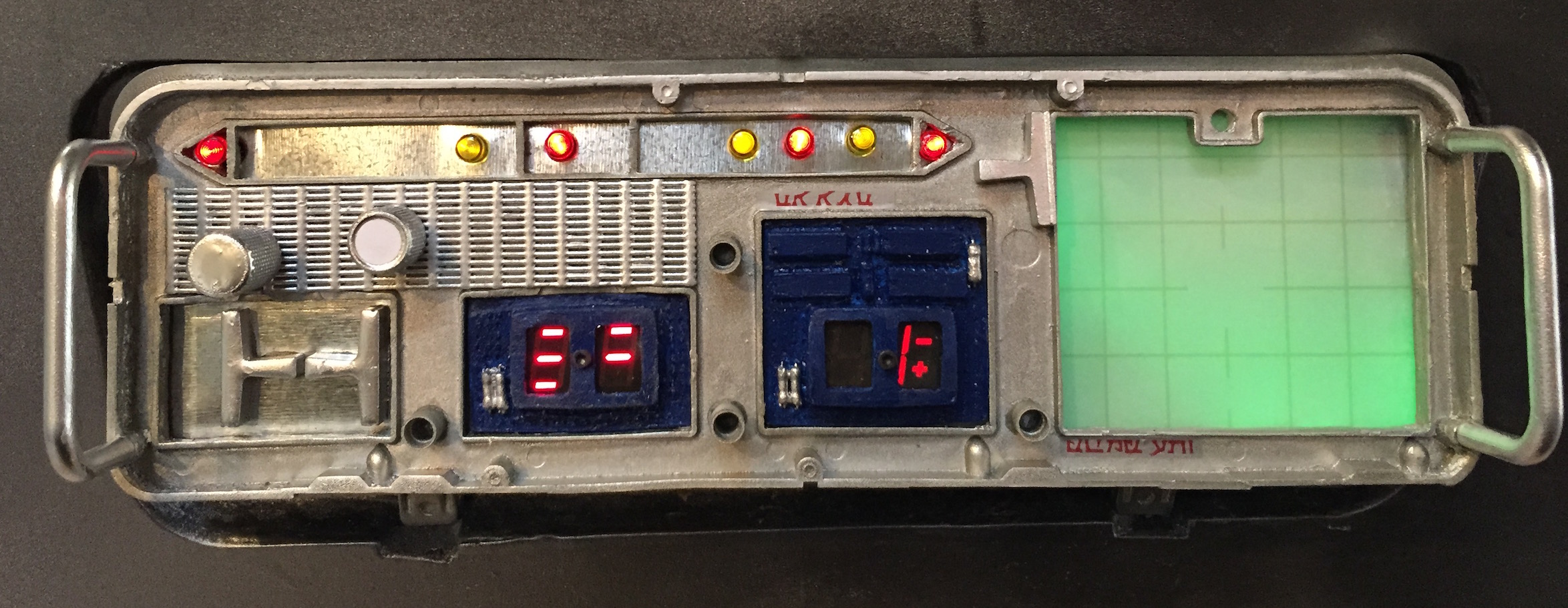

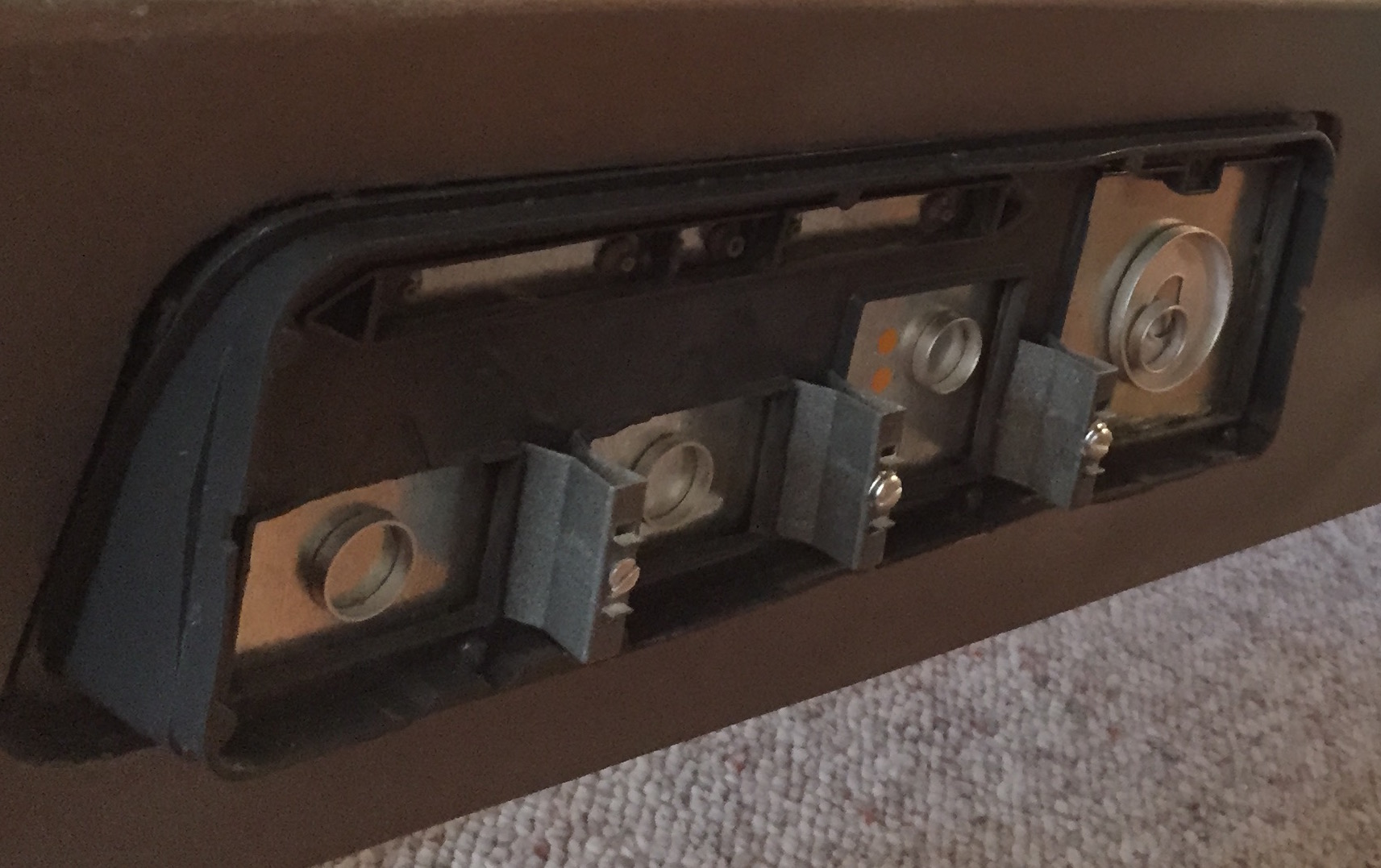

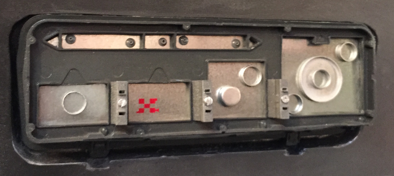

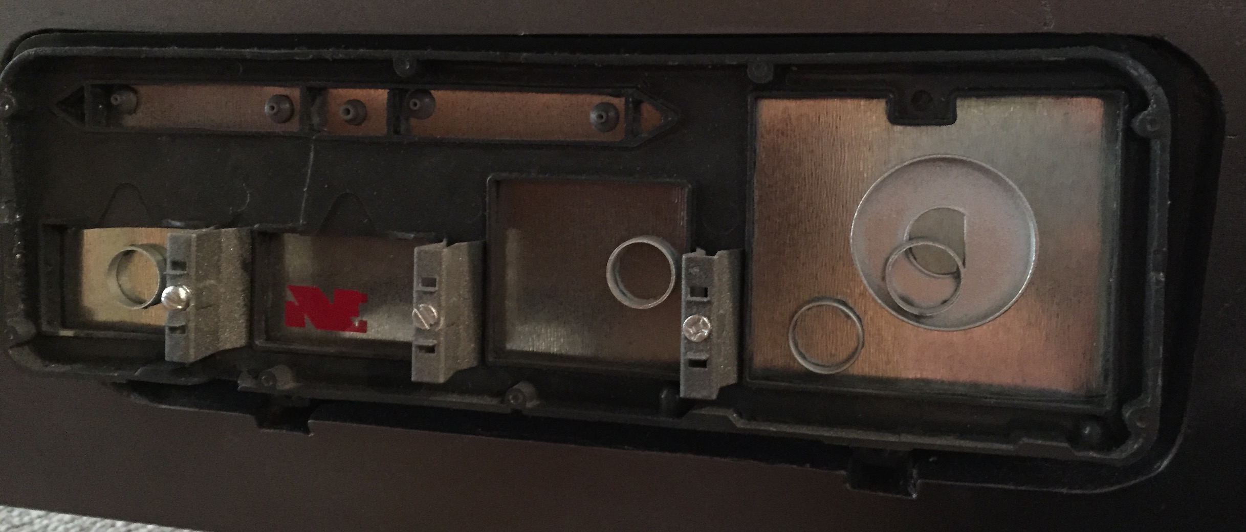

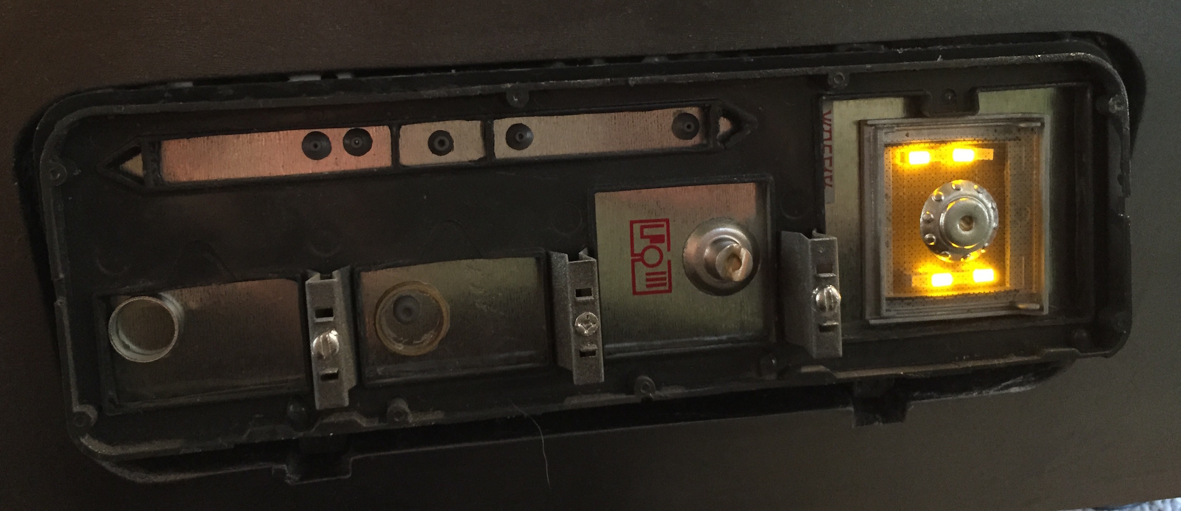

The non-hero panels were painted Rust-Oleum Charcoal Gray (SKU 7784830). The various greeblie nipples were painted Rust-Oleum Dark Machine Gray (SKU 7587838). The hero panels and the hero panel screw box were all painted Premium Decor Metallic Silver (SKU 793304). The various discs and rings, along with the “2nd hero panel’s” round greeblie and raised greeblie, and the hero panel’s knobs, handles, and “T”s were painted Premium Decor Metallic Chrome (SKU 329276). The unique ring on the 2nd hero panel, the small screw details on that panel’s unique chrome greeblies, and the screw & spring greeblie were all painted Folk Art Metallic Gold acrylic (SKU B000Y0078G). The perf boards for the hero LEDs were painted Folk Art Ink Spot blue acrylic (SKU B00COIRM3E). The hero panel grills, hero panel “tubes”, and 2nd hero panel “viewfinder frame” were painted Rust-Oleum Metallic Aluminum (SKU 7715830). The U-clips were painted Krylon Metallic Textured Graphite (SKU 2521), with the screws hand-painted with the Premium Decor Chrome:
Left (top to bottom): left 1.jpg left 2.jpg left 3.jpg left 4.jpg
Right (top to bottom): right 1.jpg right 2.jpg right 3.jpg right 4.jpg
Whew! All done!
