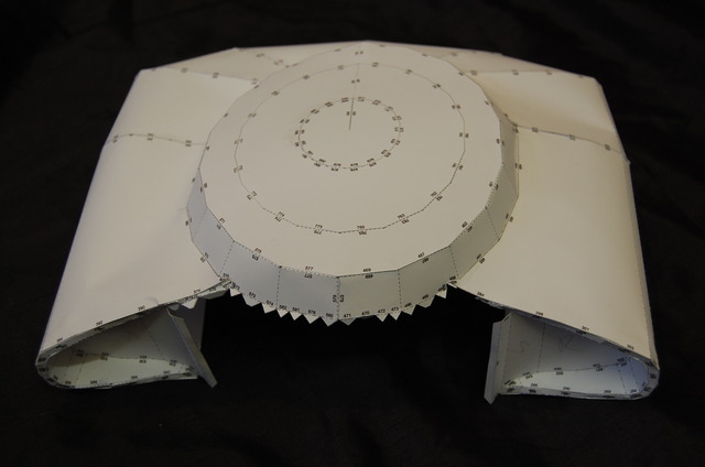

Sticking with the ethos of making as much as possible, Boushh looks a lot less complicated that doing a Fett. we begin with a pep file for the helmet and the rest will be mostly soft parts,
so far we have started the helmet and I hate it already its weak and floppy looking, there are areas of improvement for the pep file that we will be adding to make it stronger in places and give it straighter line's other wise it will end up as a giant ball of filler and weigh a ton! we plan on doing a fiber glass interior to make it strong and my secret mix of filler on the outside to smooth it out :)

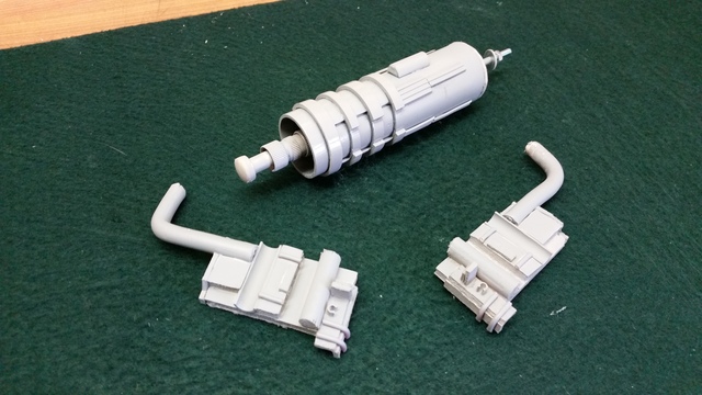

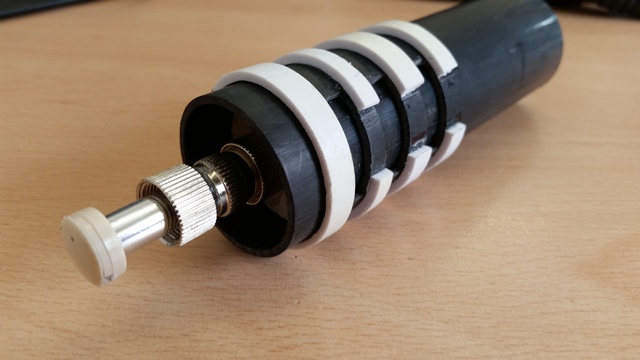

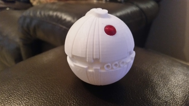

got hold of a thermal detonator already my first 3D printed item ''snazzy'' that will need all the electronics in it I have an idea already for sound and lighting but that's way off yet, this will be about a year long project to get it up to a high standard so no rush on this... slow and steady..

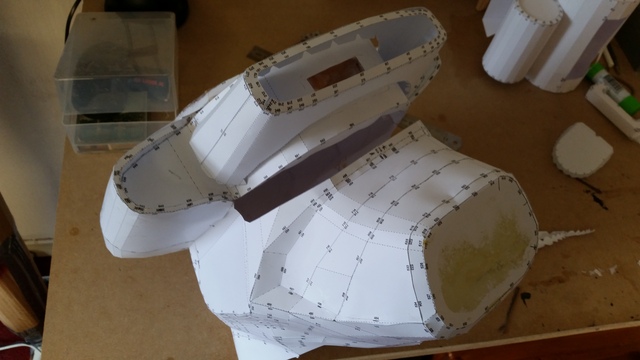

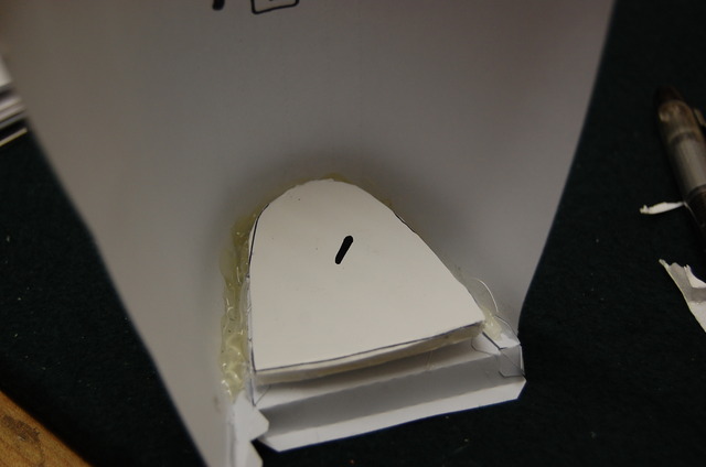

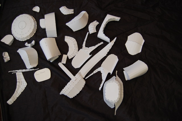

This pile of folded paper is apparently a helmet! so it says....and it took a while to fold it and glue it that's for sure so I am glad there were two of us for it!
there are areas all over it the will be replaced with framing card or backed with cell foam to make it more ridged

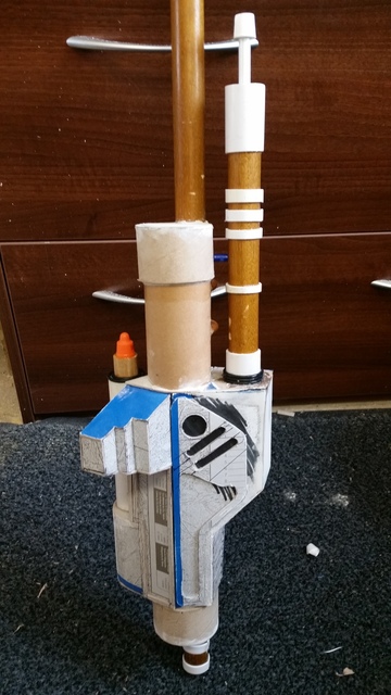

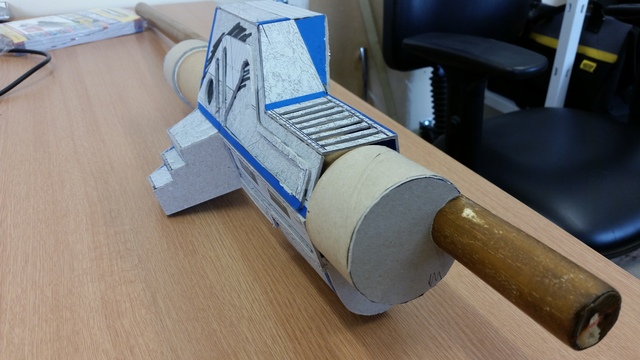

The electro staff is a hard one, there is almost no reference for it, but I have managed to cobble together some dimensions for it, this build id going to take time that's for damn sure!

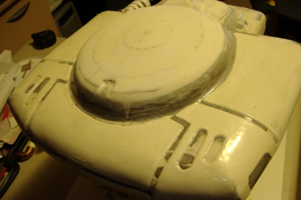

Fiber glass is all finished its good and solid. now for the fun bit......filler :sleep
I want to get it glass smooth if I can as it has such a large surface area it will be easy for pits and dips to form, this one will take a few coats of filler I am sure of that but should be worth it in the end.
The electrostaff is coming along slowly, I cant strees how strange of a shape this thing is and nothing to go by when making it so its mostly guess work at this point...

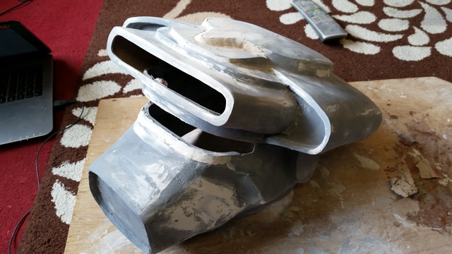

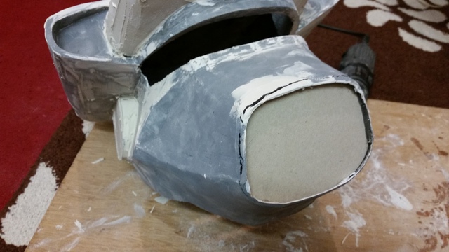

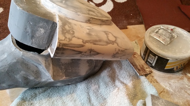

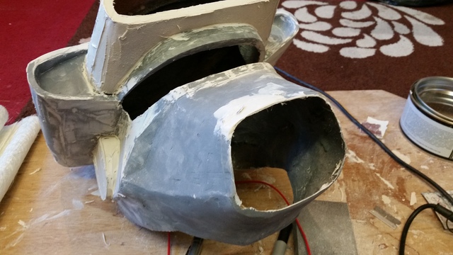

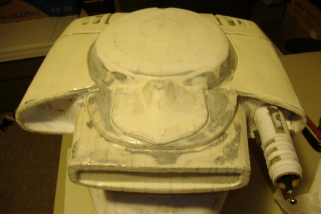

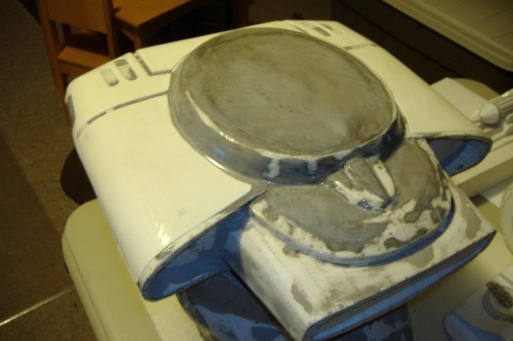

the snout section of the helmet needed cutting out as the mouth, bumpy, bits? (what ever they are) need to sit recessed inside the snout and not just on top of it
Lots of filling needed on this and then sanding and the filling again and so on, while that was all going on my Girlfriend was busy on the details works (top visor, ear caps and so on well I did the main body of the helmet.
All the damage has been added to the right areas but it still need a lot of work with the fine detailing.

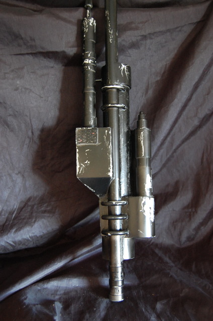

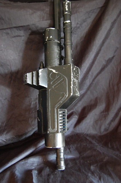

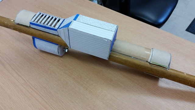

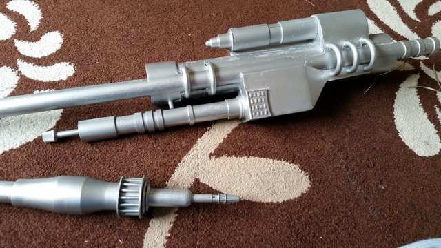

along side all this the electro staff has come along nicely, I have all the bits together and it looks the part but is not 100% accurate, again there is work to be done!

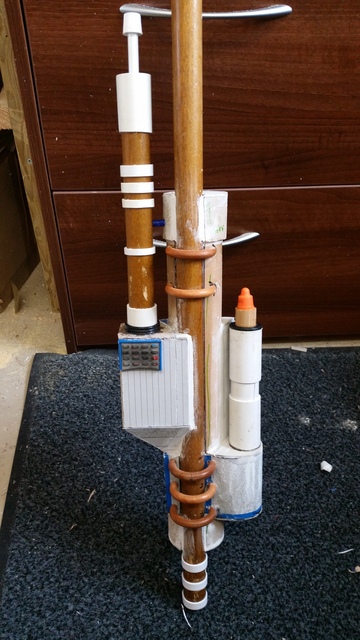

Got the electro staff finished and painted in silver, just need to get the masking fluid on it and so on.

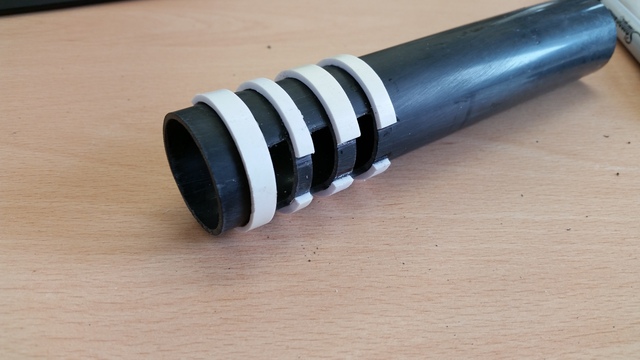

The greeblies are coming along nice, they are made with anything I have to hand and trying to keep it close to the original I am under no illusion that they will be 100% but will be close to the mark.

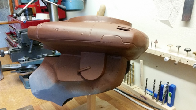

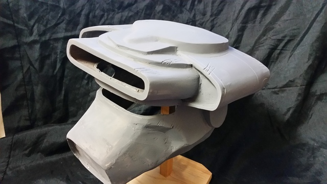

I have started the paint on the helmet well my Girlfriend continues with the soft parts
This base brown is far to light on its own, but it is just a base for the moment.

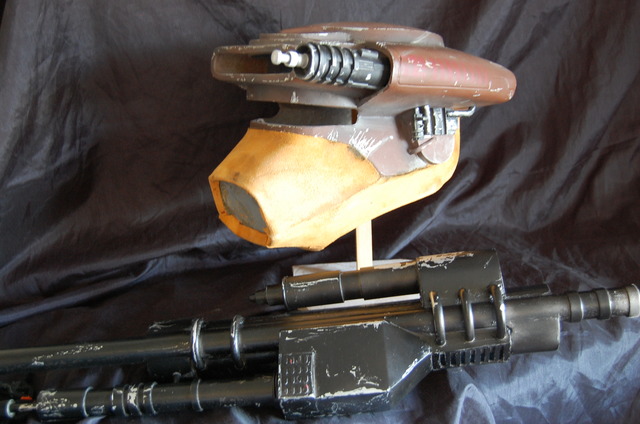

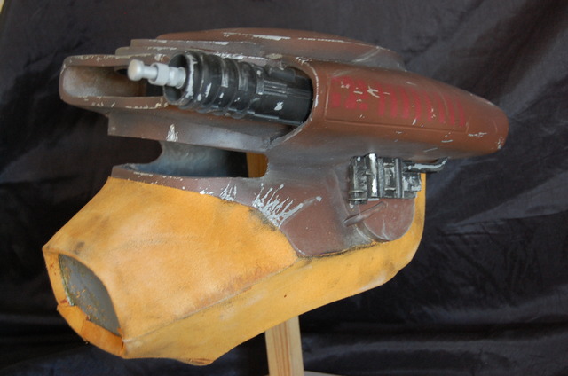

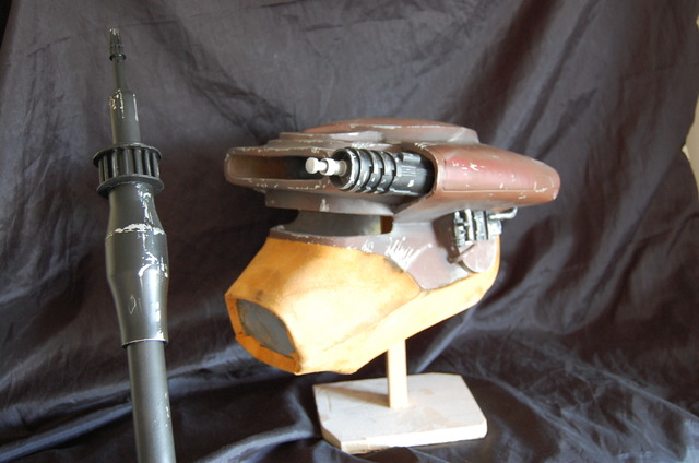

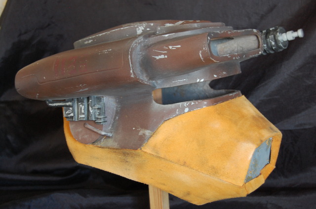

The helmet is almost done as is the elctro staff,
I added a little keypad as I felt there needed to be some visual cue as to how this thing works, so I thought a few buttons would add dimension to it...
I have tried to capture the cloudy/dusty look to the helmet but brushing on some grey with a bit of beige mixed in as every pic I have seen the brown is washed out quite a lot with this strange patina it has,
getting that leather on the front was no fun, at all in any way!, I have a very small supply of it and point in fact its the wrong color on camera its way darker in normal light, so its almost done I need to add the visor and the face plate, put a liner in it and fans and that's a wrap on it :D

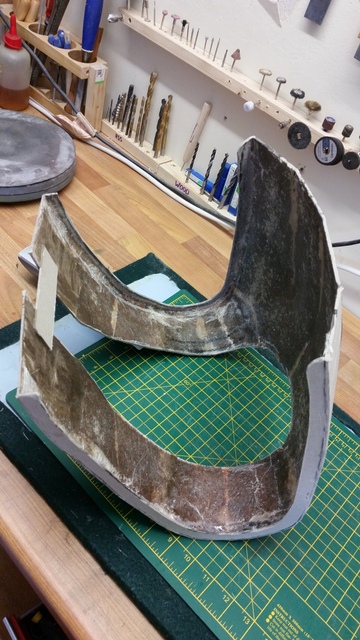

Fiberglass is great if you prep it all first...cut all the shapes, plan your moves and get the mix right.... It can be a tad heavy but just feels absolutely solid.. very forgiving if you make a mistake to cut it back etc.... its a bit old school when you think of slush casting and so on but I like good solid objects that have a good weight to them....they sit better on your body and move right....

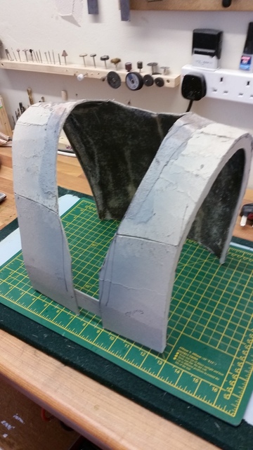

I have started the body armour,
the only way I could get the shape right was to fit it to my Girlfriend and add a strip of fiberglass (well still wearing it) to the outside running the whole way from top to bottom, once it had set we removed the armour from her and it then kept its shape, then I fill the inside with fiber glass and cut back the outside strip we added at the start, kind of like removing a scaffold.
Still very raw I have since started the filling and shaping, the helmet I am pleased to say is finished all apart from the top visor, I wont be adding that just yet until I have the lights all worked out, I will add some picture soon for that.
