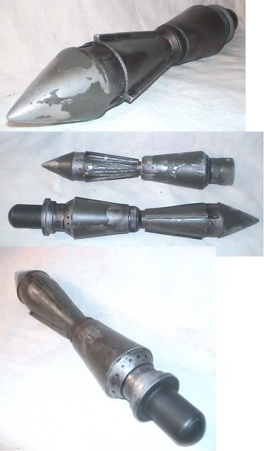

An airbrush will give you nice smoked effects, but for the spatter patterns, just use black spray paint. If you barely press down on the valve, it will 'spit' giving you that effect. I highly recommend practicing this before trying it out on your jet pack. The toothbrush technique will work too. Here is how mine turned out.

I used a simple black matt spray can... but I tested some brown, grey and black misting cans on my helmet and that looks alot more convincing.
so I might actually go at it again with brown and grey at some spots...

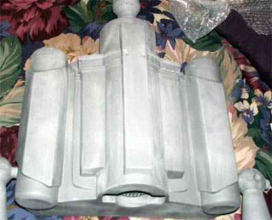

Hey gang,
Well I finally unmasked my pack last night and today after work I started the weathering. Im about 80% done with the weathering, then all I need to do is knock out the rocket and nozzles. Before I did any weathering you don't know HOW HARD it was to accept that the orange from the wal mart list was the correct paint to be using. I kept looking at it for a long time, thinking the pack looked too dark, and contemplated several times re-masking with and going over that orange with dark yellow. I but my lip and proceeded with leaving it alone. Only until I got most of the chipping and dirtying done did I realize that the colors were in fact right. I guess it took the lightness of the silver to give it that right look and Im VERY pleased with the work I have so far. I would appreciate any feedback towards my paint work if possible.
Attached are of course the before (primered 'glass) and what Im up to now in the after shot.
