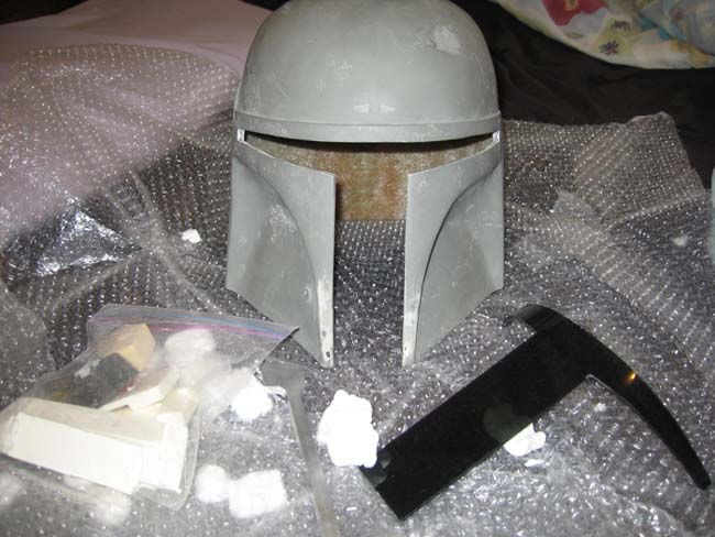

No turning back now (pic)
Fettist
Got my first bucket today and am excited as can be about painting it...
Thanks DL
K so im ready to paint it and have done a lot of research and am wondering if these links are the paints I need for my airbrush... And for an esb bucket!

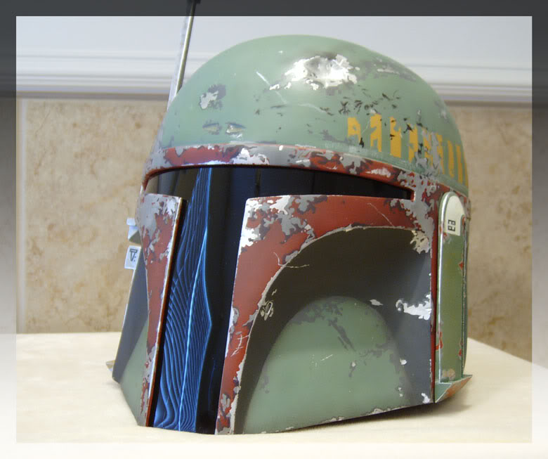

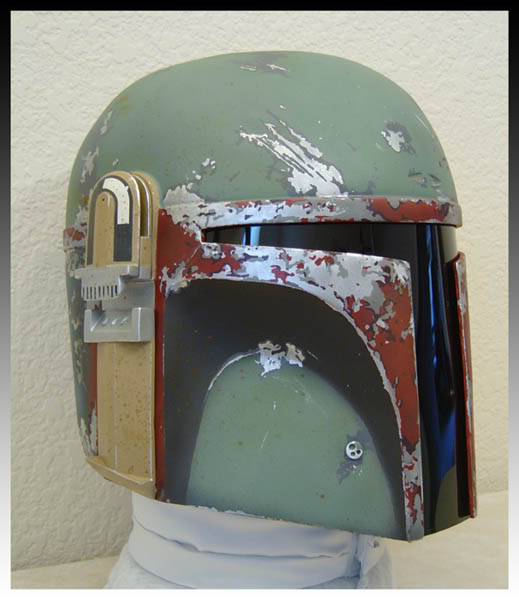

Man thats a nice paint job!
One day, one day,i shall have one as nice:-)

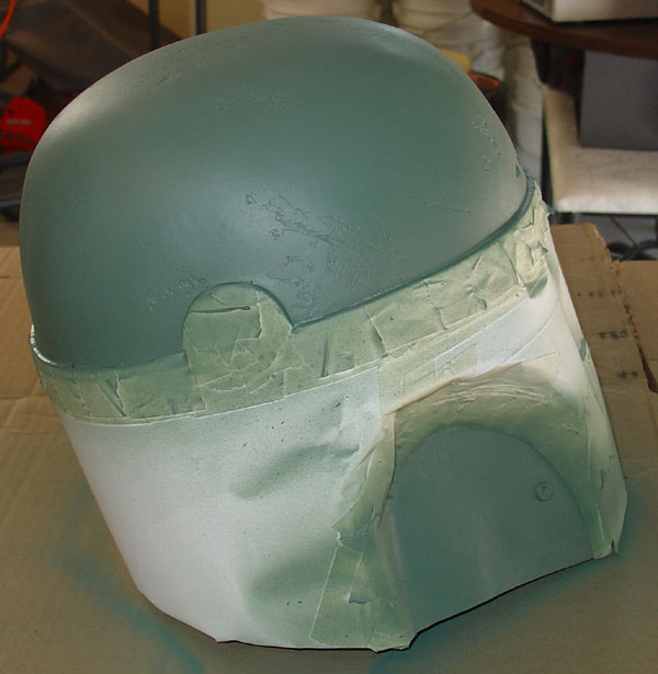

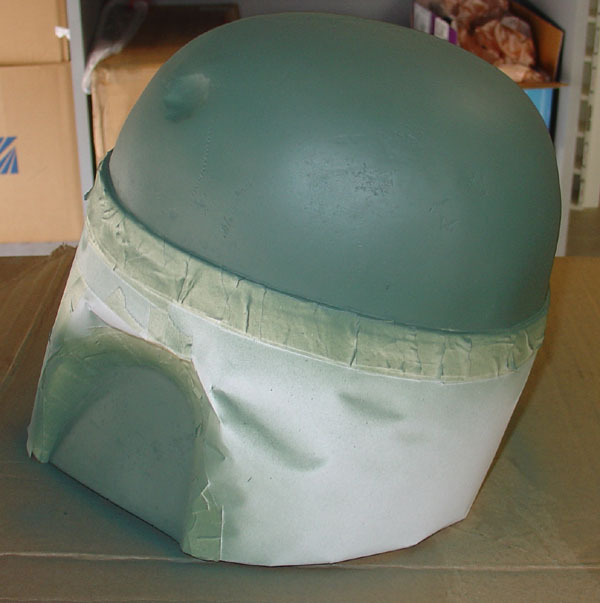

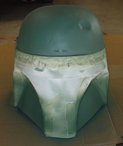

OK so finally I had the time to paint a bit...It was frustrating at start but not too bad after the whining ended...
I have pics of my fiance masking for me. That was harder looking than it really was...even though I didn't mask it. I will add those later if anyone wants them. They are in my other camera and it is dead right now...
Looks fine.....it's too hard to tell from the pics whether you need another coat. I'd advise two just to be sure.
I'd also advise using some model masking tape from here forward. It cuts and bends MUCH better than household masking,which you're going to need for the inner cheeks and mandibles. It usually comes in 1/2,1/4,1/16 inch increments. I use a brand called "Pactra"....it can be found at www.towerhobbies.com which is an R/C site,but has plenty of other stuff. I believe Testors has plenty of their own mask,however I've just become used to "Pactra".
Once you mask the outline of the area to not be painted with the modelling mask you can go in with regular household mask to do the rest....just overlap onto the model mask....NOT the tan stuf as it's too sticky....I'd advise 3M painters Blue tape in medium tack.
Looks good so far:thumbsup:
Steve
Looks good so far. :thumbsup:
A second coat of paint couldn't hurt.
I also agree with DL44 on the tape suggestion. It also helps if you stick the tape on a solid surface first before putting it on the helmet. It helps reduce the chance of the previous layer of paint peeling up with the tape.
