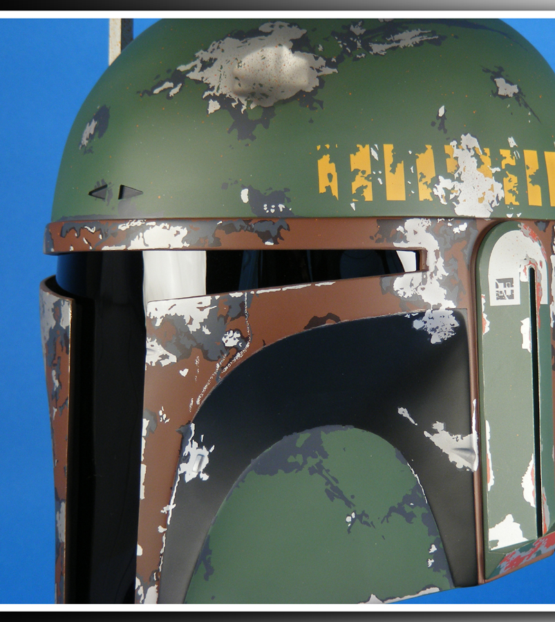

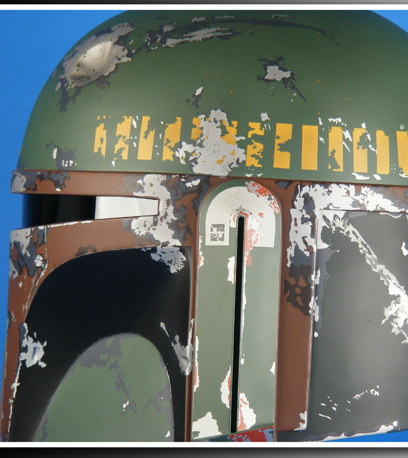

Man that dent must have been caked in paint! the lines are so much more detailed than the 'in the box' version...
FP, so because there was sooo much paint on top of that thing...the weight has changed I'm sure, but has the size changed too??
Well, I was over exaggerating a little bit. But I would venture a guess, that is lost at LEAST a few ounces in weight with removing the gobs of paint. I wish I'd took pictures of that. I'd swear that in some areas there was upwards of 1/16 or more of paint build up :lol: That, is just uncalled for :angry
Overall size wise, that's a tough one. Dimensionally, here and there, in some places, sure thing. So I really can't answer that. What I do know is, most will uncover a trim line at the rear bottom that wasn't completely trimmed ... I noticed that line matches up perfectly with the MR proto that Art posted ;) So that will affect it a bit I think. But all in all, the ear areas at least, are still the same if that's what you mean.
Embarrassingly so :facepalm If EFX revisits this helmet, they need to have this suggestion offered to them on a platter - "be carful who you outsource this to".

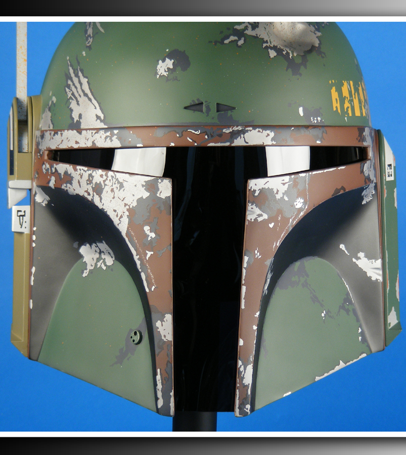

When you start doing your mods to correct the visor issue could you please post some pics of this process? I am curious if you will need to take down the thickness of the inside brow to match the thickness of the mandibles so that the visor will sit flush. I am also curious if the lacquer thinner will take the paint off of the RF stalk?

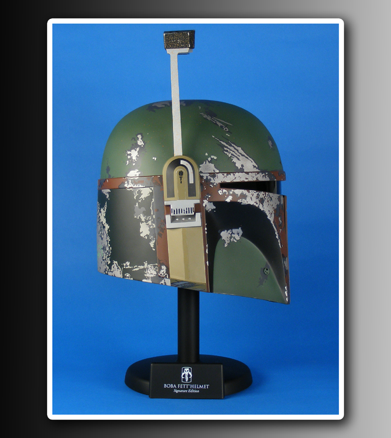

Picked up a MR helmet from a local toy store today.
It's pretty awesome and man does it smell bad! :lol:
Signature Edition 353 of 750

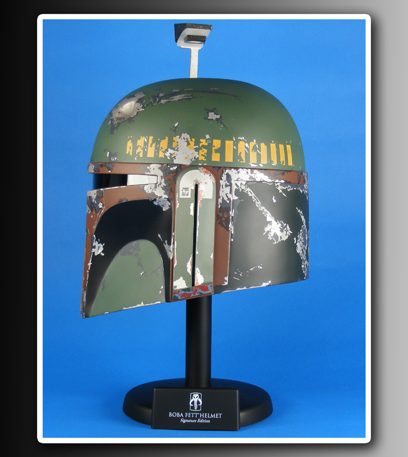

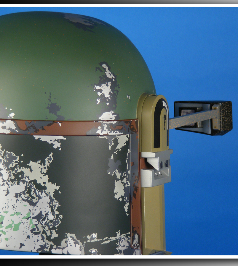

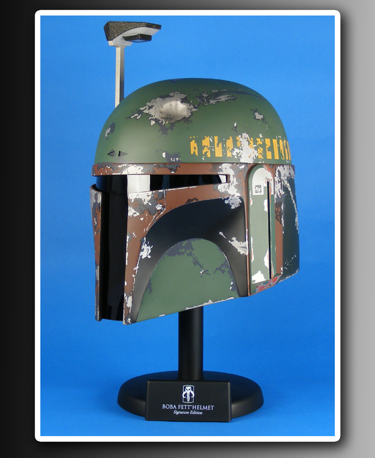

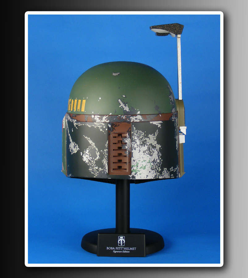

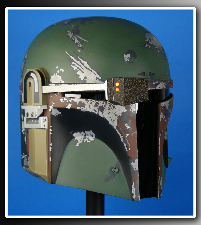

Here are some pics.
the last pic is kinda a photoshopped version of what the tapper on the lower visor might look like spread out a little.

I have an LE Helmet and I don't think MR should have sold these with the mess up T-visor. I have my Helmet on display....... every day I think about gutting it out and fixing it. I'm just worried about cracking it when I straightin out thr mandibles.
