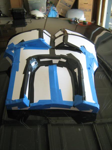

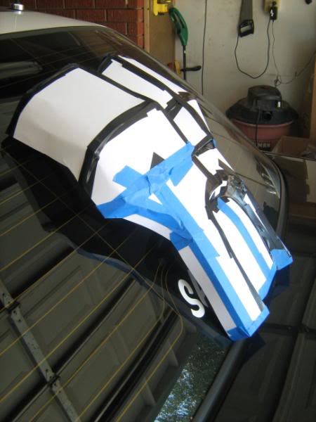

today i went out and purchased some poster boards to start my build. this is how far i got today...

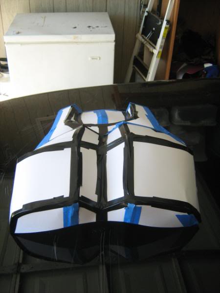

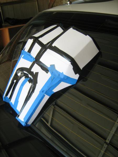

chest/ab plate build
right now it's just poster board held together with tape. the next step is to hotglue all the interior seams. that will be followed with taping a flat back to the chest/ab plate that i can use to mount it to my carrier with. once the backs on, the fiberglassing begins.
the chest may seem a bit exaggerated. if so, it is. this is for two reasons. 1 i'm using the comic artwork from the vector comics as my inspiration and 2 i'm a big guy with a barrell chest so i can carry it and pull it off.
i'll keep th wip pix coming. lmk what you all think!

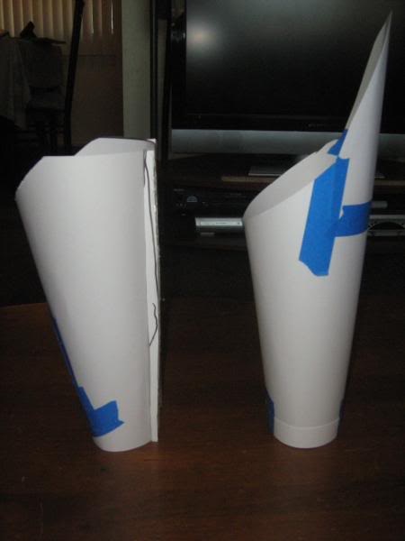

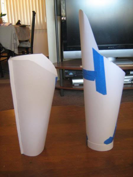

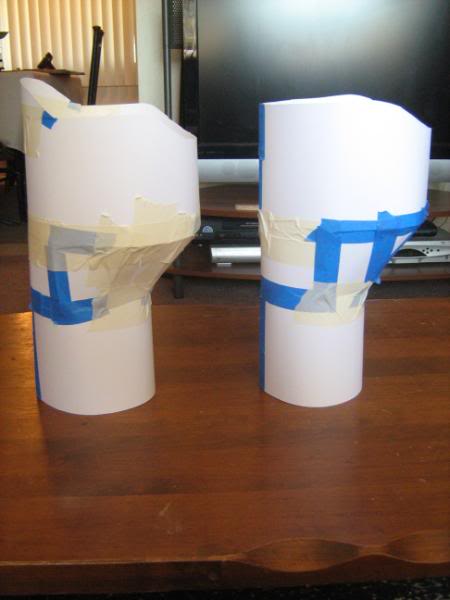

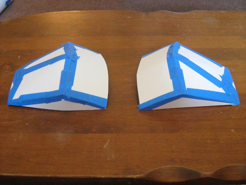

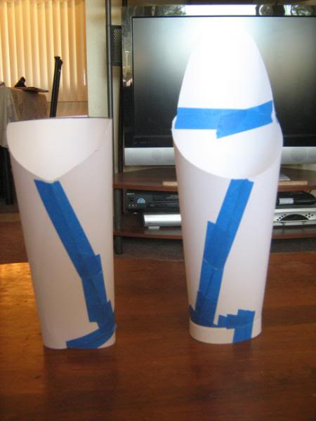

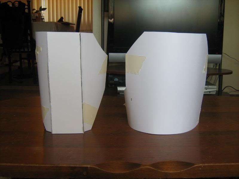

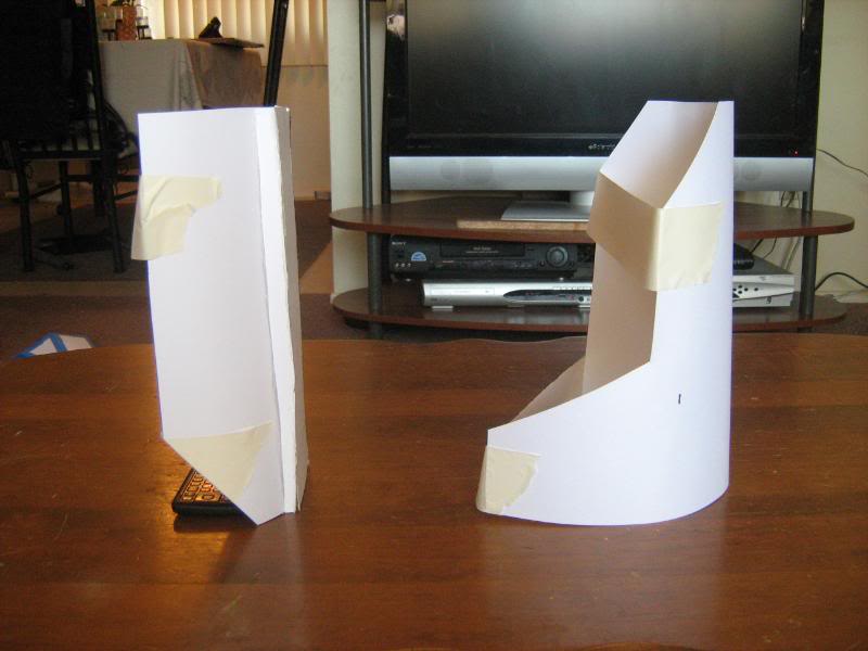

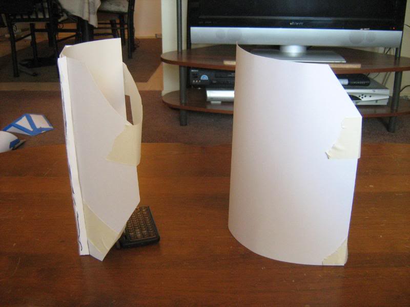

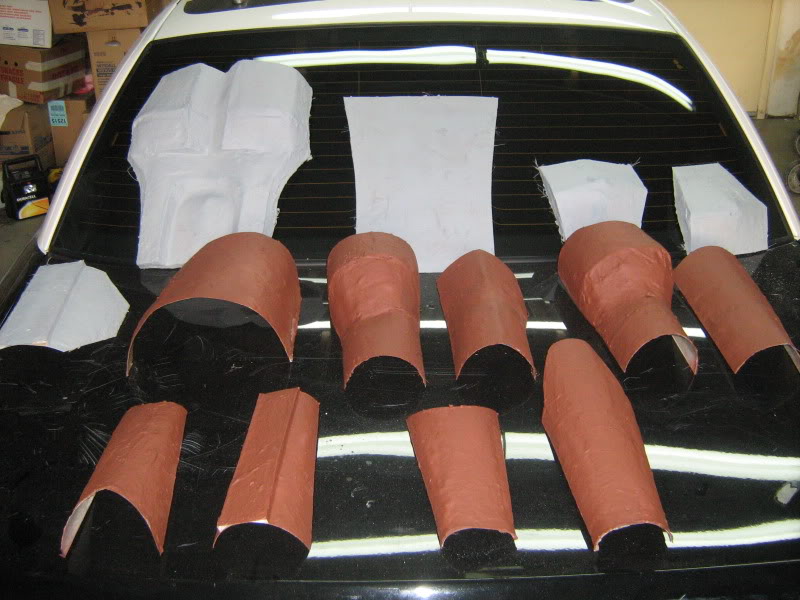

Alrighty, so today's plan was to put the backing on the chest plate and strat glassing it. However, I realized my brother has all my sponge brushes for fiberglassing. So, I shifted gears and decided I'd just get the rest of t he armor built out of posterboard and tape.

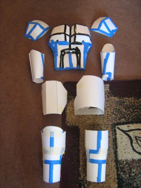

So, here it is...

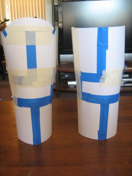

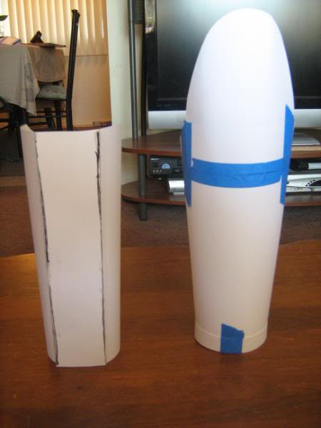

Gauntlets:

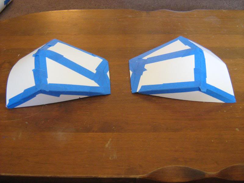

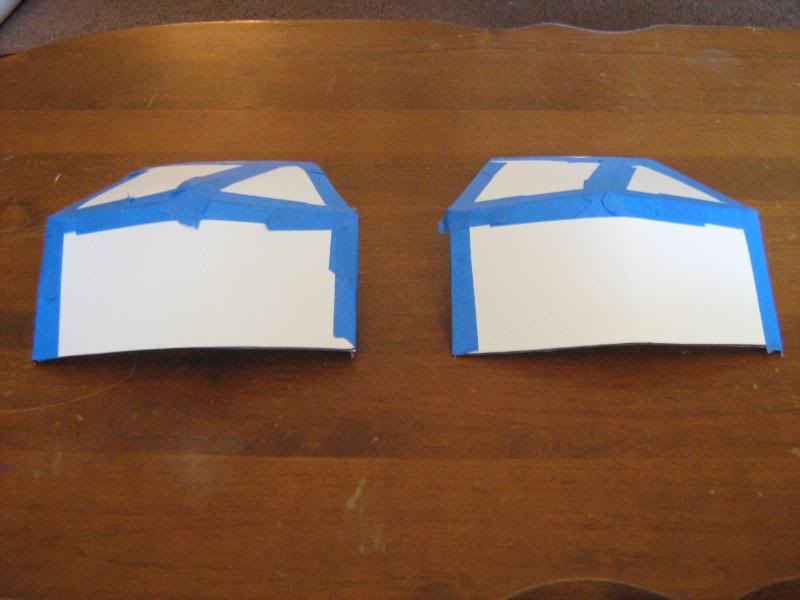

Shoulders:
Thighs:

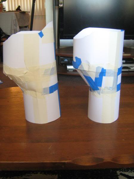

Lower legs:
Back plate:
All together:
The back plate is just a flat piece that I'm going to glass. Nothing fancy. I plan to have a jetpack with this kit. I will try to find another Mega Bloks jetpack or, if I can't, I'll just snag Ordo's and build him a new backplate.
No cod armor as I will have a 1/2 kama and a loin cloth with this set.

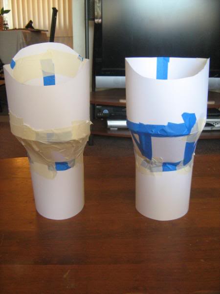

The gaunts and lower legs are snug and will be glassed in one piece. I can't slide them on and off. After they are glassed and sanded, I'm going to cut them open and use piano hinges to close them.
LMK what you all think...

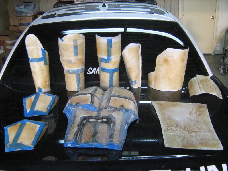

Alrighty... today I glassed the exteriors of the plates and rough trimmed them.
The next step is to add 1 more coat of resin to the exterior and the interior of the armor.
Alrighty today's project was adding a second coat of resin to the exterior of the plates, splitting the whole pieces and adding 1 coat of resin to the interior sides of the plates. I primed the plates as well to show how rough they are and to give a guide to the rough sanding which is the next step.

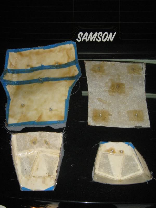

In this pic, you see the female sides of the Chicago screws glassed into the backs of the chest, shoulder and back plates. This is for future mounting.
How do you attach the chicago screws???
In this case, they are fiberglasssed right into the plate. I put down the resin then the fiber then the resin just like you would lay the glass. However, when I prepped the glass, I cut a small hole for the post to go through. So the post is coming up through the glass and the base is under it. It's sandwhich between the glass and two layers of resin. I;m hoping that eliminates any issue of popping them that can occasionally happen when you use a glue or JB Weld.
Once everything's done, I'll mark off on the carrier vest where the posts go, cut a hole in the vest and screw the male end end from the back of the vest. Similar technique I used for the bolts on my A'den plates and vest. Except with those I just bolted them straight through the plate.
