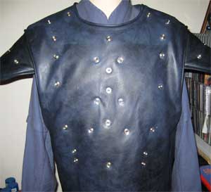

folks, i need some help here to locate where to buy the snap botton used to attach the Jango amor piece to the vest... I tried Walmart, Target, Lowe's last month while i was in U.S but it was not successful. Can someone give me an idea where to buy those :) thanks a million ...

The answer is Tandy leather. They have line 24 snaps that are high quality and affordable. You can order them online, and they were on sale recently.
verbal21, i think there is a Craftool Line 20 & 24 Snap Setters which you can buy on the Tandy wedsite, i am also gonna buy one of this. :)
One very very important thing about installing snaps is what surface you are hammering on. If you have a little anvil or on concrete it works best. If the surface has any bounce to it the snaps tend to not set as well.
